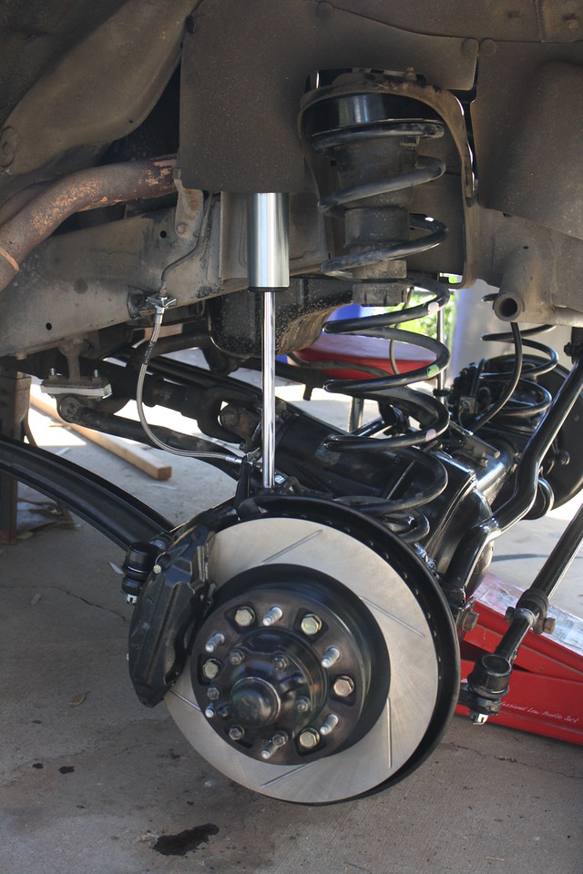

Put the axle back on along with some extra suspension travel with remote resi adjustable fox shocks, all new moving parts (bearings, seals, birfs and suspension bushings), arb air locker, slee extended brake lines and 1" lift via coil spacer.
