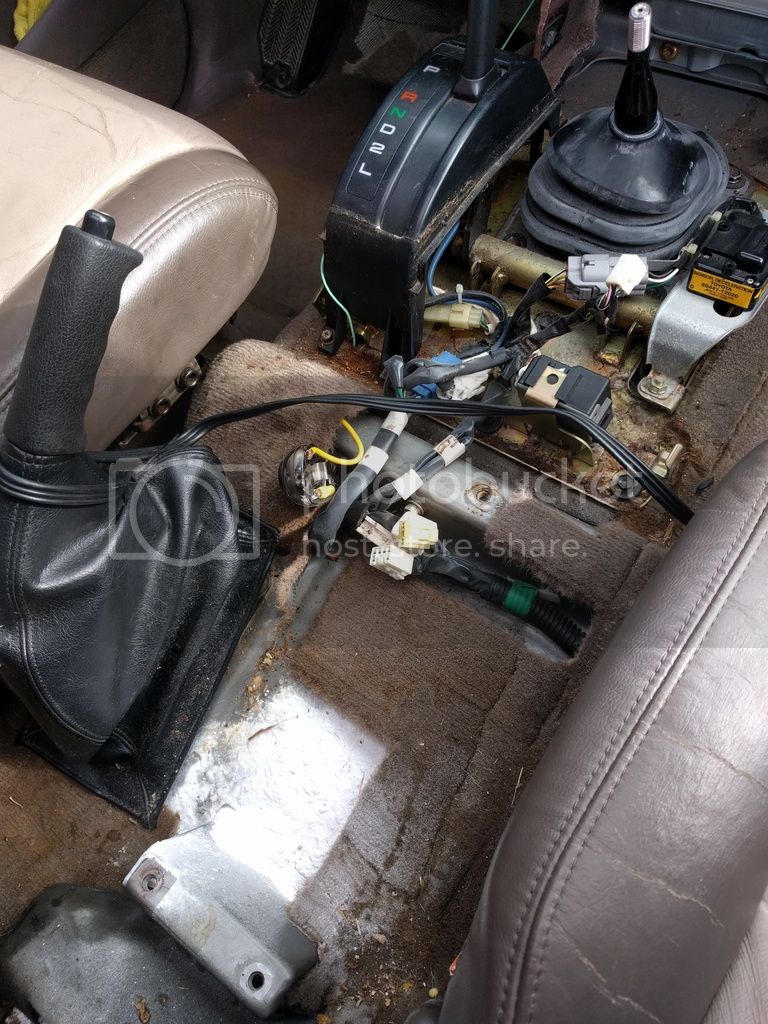

Found some nose candy pulling it apart.
Did you taste it? Maybe just baking soda...

Baking soda is a natural odor eliminator. Prob had a box of it in the glove box or something of the sort.
The only thing is, it would be impossible to get it there like that unless the console was removed.
When I was in the car business I bought a Ferrari 599GTB that had a quart ziploc freezer bag filled with some fine Peruvian fish scale. Interesting find to say the least.
