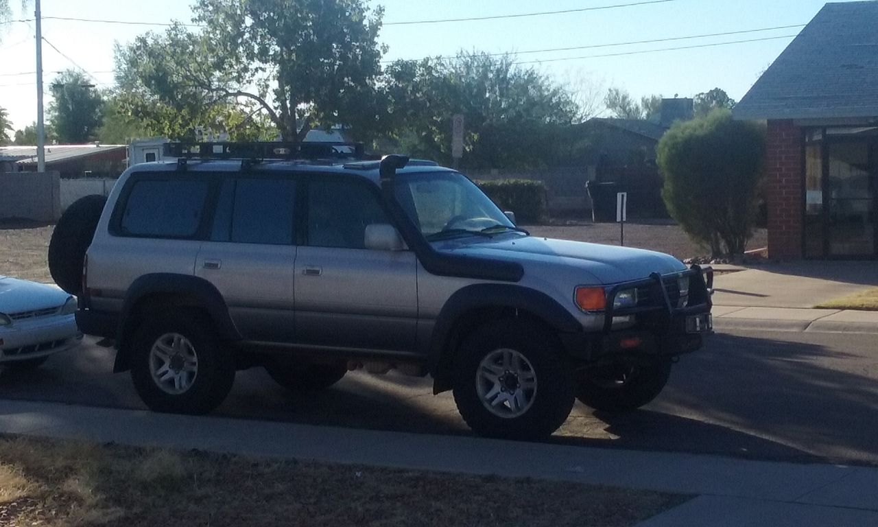

Well not exactly... exactly this weekend.. But the last 4 weekends.. I've been busy!

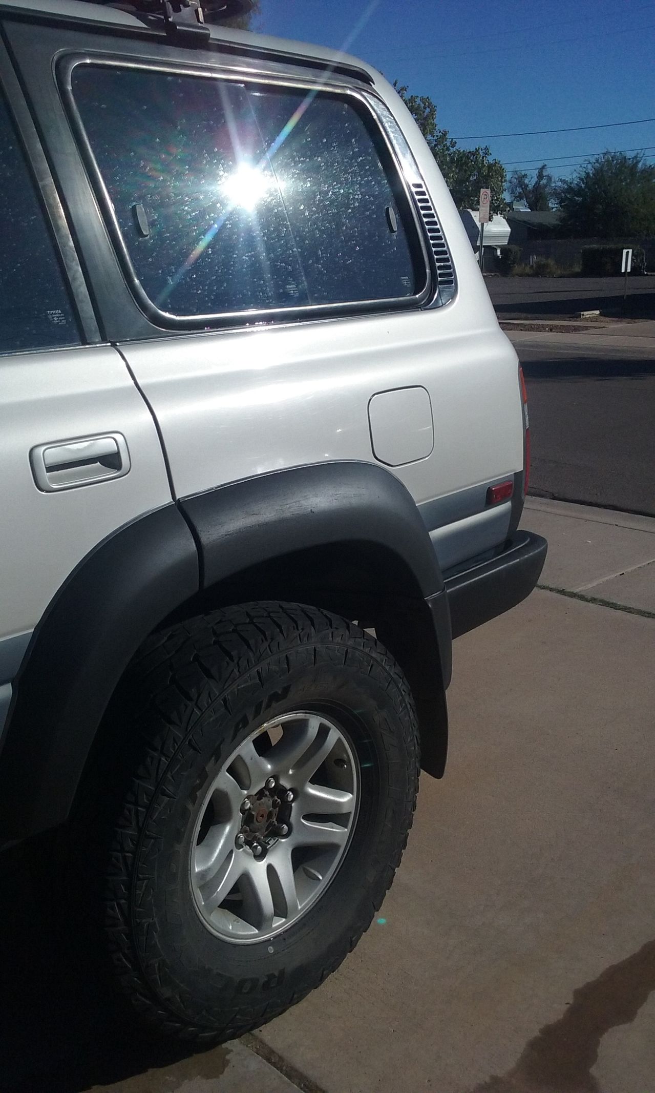

1) Remove all flares, and back bumper covers.. Order all broken grommets and paint flares + bumper covers with black bed-liner.
2) Change axles and t-case gear oils

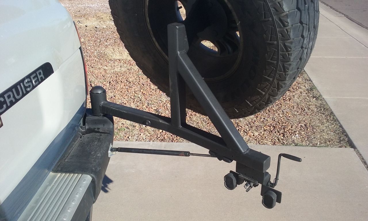

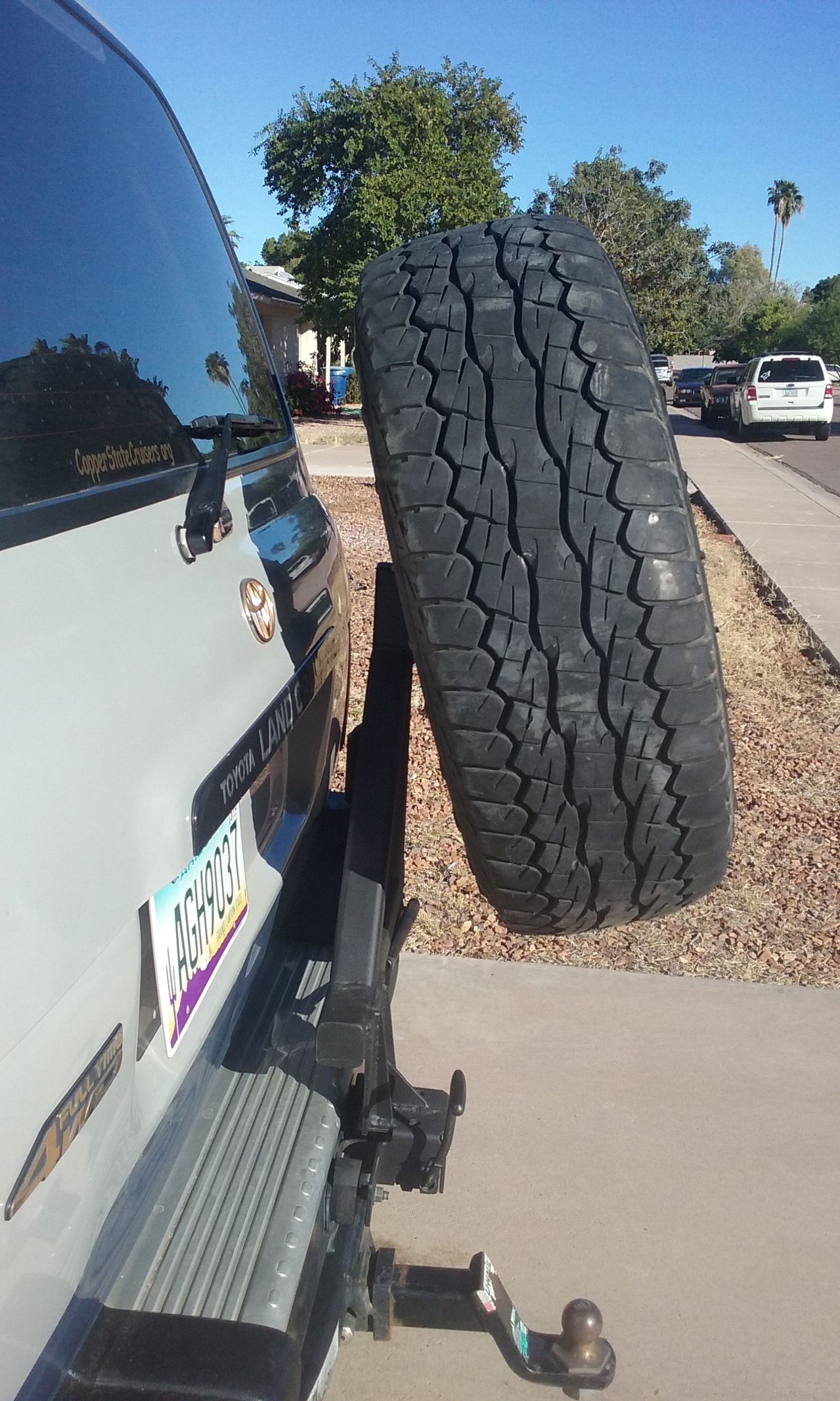

3) Reinforce my custom Spare tire carrier.. Lots of welding
4) Reattach flares and replace flare gaskets to body with new OEM trim.
5) Fix broken rear passenger side window.
6) Install in cab winch control.
7) Re-weld cracked frame on axle locating bracket front.
8) New Bushings in Front and rear axle locating arms.
9) New bushings on front control arms
10) New bushings in both upper and lower rear control arms.
11) Front axle rebuild new seals, bearings ok just re-pack, new Birfs!!!! Turned front rotors and slapped on new pads!
12 Re-welded front sway-bar to axle brackets.. and spliced/reconnected ABS line to PS front that was cut by the sway-bar while broken.
13) New Alternator.. (Broke while I was doing all of this.. )
14) Oil cover gasket (WHAT A ROYAL PITA this was I hate phillips screws for life now :mad:)
15) New Crank seal oil seal.
16) New Battery (Dead Alternator killed my last one)
17) Dizzy O-Ring.
18) New Belts including AC belt.. Toyota OEM.
19) New T-Stat and all hoses.. + Radiator to shop for cleaning refilled with Toyota Red ;).
20) New Heater diverter valve by firewall

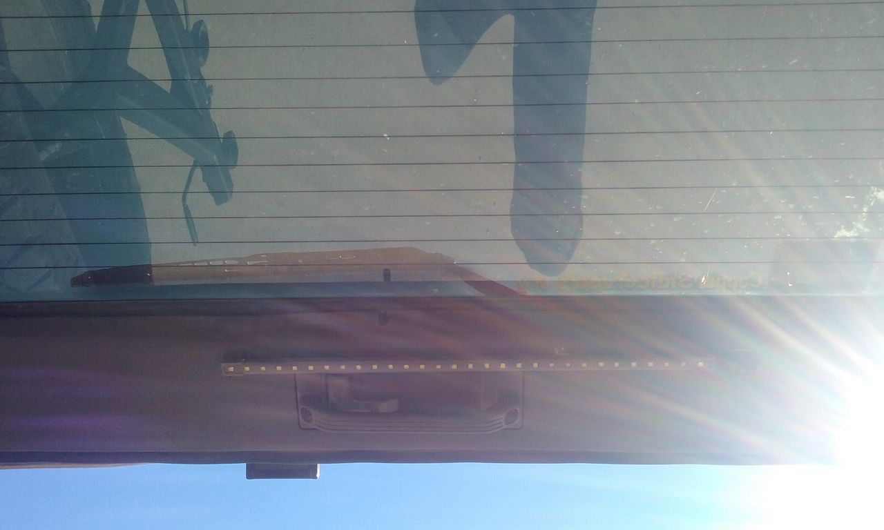

21) Installed LED bar on the upper tailgate (turns on with rear dome light)

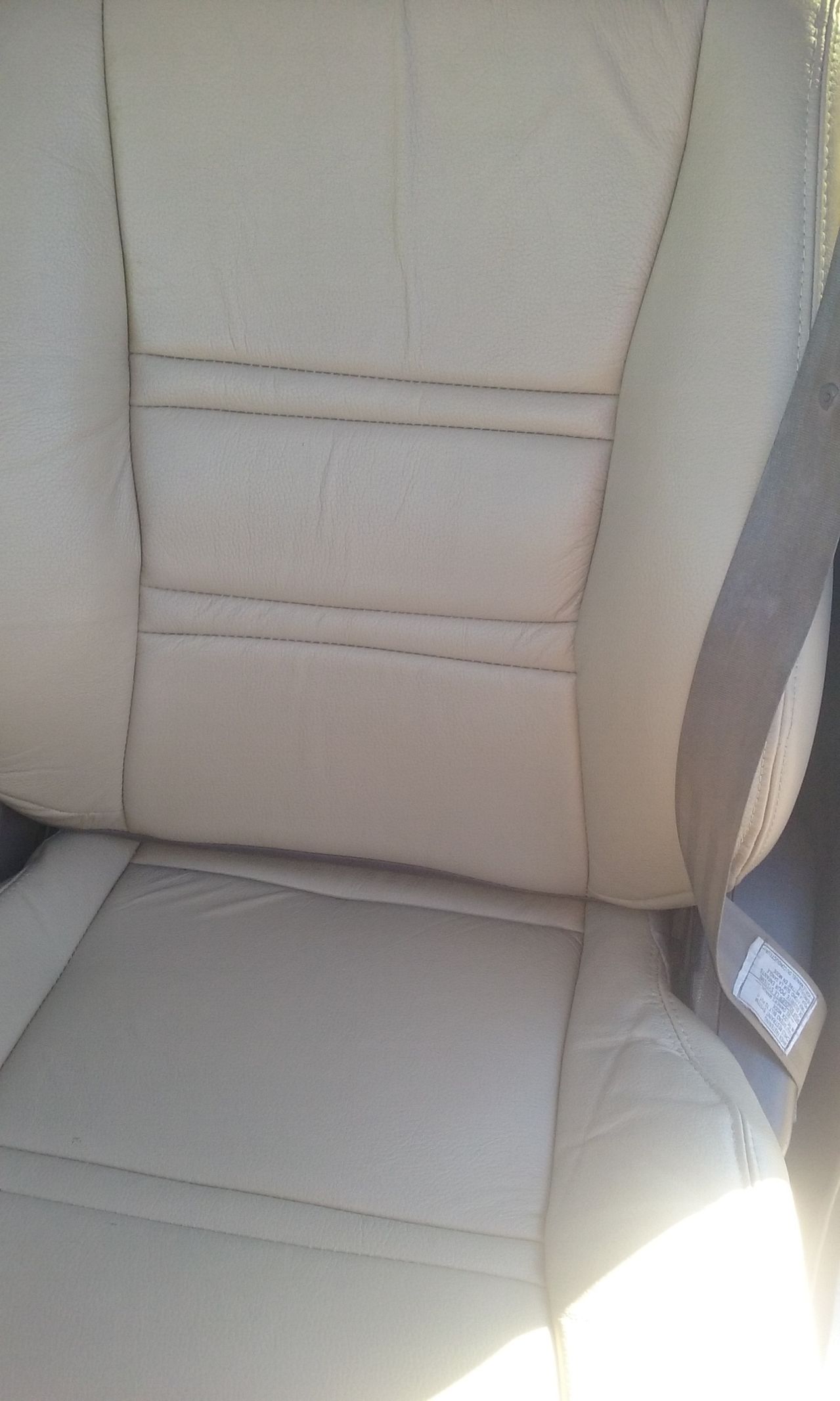

22) Took front seats out + DS and PS arm rests and center counsel arm rest and had them re upholstered (Love the smell of new leather)
23) Cleaned all ground contacts and contact on anything to from fuse box under hood to battery, Alternator, and Starter. (Also re-wrapped and re-ziptied harness to make it all perfect.
24) New goodyear floor-mats from Costco $14 for the set !!! :cheers:
25) New windshield wipers.
26) Bedlined top of washer fluid reservoir and coolant overflow (They where getting sun rotted)
27) Steam cleaned interior while both front and back seats out.. (got rid of a million coffee stains and found $3.76 in change:lol: + PO's? fancy looking maybe gold ring? )
28) Changed U-joints on front and back drive shafts.
29) New interior trim pieces for the sun roof (old ones where falling apart) Also ran weed-wacker line to front drains on the sunroof, cant figure how to find or clean the back ones?
30) Ran out of time to do the Valve Cover gasket and Spark plug gaskets.. + Sparkplugs (But I think 90% of my oil leaks where the oil pump and crank.. So I now have the parts in my parts bin for another time) :hillbilly:
30) Gave her a bath and a good waxing..
31) Out wheeling to make her look right again after all the cleaning and fixin'! :rolleyes::p :steer::flipoff2:
32 Forgot.. Also got rid of my fugly KC lights on the rack.. Installing a light bar.. Waiting it to get here in the mail. !
All as far as possible done with Toyota OEM parts.. :censor: expensive..
So I guess I'll be keeping her for a few more years..
And here are the pictures.. ! :hillbilly:
Exterior Before...
Exterior After!!
CLEAN!!!!
