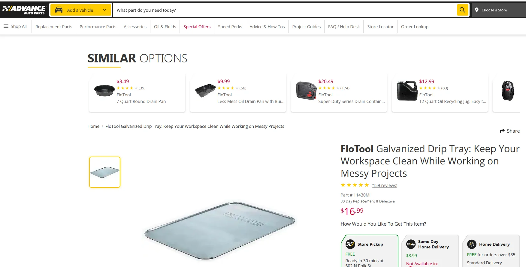

Also interested in where you got the cover, and the drip pans you have the diff/shafts sitting in. Been on the hunt for both for a minute now!! lol
Not the exact pan, but close enough (Blitz used to make/sell them, but alas, no more):
I have two of these and a half dozen large mortar tubs. Indespensible.

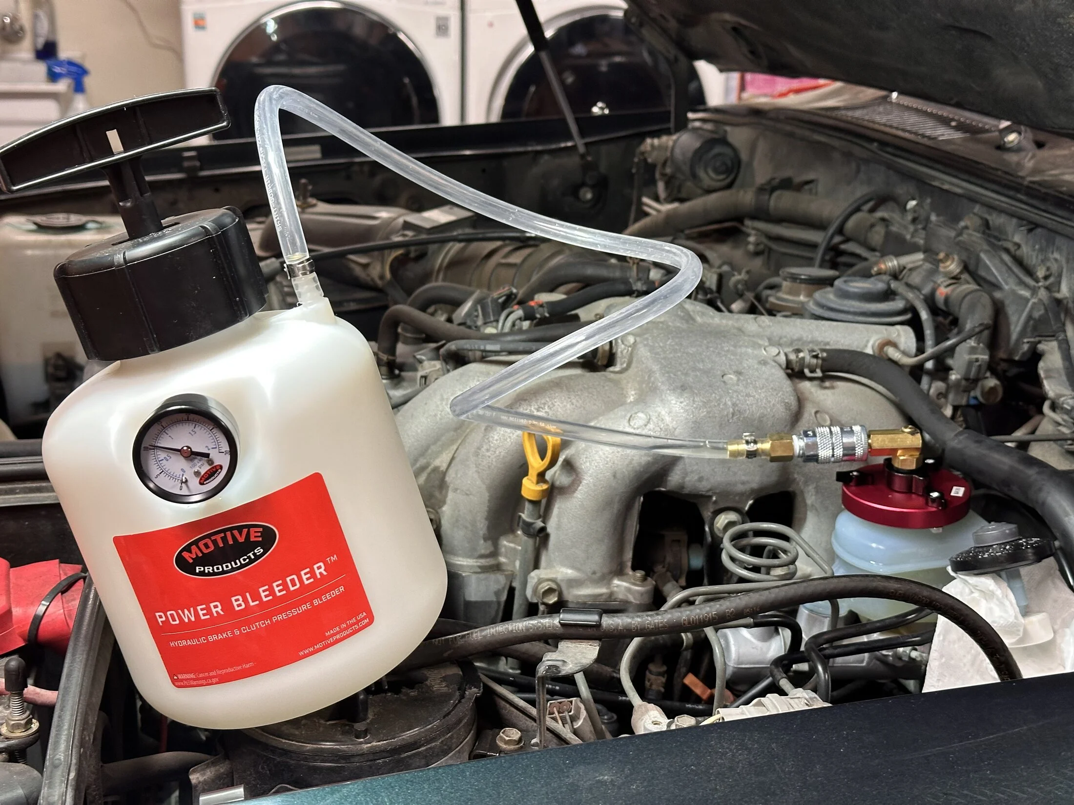

In my quest for braking improvement I did a pressure bleed. After jacking rear of truck up 6” to bleed the mc. This is because on my list of causes of a spongy pedal is air in mc. And the nose points up when mounted, trapping air. I bench bled before mounting this new mc. I used a universal kit with hoses that run back to mc res from Napa to bled.
Lowered truck then when testing pressure bleeder is was dripping at chrome universal fitting. So I added thread tape and it held pressure. Results are marginal improvement. I’m suspecting a faulty new mc.

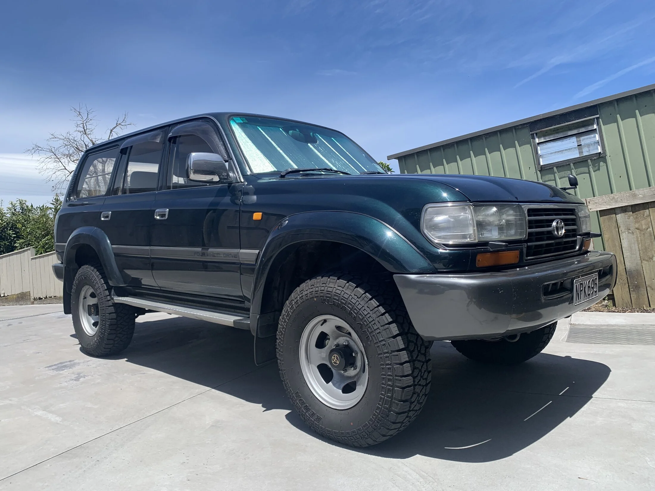

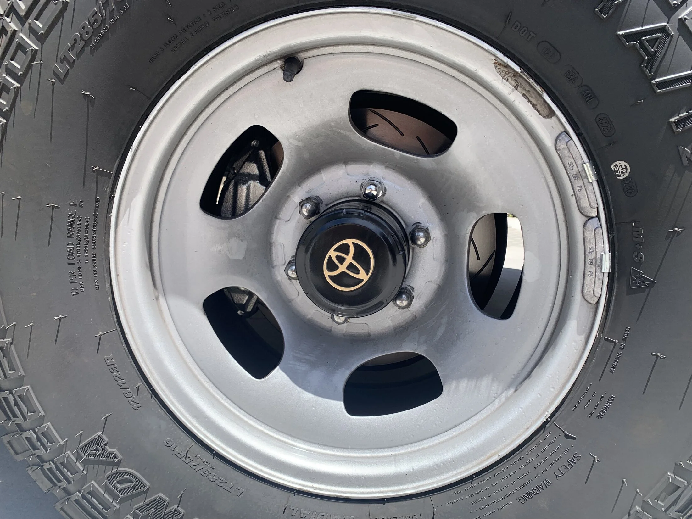

Finally found 4 x OEM steel wheel caps after searching every source known to man. Upgraded front rotors and callipers to DBA units. Had front swivel hubs rebuilt at the same time - two snapped main studs needed replacement. Replaced all studs with new OEM. Extensive baselining is now complete - ended up being more than I bargained for in the end.
love the OEM steelies, still have mine and one day will get a set of mud tyres for them

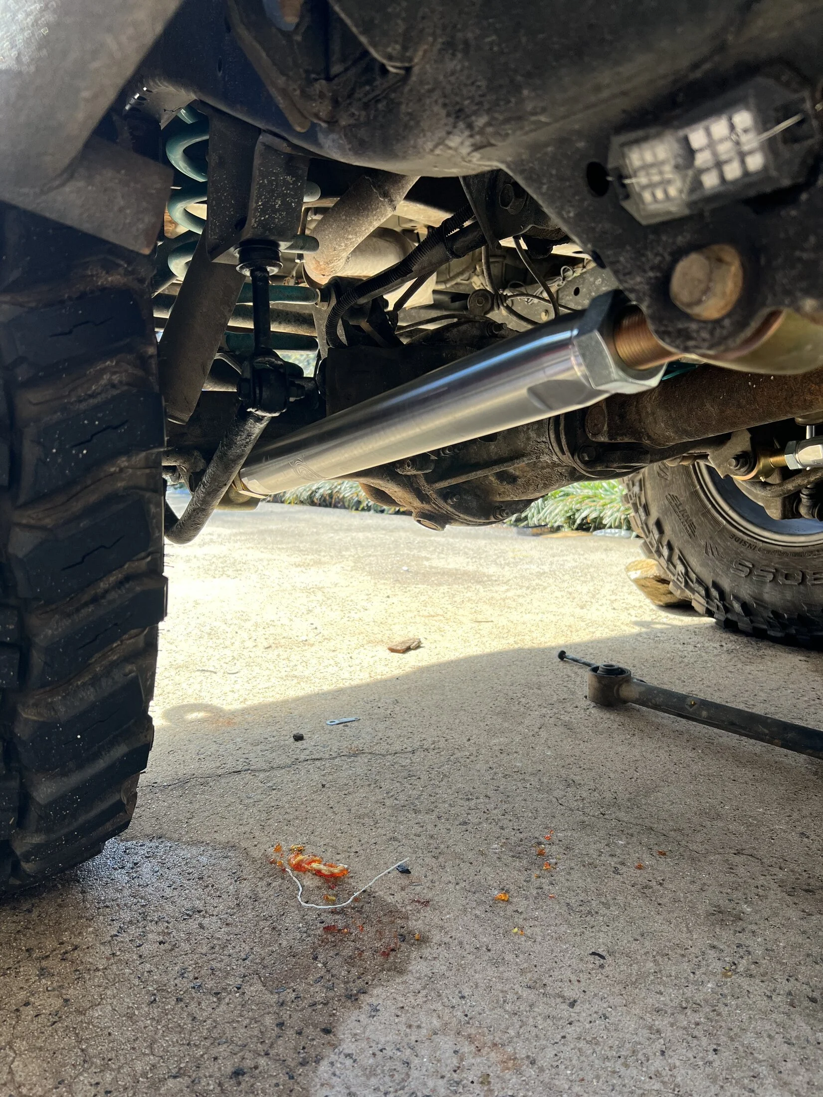

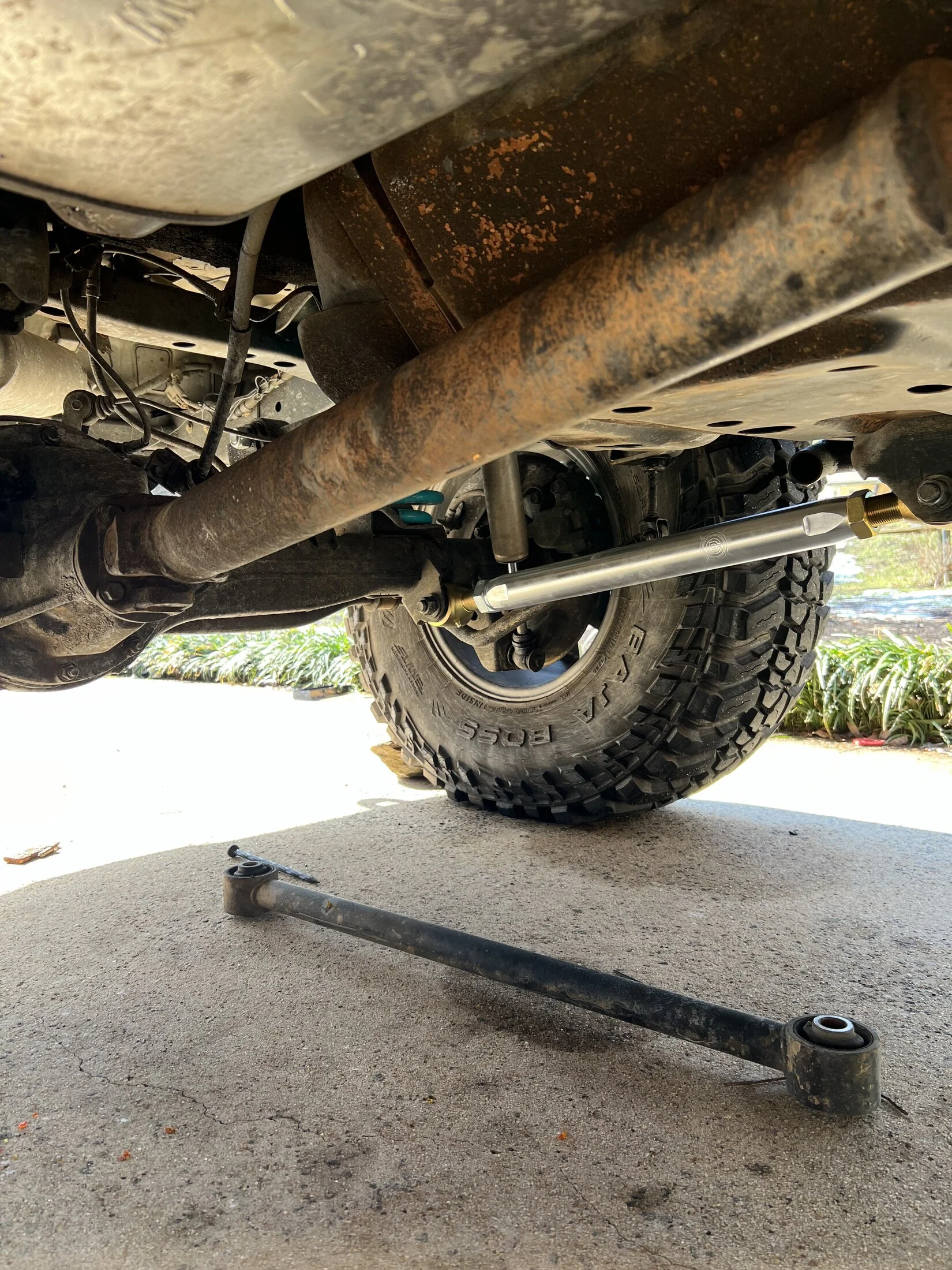

Looks sweet, but they do look a little short. How much of that joint is threaded into the link? Wouldn’t ever see a need to make them shorter and that looks like the only adjustment.
There is an 1 1/2 of thread engagement on each end. If I was to do it again I would just buy all the parts separately and get my own links cut but I bought it as a kit and I think they did the minimum length possible to keep the price as low as possible .🤷🏼‍♂️ I’ll put them to the test when I go to hammers at the end of the month.
