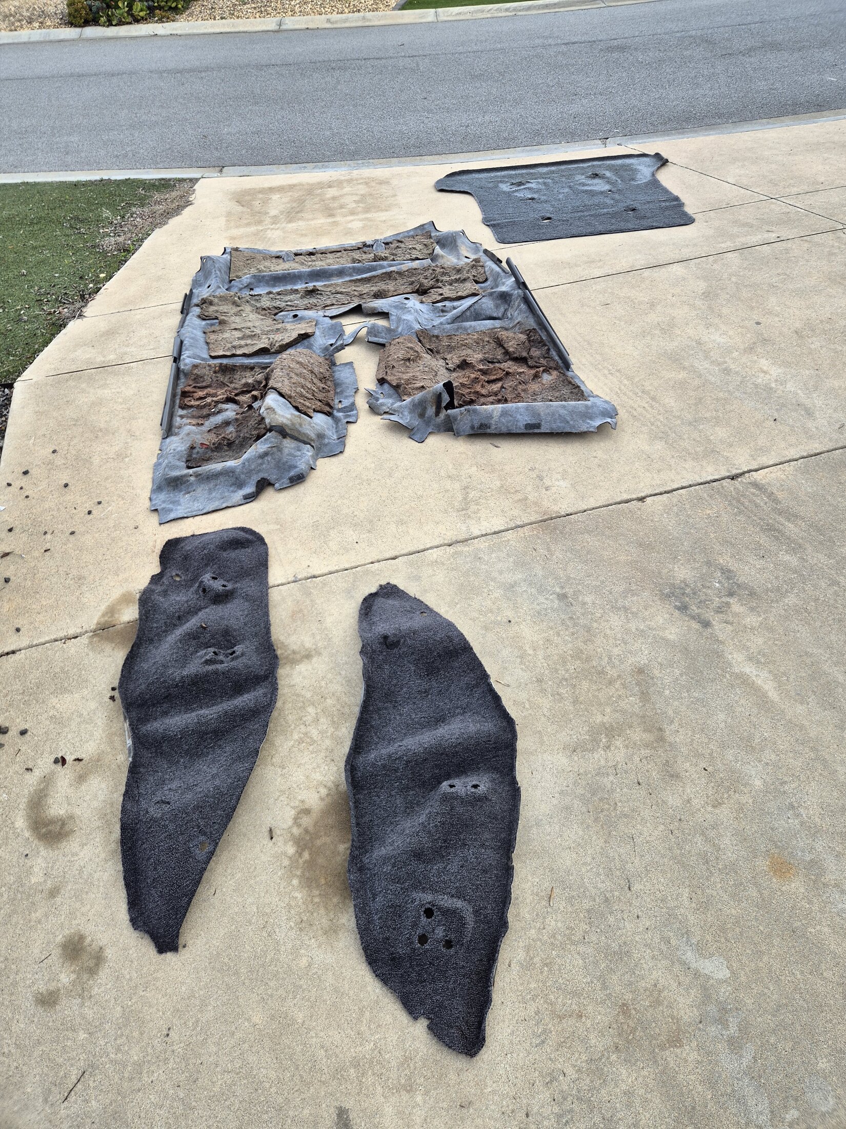

Not all this weekend but got her home (nice to be in an 80 again!)

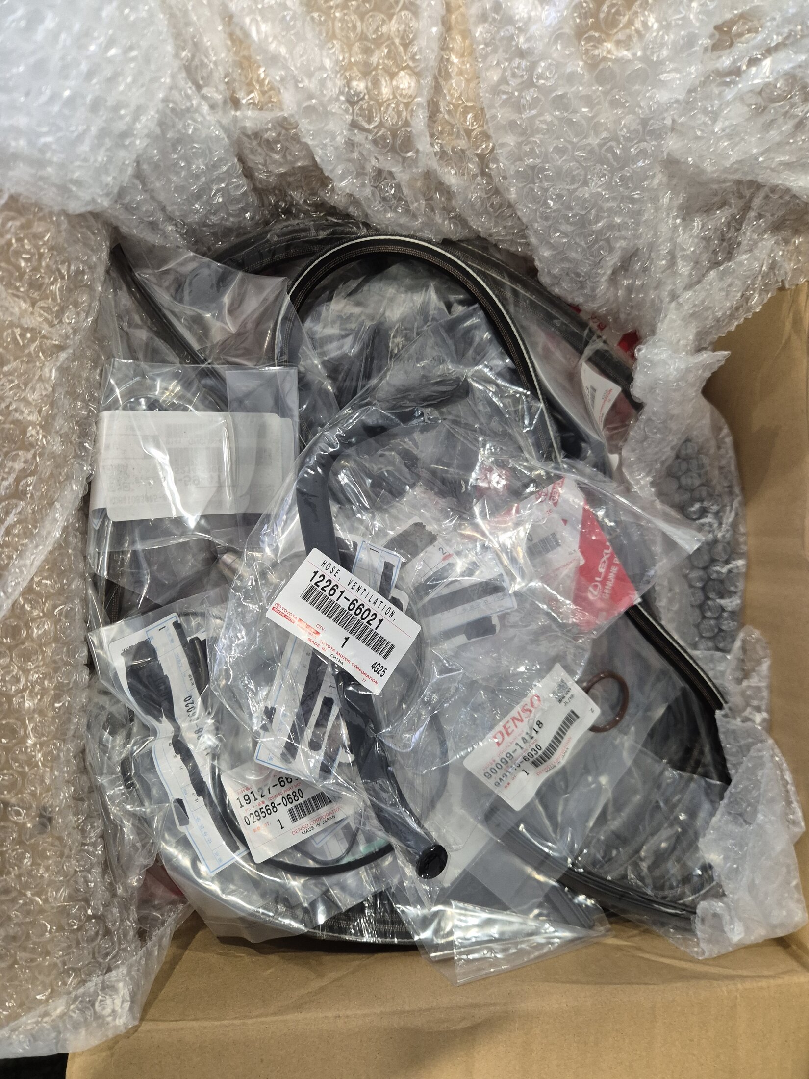

Started getting the interior clean. Pressure washer on the carpet, extractor on the seats and dry vapour steamer on pretty much everything else. Also got a haul of parts delivered
So far with @Indestructible 47 help installed new blue hub with 50ml of 10000 cst oil to replace some aftermarket that was mediocre at best, replaced drive flanges (much less backlash in driveline), replaced PO's incorrect size front driveshaft hardware with OE, replaced some blown dash lights, removed the PO's lacklustre LED spotlights and got some FYRLYTS installed and a thorough clean and degrease of the engine bay and underbody. Will need oil pump O-ring at least, maybe oil pan reseal or rear main as well.

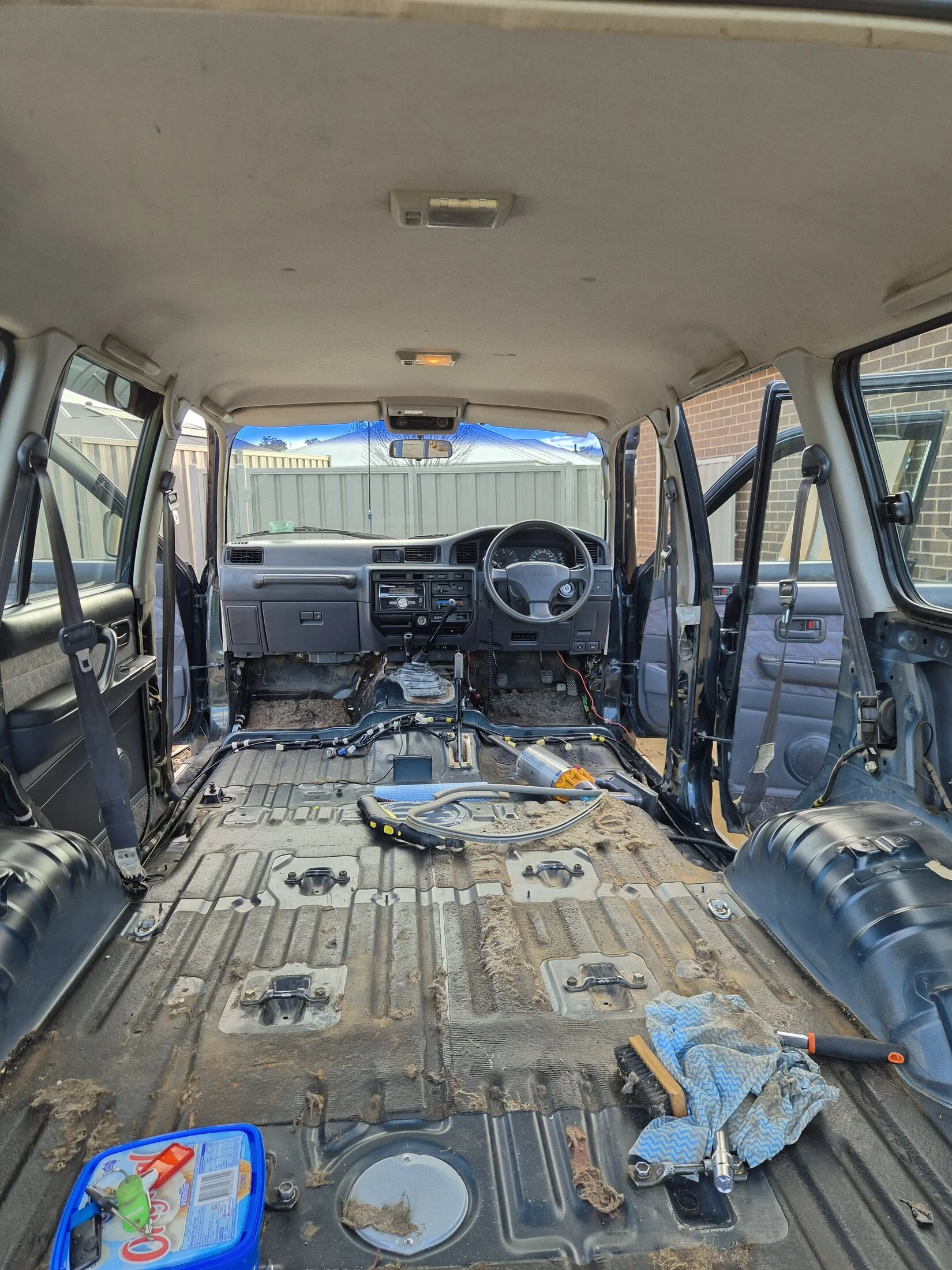

My HDJ80 from Europe has a fuzzy headliner but no fuzz on the pillar trim. Yours looks the same, ya?
I hate the fuzz, it stains far too easy and can’t really be cleaned. We have been having the headliner covered in a headliner fabric you can actually clean.
On the pillar trim, I discovered under the fuzz is the same as non-US Cruisers. Just textured plastic but the glue to adhere the fuzz is no joke.
