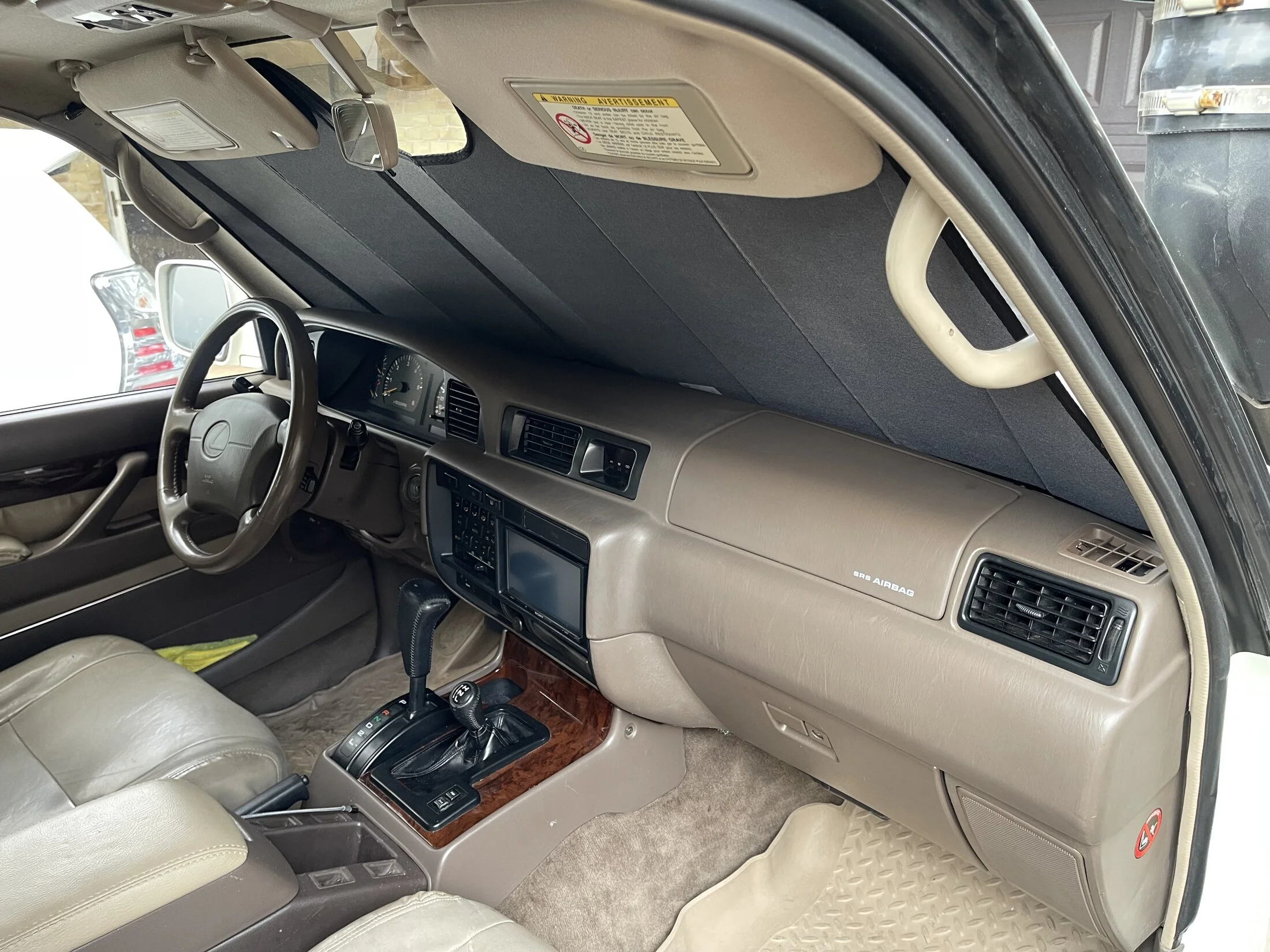

Headunit pic (not perfect but I'm not pulling the trim off again to adjust for milimeters):

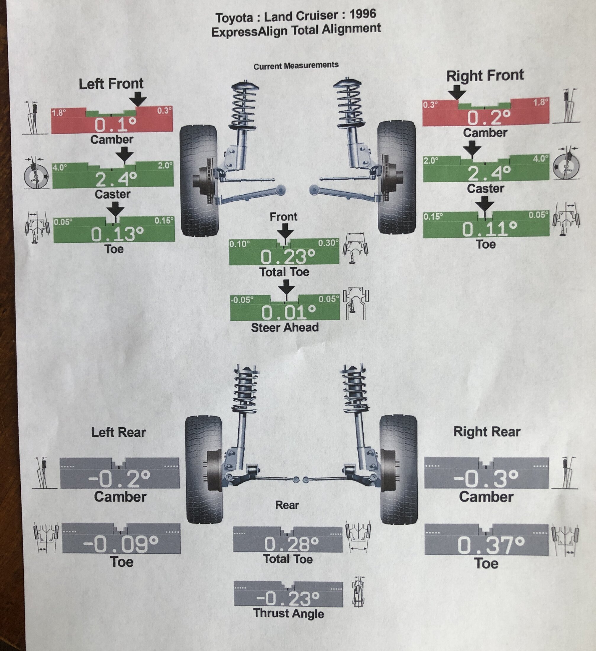

Almost two years after installing the new lift I took the cruiser in for an alignment/caster reading to see how things looked. Not bad.
These are dobinsons C59-170/171 springs
Landtank 2.5” caster plates.
I did the toolsrus alignment in the driveway not long after getting new tires.
Bottom of Fender flare to center hub measurements are now:
LF 23”
RF 23.5”
LR 24”
RR 24.25”
I do have a decel groan with this combo. I had it with a stock driveshafts/new ujoints. And still have it with a front Landtank double cardan. Any ideas on what I should check next?

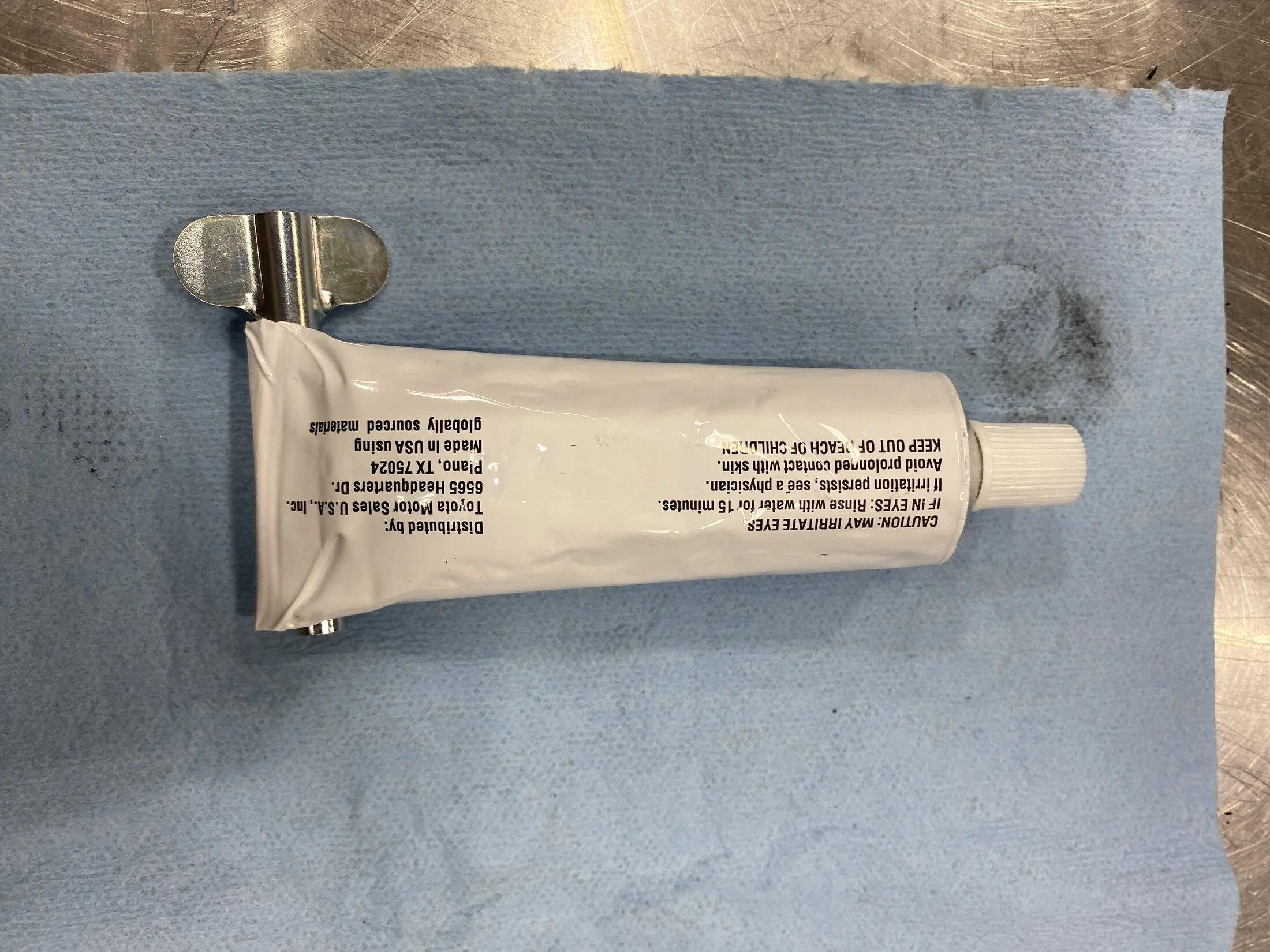

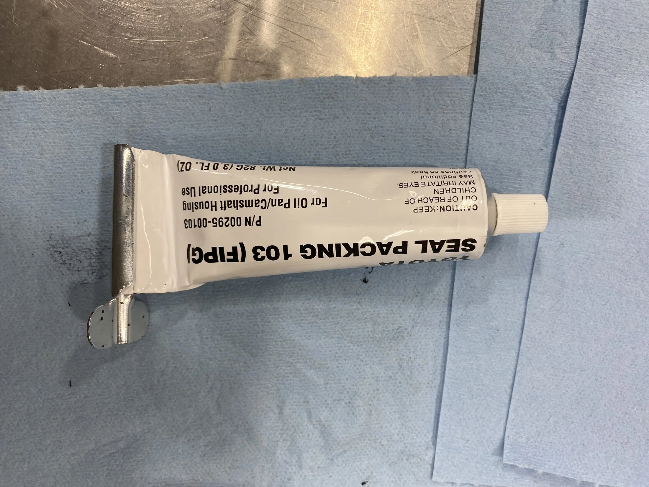

Learned what this metal thing is for in the Toyota FIPG boxes! For 5 years I have seen them and throw them away, never really thought about it. Then today when sealing a timing cover it caught my eye and clicked. No SH!T it’s for squeezing out the sealant. Every last expensive drop. I’m sure everyone already knew this and never thought to share the secret.
It also helps to control rate of flow.
We just did a trans pan and my daughter opens the box and goes "dad this is fancy. It has a thing to roll the tube up"
