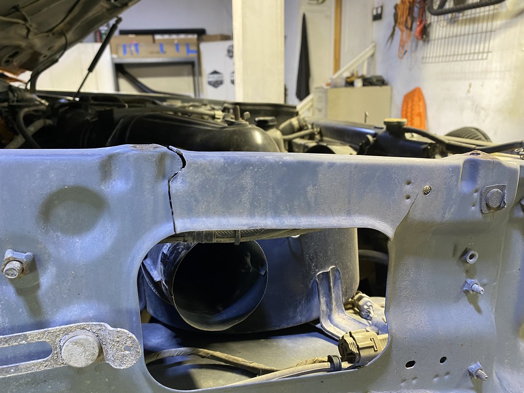

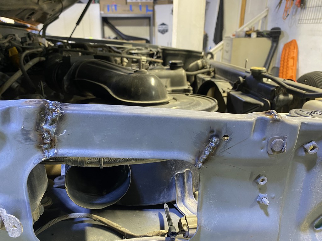

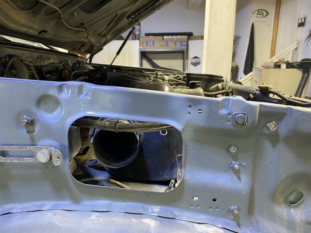

I was working on a few things yesterday and had the passenger front fender (and snorkel) off and I noticed these cracks. I assume from body flex and making contact with the snorkel inlet where is passes through here to the airbox.
I welded up the cracks and all is well again in the world. Might be worth checking on your own rigs although I'm sure it's not a certainty on every rig with a snorkel.
