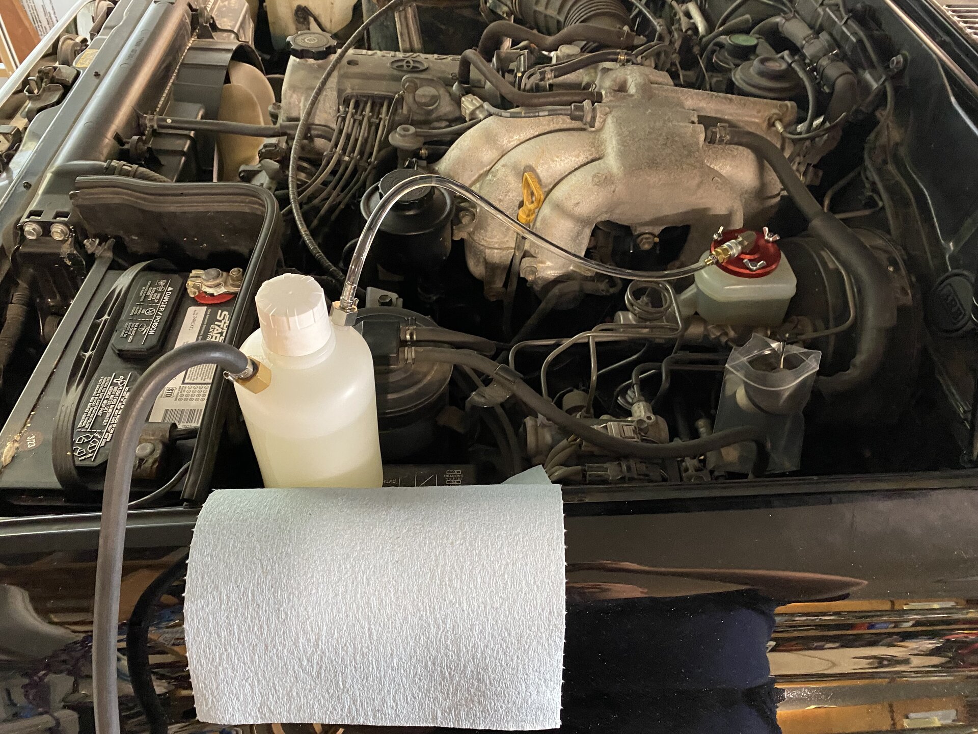

Also for those that haven’t tried the Speedi bleed brake bleed system, I can’t recommend it enough. You just put the cap on the reservoir, fill the bottle with fluid, attach the air line to your tire (yes, it uses your own tire for air pressure), dial the regulator up to 12-15psi, and the go around and crack your bleed points. I did have to put together a bottle catch with some odds and ends, but man this made bleeding so easy.
