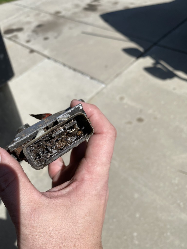

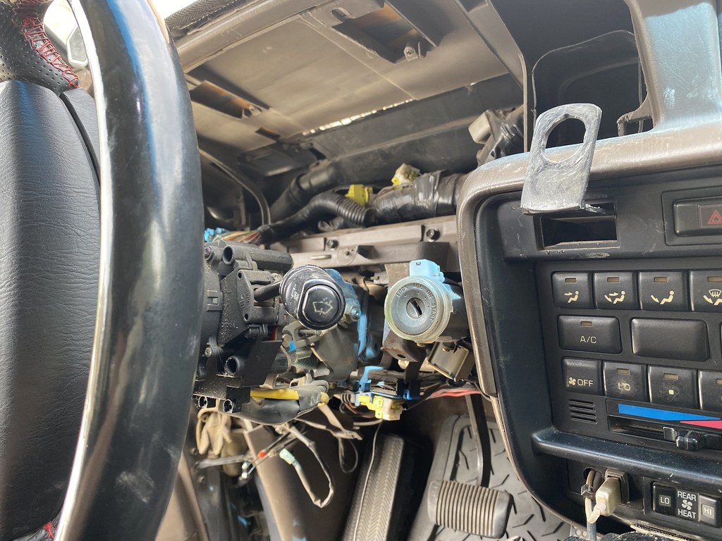

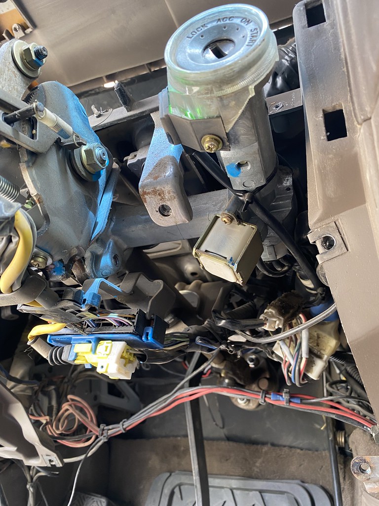

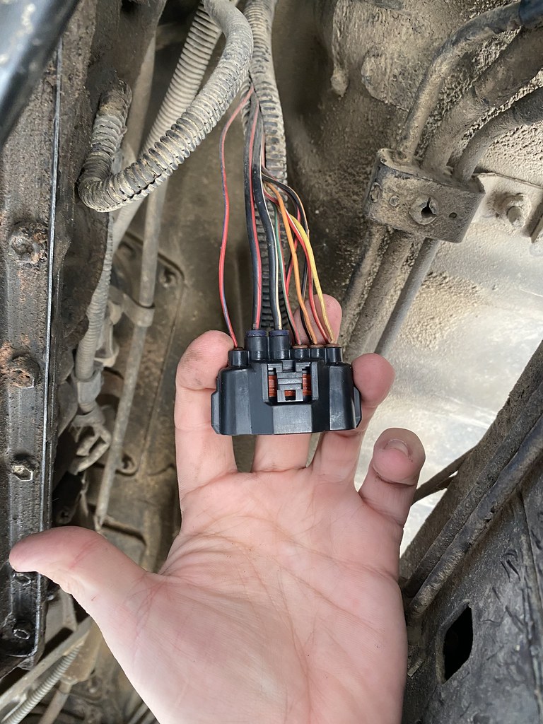

I chased a no crank, no start issue this week. In the end the culprit was a bad ignition switch but I replaced a number of parts that were aged and worth replacing. So now the truck has a new battery, new starter, new fusible link, new battery cables, new NSS plug and the ignition switch. Was a pain to trouble shoot but a good excuse to take care of some of the other stuff.
Untitled by Adam Tolman, on Flickr

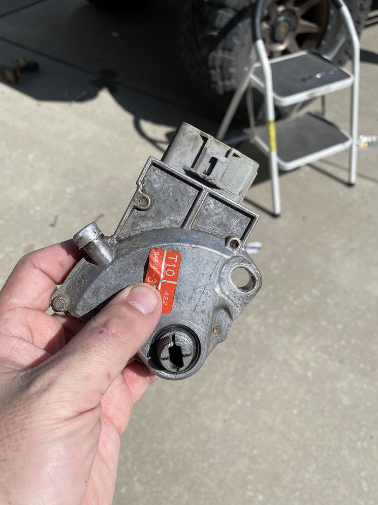

cleaned up the NSS
This was the inside of the NSS plug when I removed it.

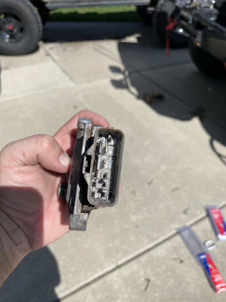

after:

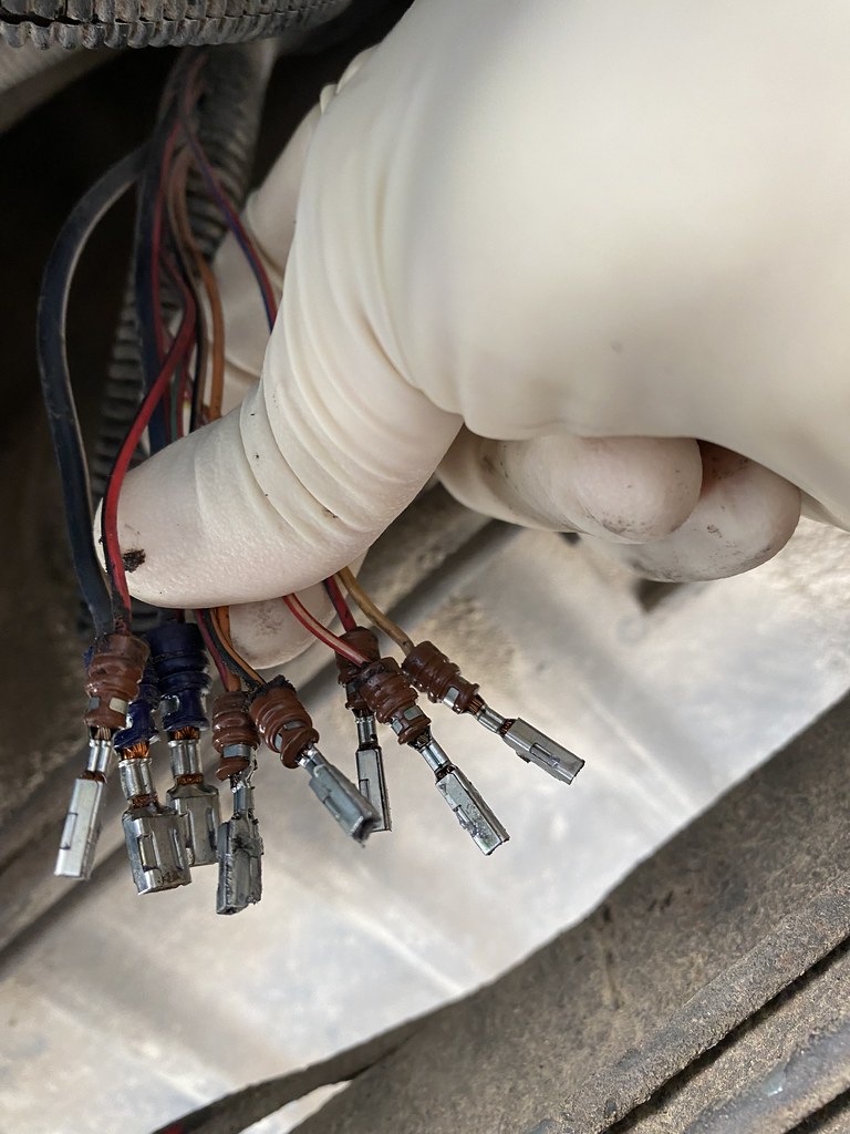

Checked that the wires were in good shape and replaced the housing.
Now the truck starts on the first blip of the key.
