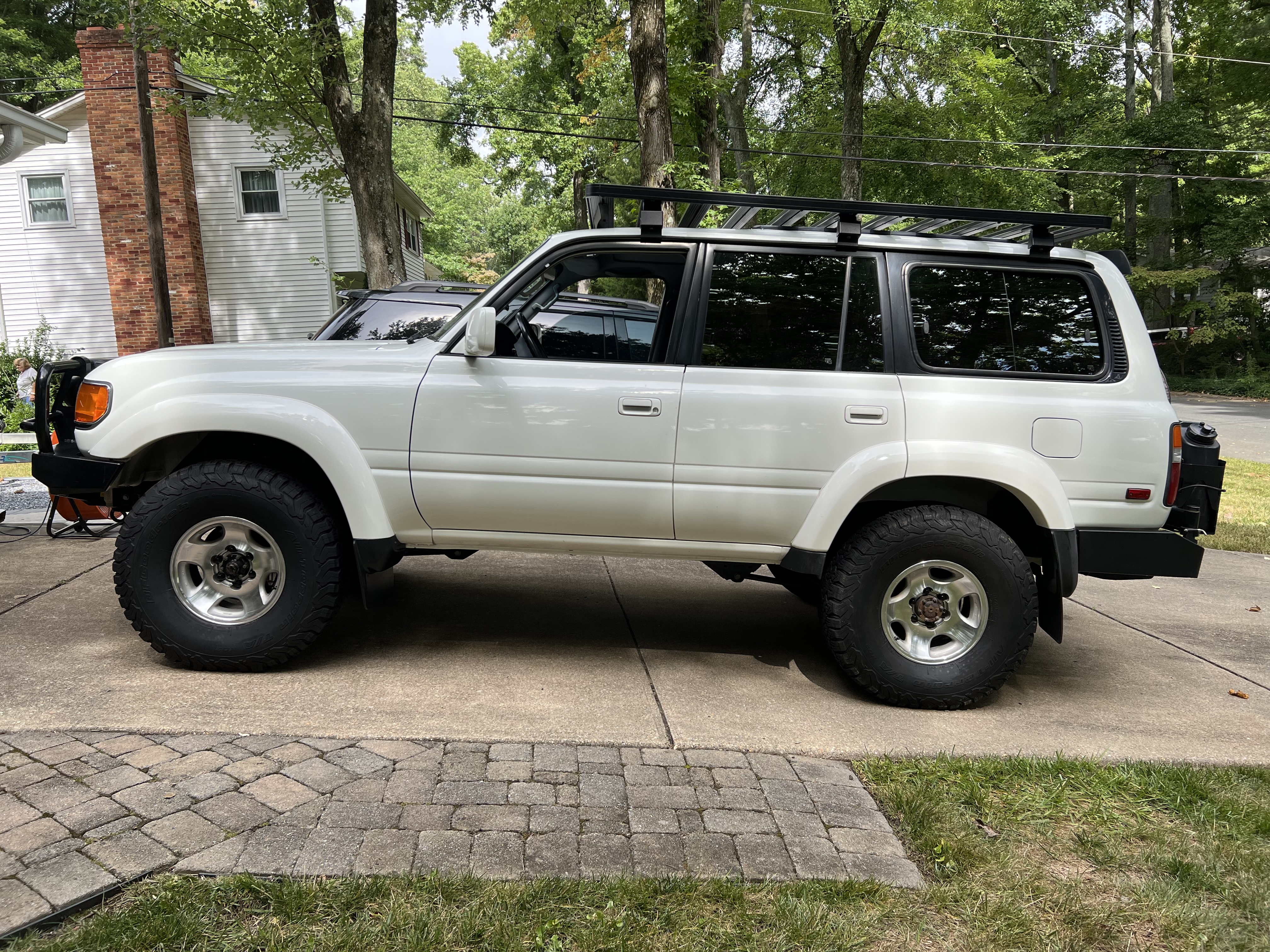

80 is back on all four tires, brakes bled, driveline running smooth after having both diffs rebuilt and swapping in a used t-case.
Two weeks ago @OGBeno were talking about how well engineered the 80 series is and I have finally come to appreciate the 80 after having performed some major work on my Cruiser - engine swap, etc.

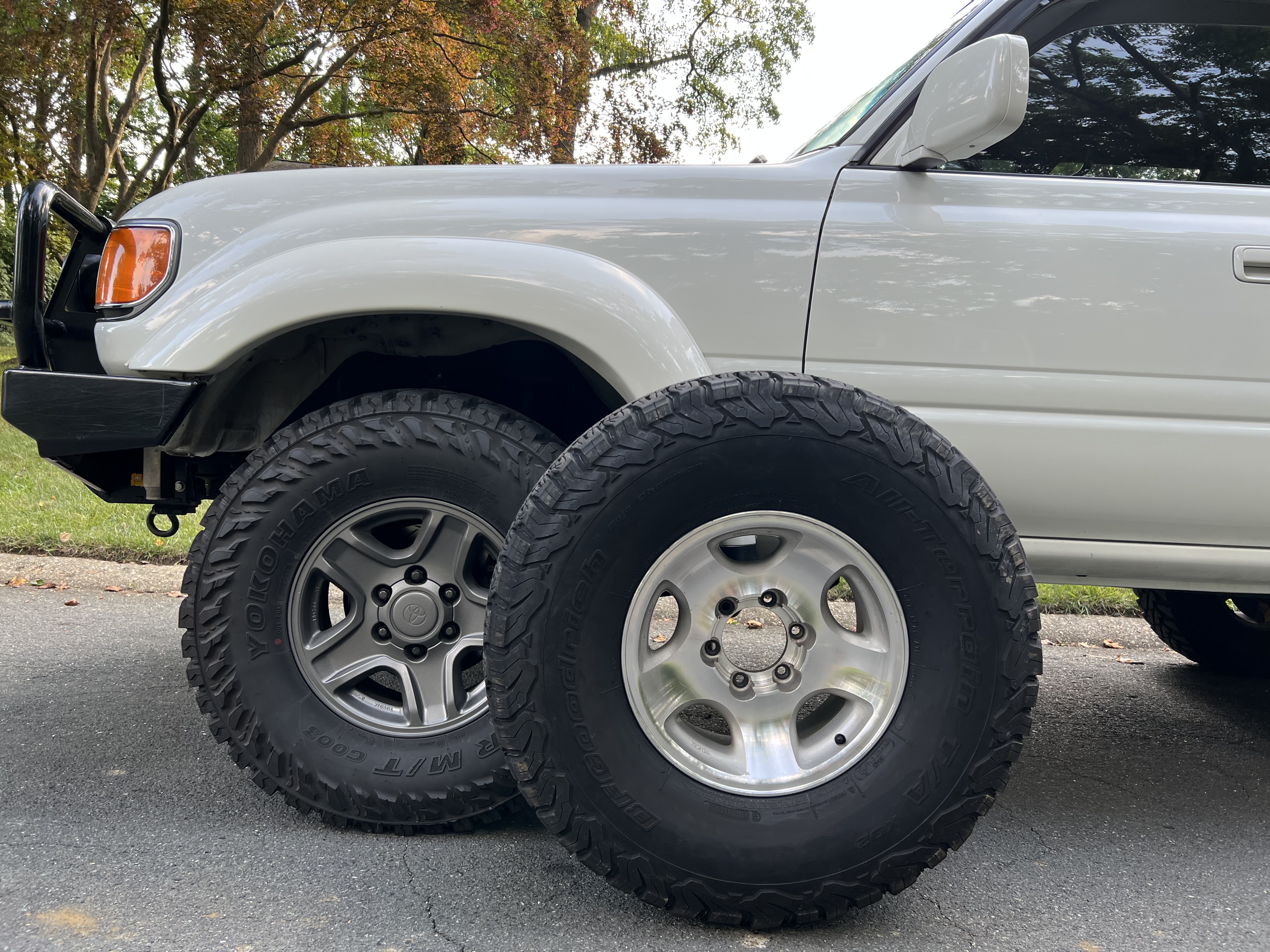

Bumped up from 285's to 315's...on the OME 2" lift...
Honestly, glad I did this as I found a leaking oil seal on the driver's side rear axle...ordered a rebuild kit to get that done this coming weekend!
