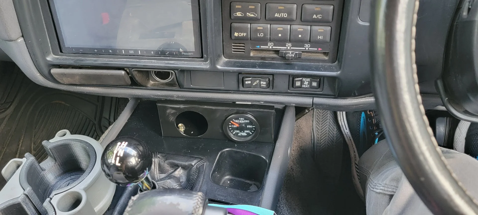

Put them on your pillar.
I really don't like pillar gauges.
The visibility is fine. And I have space to angle the gauge face a little.

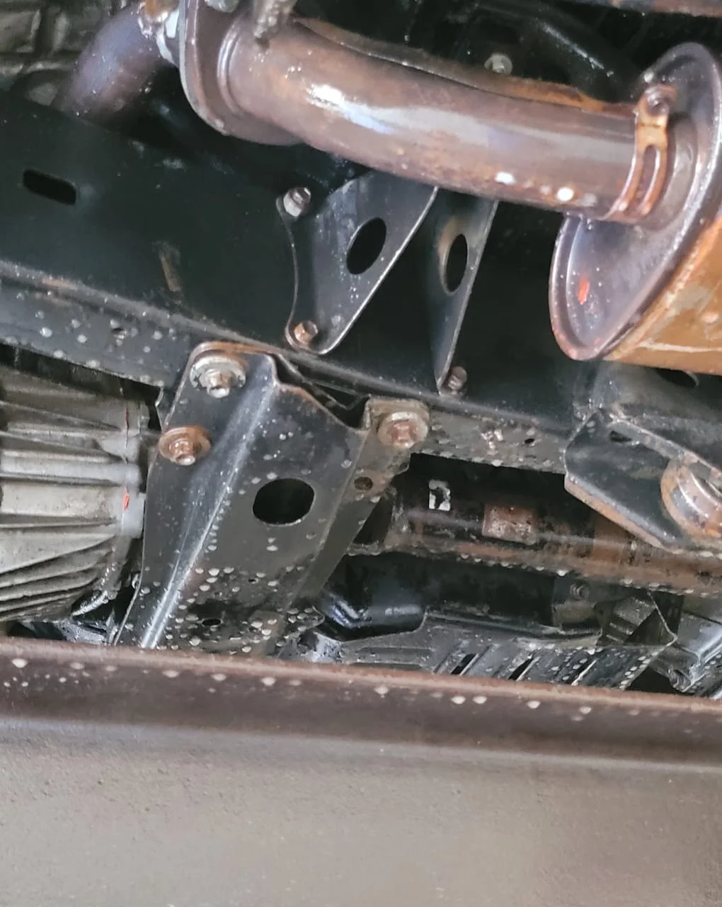

Did a quick under carriage clean, greased the steering wheel hubs and some bits and pieces.
Took lots of photos the right side has some rust issues that need addressing the left is ok.
