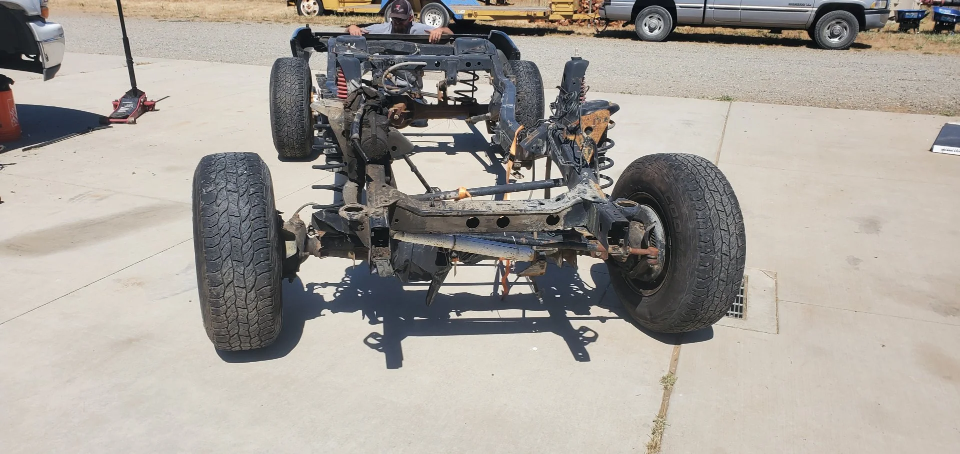

Hey all! I have been PM'ing the crud out of my 1997 FZJ80 for a couple years and am getting ready to conduct my first non-pm work on the Sherpa Mobile!! I bought a rolling chassis (allegedly a RHD HDJ81) with locking diffs in it. I don't know for sure what year the chassis is and have opted to just retro the locking thirds into my existing housings rather than doing a complete axle swap because I don't want to have to mess around with differences in mounting the entire axles. I am going to shoot a parts order out tomorrow and one of the things I am going to purchase is this E-Locker retro kit from Yotamasters but have a quick question: Apart from the gaskets which I know are different, can I buy two (2) of these kits and use the bolts, drill, and tap to do both the front and rear?
Additionally, does anyone who has done this recommend me completely removing the housings from under my rig to accomplish this magical feat? I am pretty freaked out about drilling and tapping the new studs in a straight manner!!

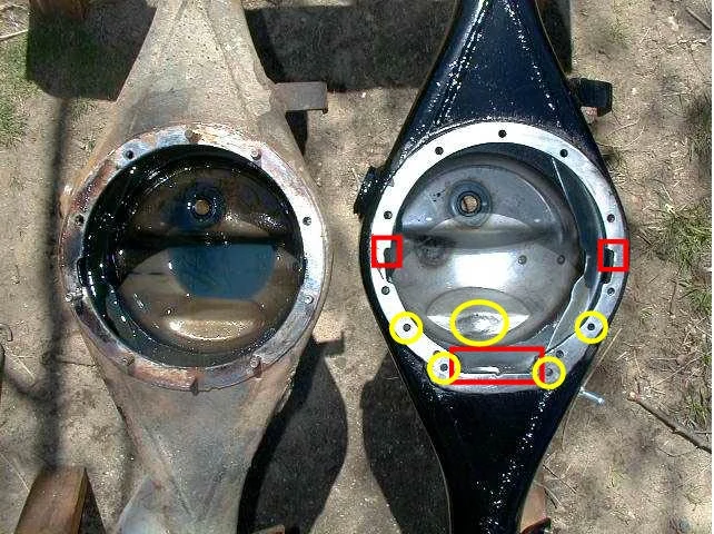

The retro kit for the front 8" e-locker will NOT work with the rear 9.5" e-locker. The rear uses larger diameter studs and the housing and locker are 100% different than the front.
Also, to fit that front locker in a non-locker housing you will need to grind/cut/otherwise remove a section of the axle housing in addition to drilling and tapping for the 4 studs. The picture below (graciously stolen from the internet) shows the difference between a stock, non-locked housing on the left versus a modified-for-an-e-locker housing on the right. The pic is of an 8" REAR axle from a pickup/4Runner, but the mods to the housing are the same for the 8" axle in the FRONT of your 80/81.
As for modifying the rear 80/81 housing for the e-locker, it's along the same lines as the front but not as drastic if I remember correctly.

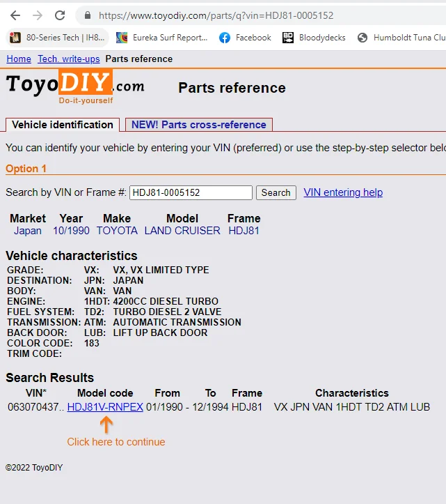

Bryson, that is wicked cool information on the difference in the studs. I used a JDM vin decoder and found this out about the donor Chassis:
I also called and talked to a SLEE representative about just swapping the HDJ axles straight over to my 1997 and was told that there were quite a few differences (apart from the obvious RHD issues) between my axles and the HDJ axles. The Slee rep told me I should just regear and put ARB's in and call it good. He also thought it was very strange that these differentials are 4.56 gears and not something much taller. He commented on how Diesel rigs did not come stock with 4.56. He also admitted that he was not an expert either. Sounds like it would be easier to just retro the thirds into my existing housings. Hopefully the axles shafts are not crazy different or something freaky like that.
Thanks again,
the hdj should've come with 4.10's just like the gassers for the most part. I think a 3.7 was an option in certain areas.

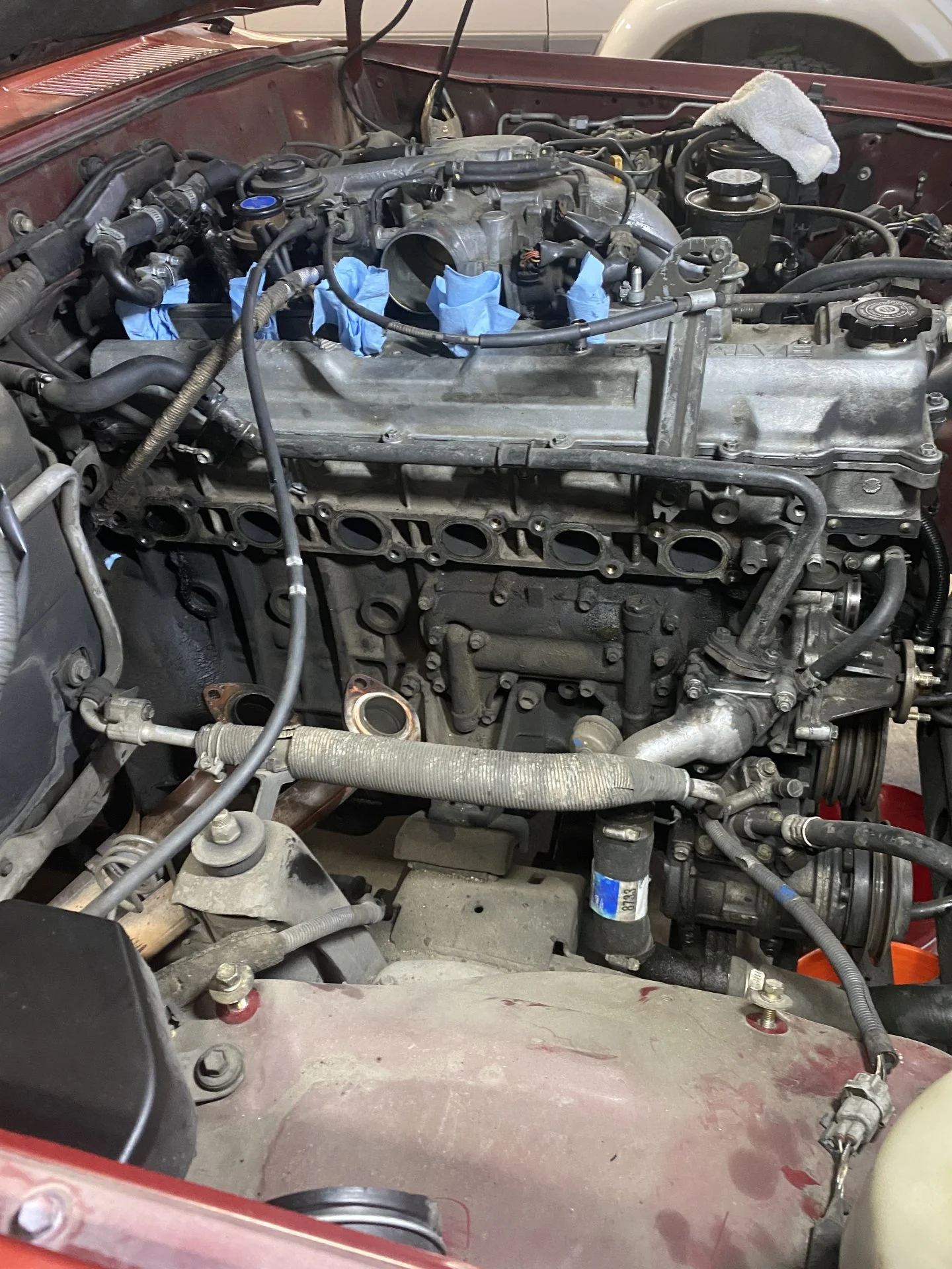

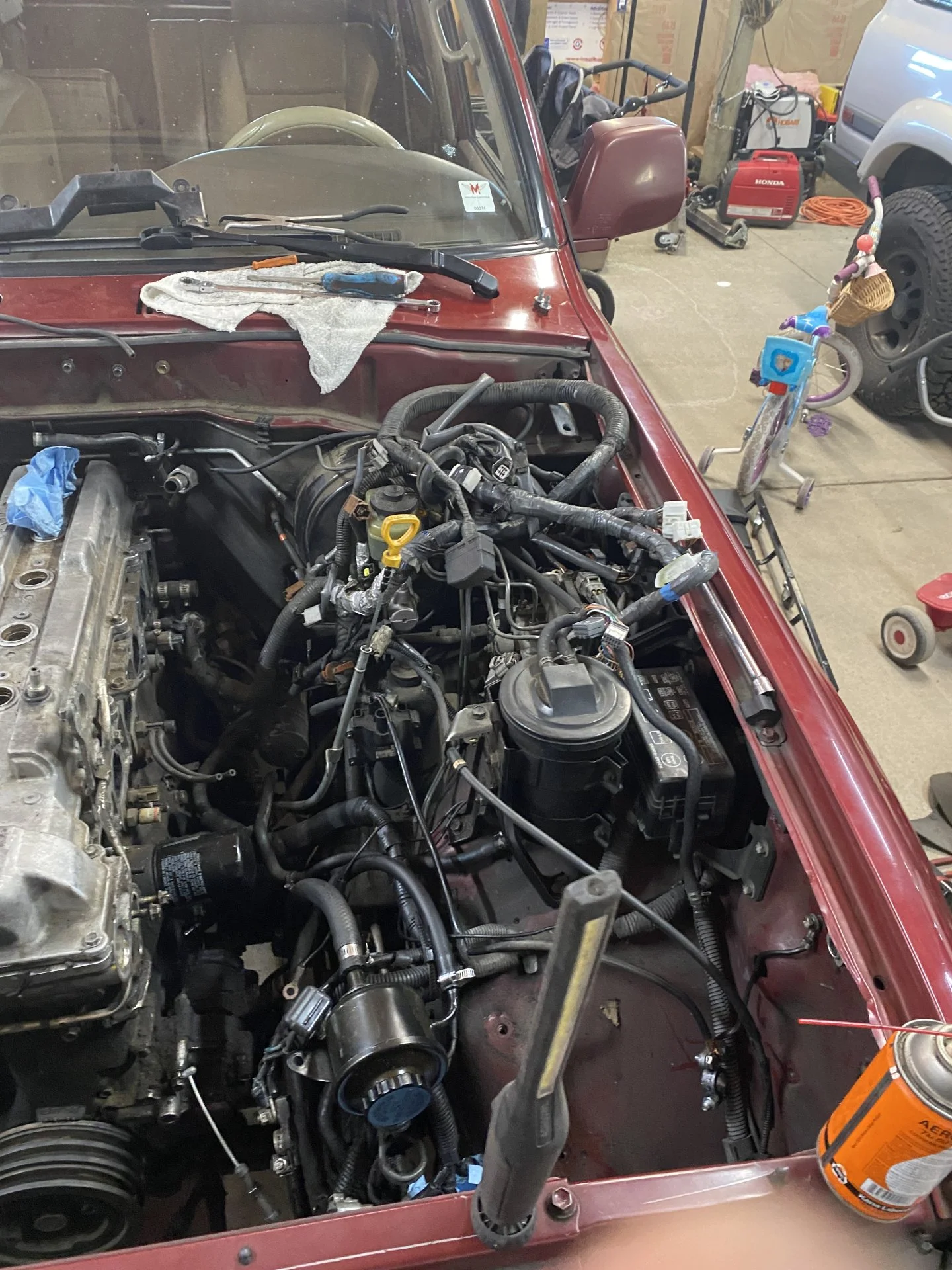

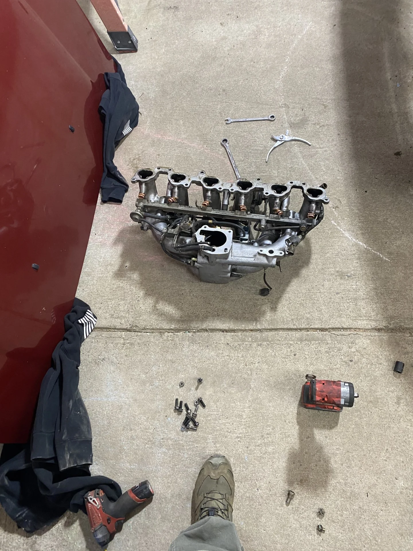

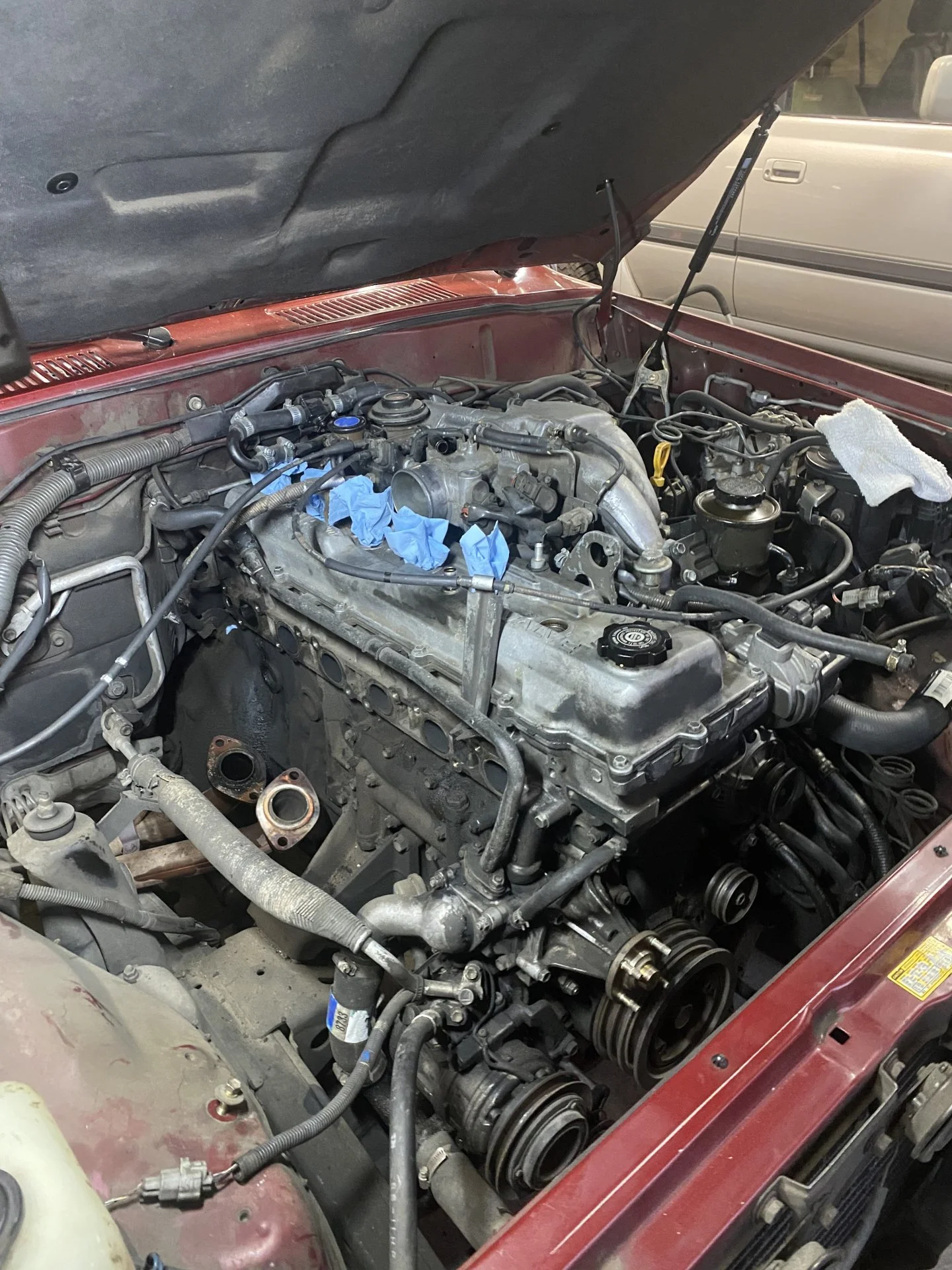

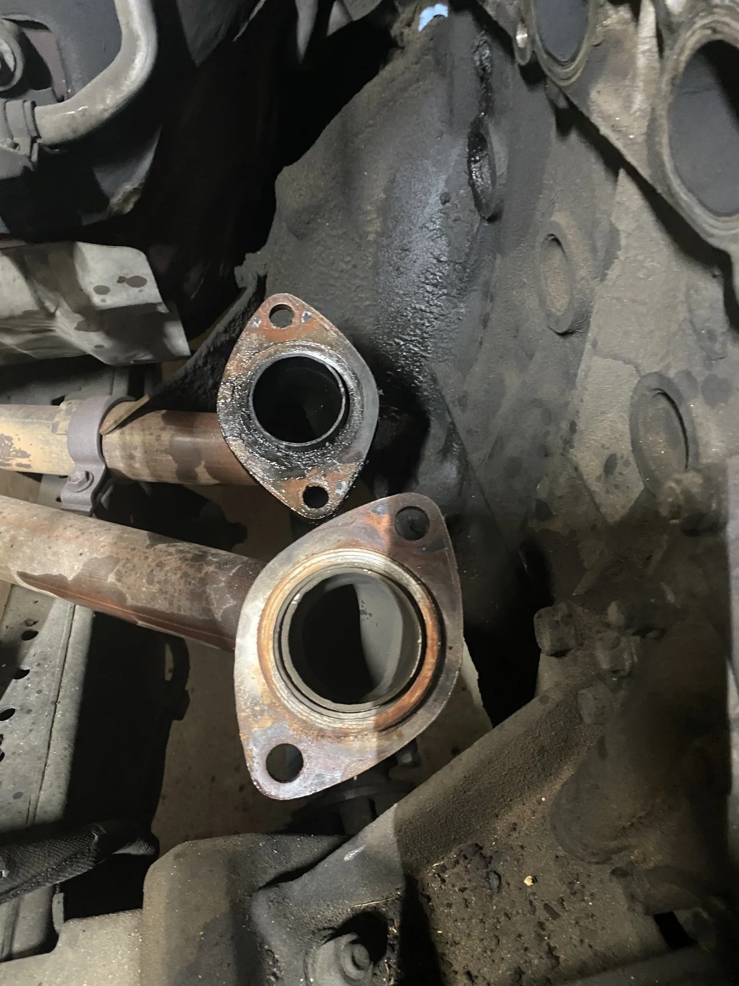

Got the intake off that was fun! 🤬

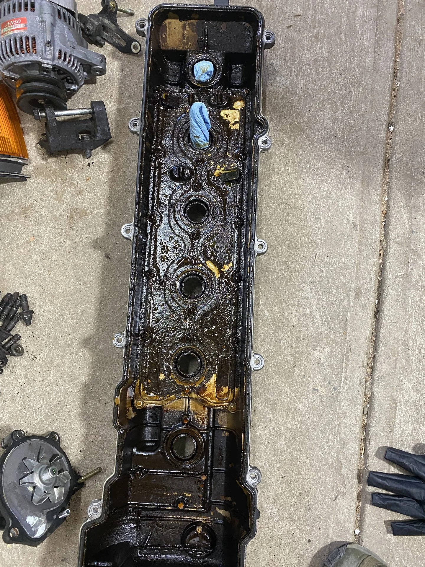

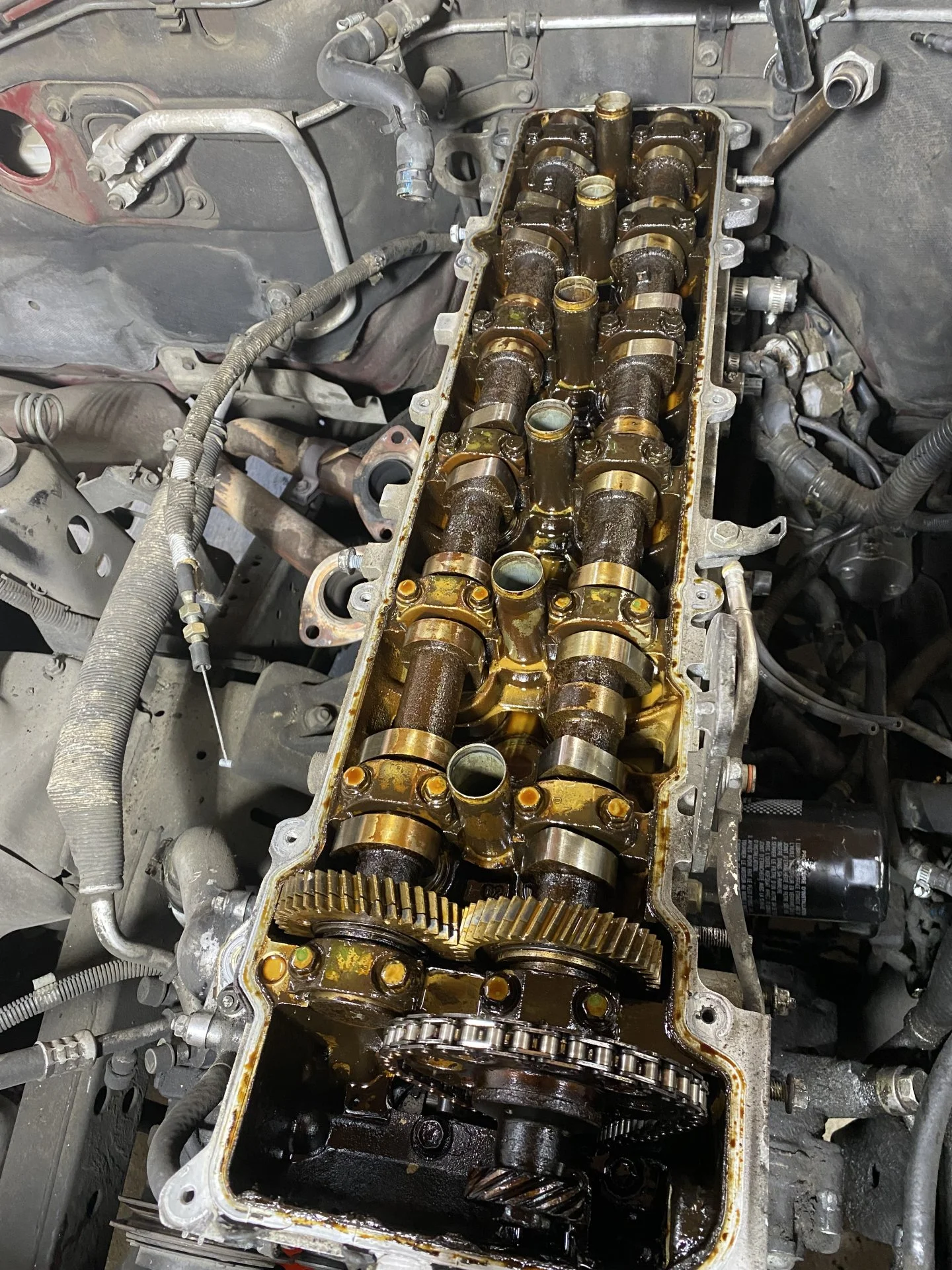

Pulled valve cover and what a mess! Blown head equals milkshake city. my machine shop will hot tank whatever I bring in with a aluminum safe cleaner when I bring the head In To get worked. Hopefully pull head tomorrow and have it back next week.

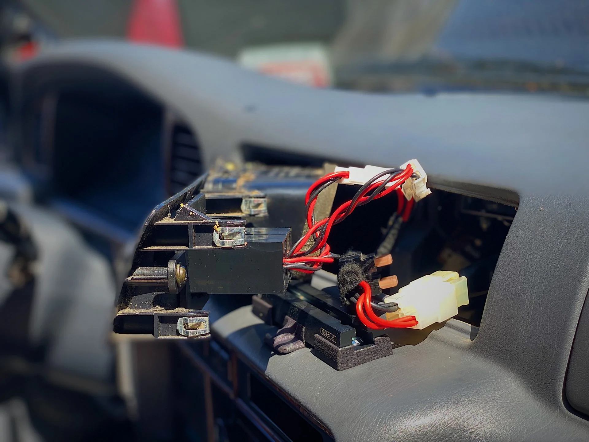

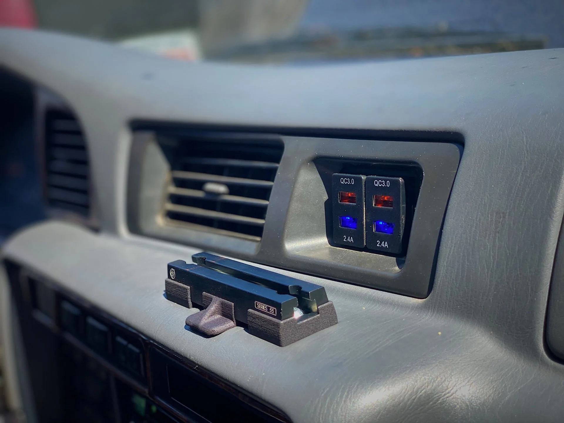

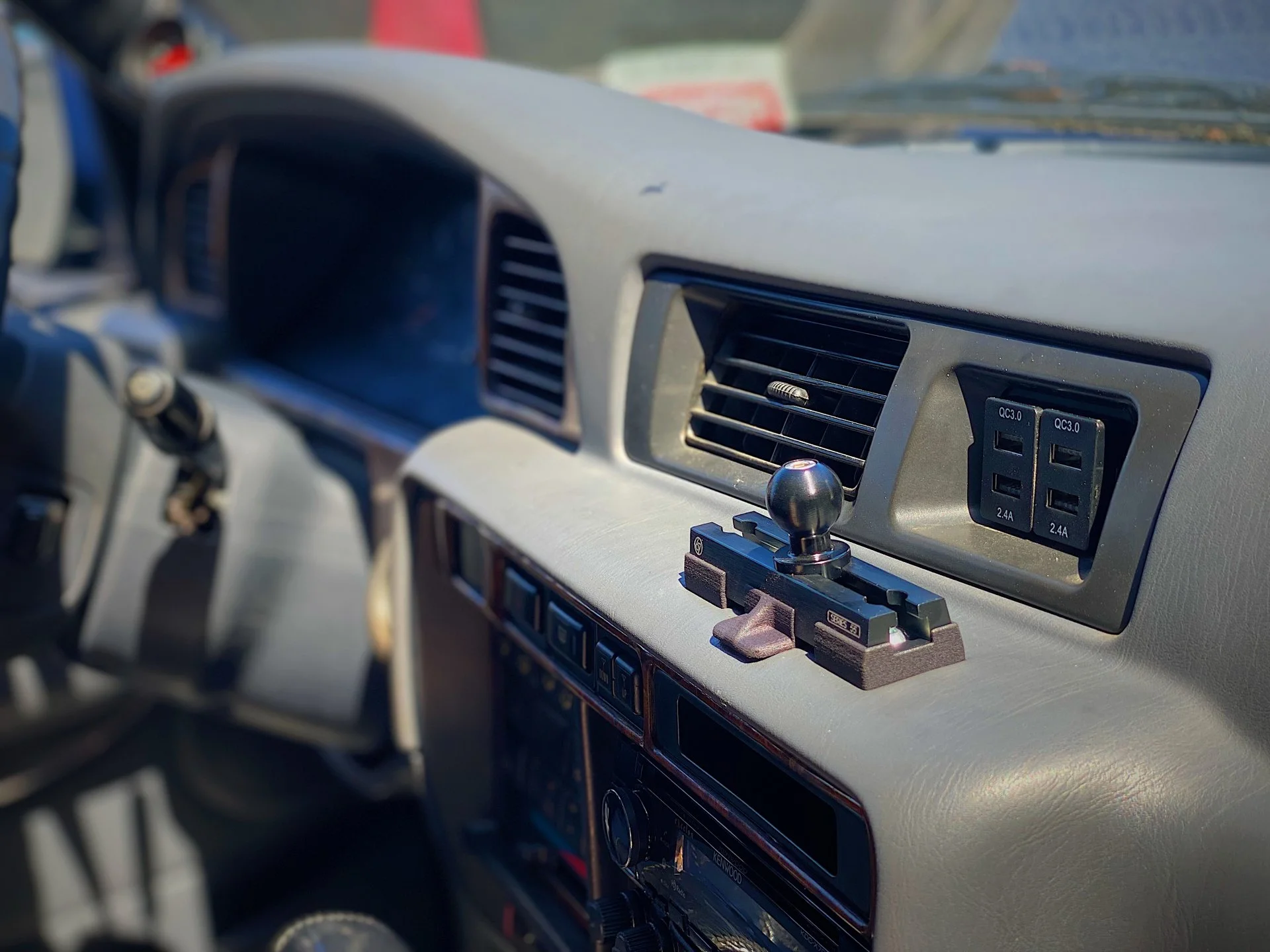

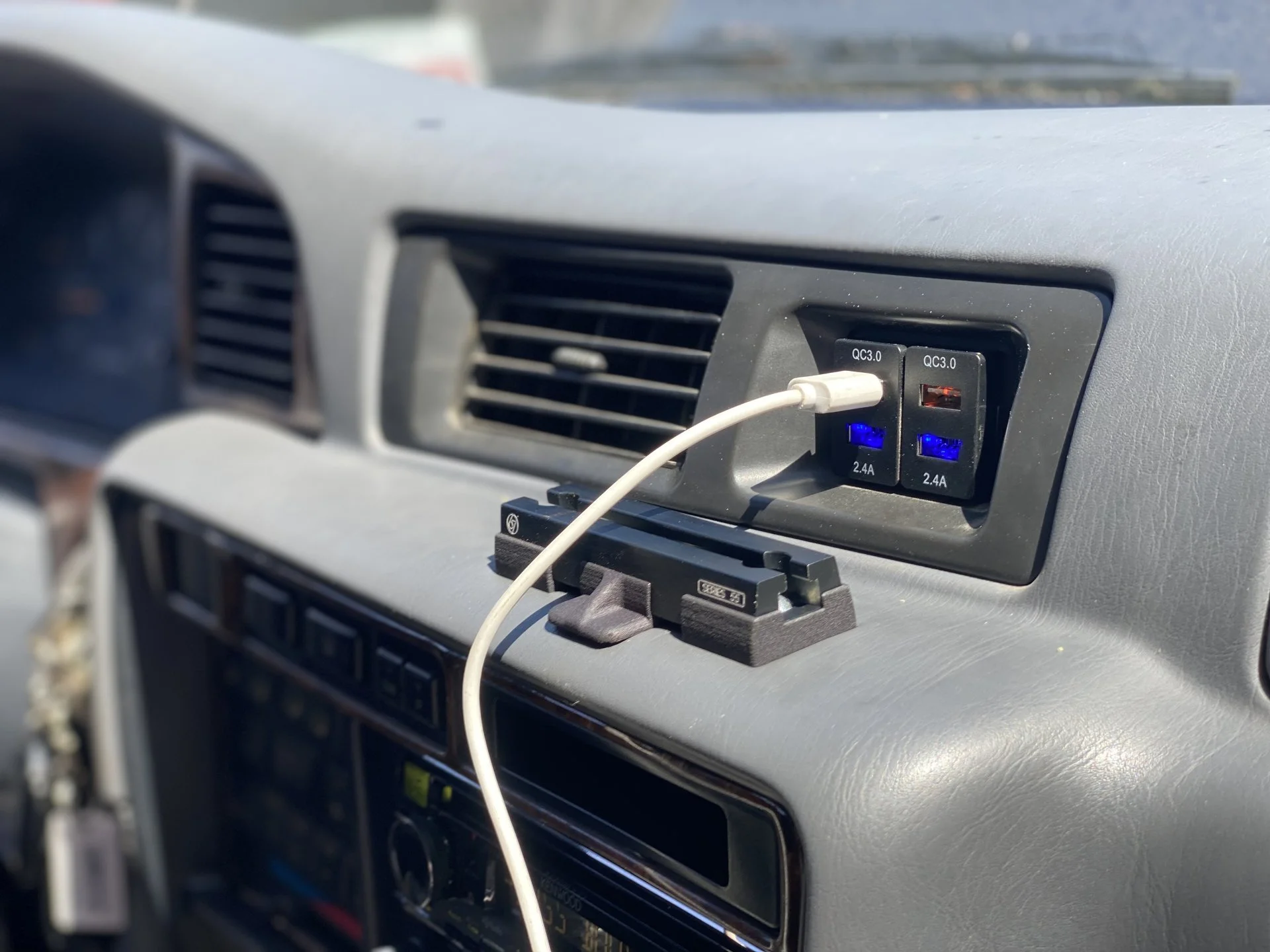

Quick install of some quick charge ports to help with some dash mounted electrical accessories.
Remove the clock, unscrew the clock from the surround. Screw in a plate, and connect the wire harness into the clock wiring.
Clean and easy.

Why did you ruin a perfectly good clock?! It's so useful and so easy to see in the daytime even on the brightest of days. 😜😂. That 67 designs is pretty sweet.
