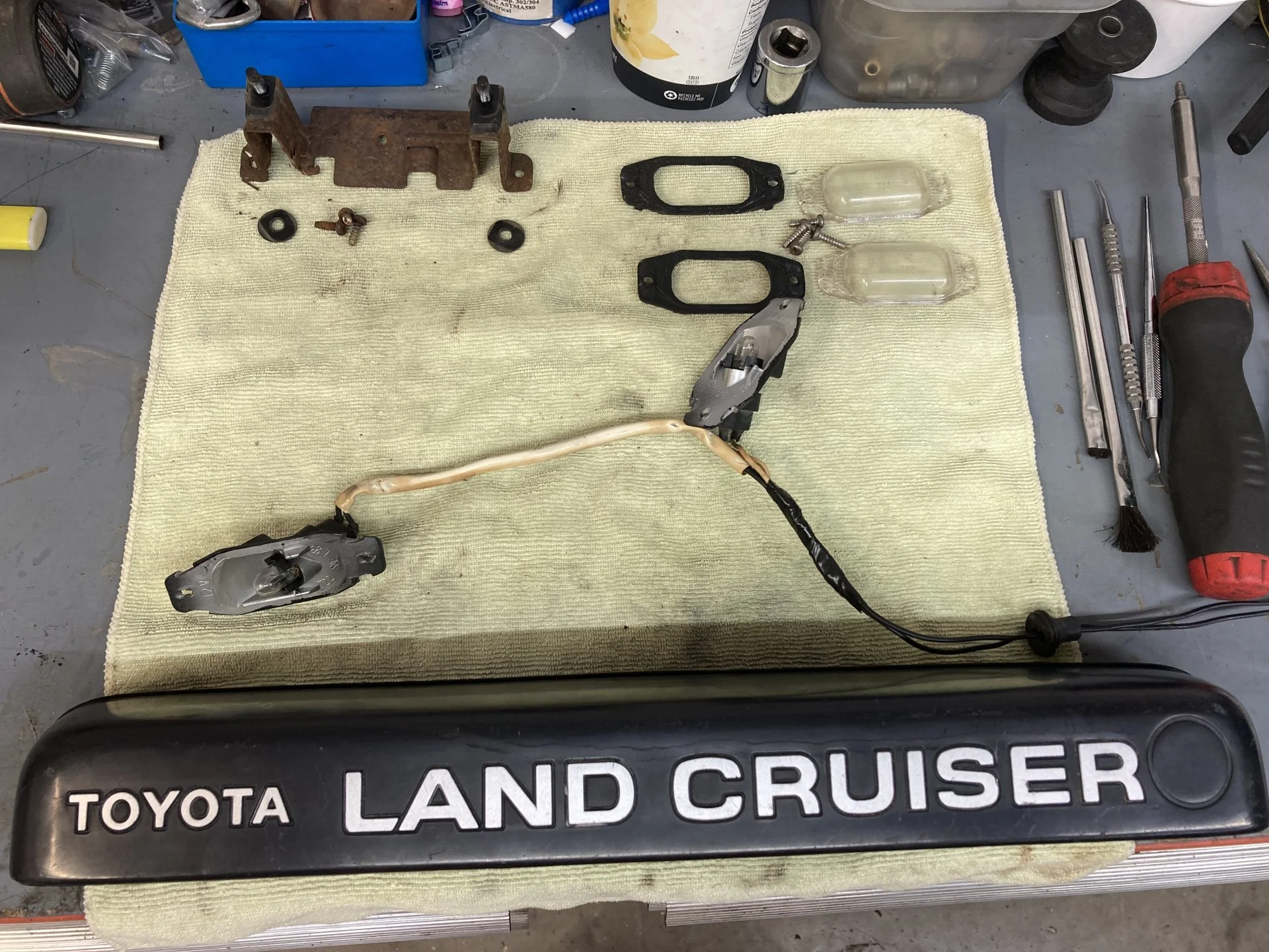

It needed cleaning, now rust removal on one piece

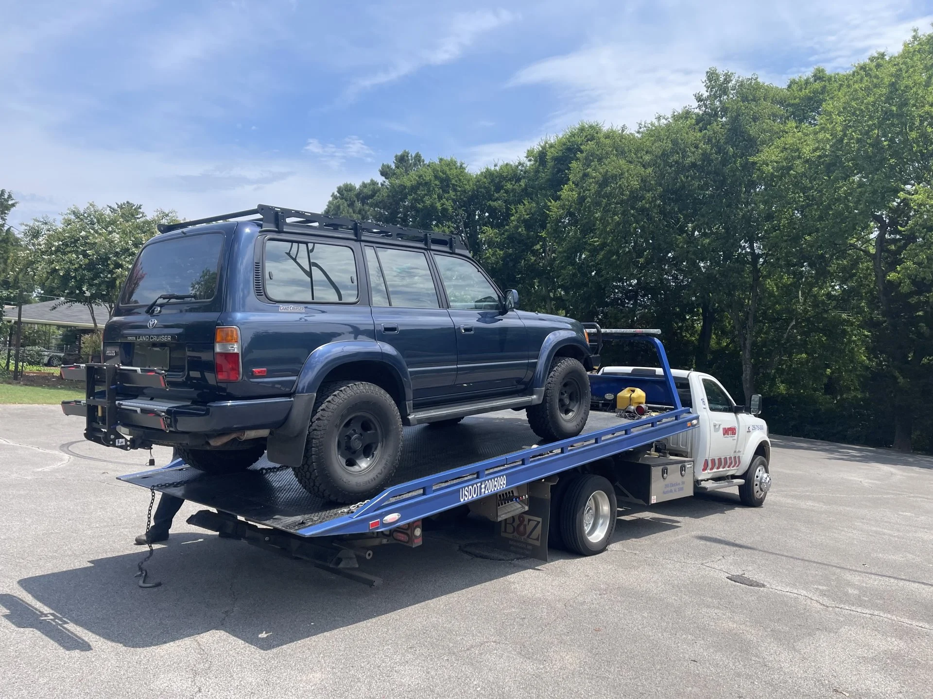

Alternator went out while visiting my folks in Huntsville. Quick mud search while waiting on the tow to figure out where to take it. Huge thanks to Rory with Rocket City Cruisers who answered my call on a Saturday. Lucked out as a bunch of guys from the local club were wrenching at his shop. He had me back on the road in < 1.5 hrs from breakdown (including the tow there)

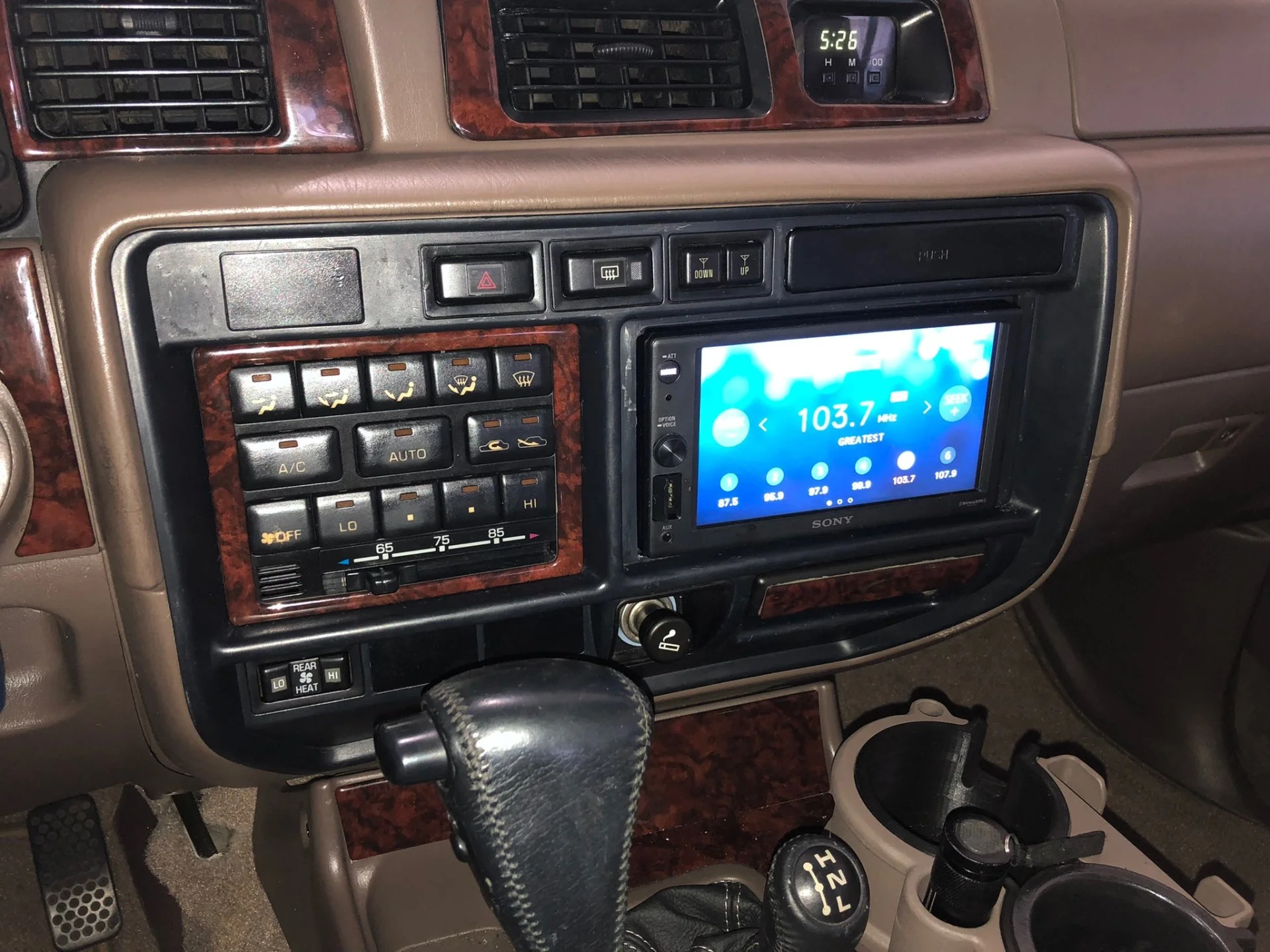

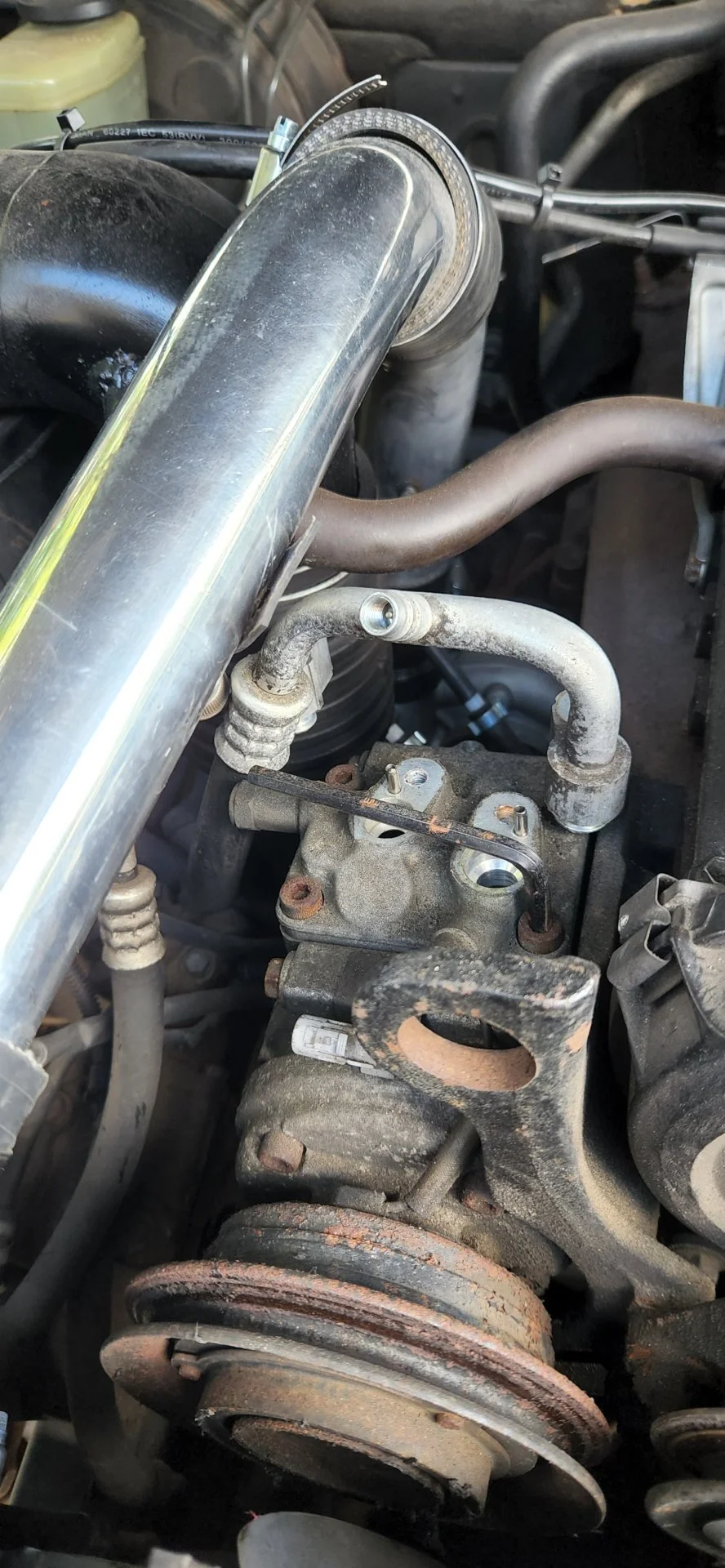

Got the new double DIN head unit installed. i went with the Sony XAV-AX1000 based on some decent Mud reviews (it was also on sale at BestBuy)
I thought it would be a 1-2hr install but ended up taking me 4hrs as the PO had cut off all the oem stereo plugs and had a spiders web of wires connected to the single DIN stereo he had installed. Finally got it all sorted out and the sound is great out
My only remaining issue is the a/c compressor is not kicking on now and it was working fine before I started the headunit install. All the controls on the instrument panel are lighting up and seem to be working fine... the blower works fine... and automatic temp control calls for heat and blows hot air when I slide the temp up. But nothing I do will get the a/c compressor to cycle on. I even replaced ALL the fuses in the fuse block just to be certain that was not the cause. At this point I’m open to any and all suggestions! Very Frustrating!!!
View attachment 3055030View attachment 3055034
I don't believe in coincidences, pull the head unit and check the wiring. You messed something up while you were in there. First thing I would check is the AC switch....

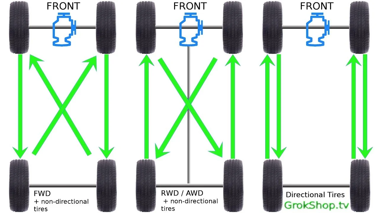

Also rotated the tires as well. Using the picture below and the middle reference we will see if my wobble will go away or reduce the issue.
Really need to get new tires and alignment done to check "toe" as well.

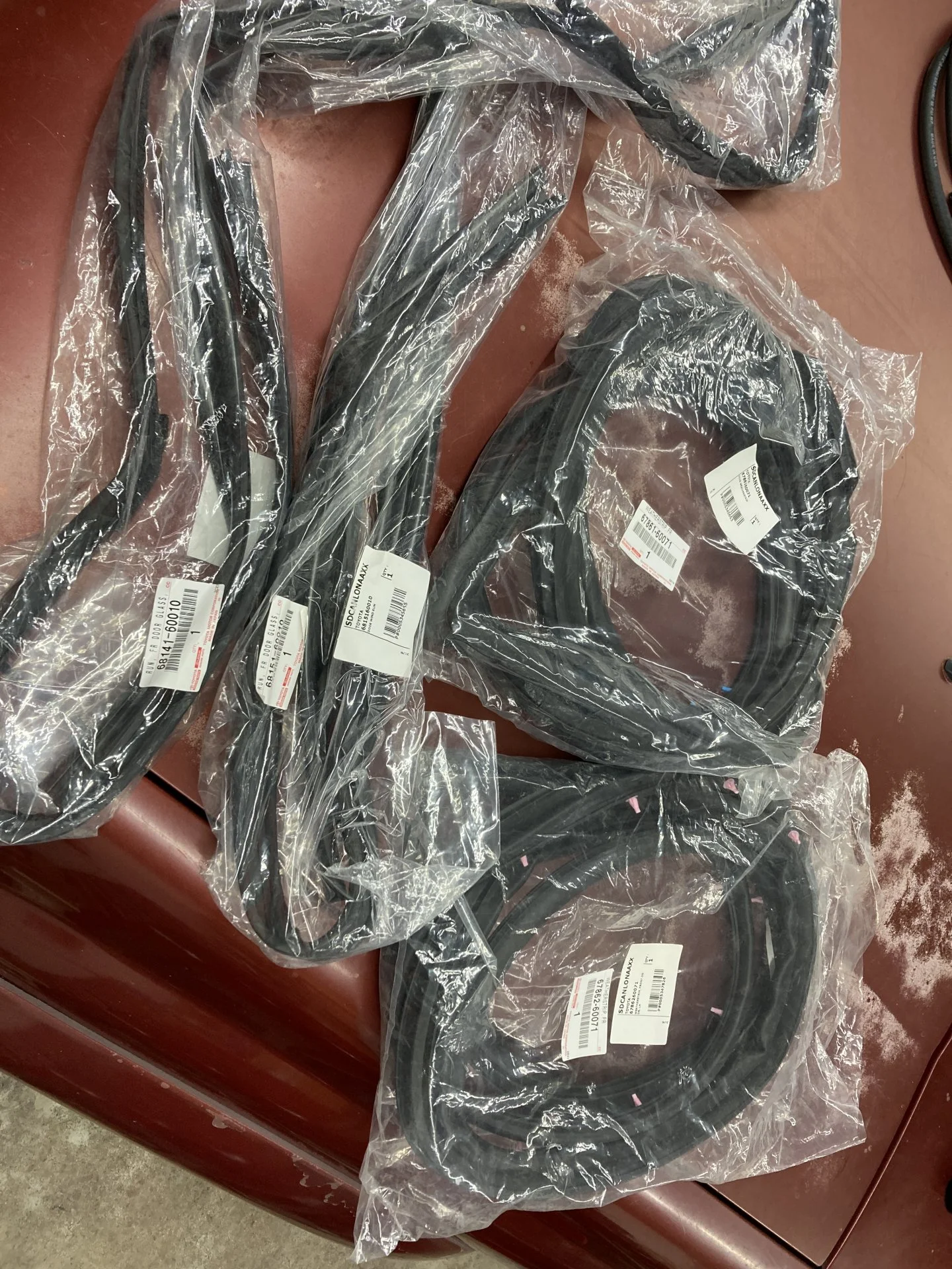

Todays job
Hoping for faster windows and less wind noise as current door seals are no longer soft and flat in some areas.

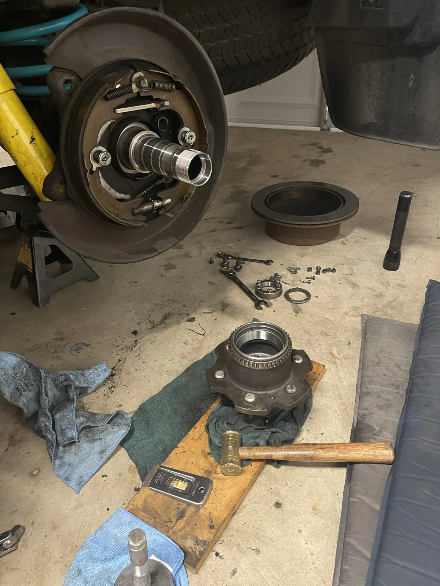

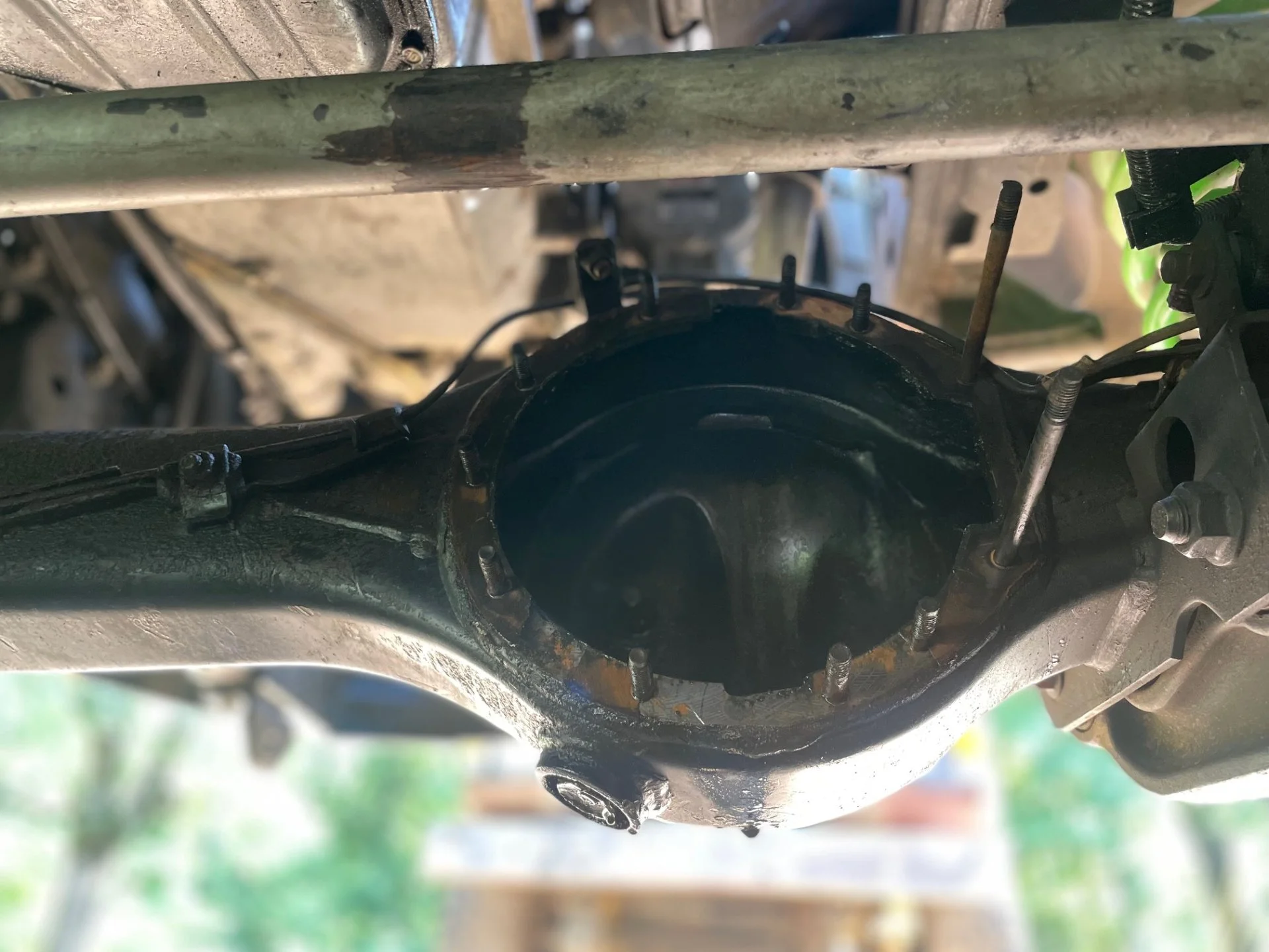

Last step in ridding the 80 of driveline vibrations. Rear diff has been rebuilt by OTM @Bama4door , t-case replaced with lower mileage unit from @slow95z , front diff was pulled this weekend for a rebuild. FSM states that with a locking diff it needs to be locked before pulling; FMS ain't lying. I had to strip down the passenger side knuckle to reinstall the axle shaft, goes quicker the second time.
