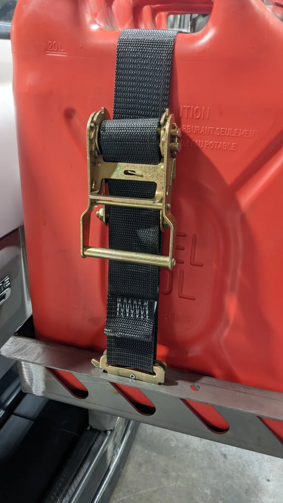

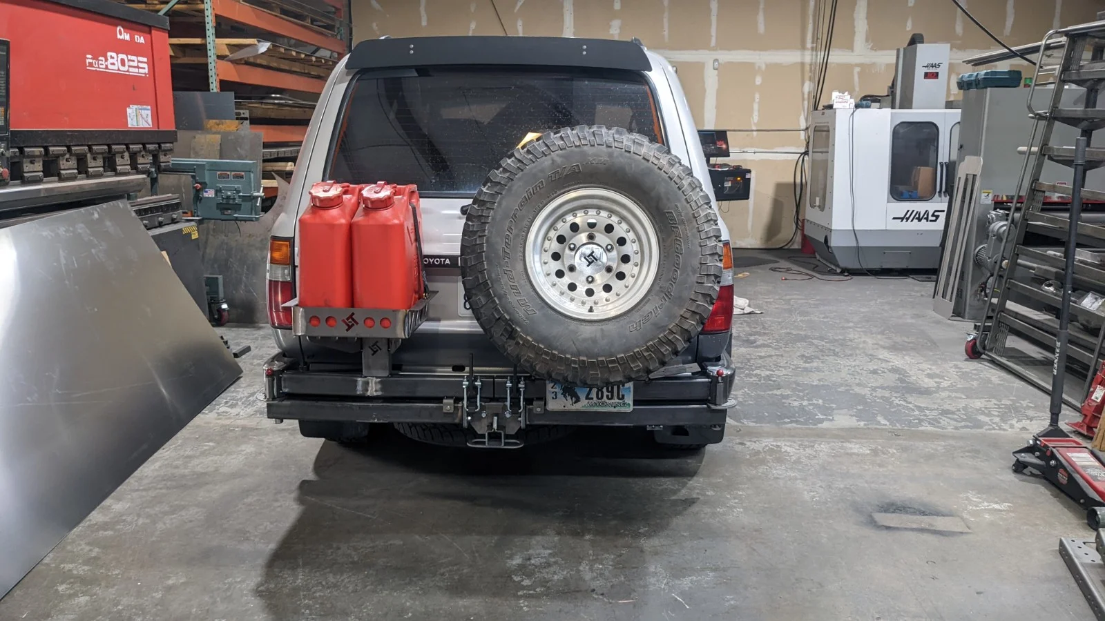

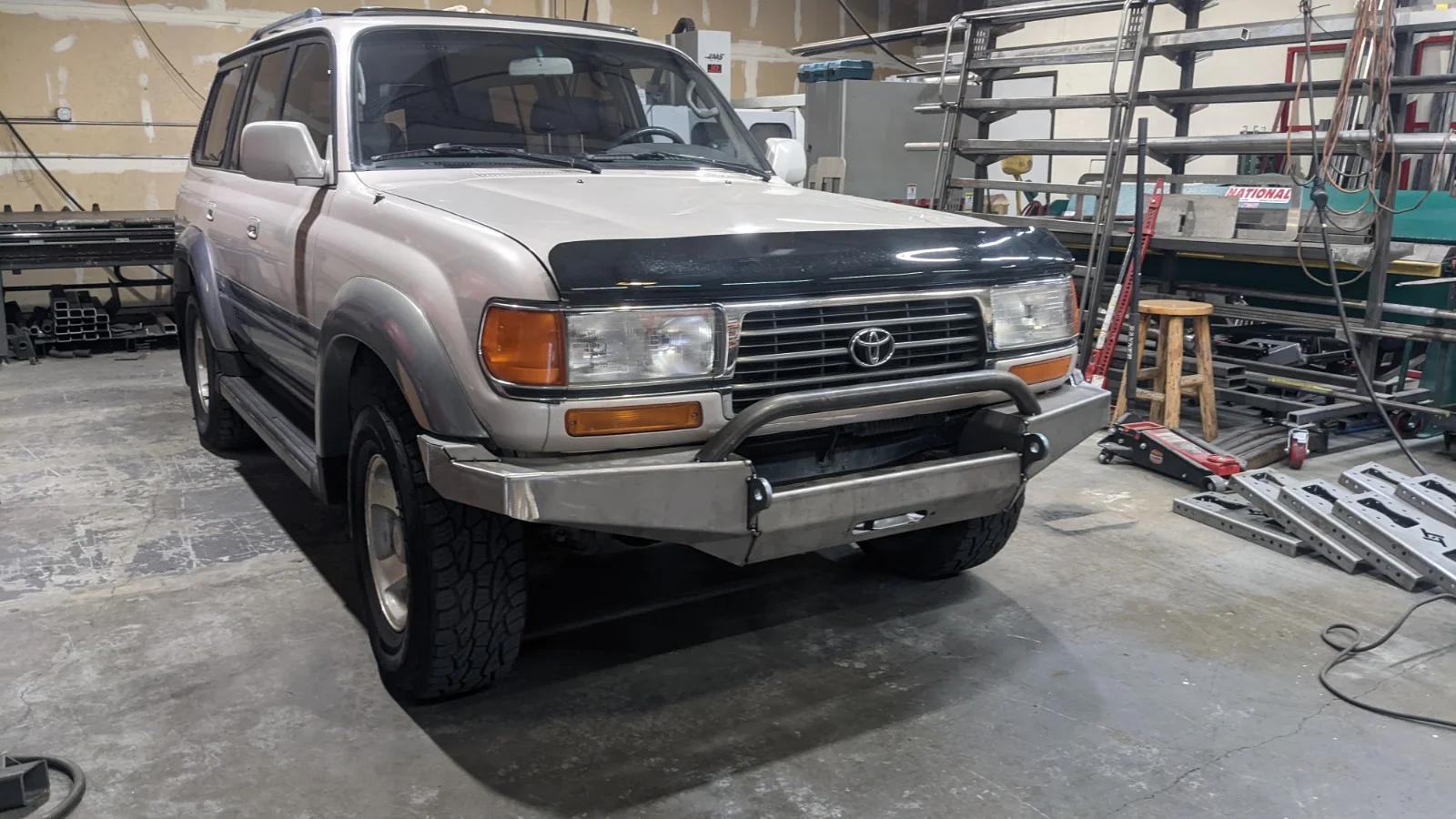

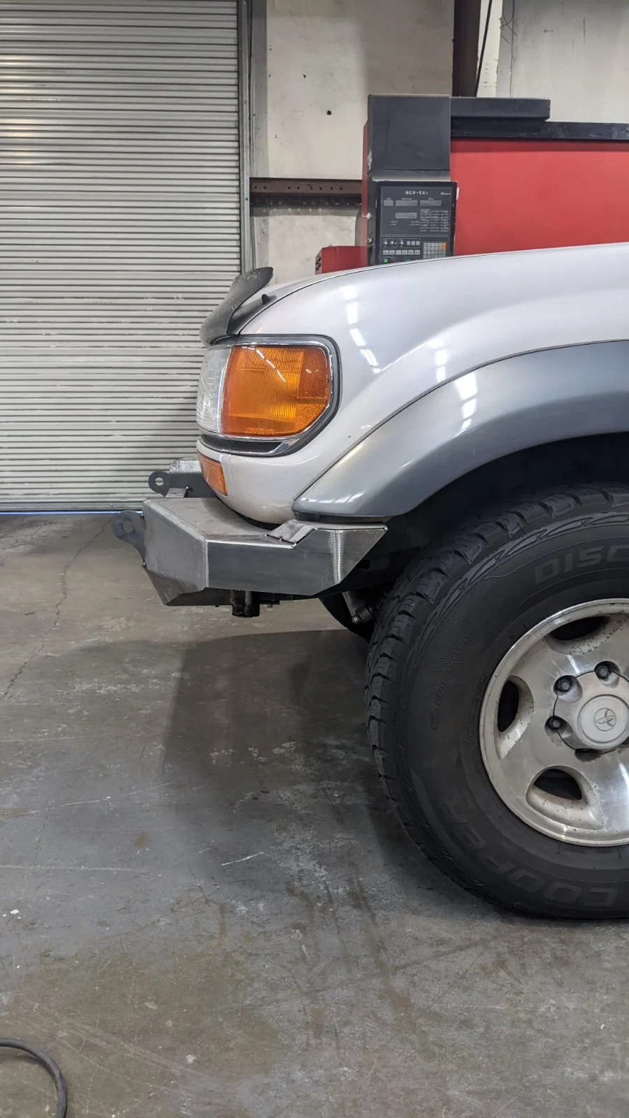

and............. jerry can carrier arm complete for those that have asked and started on a short batch of front bumpers.
Jason

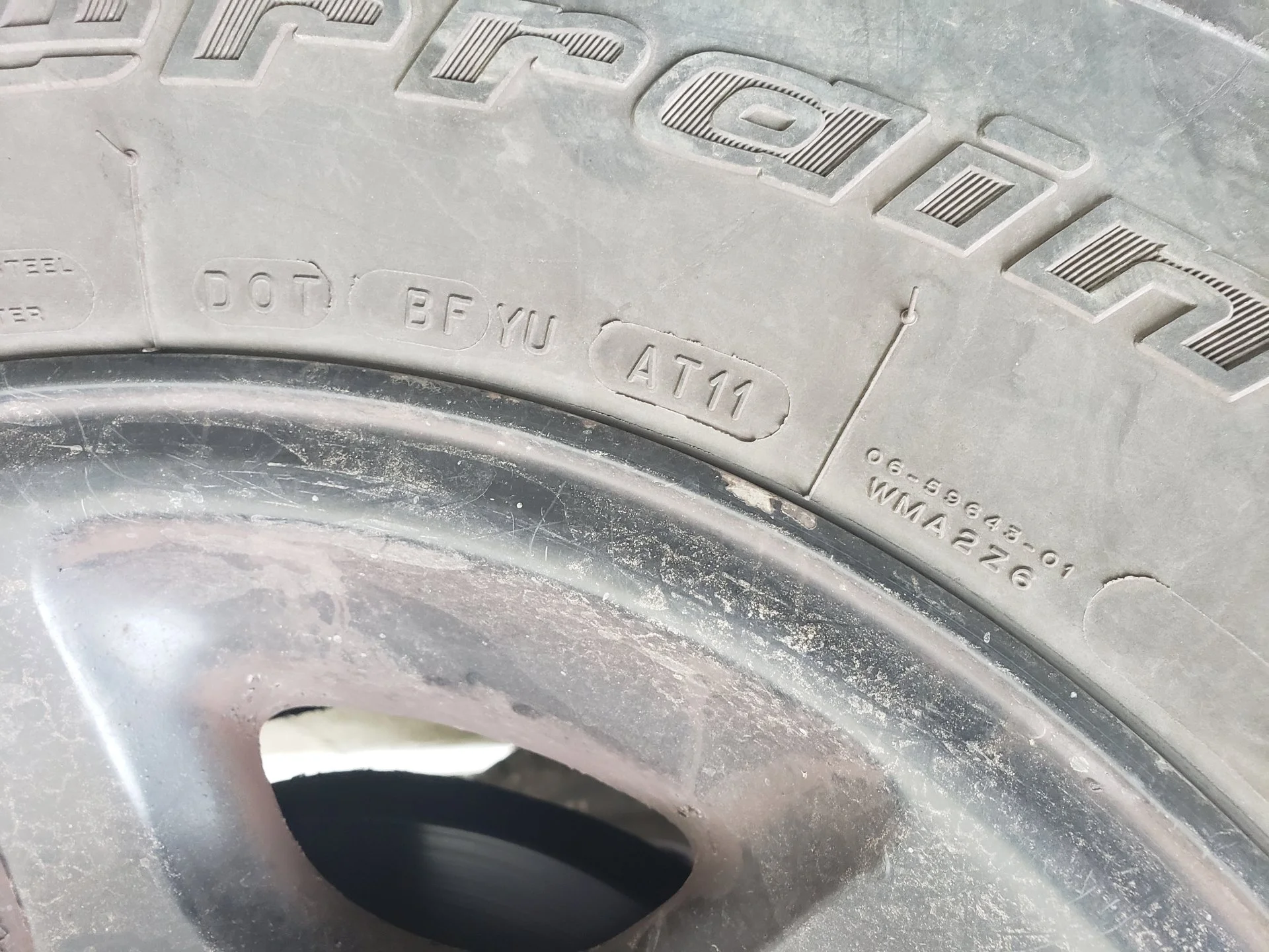

it will be 4 numbers kind of stamped into the tire, usually in an oval or circle
For example "1320" which indicates the 13th week of 2020.

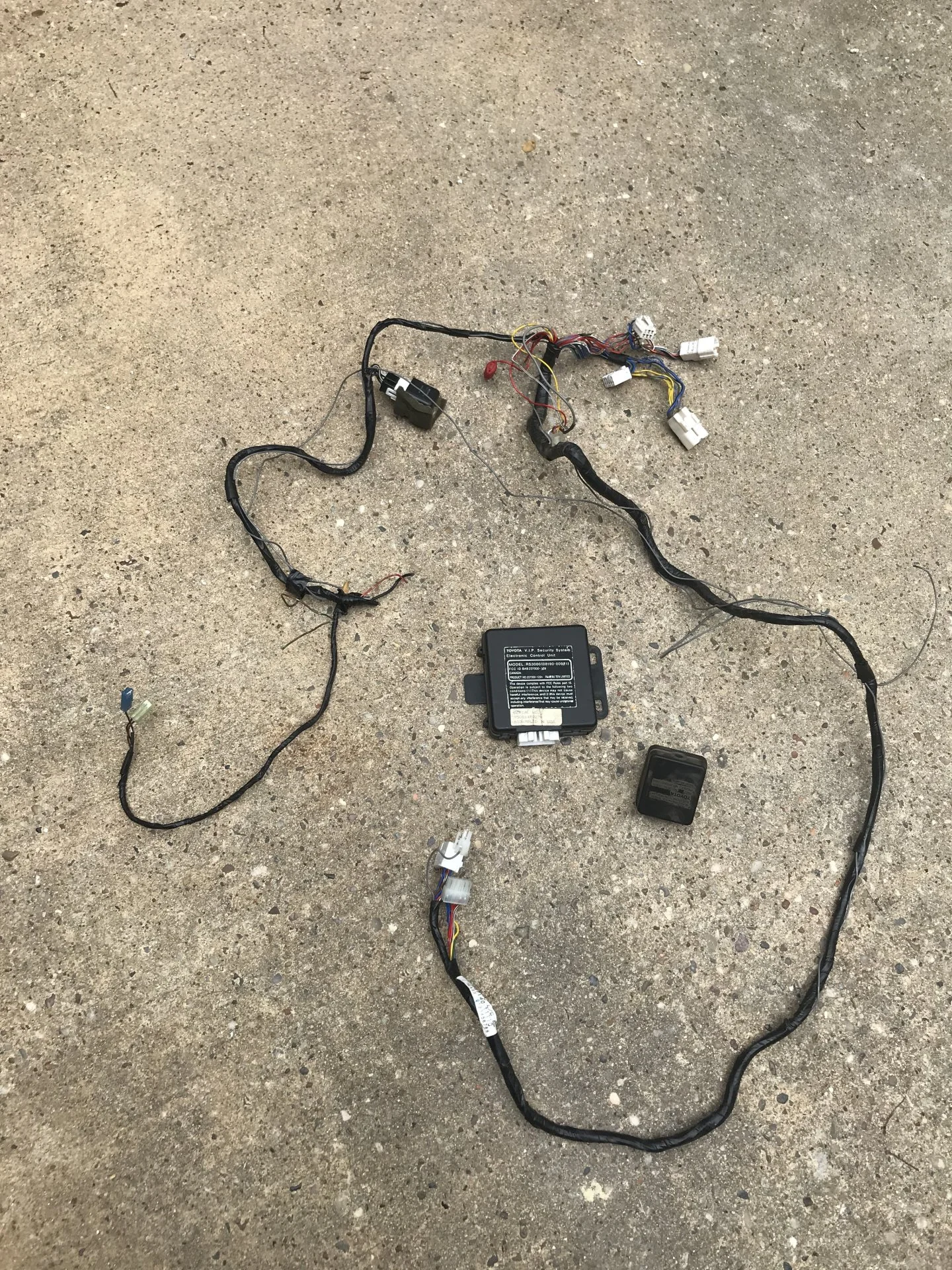

I asked for a selfish reason. I want that controller for my wife's truck...:lol:
I have one that I pulled because it decided to lock me out one night at a restaurant.
I have never owned a key fob and only ever used the key, so I unlocked, let the alarm go until I unhooked the battery, allowed it to clear for 10 minutes, hooked up the battery and drove home.
Then I immediately proceeded to unhook it and remove it 100% from the system.
