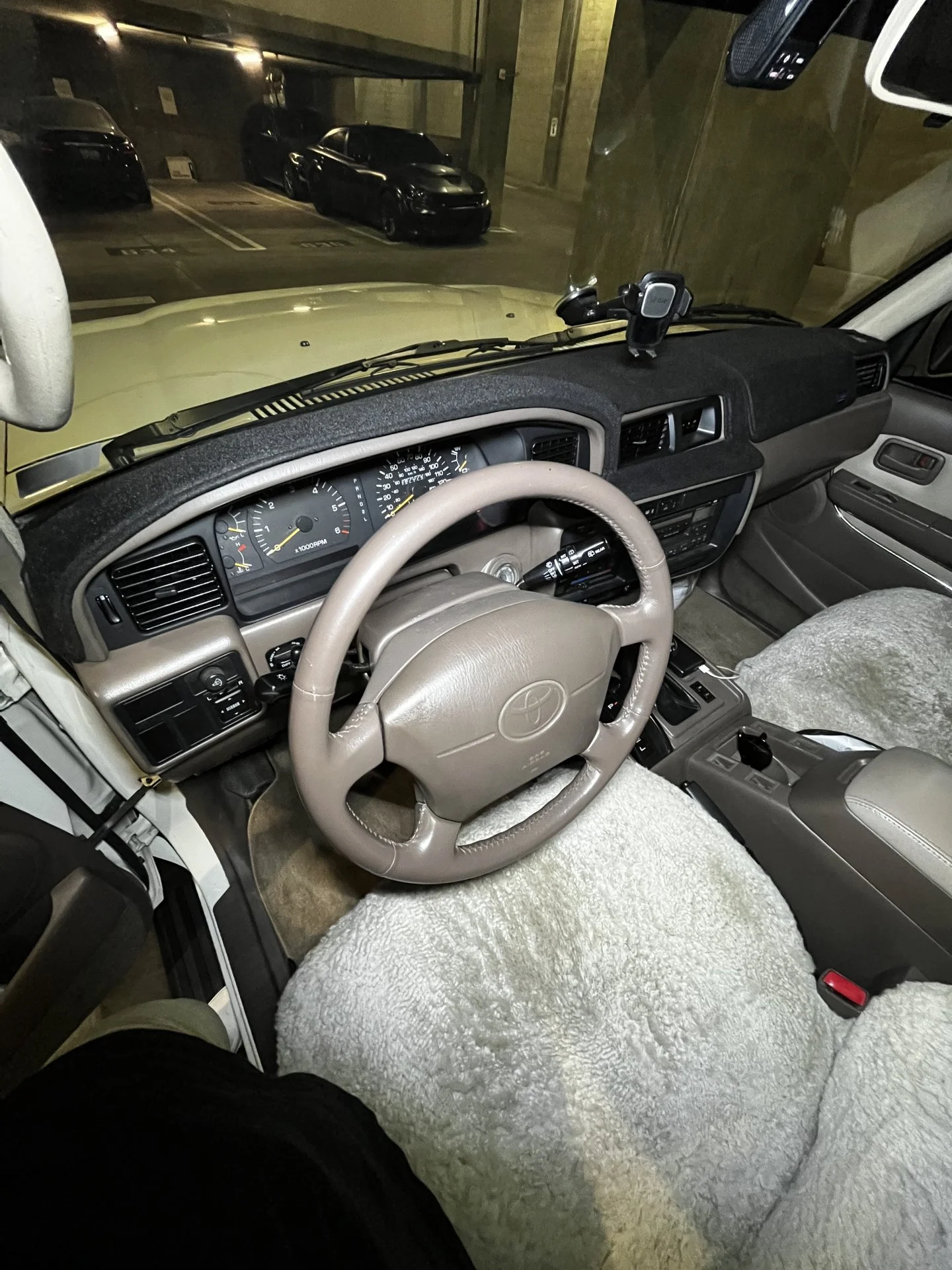

24 years no cracks, just dash fade. Originally a Seattle car. Want some protection here on out.
The dash mat look is growing on me just like I never thought I’d grow to appreciate sheep skin seat covers.
Black is the only color I’d go with. Nice and flat, too. I ain't scared of no ☀️.
Can you share where you bought it?

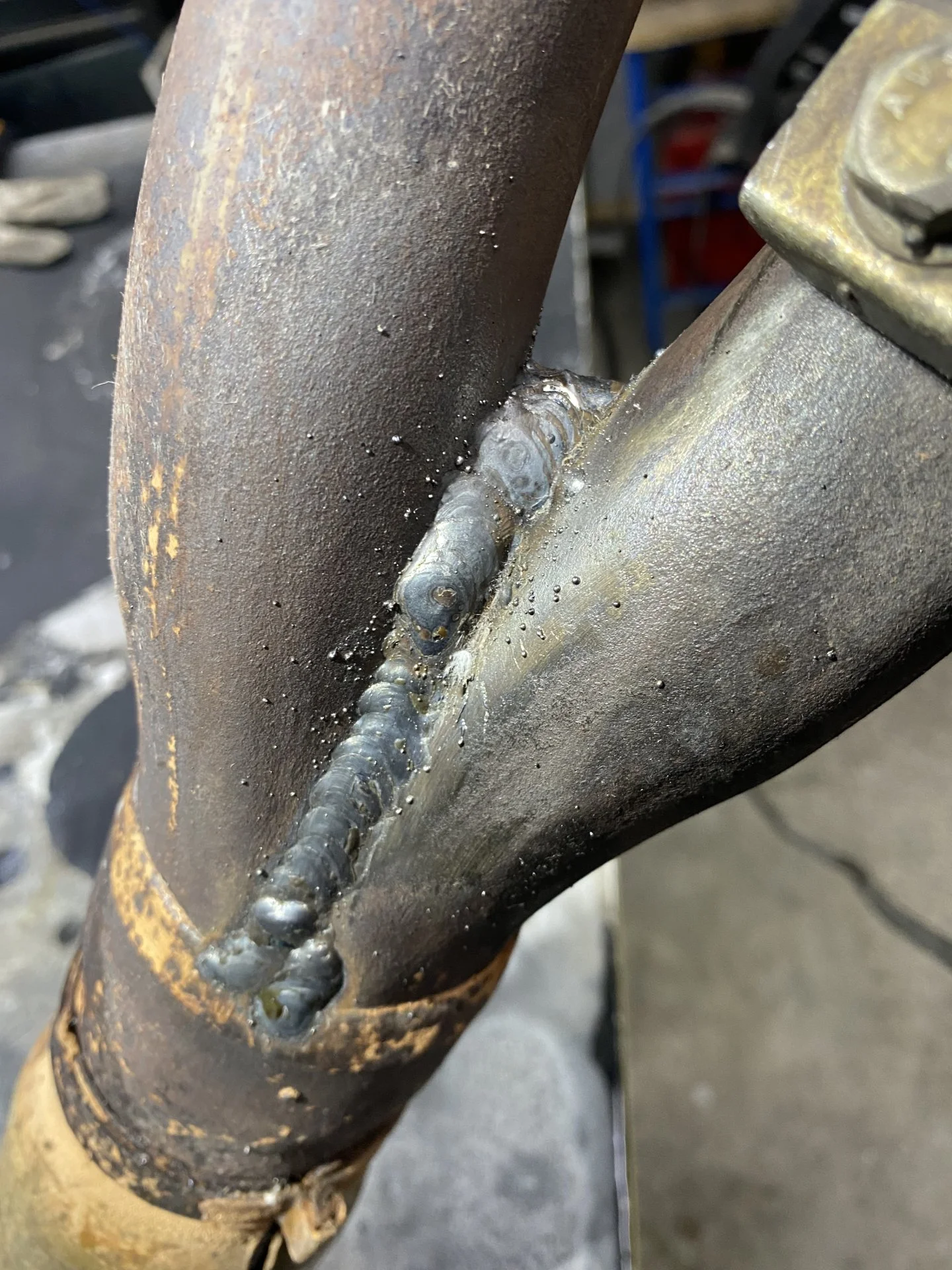

Got rid of my P0420 code by fixing two exhaust leaks I found. One between the cats and one at the Y-pipe "crotch." New gaskets between the cats and I welded up the Y-pipe as best I could. Stuck my leaf blower up the exhaust pipe and zip tied the throttle wide-open and sprayed the exhaust with soapy water. You’ll find any leaks! Neighbors may look at you funny though.

As if this would be the only reason my neighbors looked at me funny....

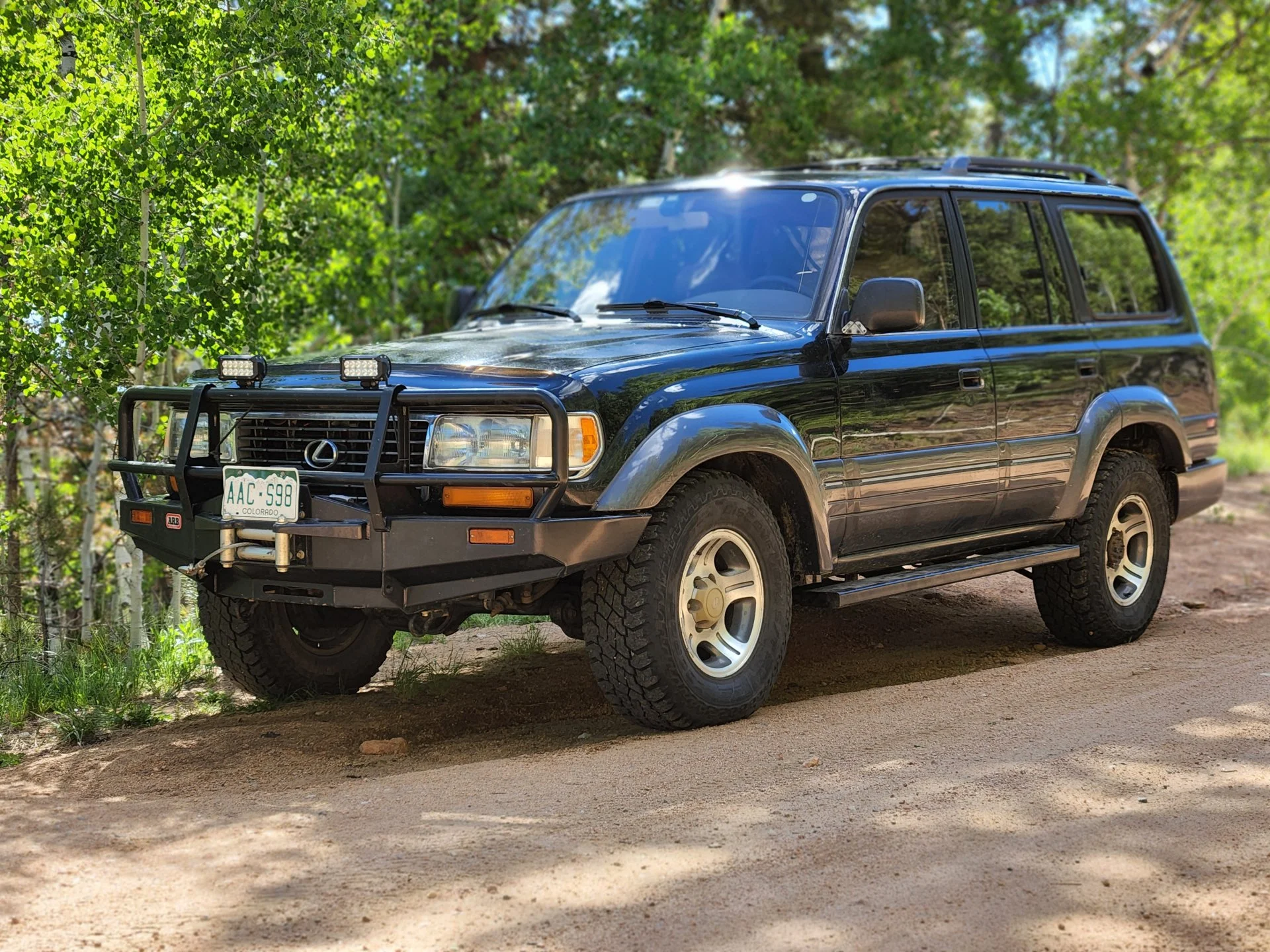

Those look great! I really would love to have the BOR step sliders, but alas he only makes them for '95 and later (mine is '94). Presumably because the cat is in a different spot. I even reached out directly to see if he's make a one-off, but he declined and suggested I look at other vendors. :( Guess it will be White Knuckle for me at some point.
