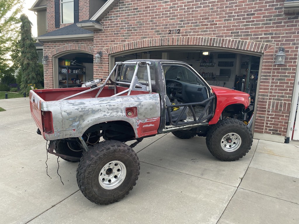

My 80 has sacrificed its spot inside the garage for the past month or so while I've been working on this thing with my son. Finally pulled the minitruck out of the garage last night (temporarily) and the 80 was moved back in for some routine maintenance.
Untitled by Adam Tolman, on Flickr

Interesting roll bar. What's the the concept behind that design?
The idea was that I just wanted to do something different and a bit more unique but still functional. I like the lines of a lot of prerunner bed cages so this was inspired by some of those like this one pictured. Most prerunner cages are cut into the rear of the cab. I didn’t want to do that which is why there is a main hoop behind the cab. Most also have a horizontal tube connecting the two sides at the lower junction in the legs. I didn’t want that horizontal tube in the way of using the bed space so instead of that I added some support to the legs with the plates that connect to the main hoop. I could have done that with a tube but the plates have the “look” of plated upper shock mounts on prerunners. So I did the plates partly for that aesthetic but also to add the support where I wanted it.
This truck isn’t a dedicated trail rig and will occasionally be used for regular truck stuff around the house so I wanted to be able to have a completely empty bed at those times so there are sleeved connections at the top of the main hoop and where the plates connect to the main hoop so the cage can all be removed easily but leaving the main hoop as the only permanent part, kinda like a headache rack.
There are also frame tie-ins under the bed so it isn’t just mounted to the bed. Also we plan to add an in-cab cage too so it should have ample rollover protection.
So yeah, I know it’s different and kinda funky and not everyone will like it but it should function well enough for all we want it to do and it gives the truck something kinda unique instead of looking like all the other minitrucks out there. Long-winded explaination of the chaos that was in my brain while building it. haha
