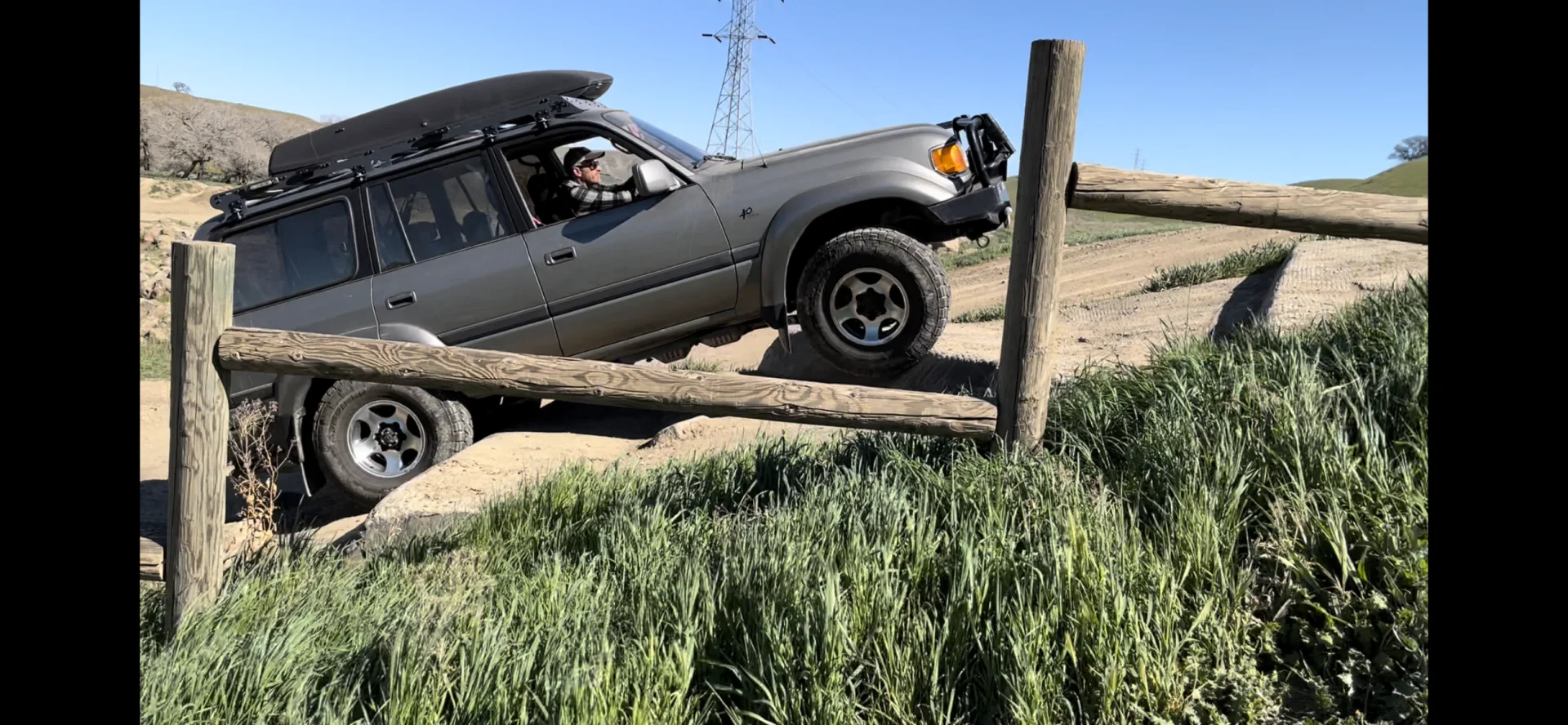

Took the boys to Carnegie OHV.
Good times on the steps. Ran into @Tonkaboy

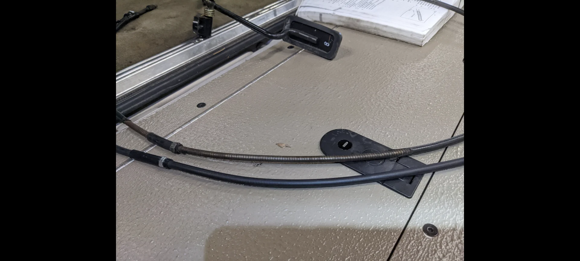

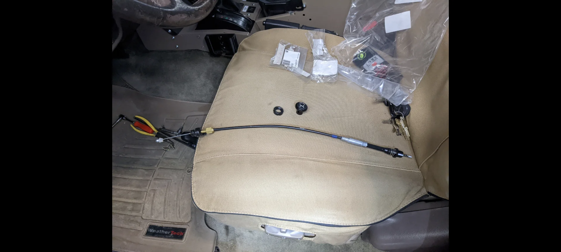

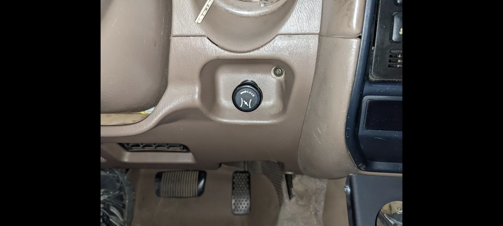

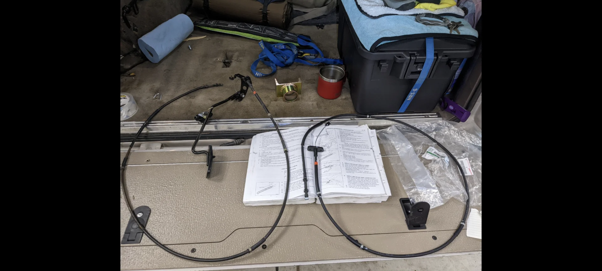

I finally got around to replace the throttle cable, I've had it for months. I also took the opportunity to install the hand throttle as well.
It's pretty amazing how much smoother the gas pedal feels now. I didn't realize it would make such a nice difference.

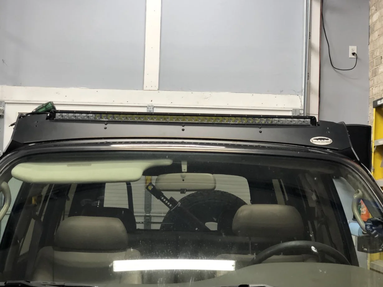

Mounted a light bar on the Bowfin rack - had to notch the front panel a bit to accommodate the width of the bar but otherwise unremarkable install. Now for the scanstrut gland to get the wires through the roof... Anybody have a preferred location (i.e. front of roof, back of roof, etc.)?

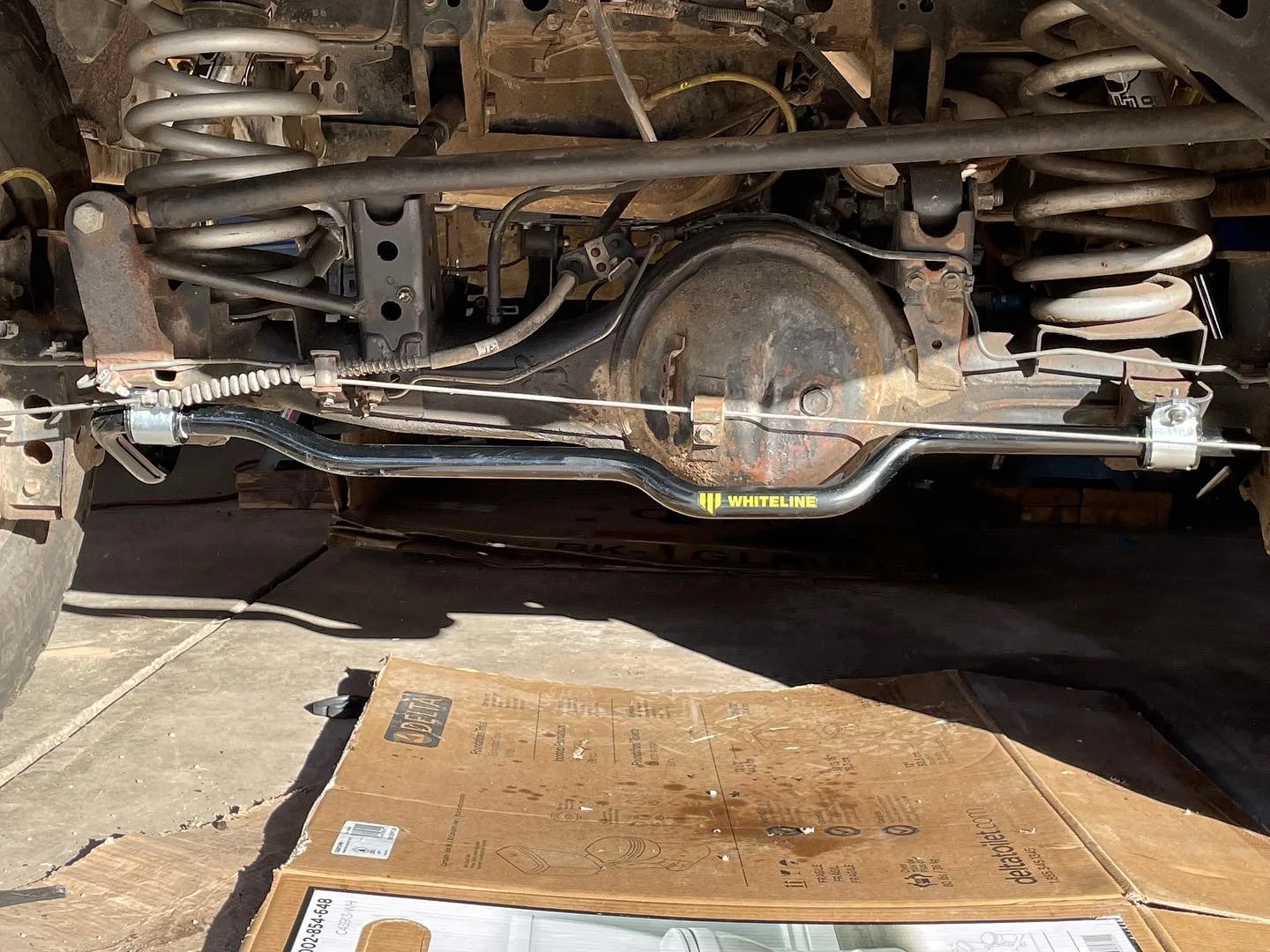

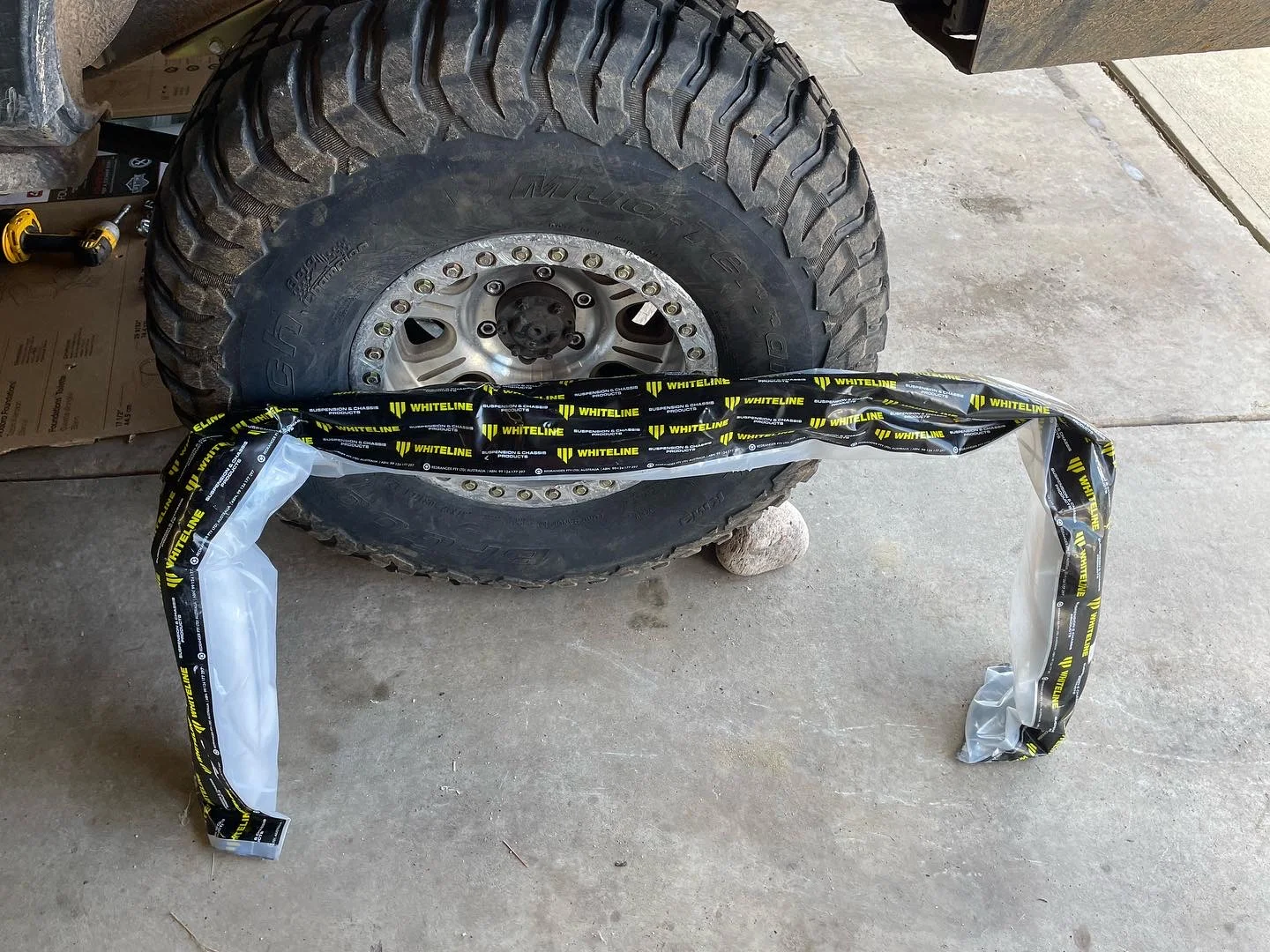

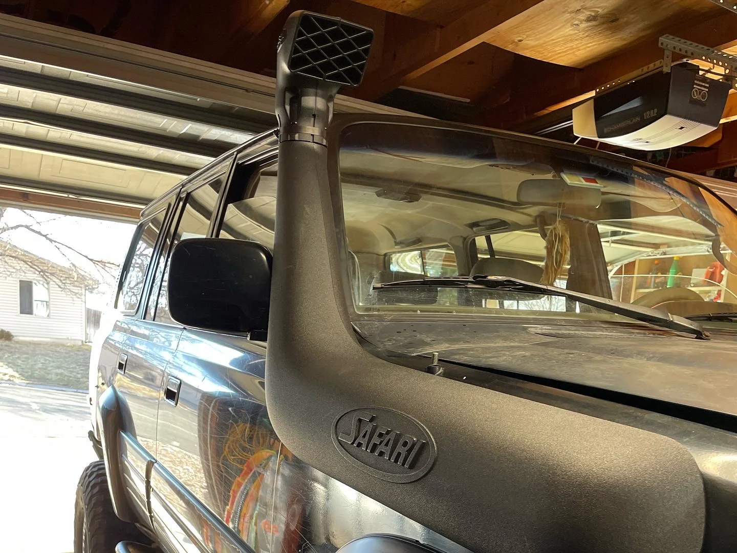

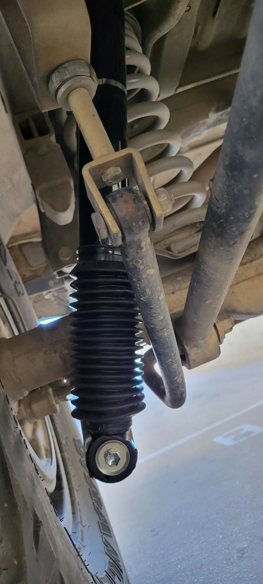

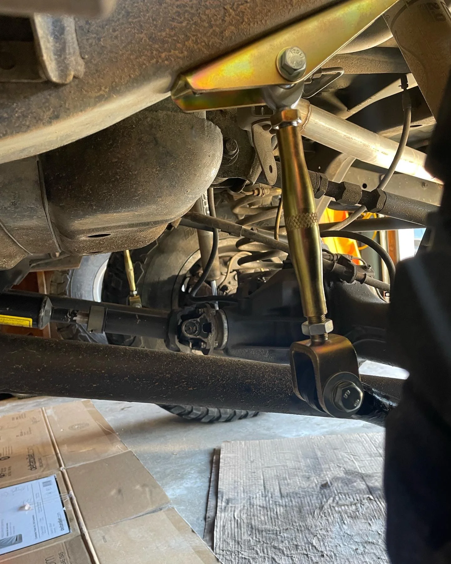

Installed the 30mm whiteline sway bar. @LandCruiserPhil sway bar end links, and a snorkel to get my LS intake temps down to. A more respectable temp.
End links still need to be fine tuned. Waiting on my coilovers to be finished up at the rebuild shop. Once it’s back on all 4’s I’ll finish the end links.

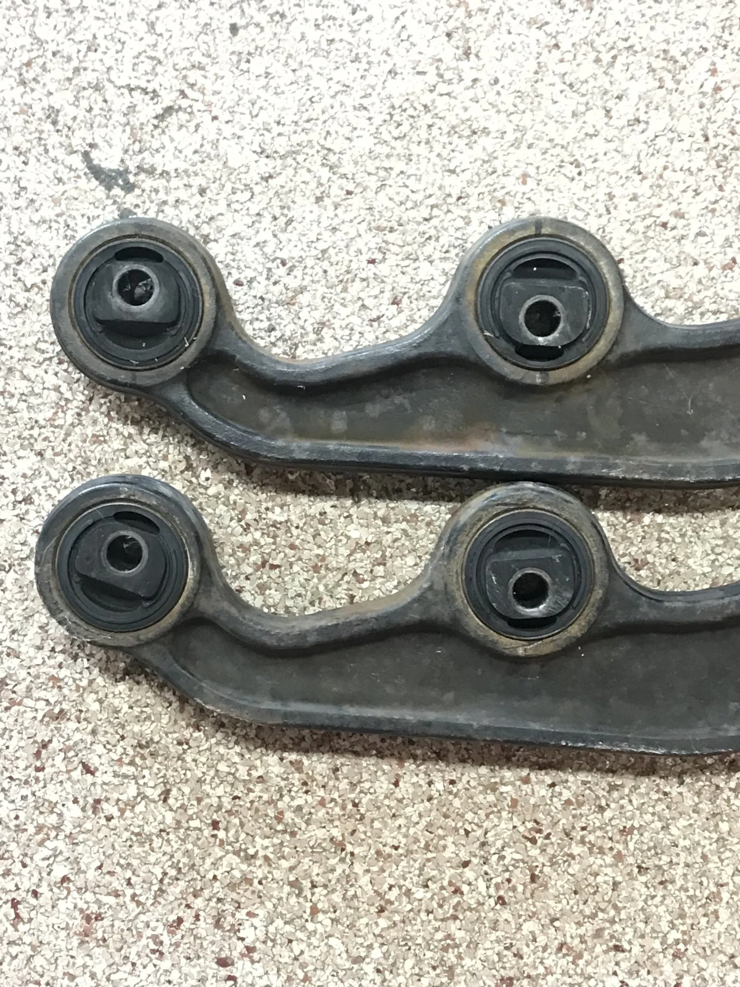

Not the weekend but was hoping to put these in this weekend….just got them back from the shop that pressed in Dobinsons 2.5 degree bushings but does it look right???

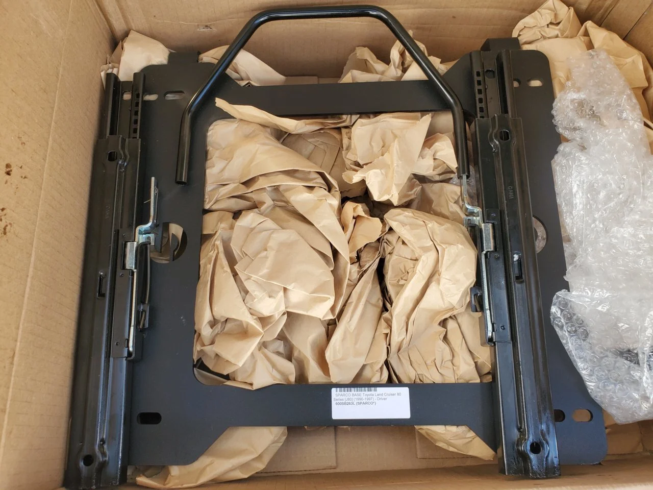

Installed my Sparco seat.
@Dirt Ferguson
Man, what can I say...I've waited quite enough for this bracket so when it came in, I left work early to start my install
:rofl:
I could've made one at work, but I hate the thought of how inconvenient it'd be to bolt and unbolt my seat several times just to fab something up. Make sure to get yourself some hardware as it's not included; M8 x 1.25 and 16mm long.

Not the weekend but was hoping to put these in this weekend….just got them back from the shop that pressed in Dobinsons 2.5 degree bushings but does it look right???View attachment 2934037
Front hole up and rear hole down gives increased caster (more positive) so they went the right direction. That lower one looks like it twisted a bit on the way in, so you won't have quite so much correction. Pressing it back out may destroy it, so you can decide how picky you want to be.
For sure not right. the bottom one looks way off
For sure they should be the same
