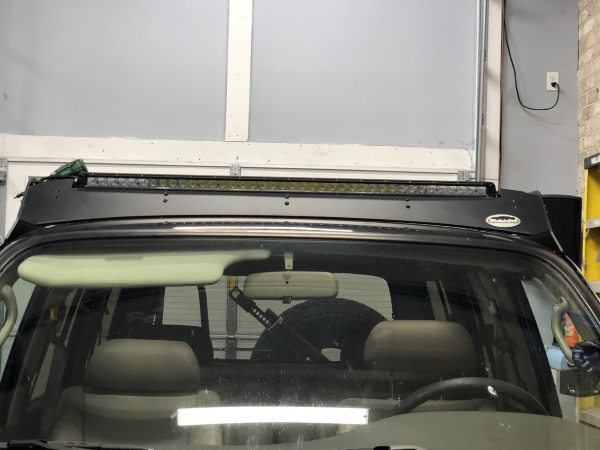

Mounted a light bar on the Bowfin rack - had to notch the front panel a bit to accommodate the width of the bar but otherwise unremarkable install. Now for the scanstrut gland to get the wires through the roof... Anybody have a preferred location (i.e. front of roof, back of roof, etc.)?
Awesome, how did you decide to run your light bar wires up there?

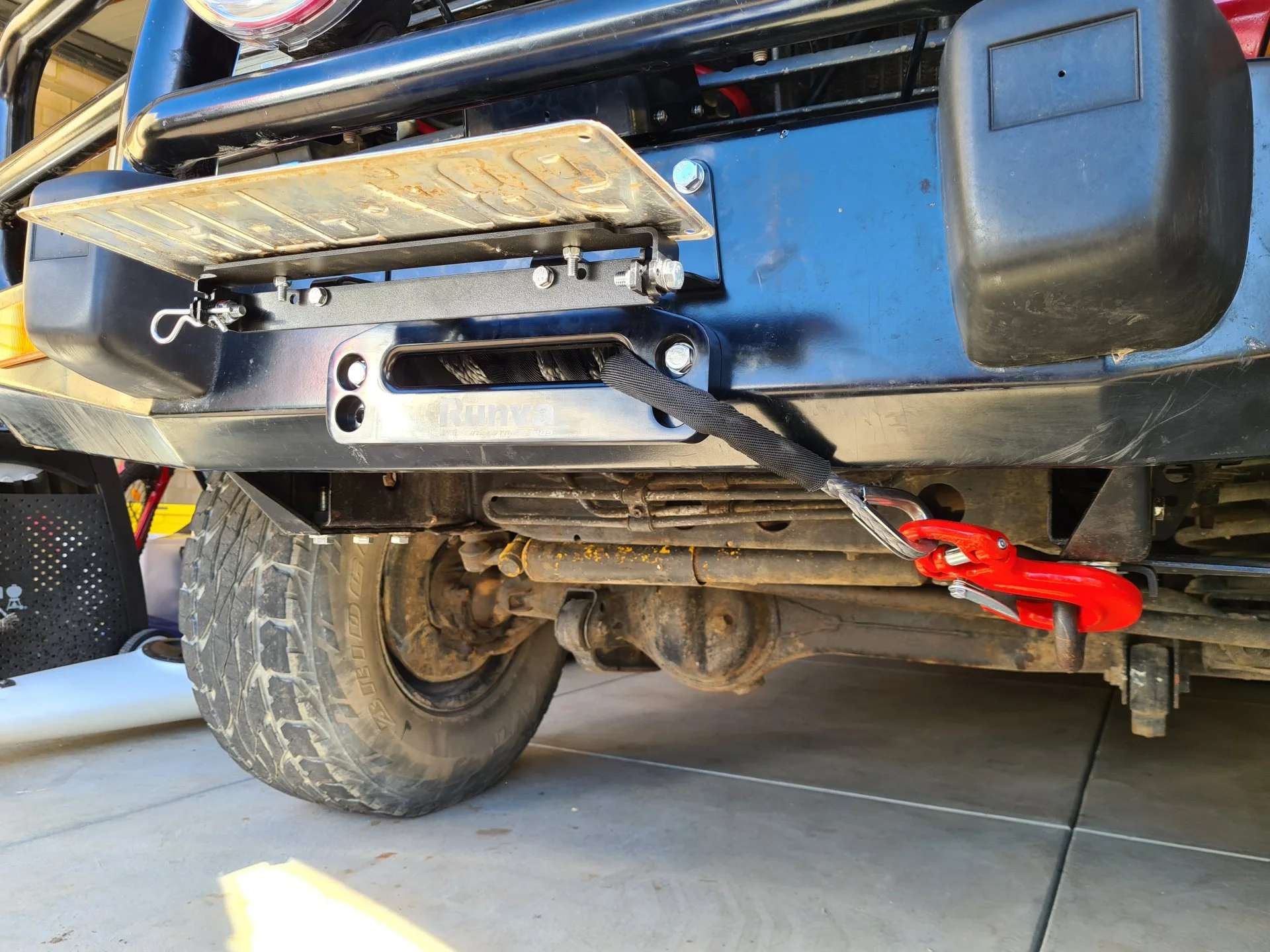

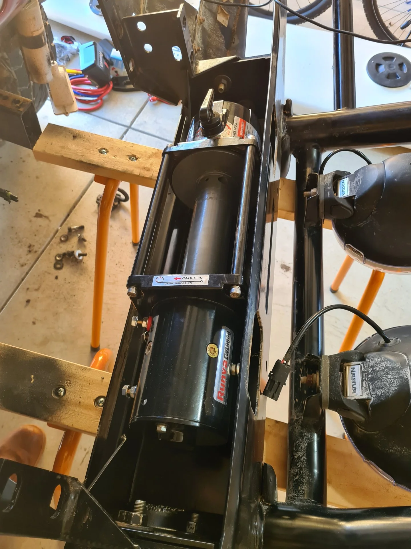

Winch finally arrived in the mail (rated recovery points didn't though!) so I went about installing it in my TJM T15 bullbar. This would have been so much easier as a 2 man job but alas I had myself and a 38degC garage to sweat in.
Decided to replace all the bolts with 10.9 grade; PO had used 8.8. In any case they were rusty and I had no idea what their life was like. There was more bolts on the front end of the chassis rails than I was expecting and I'm not sure if PO has added extras? Was 3 M12x1.25 bottom, 2 M12x1.25 top, 1 M12x1.75 (not 100% but course thread) and 2 M10x1.25 on the outer sides. There's so many bolts that they all interfere if they are too long.
While I was in there I figured out that I'm missing a stock bash plate and as a result PO has bent the power steering paperclip. Looks like I'm adding a Wits End cooler upgrade to my order!
Winch works nicely with the wireless remote but I'm unsure what the current draw is... I'm thinking I might upgrade the alternator to a 100 series 140A or something... more to buy.
Your synthetic rope will last a lot longer if you swap out your hook for a winch shakle mount: Factor 55 PROLINK XXL Winch Shackle Mount - Black

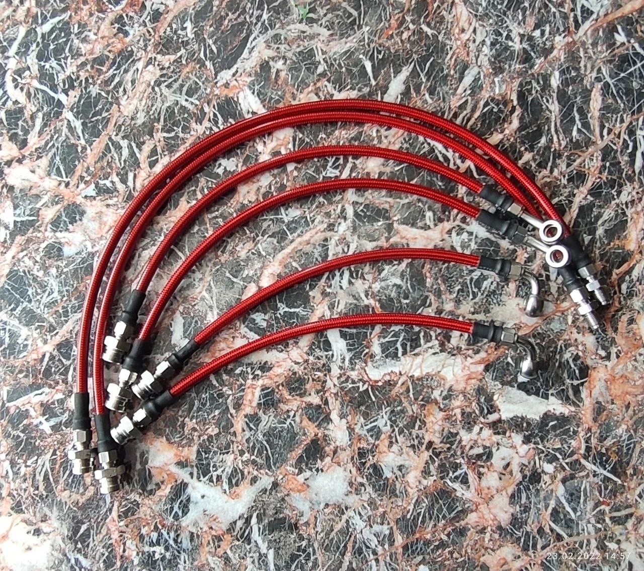

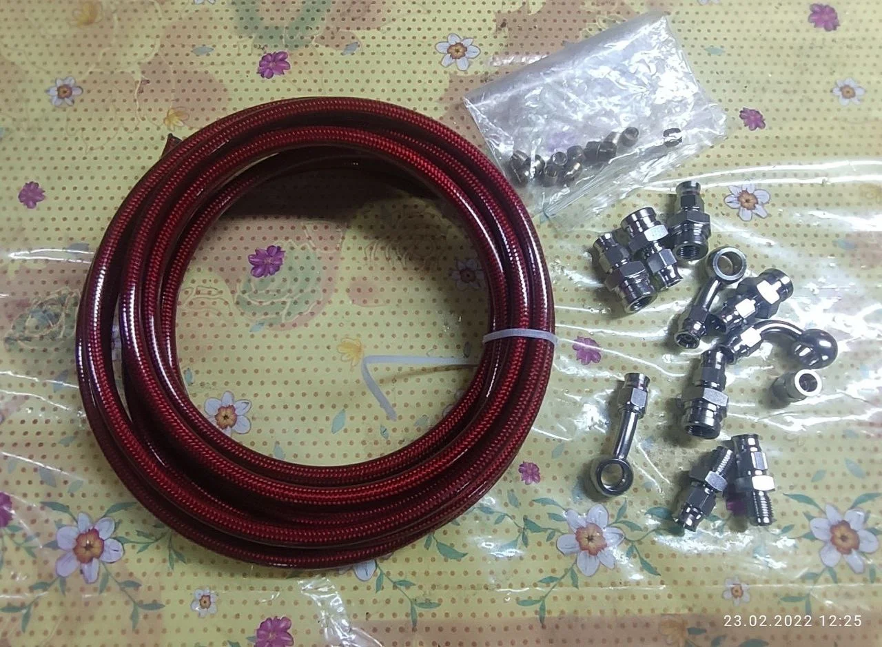

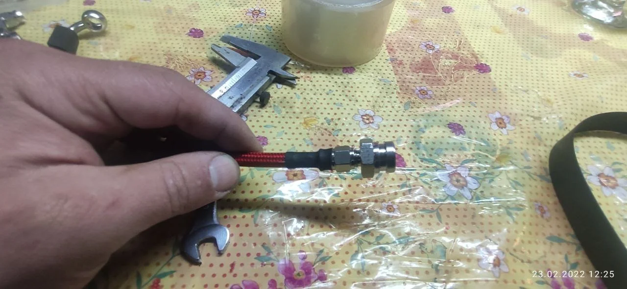

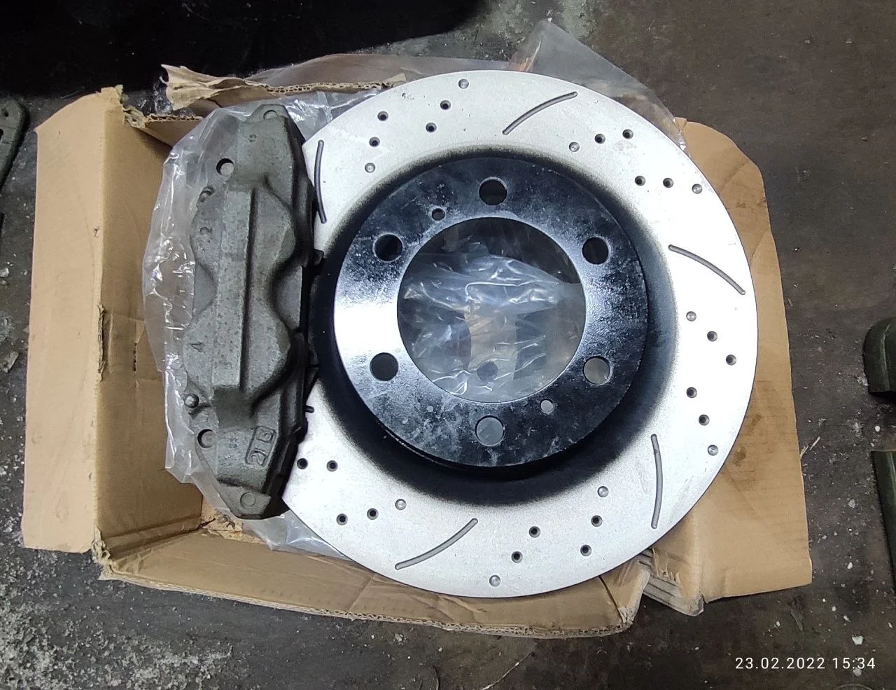

Make a new braided brake hose for 8 inch lifted rig.
Frame to axle 55 centimetres, front callipers 35 centimetres, rear callipers 30 centimetres.
Get ready for front big brakes upgrade.
Thanks to @jcardona1 for his thread ✌🏼
Have details on part numbers etc for the braided line and fittings? Looks nice and I need to do mine.
Yeah, is that a build you own brake hose kit?? Where is that from??

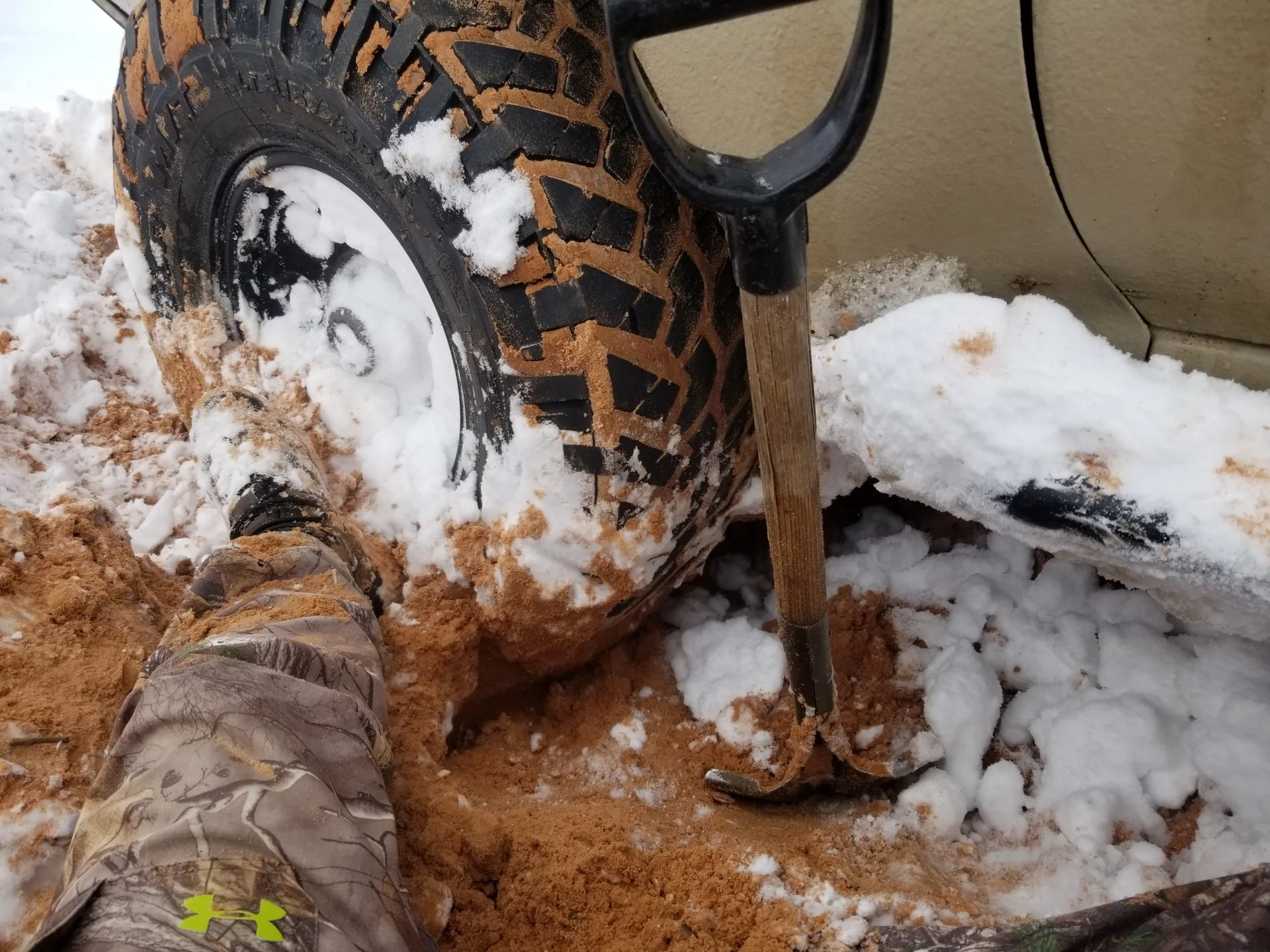

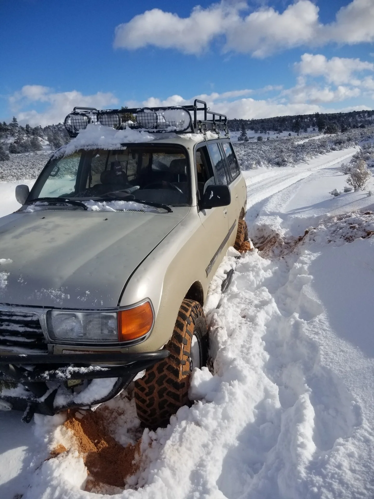

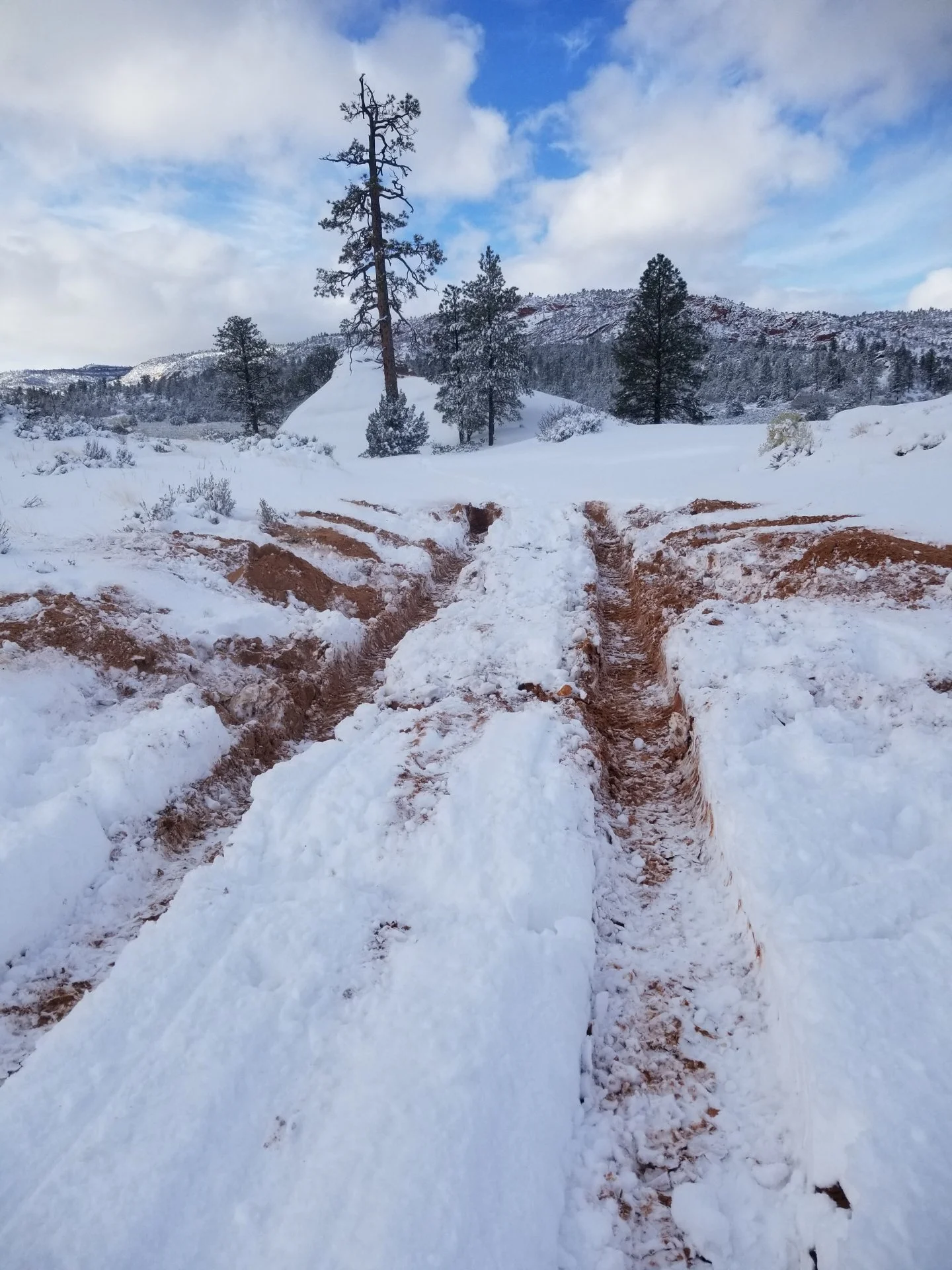

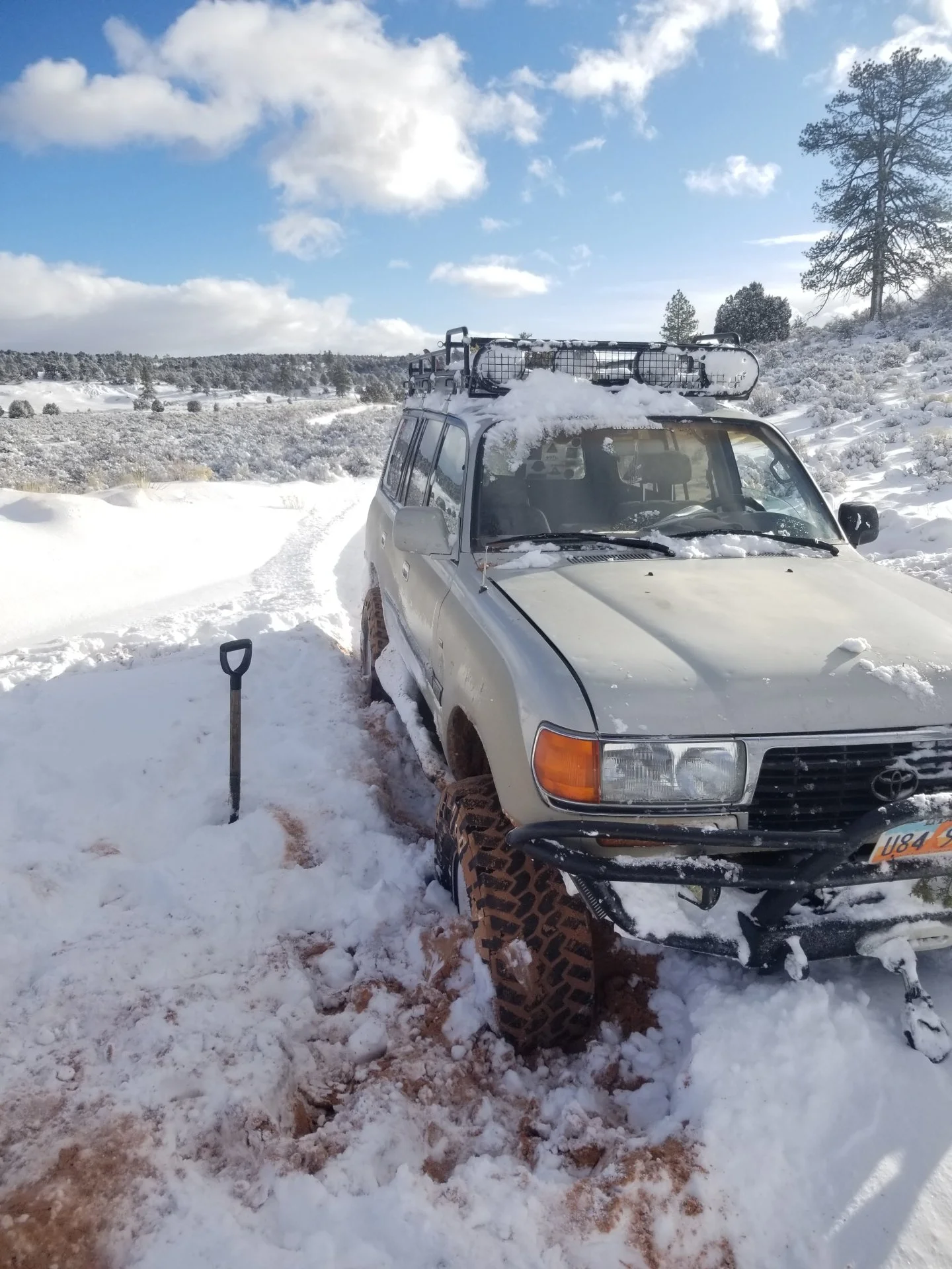

Got it stuck
Than proceeded to unstick it....
I think I need a winch extension.
Get a set of ActionTrax 👍🏻
I have never seen traction boards actually make a difference. Do they even work? I just assumed they were overlander bling bling
They make a helluva difference if used properly yeah. Overlanders don't ever use them they just look cute 😂
But for wheeling solo in sand and snow they're a good bit of kit to have

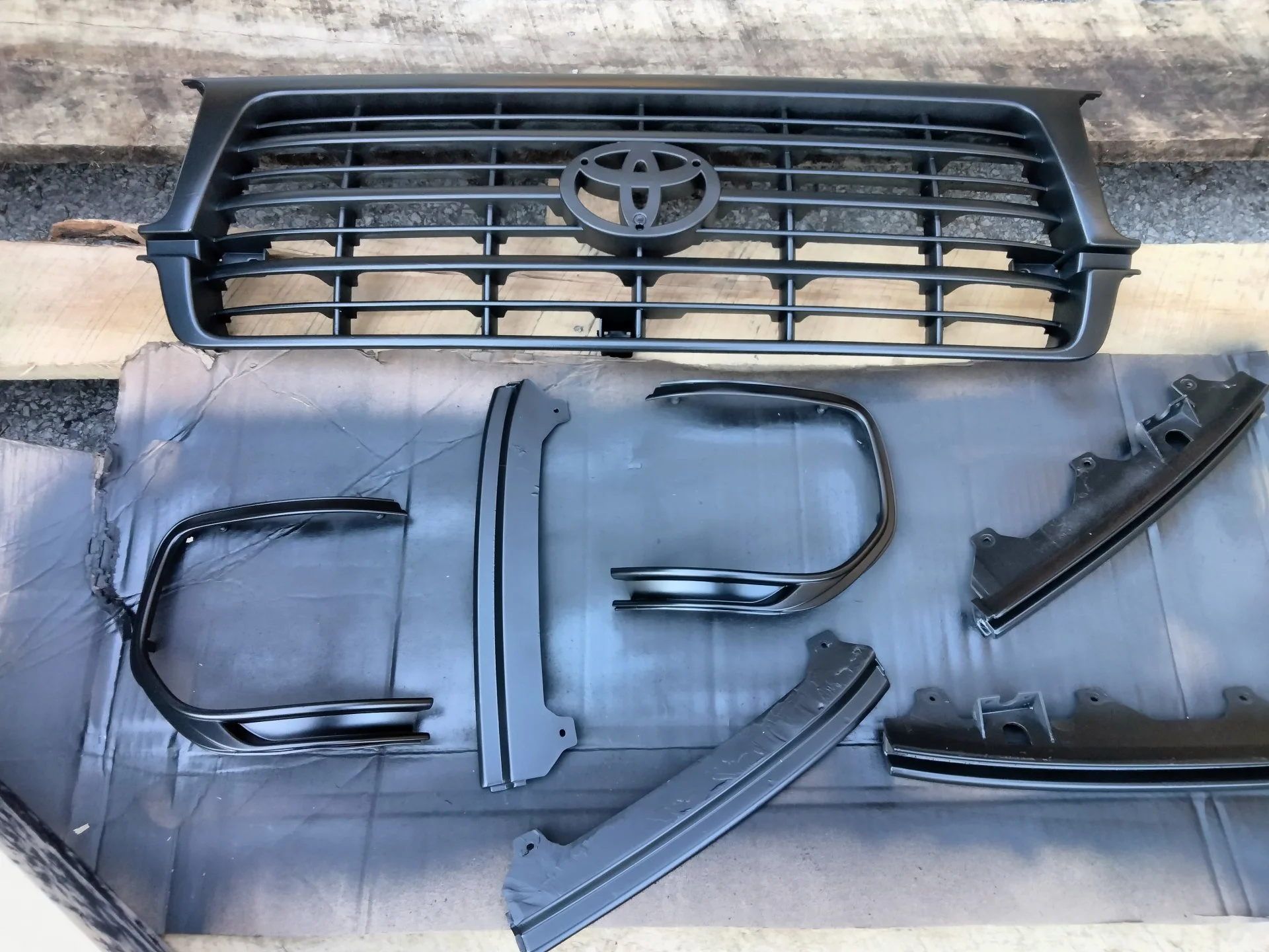

Took all this apart, scotchbrited and freshened up the paint job that I did in a hurry last time....
Actually took my time cleaning it up and painting and clear coating this time. Still not perfect but better than it was by far. Not a fan of chrome. Even though my door handles are still chrome... Also redid the center section of my hood and my cowl. Muy bueno.
Can I just refer to my previously more lazy/hurried self as "previous owner?" 😂
On a negative note...my hi beams don't work after doing all this...
(Edit) Fixed hi beams 🤙🏻
