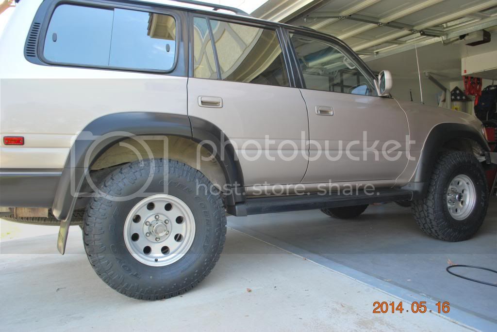

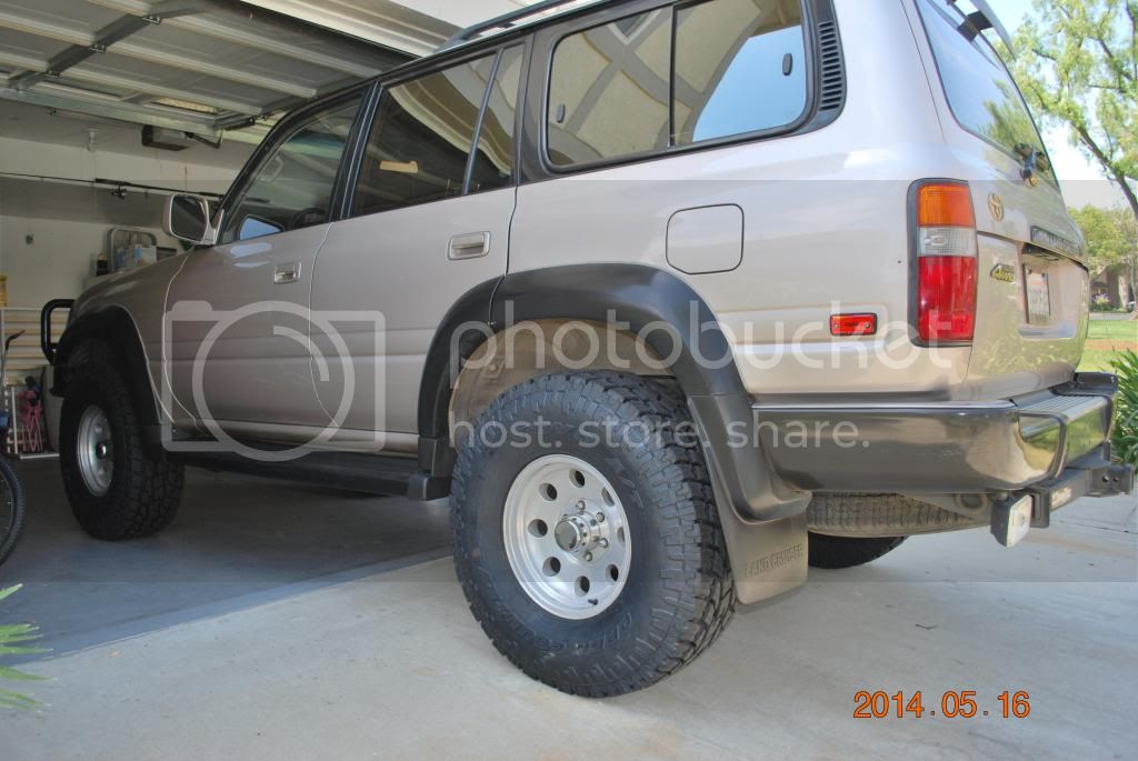

Inspired by RileyEscobar, I decided to touch up the flaps as well
Also replaced the old wood grain
Got some new Toyo Open Country AT2 Extremes! Finally pulled the trigger on the 315s! :moon:

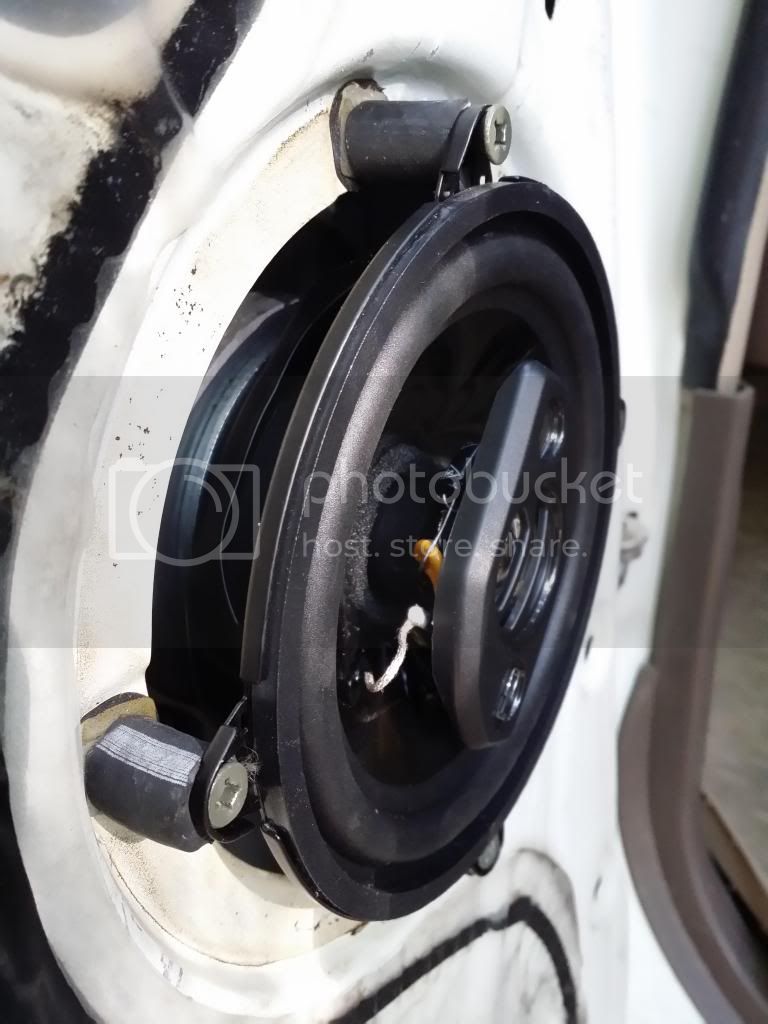

Replaced front speaker having to use spacers I made due to speaker hitting widow glass slide.
