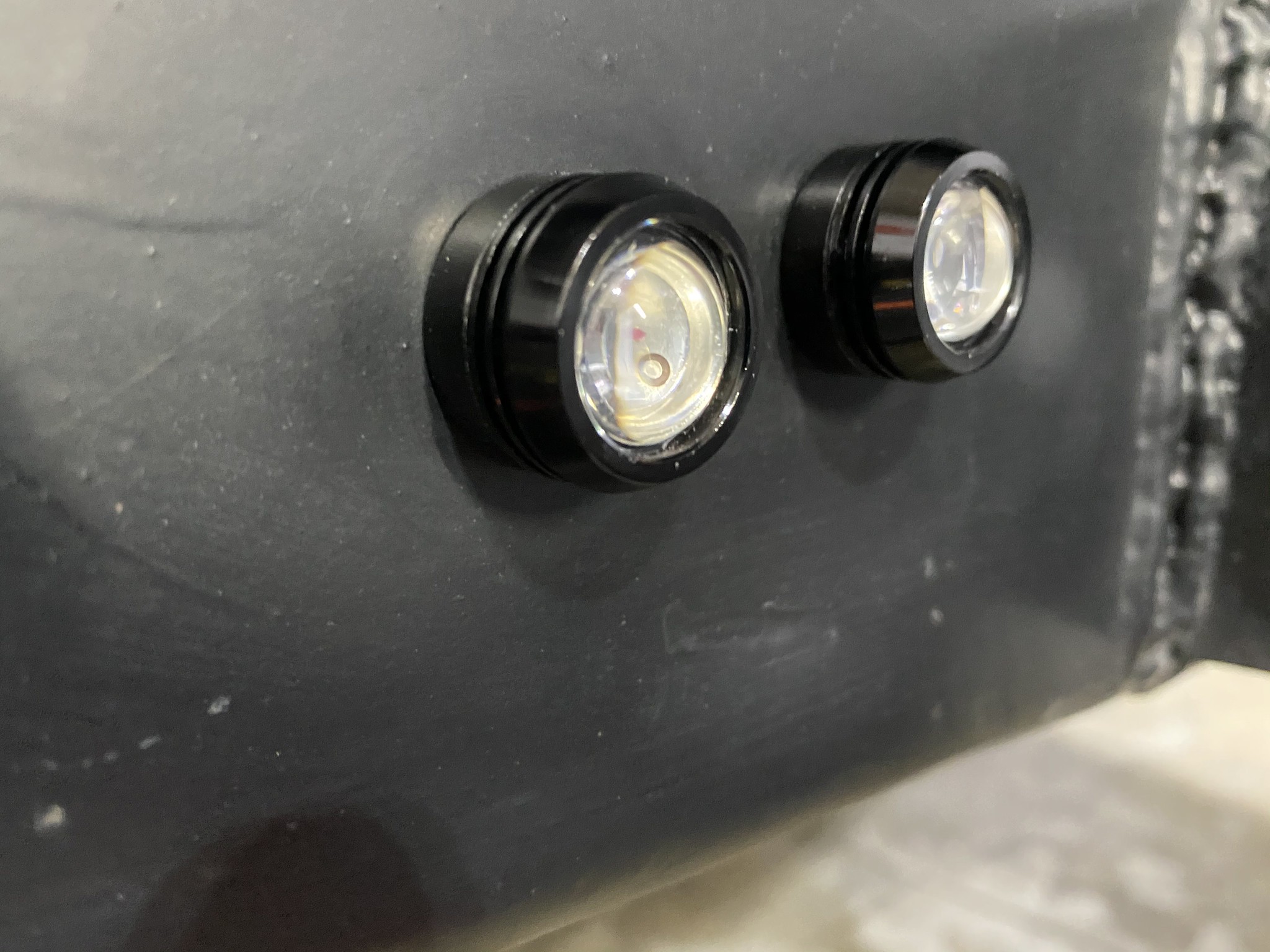

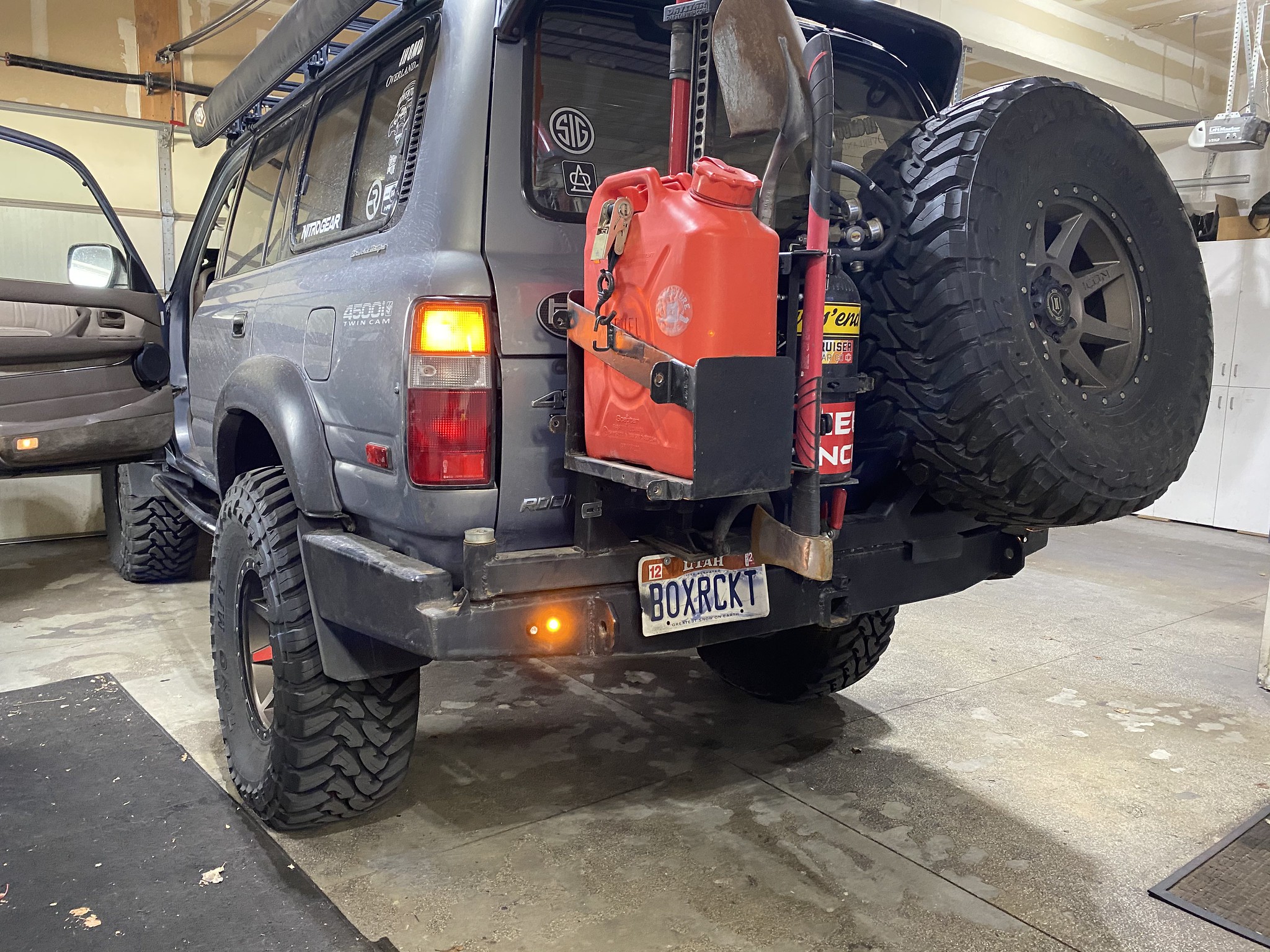

After getting 37's my spare tire was partially blocking my passenger side taillight assembly. The brake light was mostly still visible from behind but the turn indicator was hard to see for drivers behind me. I looked at a bunch of different options to fix it but settled on a couple extra lights added to my rear bumper. I found these little LEDs about the size of nickel from Revival Cycles. They are brake and turn indicators for motorcycles. I ordered a pair of red LEDs and a pair of Amber LEDs and connected them to the brake lights and the turn signals. Should be a bit safer now.
