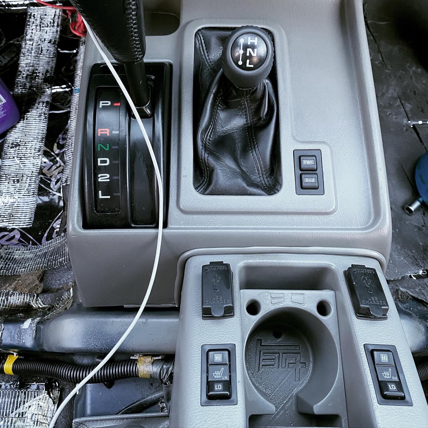

Niiice....you’re building a cream puff there, are you?progress on the interior continues now that the rains have stopped in Cali... but the learning from this forum never stops! Grateful for all that knowledge from everyone here

Delta Console by Adam Tolman, on FlickrI’d be lyin if I said no!Niiice....you’re building a cream puff there, are you?![]()
View attachment 2570753View attachment 2570755View attachment 2570754View attachment 2570752View attachment 2570757
I went with Duplicolor medium grey on everything... went ahead and cleaned with purple super cleaner, then warmed panels with a heat gun, sprayed and rewarmed to promote drying... came out good, no runs, seems to cure well to the panels. I replaced all panel clips and added some sound deadening inside the dead spacesWhat color did you spray that back panel with?...looks good!

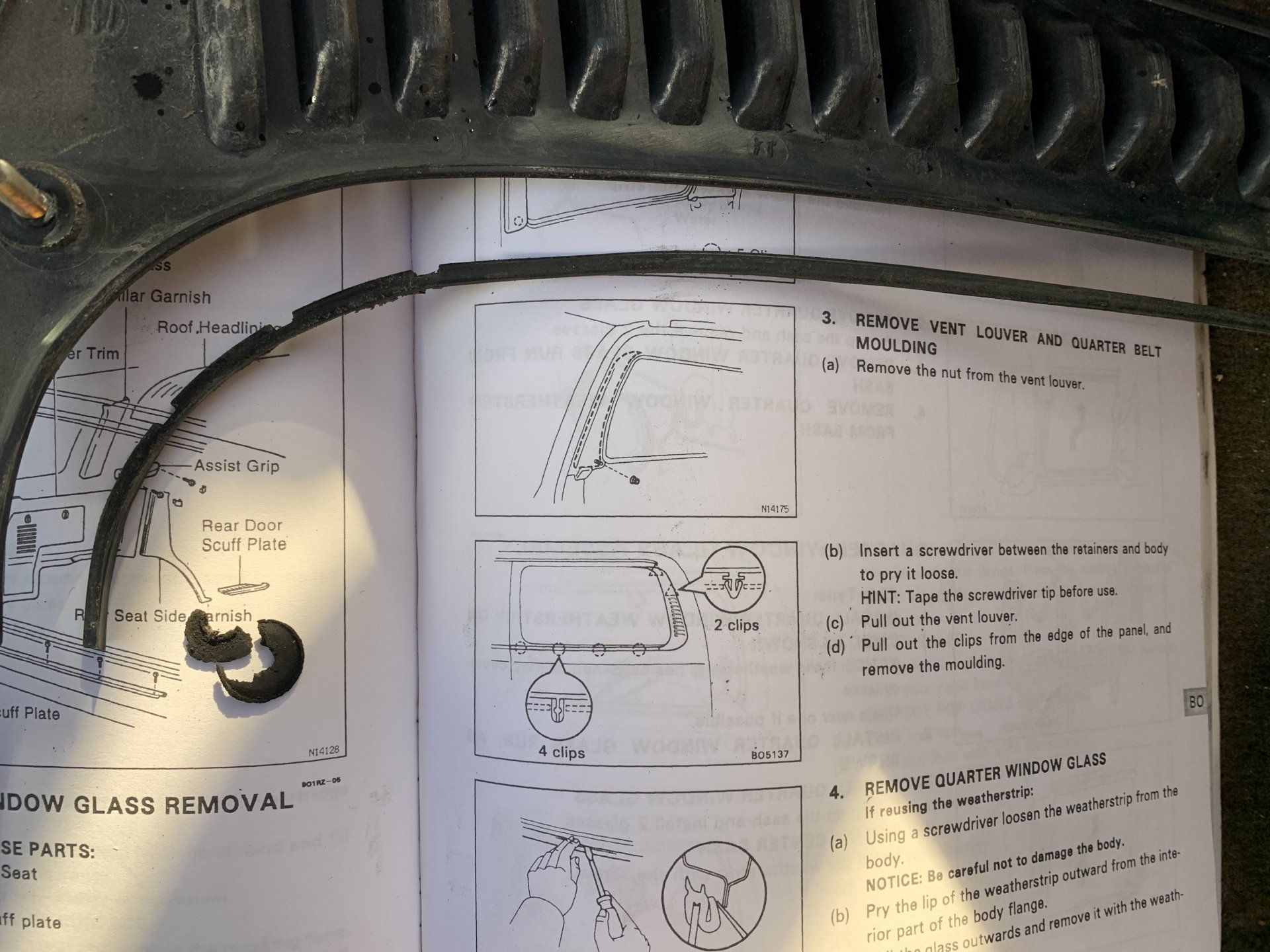

Thanks for the info. I’ve got this issue and try and hog the garage when it rains because of it. Replacing rear window rubbers is on the short listQuarter panel louver leak culprit?
The gasket for top trim tab was shredded, will fix that. View attachment 2570974
Does the other edge piece coming off the louver itself have anything to do with anything?

Nice clean Install, looks factory. Well done. Where did you get the USB charger plugs?progress on the interior continues now that the rains have stopped in Cali... but the learning from this forum never stops! Grateful for all that knowledge from everyone here
