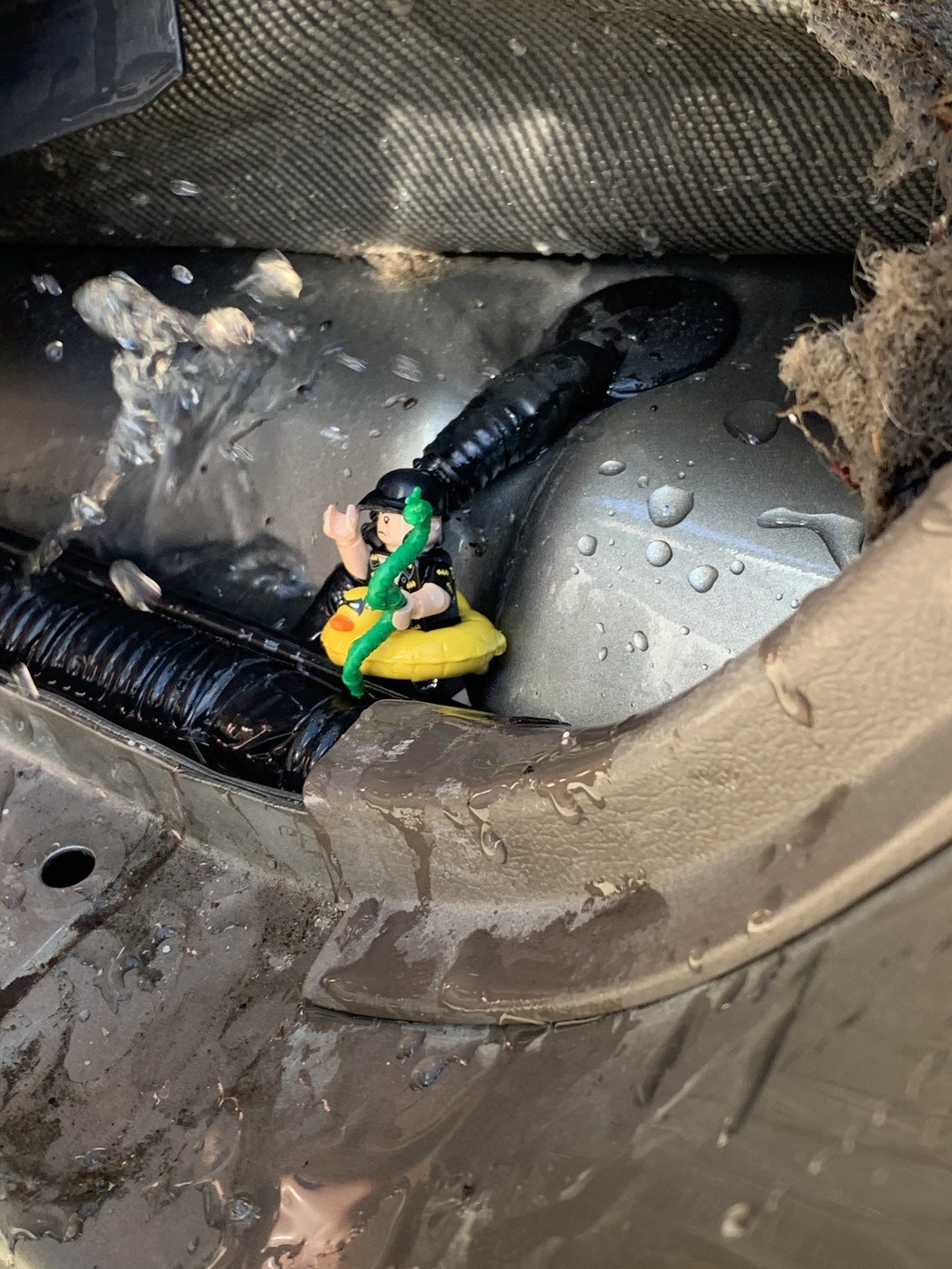

The sunroof still leaking, overwhelmed really. #deleteallsunroofs Needless to say, someone is having a lovely beach day at least.
The sunroof still leaking, overwhelmed really. #deleteallsunroofs Needless to say, someone is having a lovely beach day at least. View attachment 2568900
In that location (looks like driver rear door) I believe it’s possible it’s coming from the “belting” under the sliding windows. Do the rear quarters get water in them also?
I suppose that’s possible. The rear corner by the hatch is damp too, but also this: above drivers head
is there a way to check that belting?
Another way of know if it’s the sliding window trim is the 2nd row seatbelts may be wet when pulled out. Pop the side panels above the rear wheel wells and look up. You’ll see several holes with the clips that hold the “belting” in place poking through the sheet metal. I smeared FIPG over them in my truck 10 years ago and it has been dry ever since.
