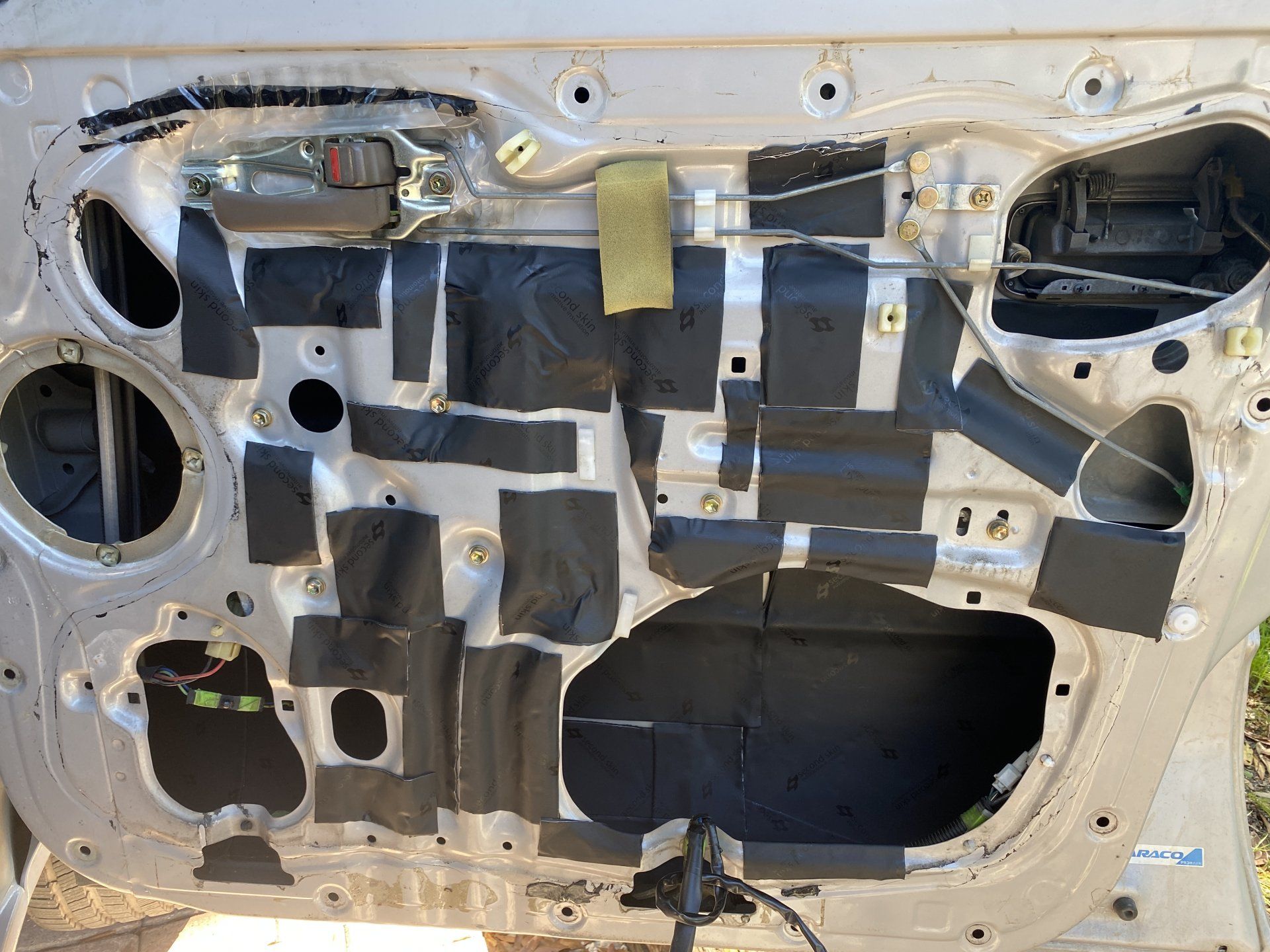

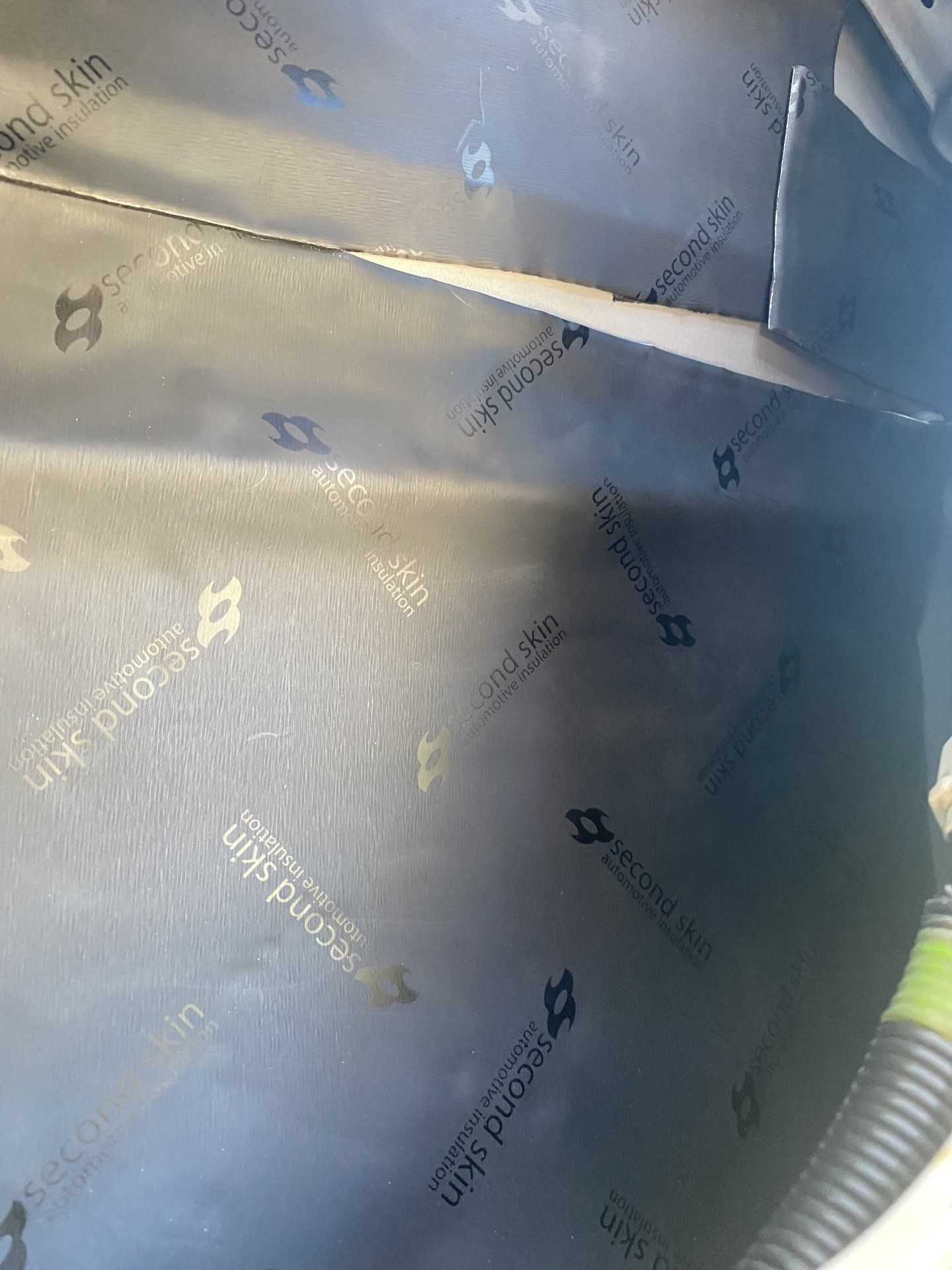

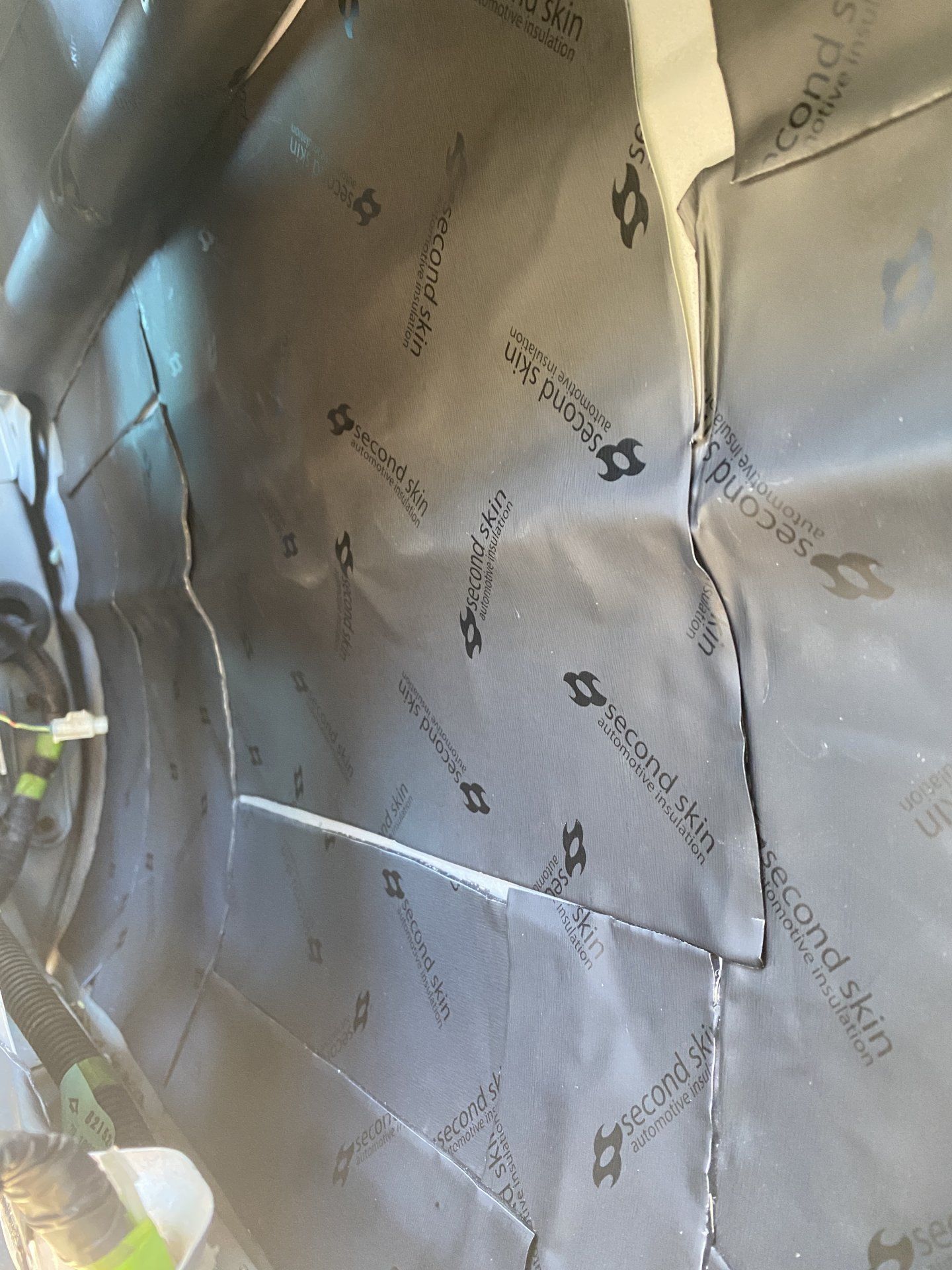

Began soundproofing of the doors. SecondSkin Damplifier pro followed by luxury liner pro. Did the inside of the outer panel, then inside and outside of the inner panel. If that makes sense.
Preparing for the morel speakers.

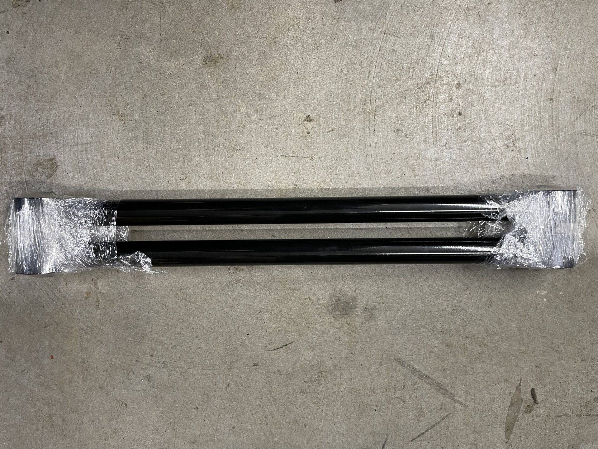

My current rig came with a metal tech front tube bumper. So far I really like the lines of this bumper and it is very light which is an added bonus. The bumper takes care of the first and second item on my list, but I thought it was lacking in the protection department.
On thursday my friend and I were talking about this subject and my lack of a tube bender to remedy the situation. My buddy proceeded to pull out an 8 ft piece of 1.5" DOM with a 90° bend on either end out of his garage and said "problem solved".
So today I modified my front bumper. I am mainly worried about smacking deer. I only added another 5" of height to the bumper, but I am quite confident this little change will make all the difference when I hit bambi again. Before it would have been a broken deer knee and shoulder blade into the headlights. Now it should be shoulder blade into the bumper and deer underneath the tire.
