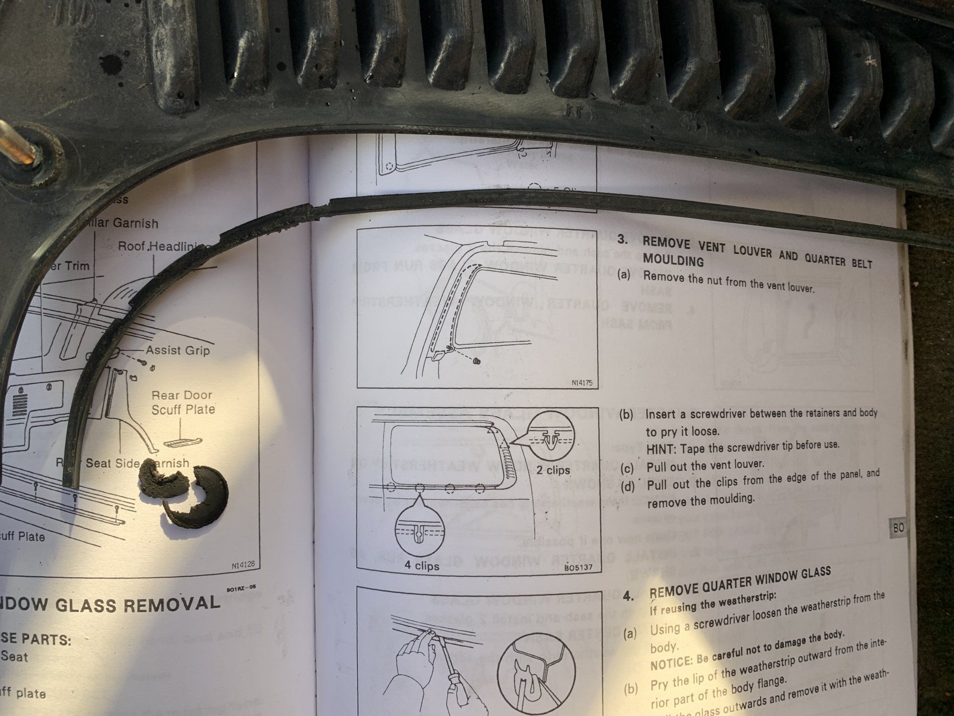

Quarter panel louver leak culprit?
The gasket for top trim tab was shredded, will fix that. View attachment 2570974
Does the other edge piece coming off the louver itself have anything to do with anything? And confirmed. Both of these are leaking into cab.
Will also assume the bottom bolt is too.
View attachment 2570978In stock at NAPA.
And now the clips.
also going to seal these. View attachment 2571083
I did driver side and kept the remains of my tired gasket and then just put silicone on all the screw holes/clips. So far so good, didn't leak during the most recent storm.

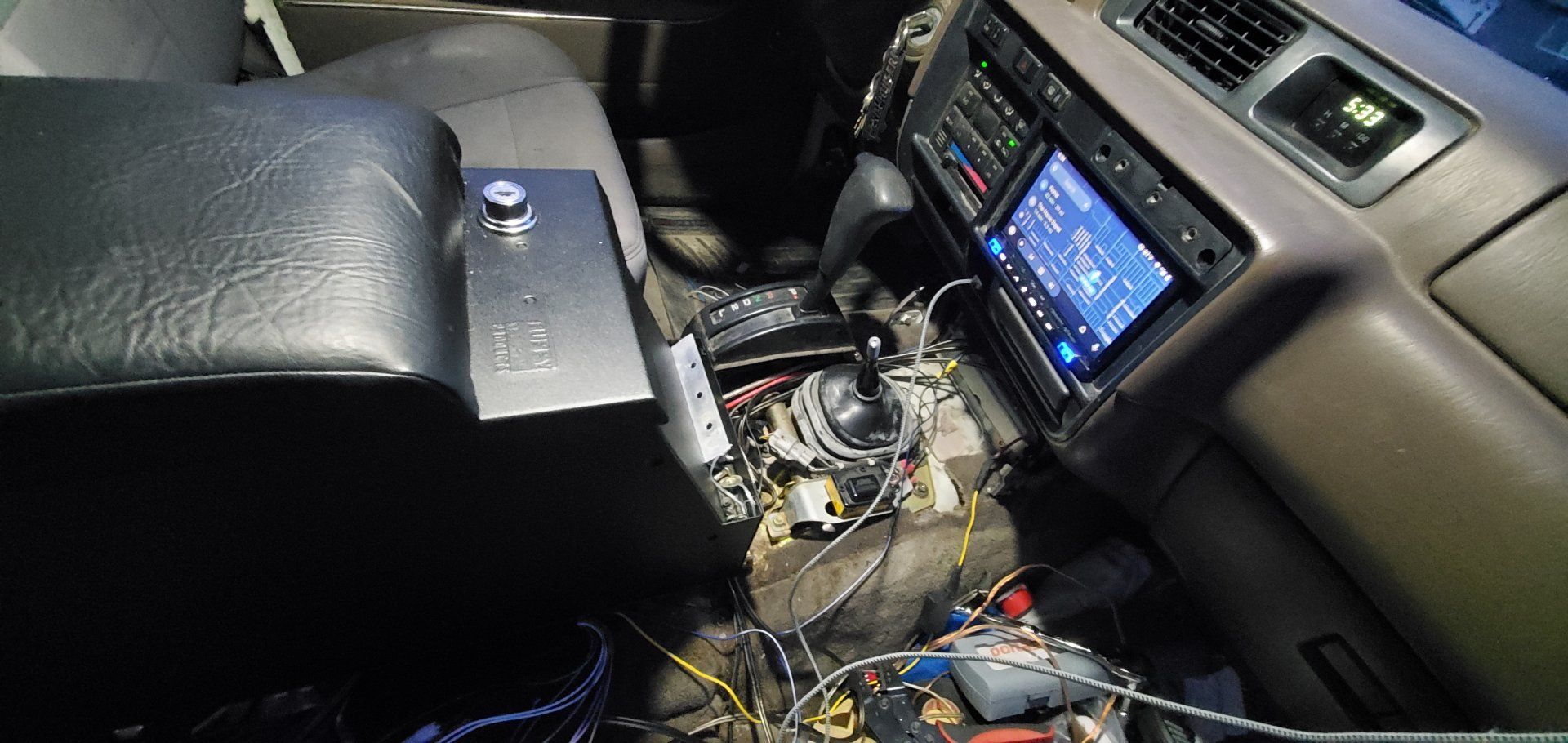

Since I did the tuffy, I removed my rear heater blower unit which has been bypassed and the little itty bitty kicker powered sub fit under there. I also ran all new wire to the door speakers, and wired in the small Alpine amp 45 watts rms x 4 for the headunit. Sounds waaay better than it did. The headunit is now a Alpine Ilx 207.

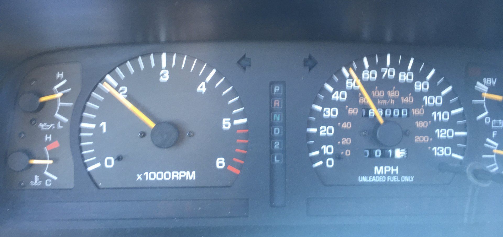

Hit 163,000k on the odometer. I’ve owned this for about 2 years. The countless hours of preventative maintenance and on this website is very worth it. This mud community and the wealth of knowledge is the best!
