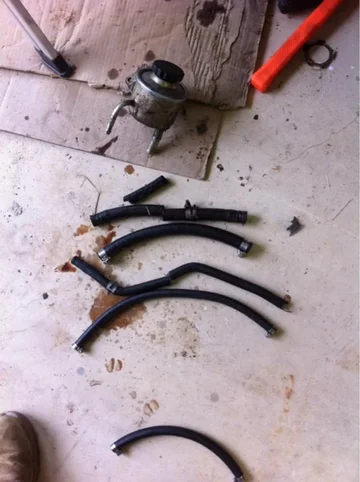

I also pulled the ps reservoir and two of the three low pressure lines. I can't find the third (haven't looked that hard) these must have been original, the were very brittle and broke in half!
We have been changing a lot of them around here. The desert heat has made them rock hard, and then they tend to crack right where the end of the hard line is inside the hose. The high pressure lines seem to survive much better. John
