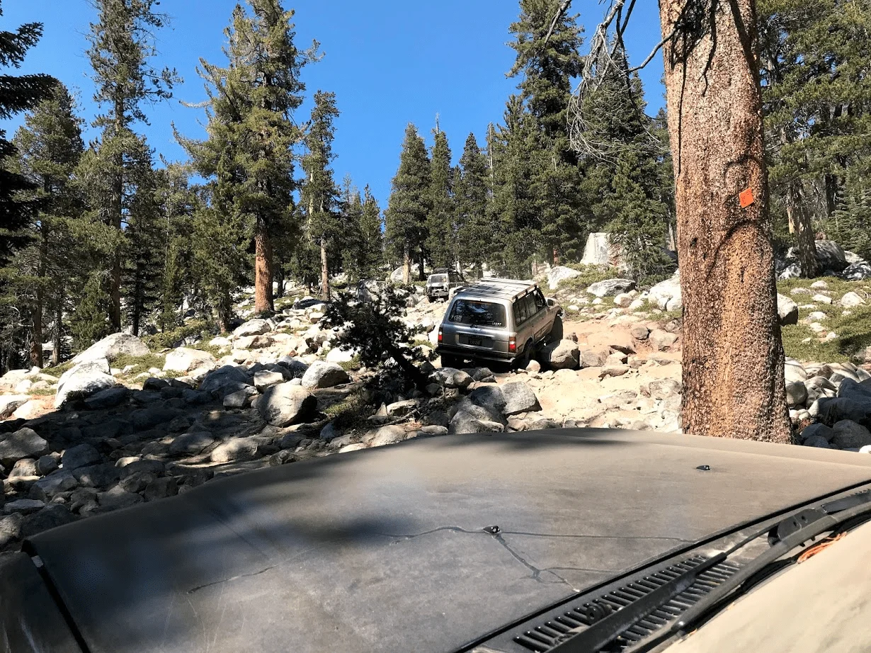

Dusy Ershim trail, 9/5/20

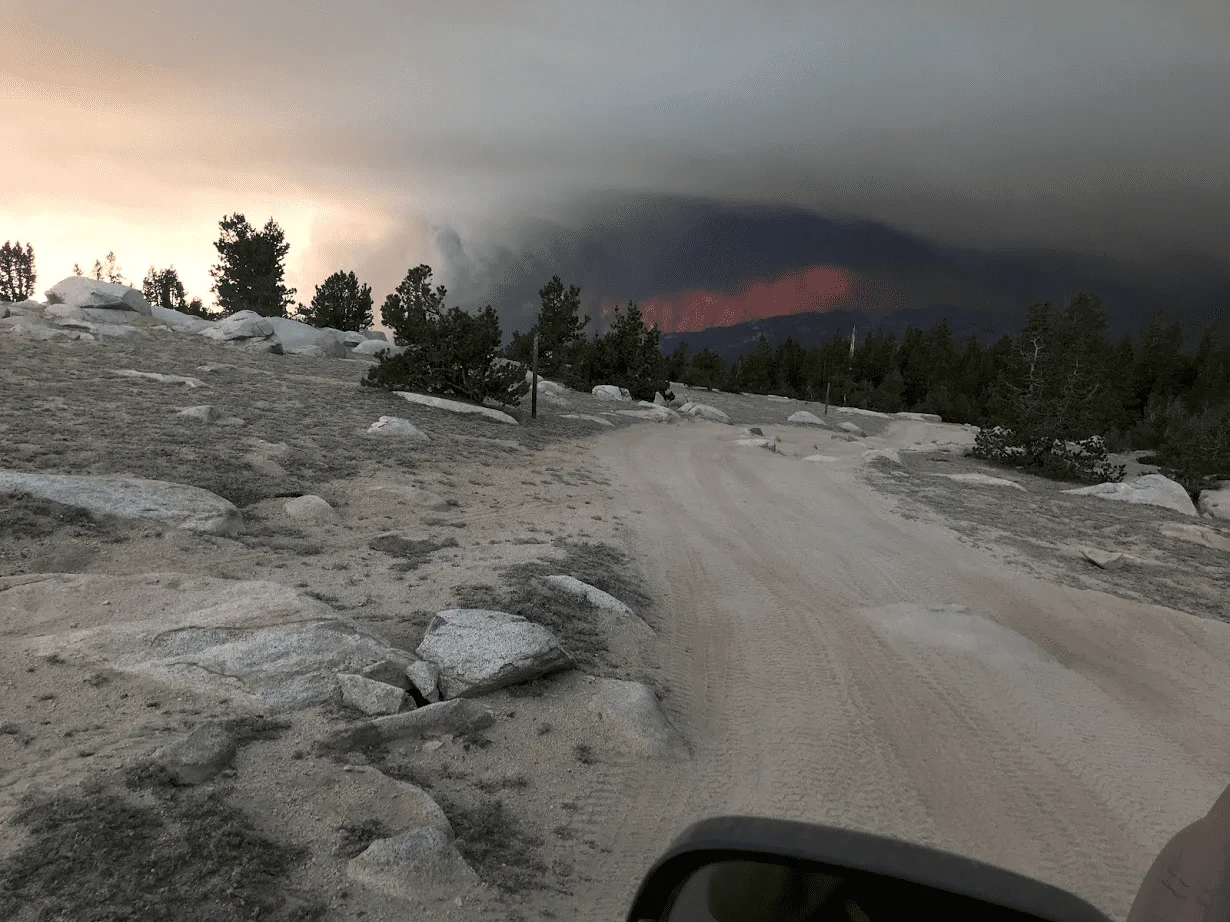

#CreekFire
So glad you guys were able to make it out safely. It sounded like a hair-raising trip.

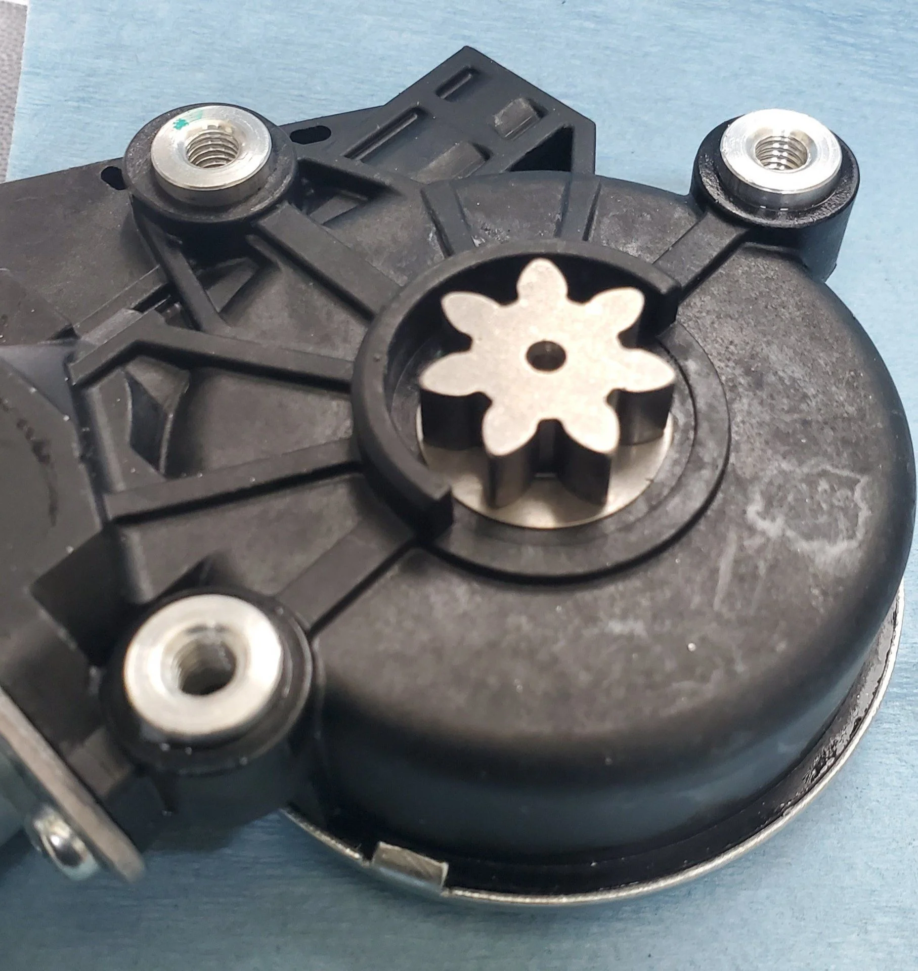

Replacing the other 3 window motors on the truck. Replaced one a long time ago and love how much faster it is.
Anyone tell you how much fun it is lol. 😂
Well, after at least 15 min of trying to screw the new one in, I gave up and inspected the hole. Realized Doorman does not thread the holes anymore. :bang:
Luckily I purchased a tap and die set last year...
Toyota window motors don't come threaded either. The bolts are supposed to be "self-tapping" but it may take a little force to run them in.
Interesting. I could have swore my last Doorman was threaded. No way would I want to keep trying without the tap.

Went wheeling on the Dusy Ershim with friends .
Was good times tell the Creek fire started and we high tailed it out of there.
mrs surfpig was just on a conference call with someone in Berkeley. Same thing.
:eek:
Ya. It’s spooky AF. Hoping the winds will keep the smoke aloft, because if it drops to ground level it’s going to be real bad.

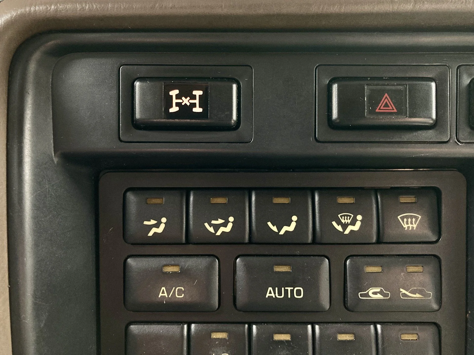

Happy to have a CDL button!
And yes, I do need to fill up on fuel.
Time for my 345,000 mile oil change as well.
Re-stickered the hazard switch I’m using for CDL button. Previously was placed over red triangle and thus didn’t light up. Popped out plastic piece, scraped off the print down to clear plastic, tacked it back in place with superglue. Covered with white vinyl, confirmed I got a bit of light coming through, then overlapped in black w/ CDL icon cut out. Popped a green cover over the bulb to make it match the rest. Works great & slightly brighter than stock buttons. Now I can see it during winter when it’s dark most of the time...
This same thing happened to me! I thought it was a defect in the motor or something.
