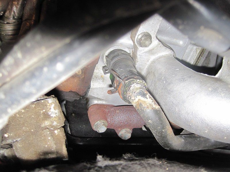

Found my coolant seemed a bit low in the overflow bottle - did a little searching and found this. Sorry the photo is turned sideways for some reason but the coolant leak is easily seen.
Here's the inside of the hose.
This hose was supposedly new from a few years ago when I had the HG replaced and asked that the dealership replace the PHH. They may actually have done it lookin at the clamps that are in the photo above as the original would have had the twisty cotter pin type clamps if I remember correctly. I replaced with a segment of gates green stripe and gave it a coolant flush. No more leaks so far so I am pretty sure I found the culprit.
