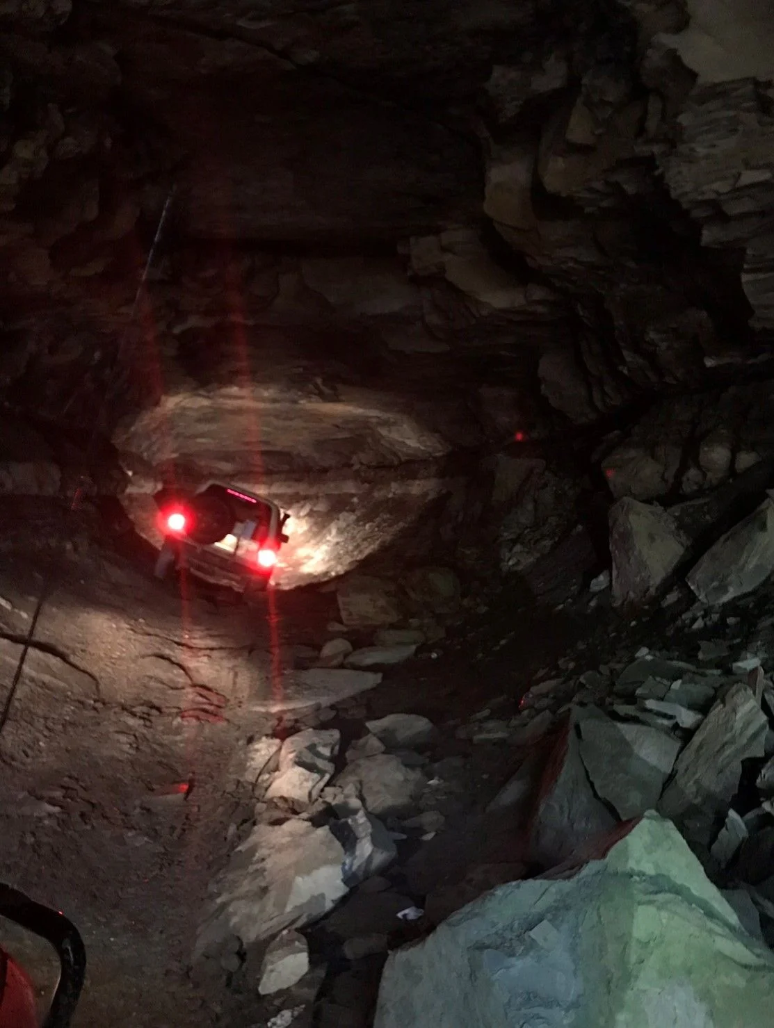

Took the LC to some old train tunnels and creeks this past weekend. It was epic. There are three different tunnels on this property. One is so long you cant see light from either side.

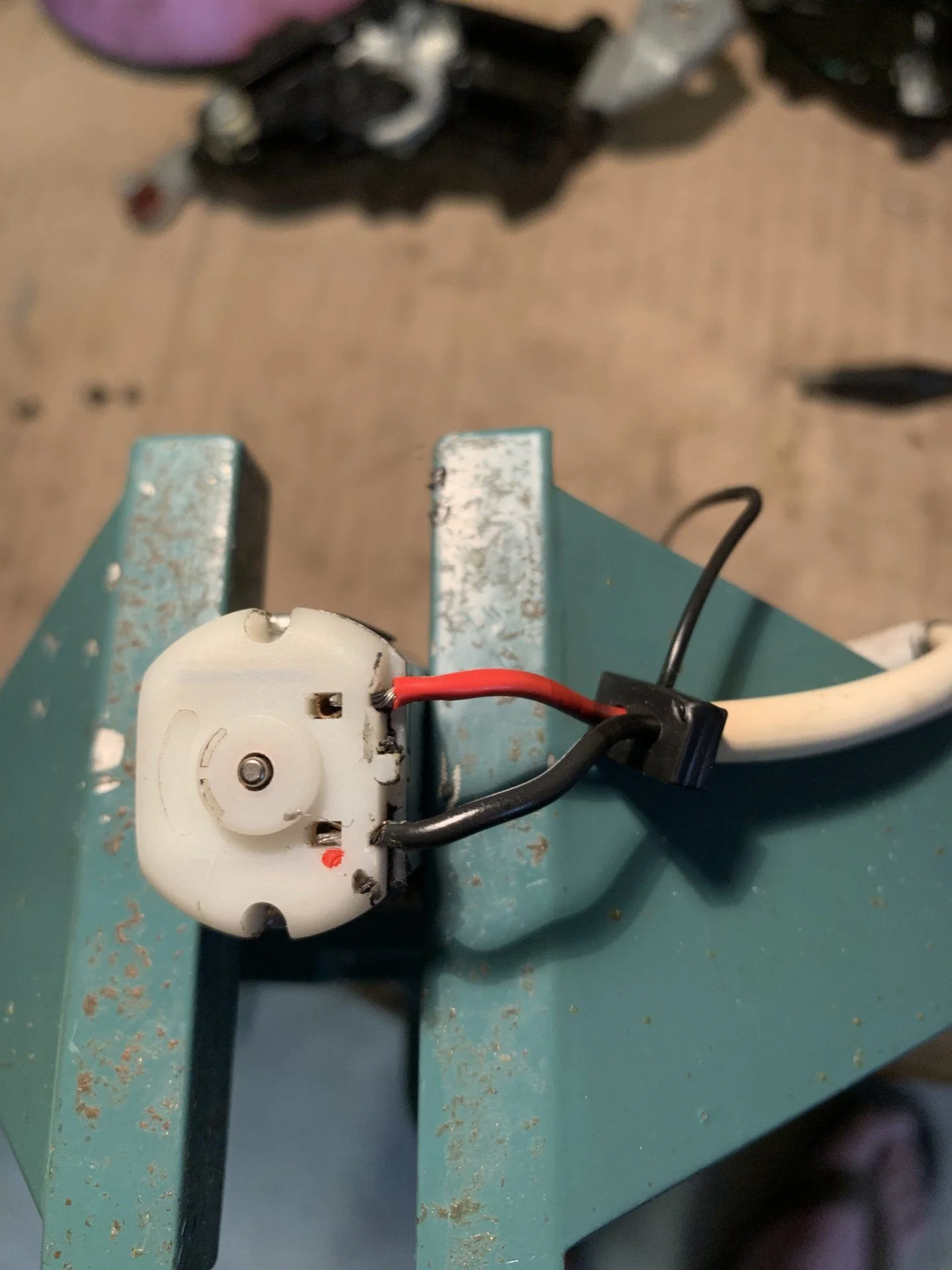

Repaired the drivers side rear door lock actuator. Replaced the little motor inside the actuator with one from Solvefunction . I used JB Weld to secure the worm gear to the shaft. I used a file to ruff up the shaft so the JB would have something to grip (unsure if this was needed). Also, be sure and wire up the motor according to how the wires are oriented on the old motor and not by color. Test before putting everything back together. If the wires are wrong, door will lock while unlocking and unlock while locking. Ask me how I know :)
Wires:
