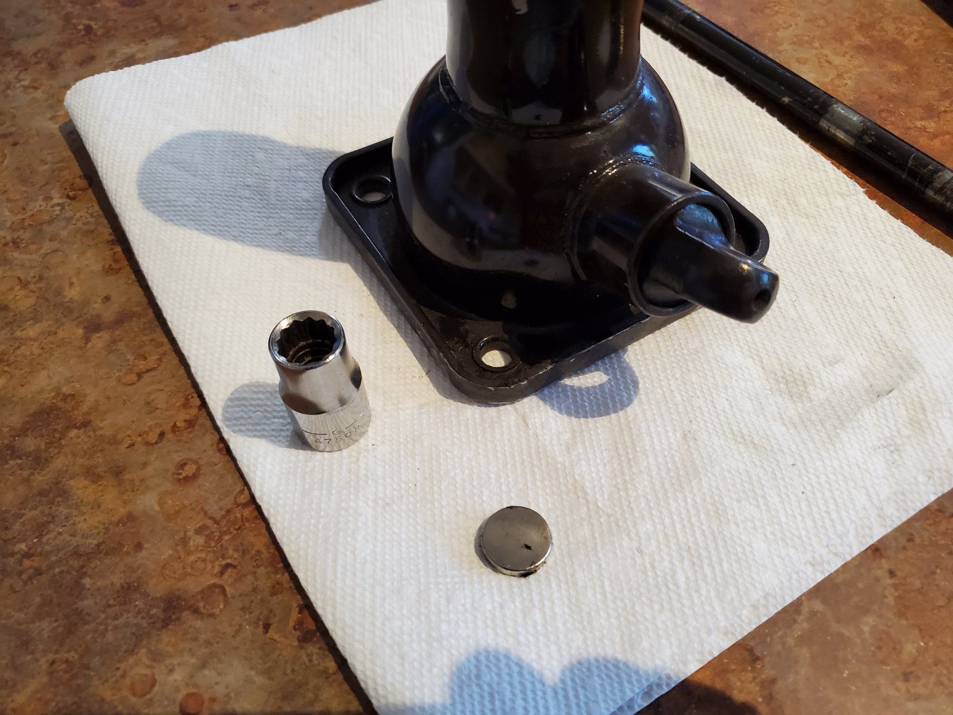

Lubed up the OEM jack with some white lithium grease, stuck a 12-point 1/2" drive socket (8-point would work too) on it with a magnet and stored it back in the truck.
The socket fits the drive handle perfectly and, coupled with my electric impact, makes quick work of raising and lowering the truck. Going to start storing the impact in the truck where it might do some good rather than the hall closet.

And it's not an 8 point as stated. It's a 12 point.
<takes off socks to count>...4...5...6....DANG, you're right! I figured 2x 6-point is 12-point so 2x 4-point was 8-point. Just found the 8-point in my toolbox. Whoops! Either will work to catch the 4x points on the rod. :D
Fixed it above.
Fixed it above.
So for future readers in the year 2021 (if we make it) 1/2” drive, 12 point, 1/2” socket?
exactly the setup I have. Works great.
