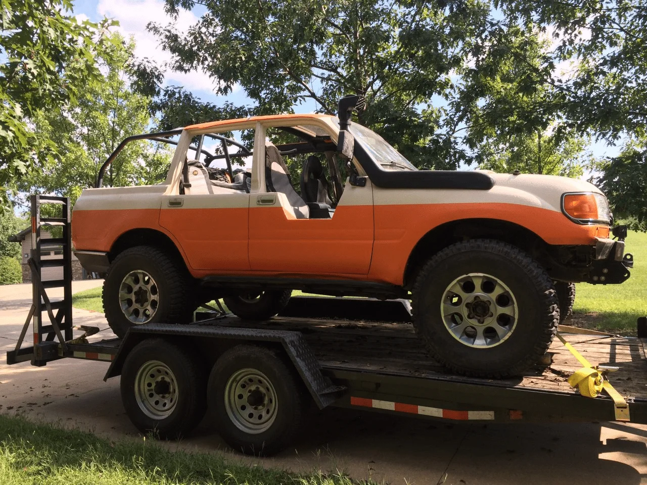

Awesome! Really wish someone would make some sort of quick disco system for 80 doors. Being able to pop them off and leave em home for nice summer weekends would be pretty sweet.
@4LowandSlow good job on the doors. I did these a few years back on foo.

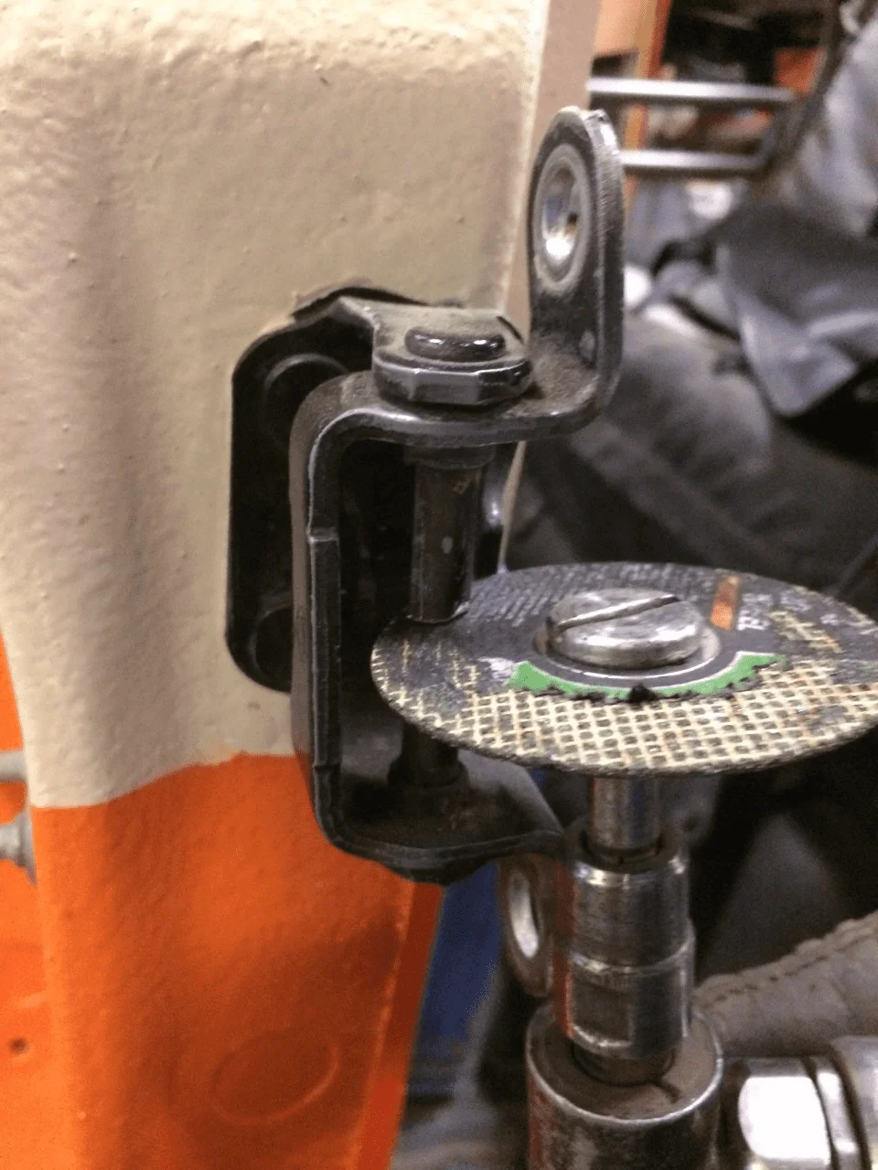

I found that hitch pins work to be able to swap doors on and off quickly. Same size as on 4runners. Only difference is top pin you have to put in from bottom side. Basically get two sets of hinges, cut out the old pin, and then leave one side on the car other side on your doors. see post 272 on my thread and it walks you through it.
Comments I have are to make a mount for mirrors and leave about 3/4" above the door handle so the mechanism has room to work still. Cupholders are a must also.
Thanks! i like the hitch pin, ill have to do that at somepoint. I really should of went back into your build thread to read the 3/4" above the door handle, i learned it the hard way lol.

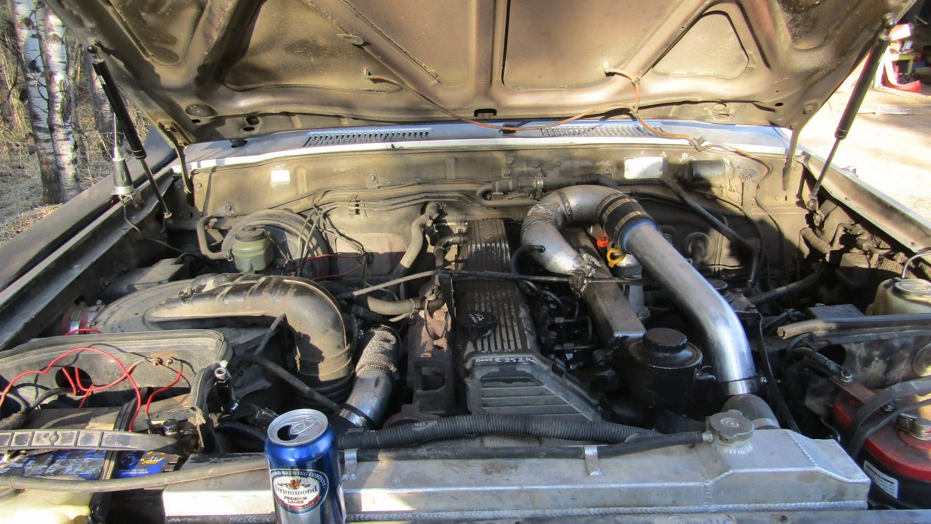

Intercooling for Cobbles! Started as a Sunday 'fun' project so I could ignore the things I 'should' be addressing. :hillbilly: ...several days later here we are. Nice performance boost on the highway, a hill I previously had to drop out of overdrive for is now conquered at desired speed with ease seeing much nicer exhaust gas temps. Time consuming and tedious yes, a water to air or top mount would be an easier way to go. But I had all the bits lying around shy of a few clamps, so spend my time and endure the tedium I did. A/c system was trashed when I got the truck so the junk condenser hit the road, as well as hoses to make a little space. Ended up making bracket that uses stock condenser mounting points and rubber isolators to hold steering and bonus trans coolers as well as main charge cooler core. Not much room to spare, I feel it could be done and retain a/c but would significantly up the difficulty level.

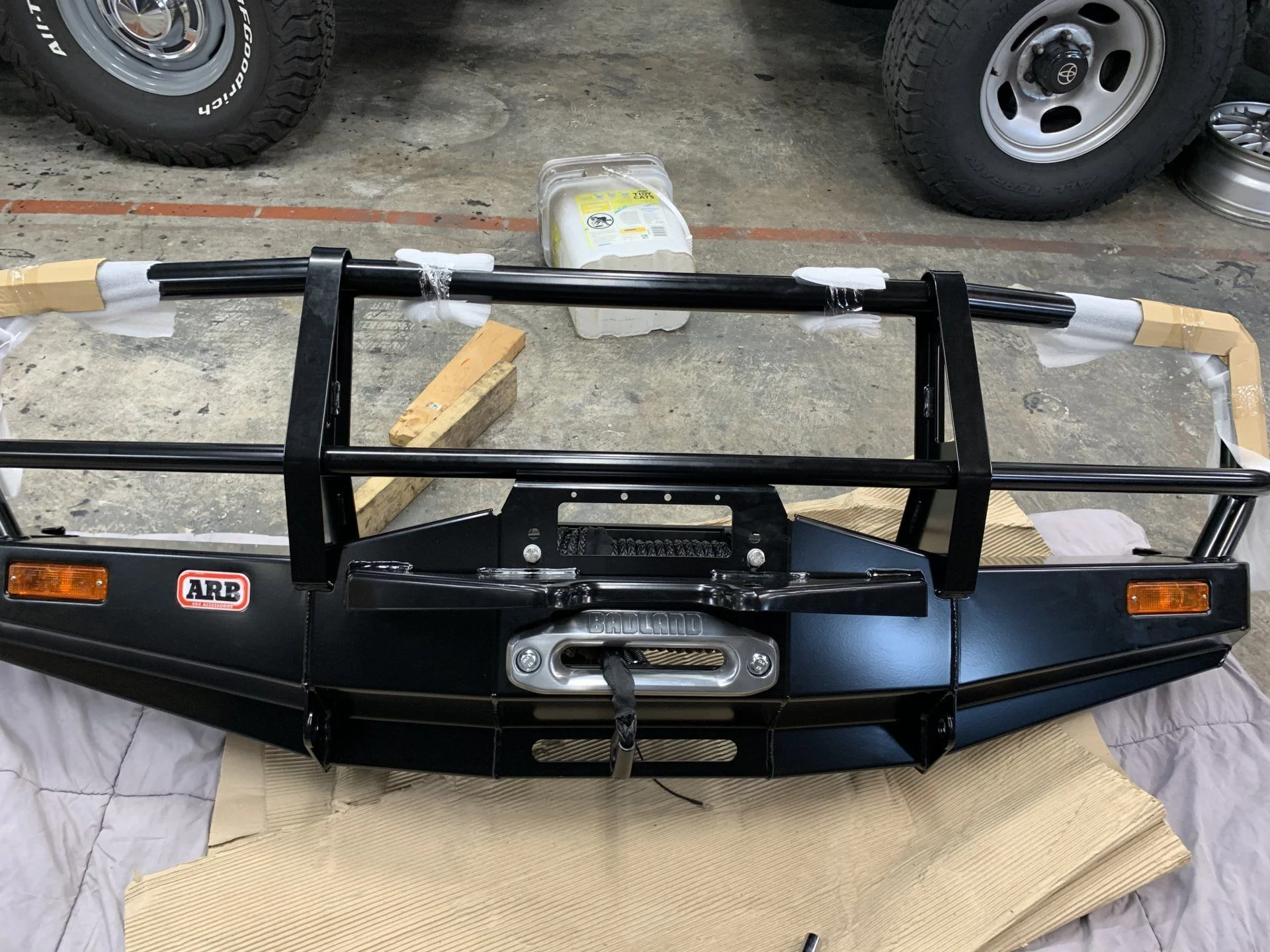

Thanks to John and Natalie at @white-knuckleoffroad,I put my third set of sliders on one of my Cruisers. This was my first 80 series set and I am as impressed as ever. Went with a 10* angle for more of a “step” as opposed to tucked in protection. Everything fit without issue and quality was better than I remember it being.
View attachment 2297855View attachment 2297856

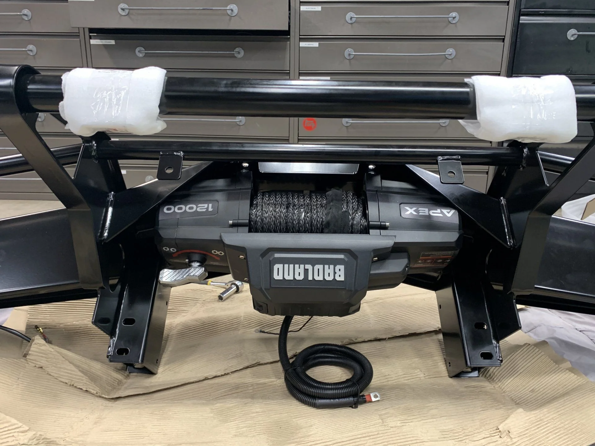

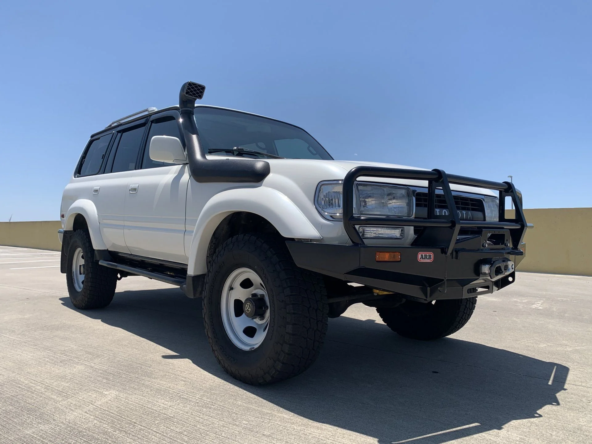

Then shortly after got my ARB and went to work mounting my Badlands Apex 12000 winch and installation on the 80.
View attachment 2297860View attachment 2297861View attachment 2297862
getter her ready for CO in September with the boys.
I have been searching for a writeup on putting that winch on an arb since I installed my arb yesterday. Typical spacers on the mounting feet?
Thanks
