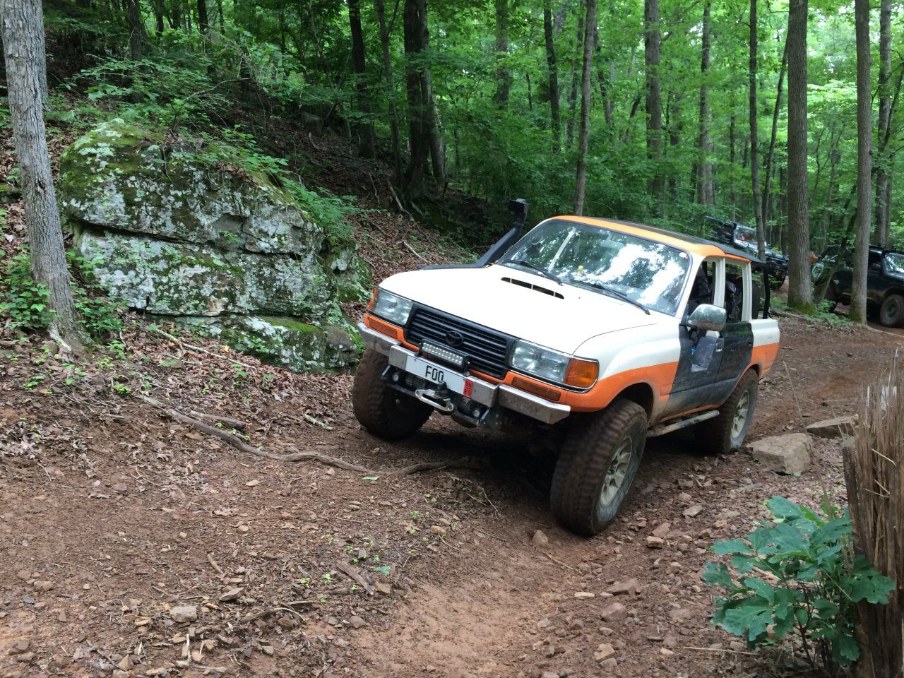

Been on trail for about three days and love the half doors, likely going to stay. The dust level has gone down 90 percent and the short flat area over the door handle is perfect height for your elbow. Think I'm going to add a little leather covered foam pad there much like the Tuffy box has.
For the front doors I'm just using the outside stock door handle. For the rear doors I'll probably leave the interior handle and exterior handle.

Bambi encountered on first trail ride with half doors. Waited 20-30 mins for momma to help move from much further away but wound up donning nitriles cause no way to get turned for difficult obstacles behind us.

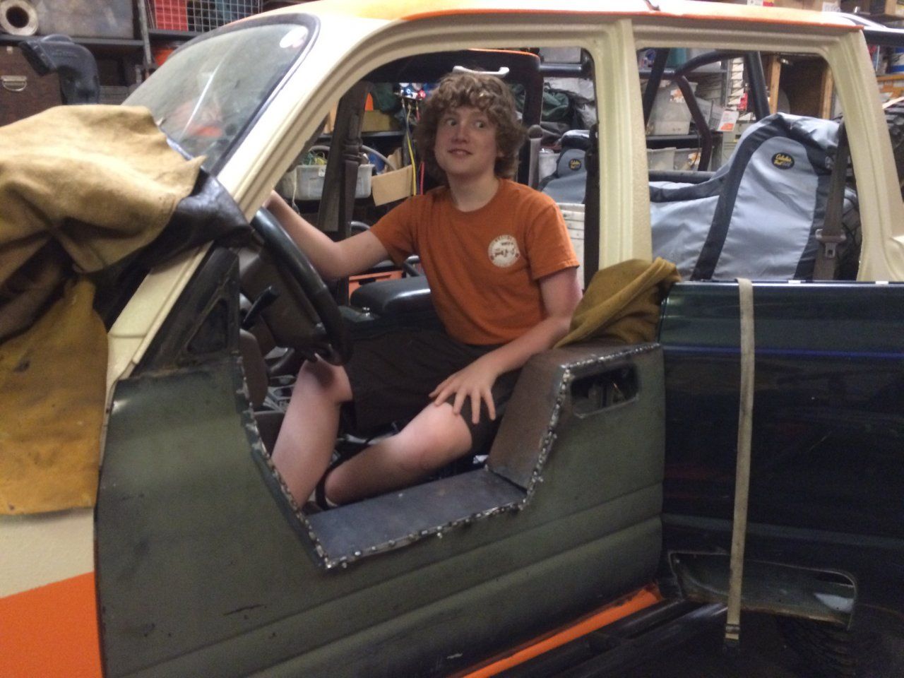

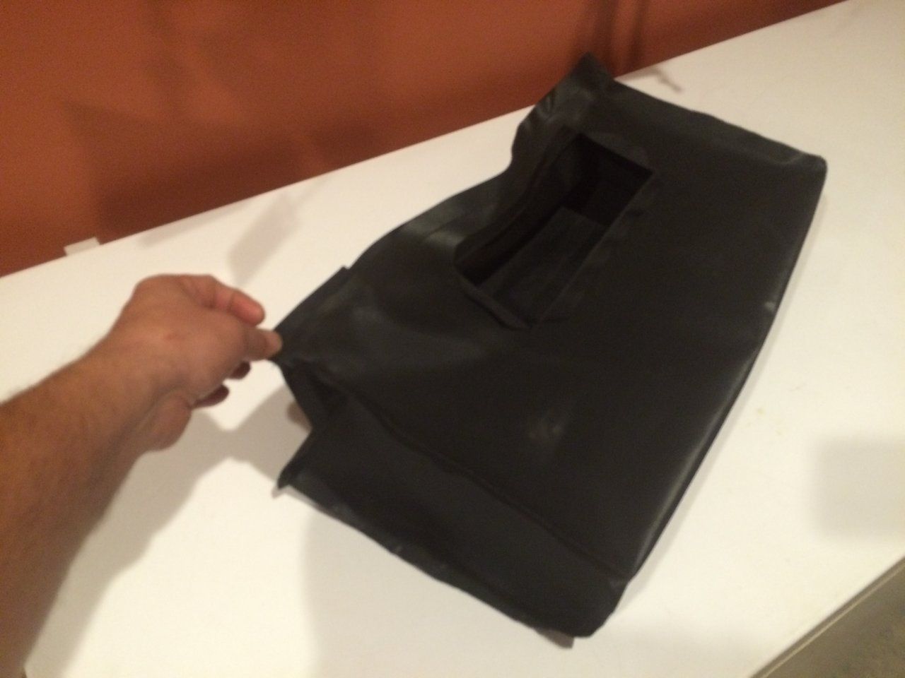

Started working on the rear half doors and I'm making some inserts out of some material to make use of the door panel areas for storage and trash . I'm also cutting off the mirror mount part of the door and putting a mount for a cheap style foldaway mirror
Got both rear doors tacked. Ordered cupholders on Amazon today

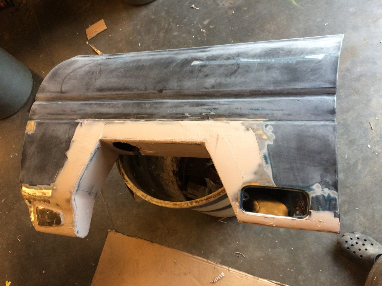

Pics of the Doors with mud ready to sand.
Got them roughed in this morning, and applied mud on the low spots, plan to paint with por 15 on the inside sections tonight.

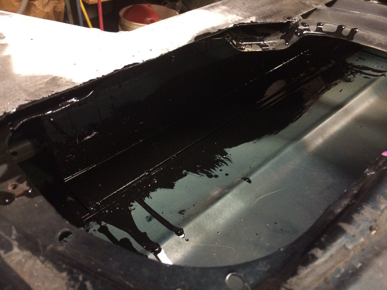

Po15 done. I assume these half doors will be full of water at one point in time, so hopefully this protection will be worth the mess. Looks like I Gotta do you tattoos, as most people know this does not come off very easily. Oops. Next up is to finish Bondo work, then shoot outside with epoxy

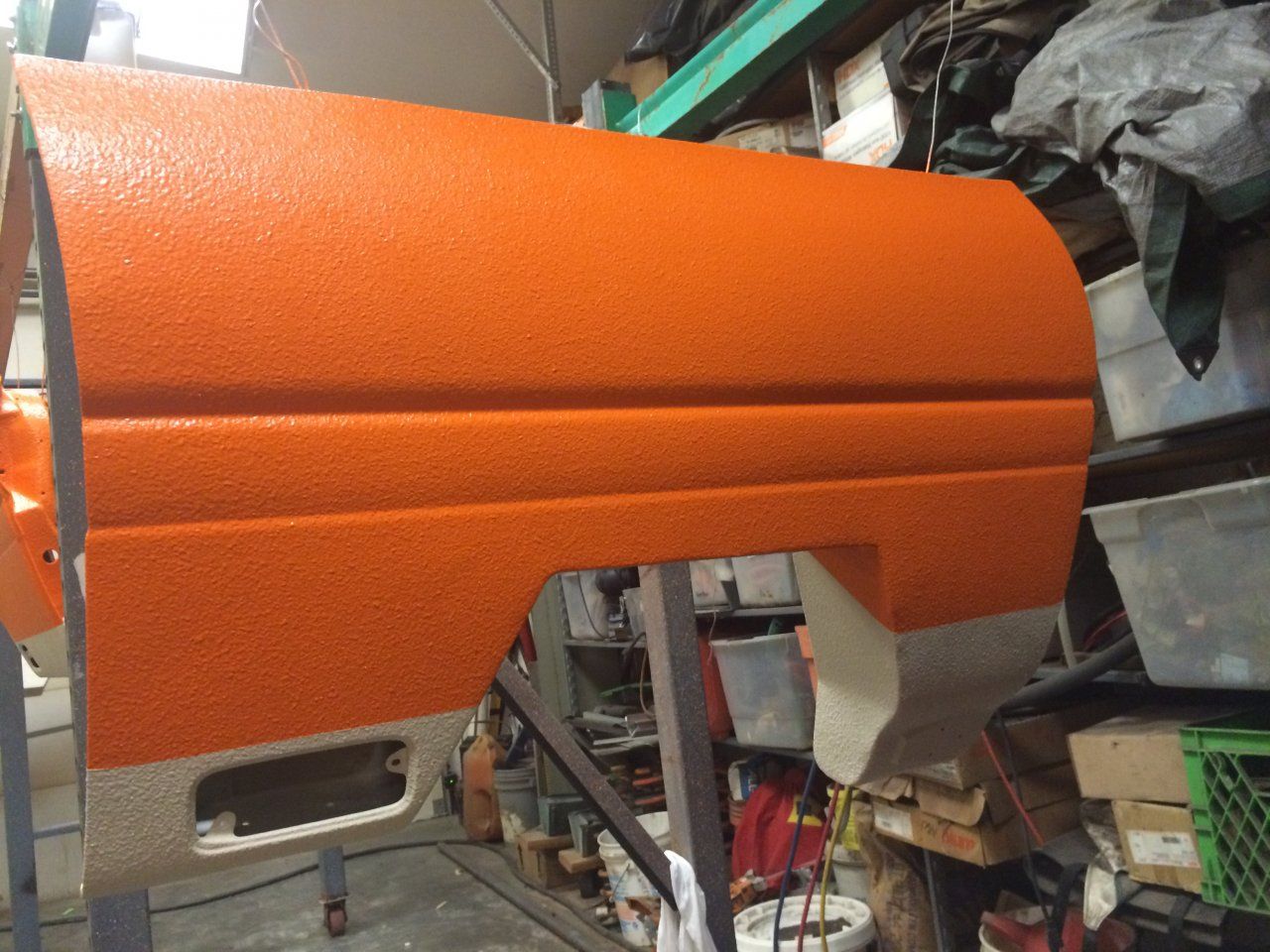

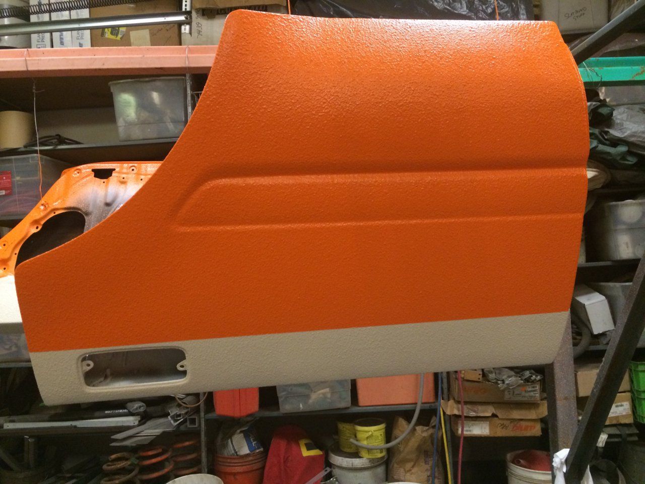

Monstaliner applied. Basically half gallon of the orange and one liter of the off-white. 750 g of Mostaliner base made about 1 L with the catalyst and color. Have them on my mobile painting scaffold hanging upside down If they don't look right to you turn your monitor over

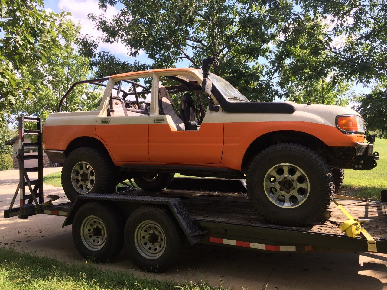

The moment you've all been waiting for.... Well maybe not everybody. Got the doors put on, onto the trailer, then headed to flat nasty in Central Missouri.

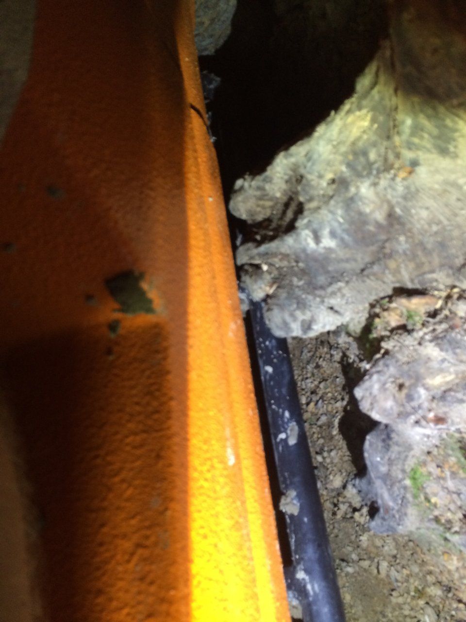

Got to the park, unloaded, and was on the trails within 15 minutes. Night Wheeling is so fun. Unfortunately dropped into a nasty V notch corner and the doors met a tree root. With the help of a lot of ballast, thank you friends, managed to escape with a couple tiny dents in the door.
