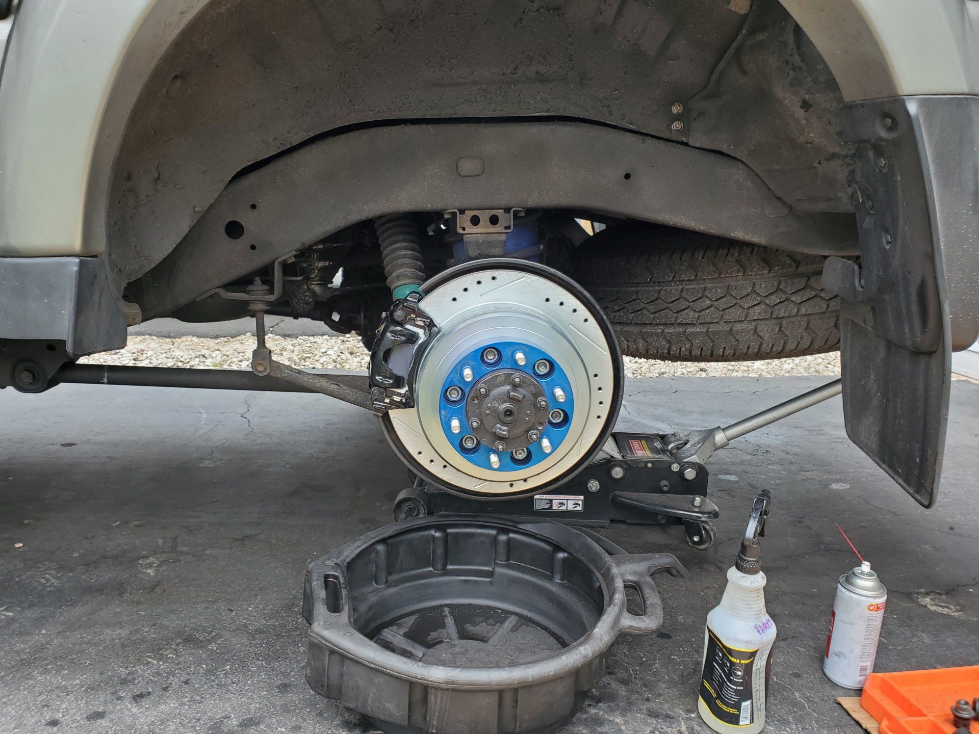

I just finished the rear brakes on my 80 with new Power Stop rotors and pads. I also rebuilt both rear calipers, new e-brake shoes and hardware. I had a set of wheels and tires that suppose to go on my 3rd Gen 4runner but decided to put them on my 80.
Nice!...I’m about to do all of this as well, where did you pick up the hardware for the parking brake and calipers?

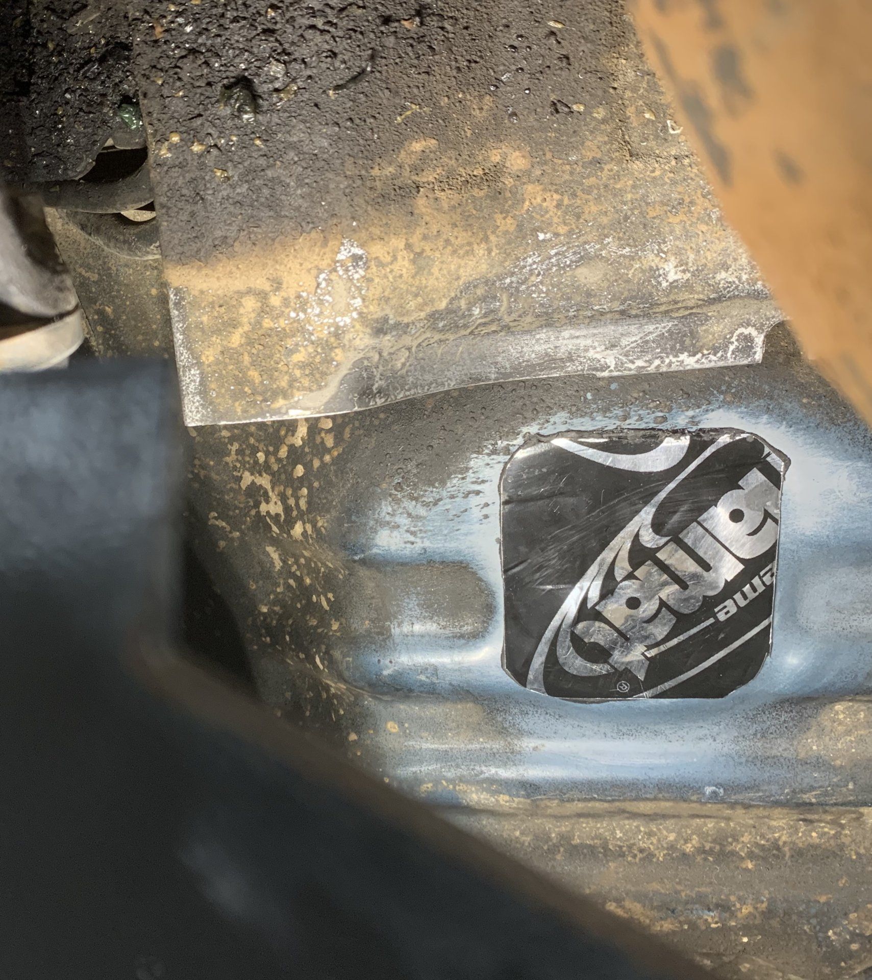

Pulled the seats and carpet out to start replacing things. Found a lovely hole in the passenger floorboard. Didn't look too bad at first until I started pulling up the brittle sound deadening stuff and it kept going and going. Also one where the seatbelt for passenger-side back seat mounts. Front one is repaired. Rear one will be repaired tomorrow then it's striping the rest of the old padding, etc from the floor before the dynamat goes down. Gonna repaint all of the plastic trim pieces while it's out of the way. I'll post some pictures once it's all done.

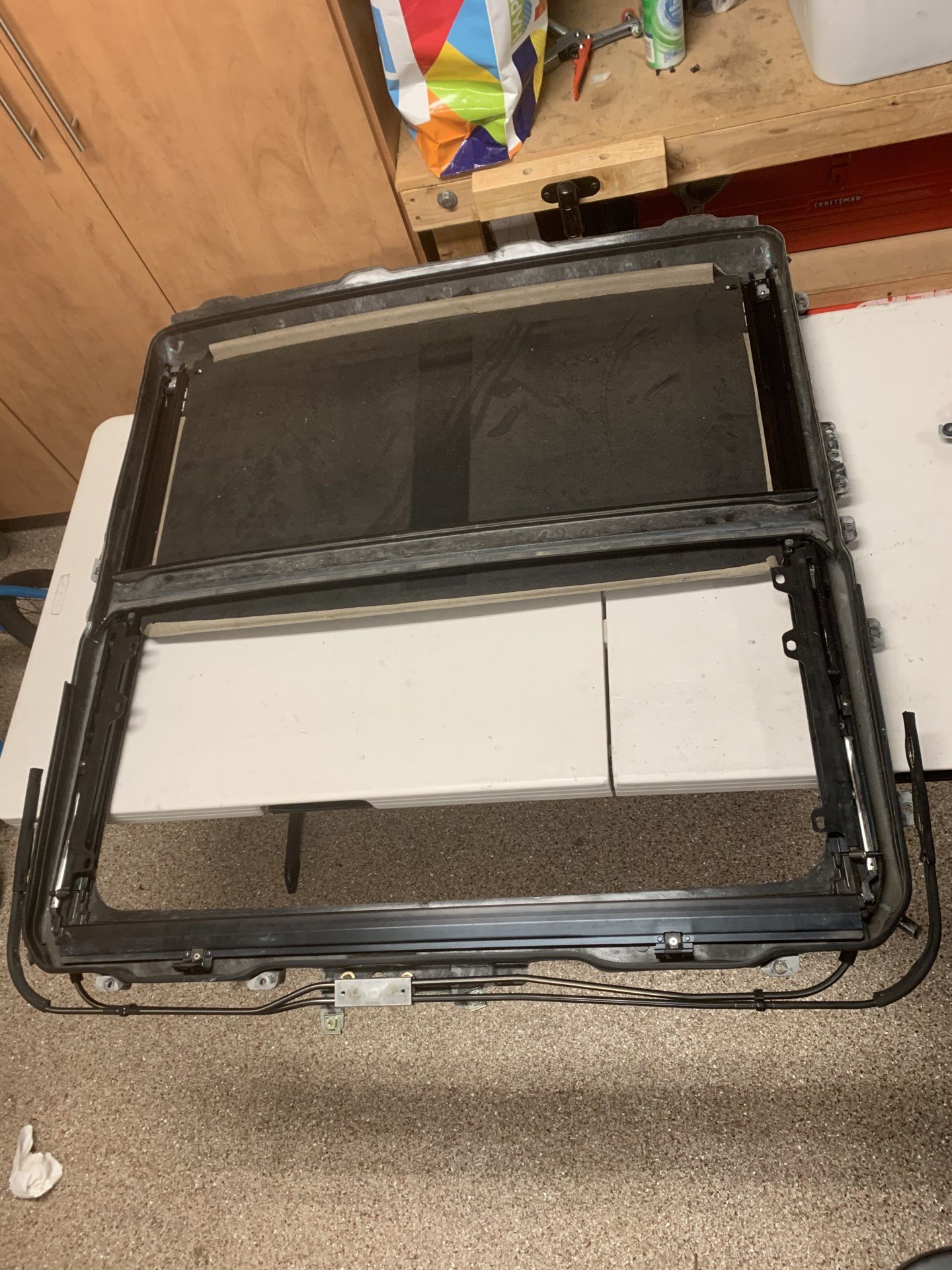

Finished swapping in the new sunroof rails. Now it is watertight and smooth as butter!

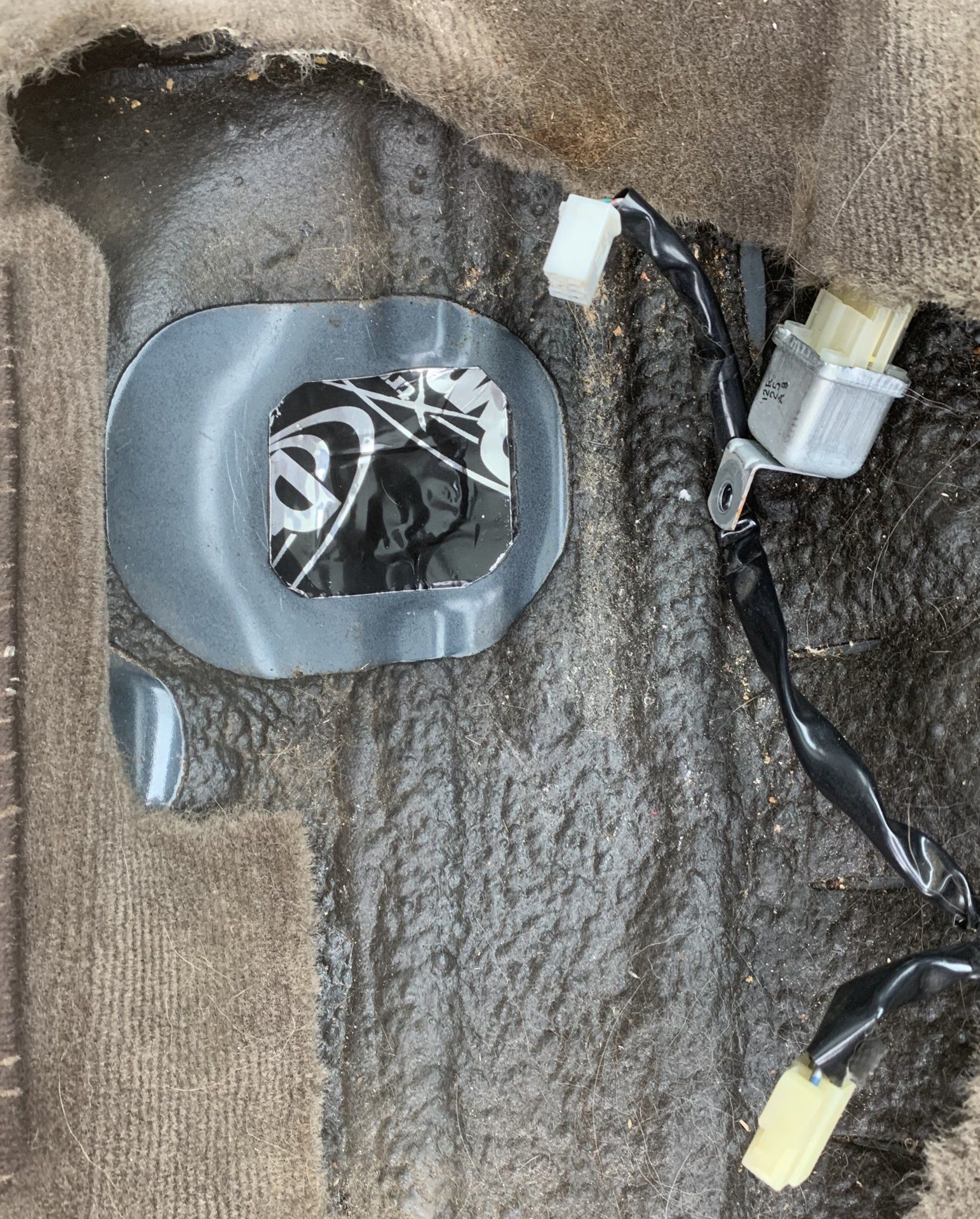

Also the passenger seat finally stopped working and is stuck all the way forward. So I removed it to fix the gears and remembered that I should finish pulling the rear heater as the rest of the heater delete is done under the hood. Sealed the hole with some dynamat I had lying around on the top and from underneath. I hope it’s watertight until I can get it welded up!
I purchased all my parts at Rockauto and used 2 sets of Raybestos WK1562, hardware H17394, and Power Stop kit K115636. I usually use the Toyota caliper rebuild kits but Raybestos kit was cheaper and the Power Stop kits have the pin boot kits for the brackets.

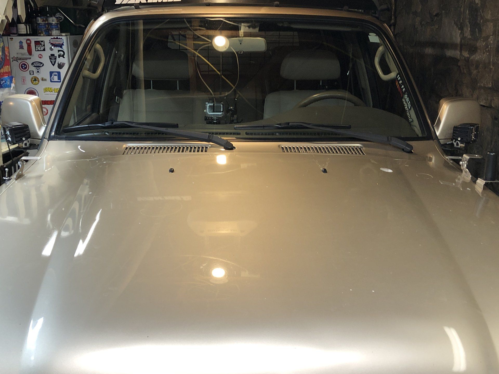

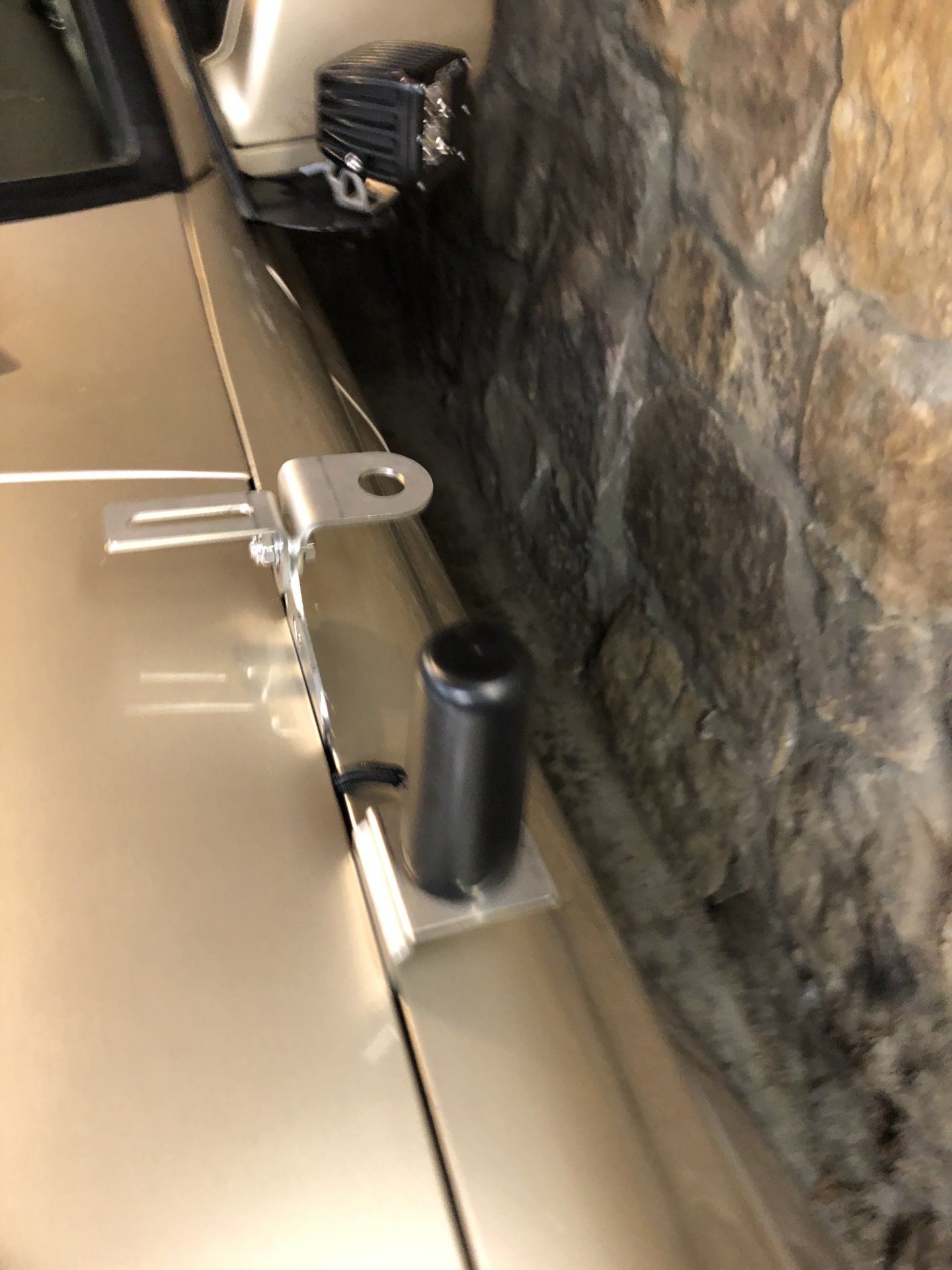

Installed some Massive Metal Shop hood brackets. Lights from HuddExpo get here tomorrow going to use the NMO bracket for a cb antenna.
Funny was playing with some LED lights that came on my 450 and was thinking of a way to mount them like that, looks like we have the same vehicle.
