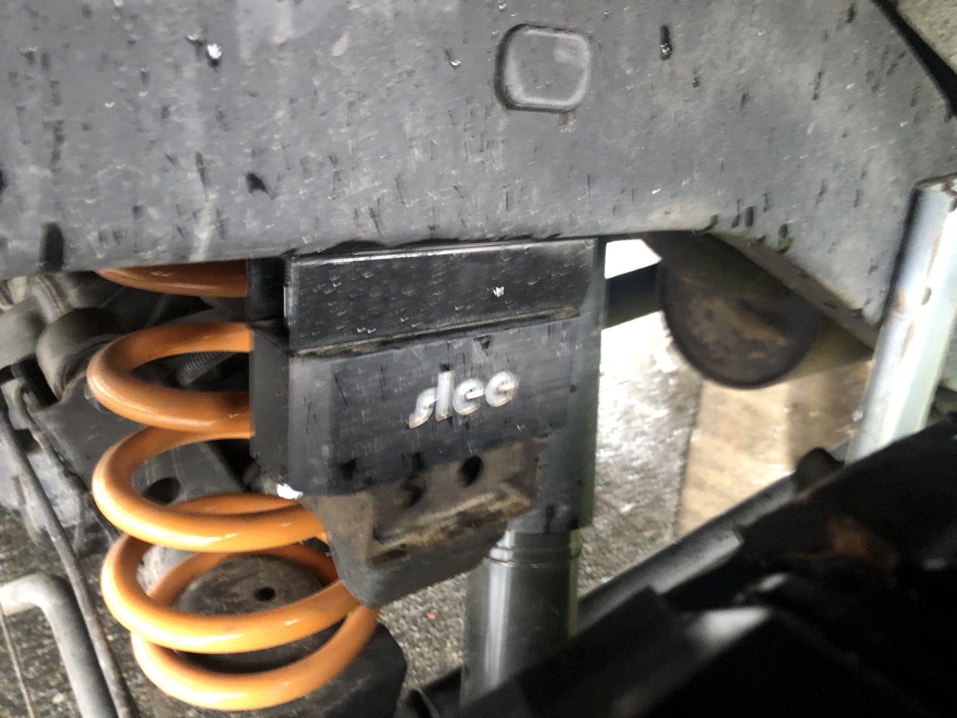

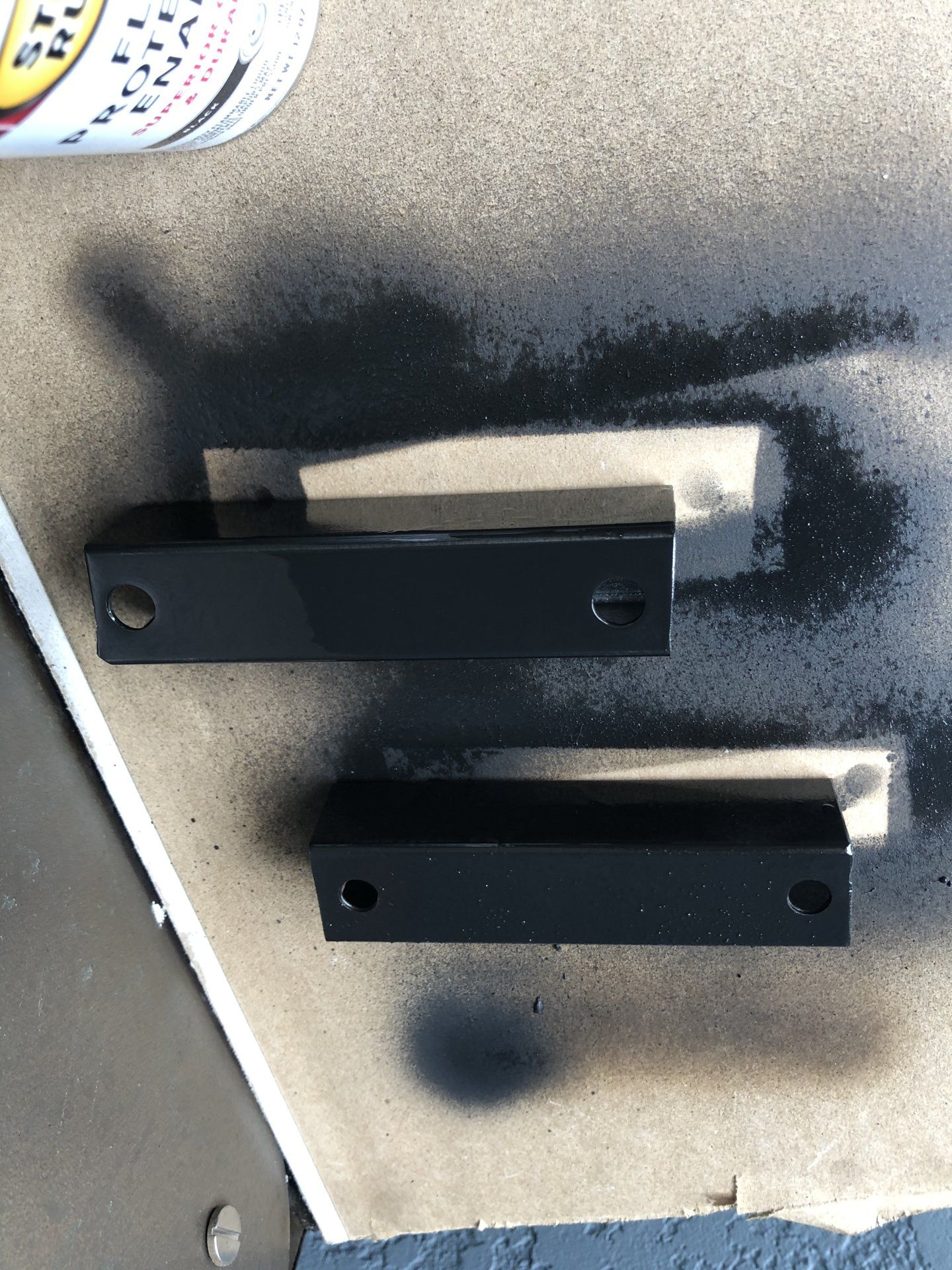

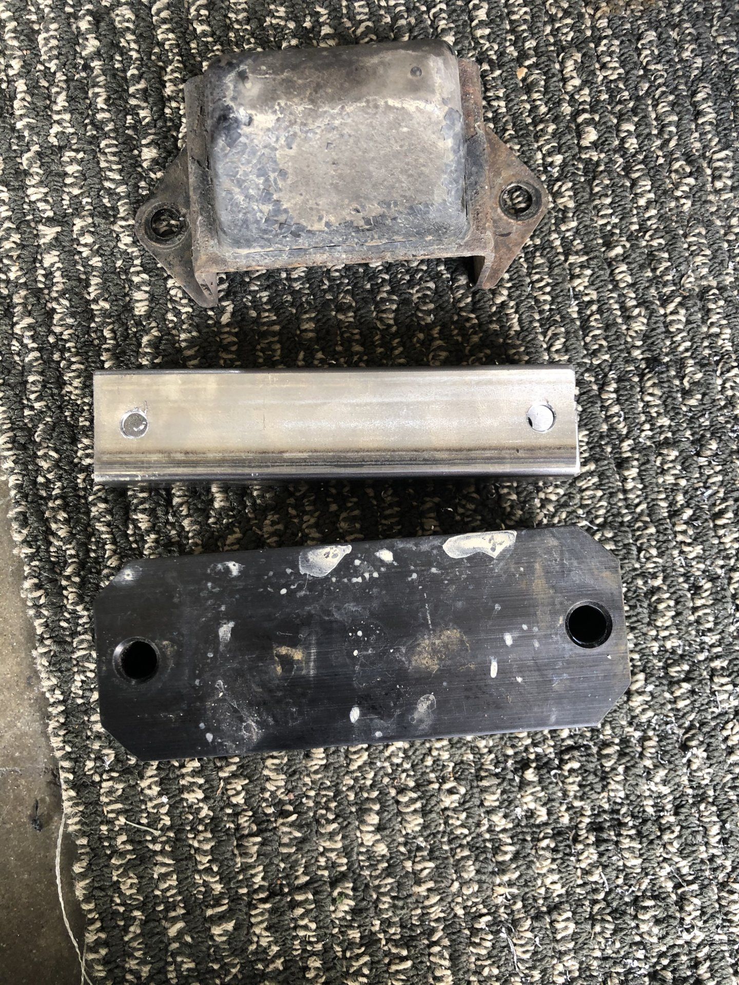

I found out my 2” slee bump stop extenders were not cutting it for my 2” ironman lift and 37’s when stuffing a rear tire. I took a little damage to my rear driver side rear fender on the initial flex test. I had some square 1” tube laying around so I made some spacers. I don’t have a welder or welding skills, so I wasn’t able to enclose or box them. This will have to do for now. I was able to source some longer metric bolts at my local Lowe’s Hardware store. I think the bolt size was 8.125 x 100? On my follow up test it seems to be enough to make the difference and clear both my rear fenders on full flex now.

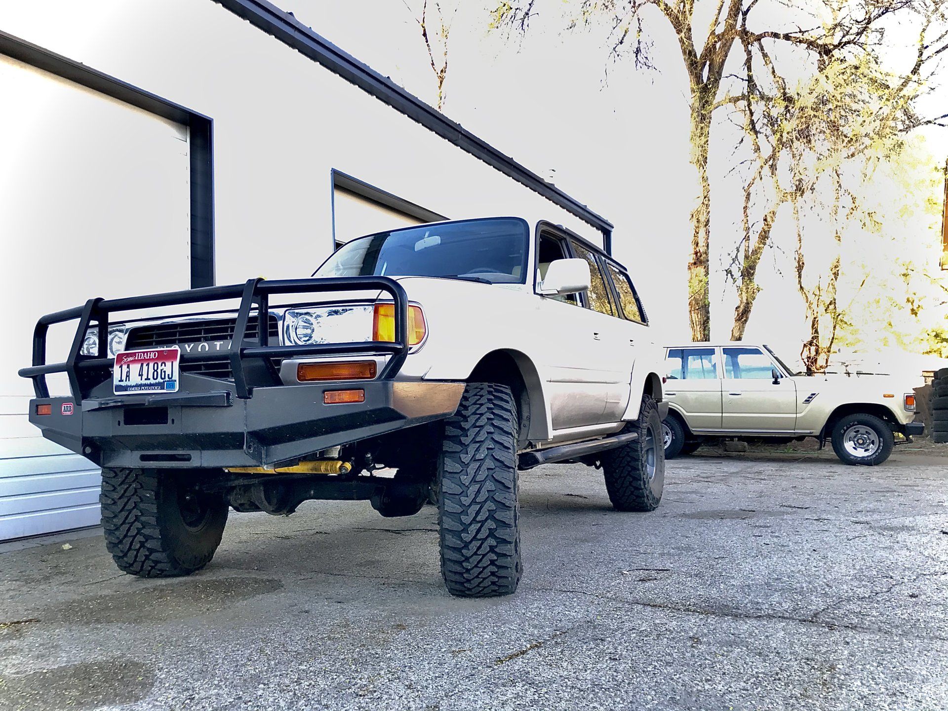

Nice! I've been debating 37s when i get new tires (also on a 2" lift) but don't want to regear ha. Looks good.
Not sure where you live but, I’m on stock gears and live at sea level. I don’t really deal with hills. It’s not that bad. I did just order gears to take advantage of the nitro gear sale otherwise I wasn’t in a rush to re-gear. I plan On hitting long roads trips Otherwise I could have chilled in stock gears for a while
At sea level as well and just installed a turbo. Gearing concern was more about crawling ability.

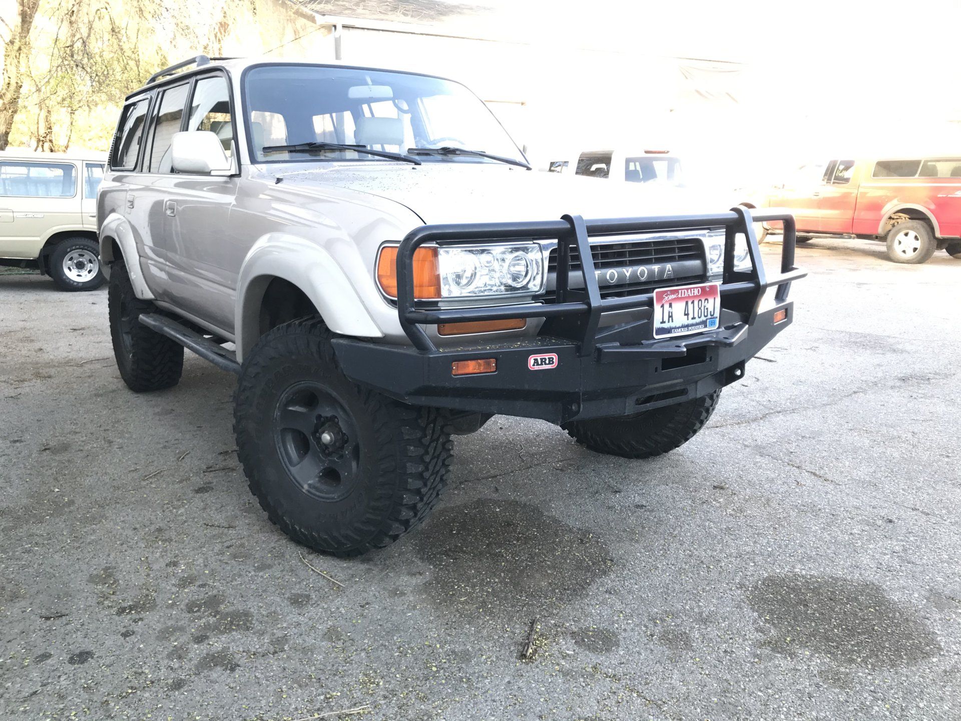

How has it been clearance wise running 37s on a 2" lift? What is your wheel size/offset? Read a bunch of threads on low lift/big tires (which i'm a fan of) but haven't seen any good definitive info on it.
These 37’” KM3’s are actually 36.5” tall according to BFG website. I haven’t actually measured my tires. I had a tiny bit of rubbing when turning into a driveway @ the back of the front wheel wells. My BFH took care if that. My BB wheel offset is 3.5” backspacing.
I’m pretty happy with it. I had 35’s before and I just needed more.
Nice, how do you like the 3" of uptravel you now have?
