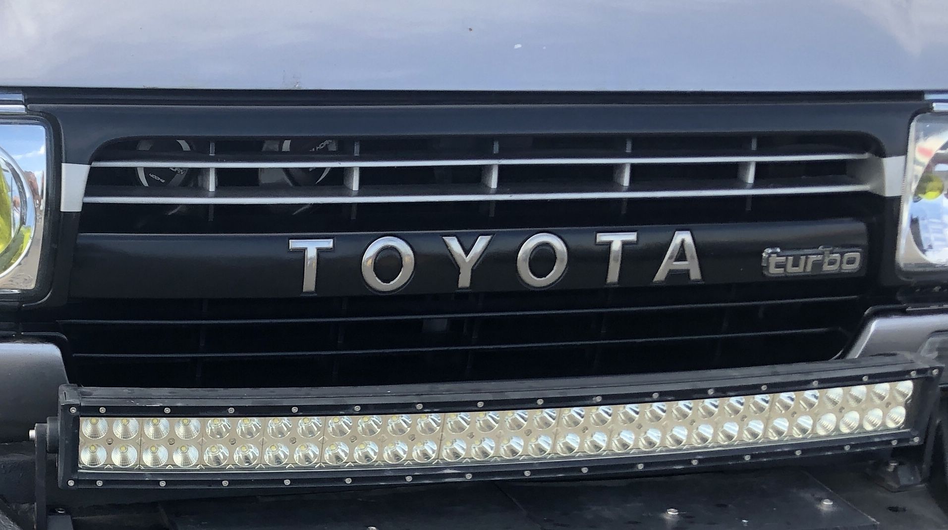

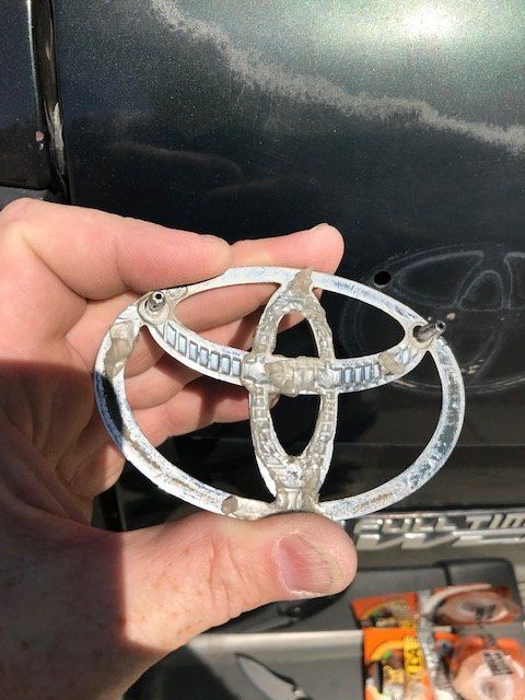

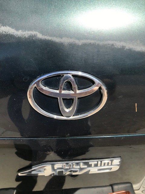

I used some Gorilla Tape (albeit sloppily) to get the logo back on...
I had to do the same a while back but used contact cement. Still holding up it seems like but not the prettiest if you look closely.
That's funny - wife suggested contact cement, but I thought something called "Gorilla" anything would be cooler.

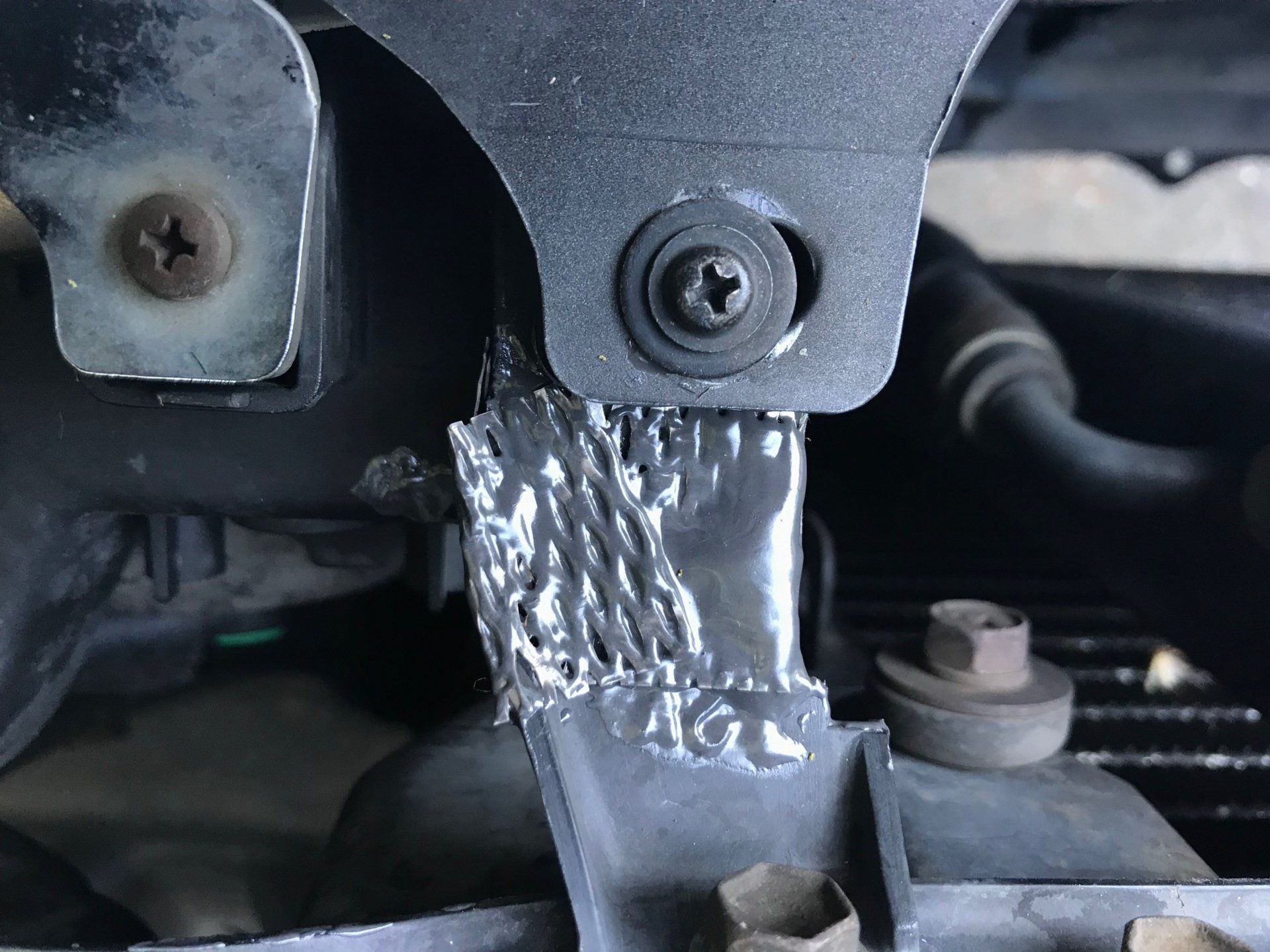

Started the weekend by hitting a deer late Friday night :frown:.
About 45mph on a two lane road and nowhere to go. Hit driver side just inboard of the bumper cap and pushed in bumper, contacted and bent valence, and snapped off one of the mounting points on the headlight bucket. All was repairable by re-bending metal and brackets except I will need to replace the headlight bucket. For now, I fabbed up a repair to the mounting tab using JB Weld and aluminum mesh. Not pretty, but at least I can drive the truck and aim the headlight.

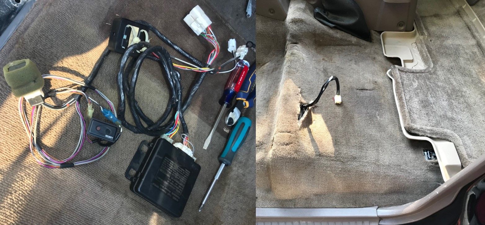

The real plan for the weekend was to remove the RS3000 security system. Following the first part of the thread below it was truly a (un)plug and play exercise. Thanks to @firetruck41 for posting.
HOW TO: Detailed DIY for Remote Start/Alarm/Keyless Entry
