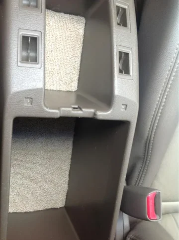

found drawer liner foam and cut it to fit the cupholders and center bins ( and the darn glove comparment....that's way more complicated...)

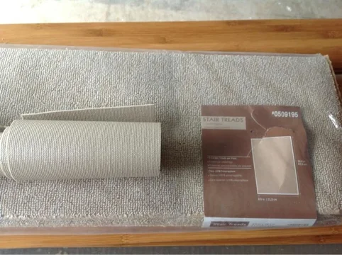

Then bought "tread" covers from Lowes and cup to fit over - and glued it all with contact glue.... I have to say it came our really nice for $10.... I also put felt tabs on all the contact points and iit helped minimize a few rattles...

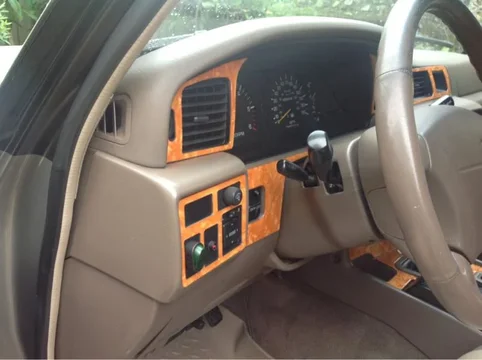

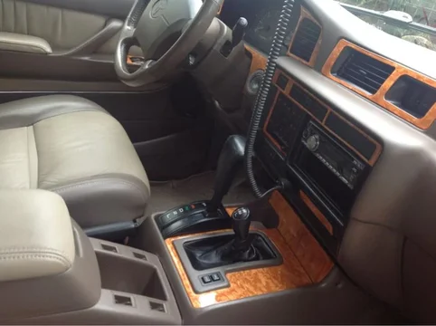

I also installed the finally parts from the CARID real wood kit..... stripped all the rest of the old trim and slap on the new - a HUGE difference for the money and it really lightened up the interior. Pics to follow tomorrow......

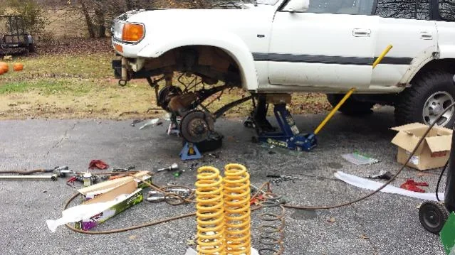

Making progress on the gears and front end.
Installed the rear third member.
Finished setting up the front ring and pinion.
tore down the front knuckles the rest of the way and Cleaned, cleaned, cleaned.
I got a small ultrasonic cleaner from harbor freight and put some degreaser in it. I took all the hardware and tossed it in there for a couple of min. and it does a great job of knocking all the grit off. makes reassembly way nicer.
I have a set of these off set king pin bearings that I'm going to try to add another 2 deg. of castor. Depending on the orientation when you install them you can also get camber if you want. I may set it up for a couple tenths of camber too.

Pics of the cheapo console rehab project - you can't see the rubber underlay but it make a diffence in feel.

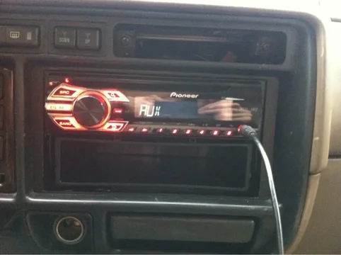

Threw this hell-raiser in. I wouldn't recommend a sosche kit for a 97 LC unless you have an engineering degree. But the radio is in and works beautifully.
