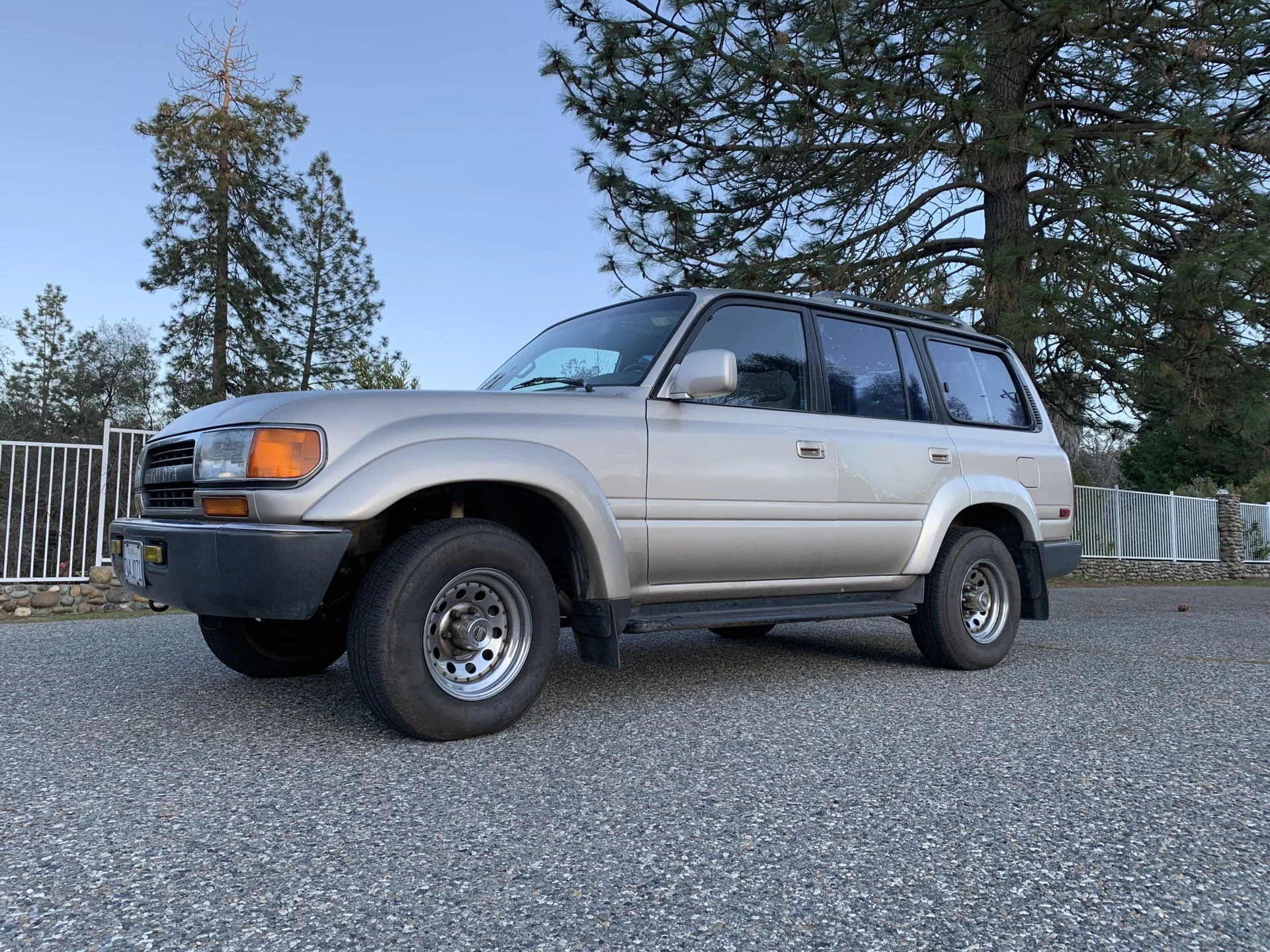

Bought one.
Got a '91 with 313k on the clock. Front axle will need to be completely gone through. 1300.00 was a good price for a project vehicle. It runs, drives, stops, passes smog, and is registered.
Fixed most (hopefully) of the vacuum leaks.
Fixed the rear door interior latch.
Stopped by Marlin Crawler and got knuckle rebuild kits.
Stopped by Trail Gear and got rubber wiper kit.
Ordered up a couple zip lockers and a 100% duty cycle Vair compressor from Amazon.
4.88s are on the way from IPOR.
Ordered up a Wits End inner axle seal tool.
