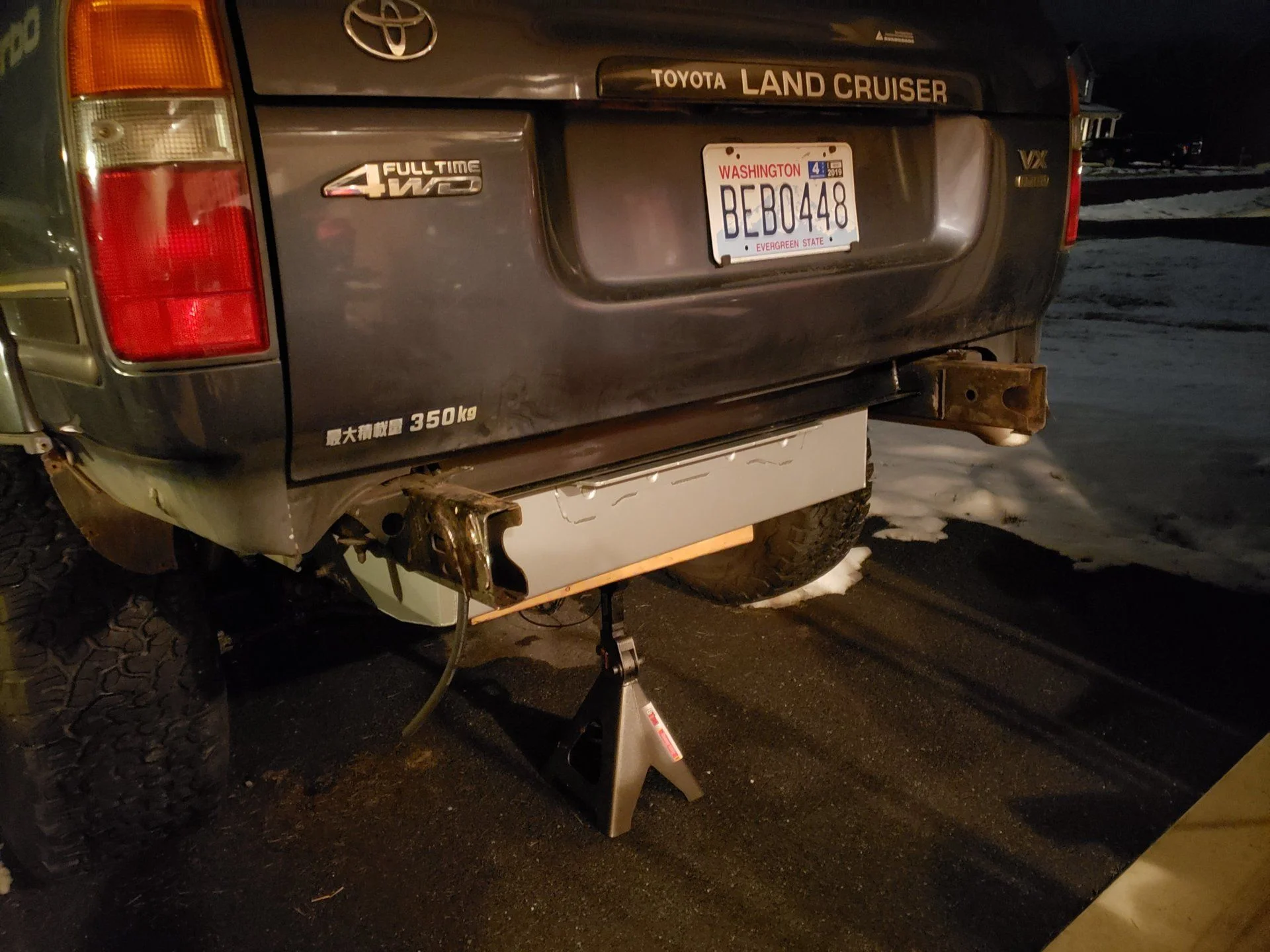

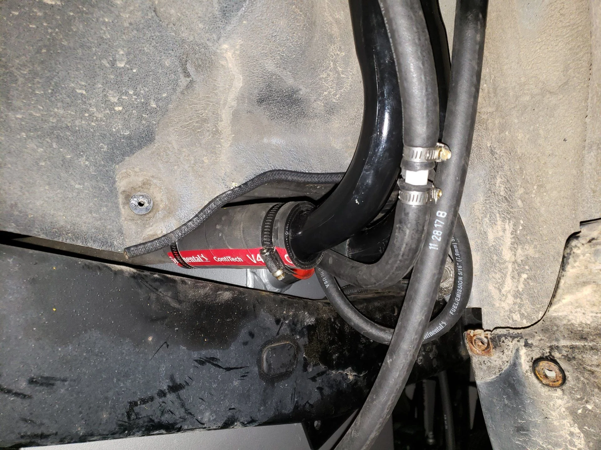

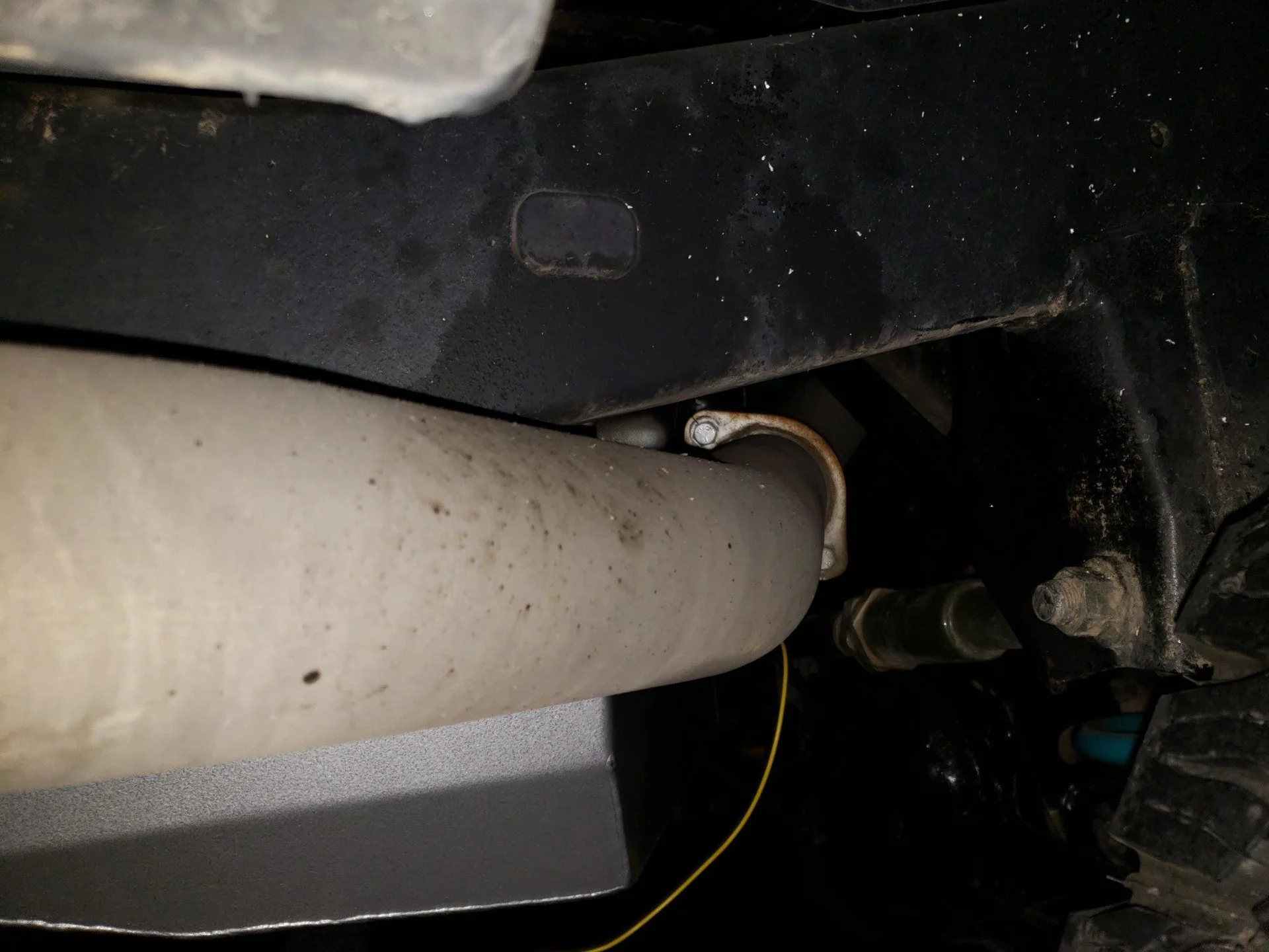

Adding a LRA 42Gal/160L Aux Tank and 4x4Labs rear bumper.
The directions for the LRA Aux Tank need work. My 1990 HDJ81 did not come with the Captive nuts in the cross member above the axle (2nd to last rear cross member?) so I drilled 4 holes and was able to add nuts on the inside. Surprisingly, Mr. T had 4 holes in there that allowed me to put the backup wrench. Ideally, and after confirmation from @wardharris and George Esterer, Rivnuts are the way to go.
Since I was trying my utmost to finishing the install (no corners were cutted :D) I decided to use the M10 Bolt + nut combo.
I did add waterproof Deutsch connectors to the Sender on the Tank and the pump so it is sort of plug-n-play.
The 4x4 Labs bumper install is straight forward. I do recommend getting a hold of a neighbor or friend who has a plasma cutter to get the Rear cross member off. Saves a ton of time.
But, you still have a few tabs and weldments left that need to be ground down.
Another note is that the rear bracket supplied with the LRA 42Gal aux tank gets in the way of the 4x4 Labs bumper so, (because they both use the 6 captive nuts that hold the tire carrier) the tank will have to be mounted to the bumper with a custom fabricated bracket or mounted straight to the bumper itself. More to come on this.
