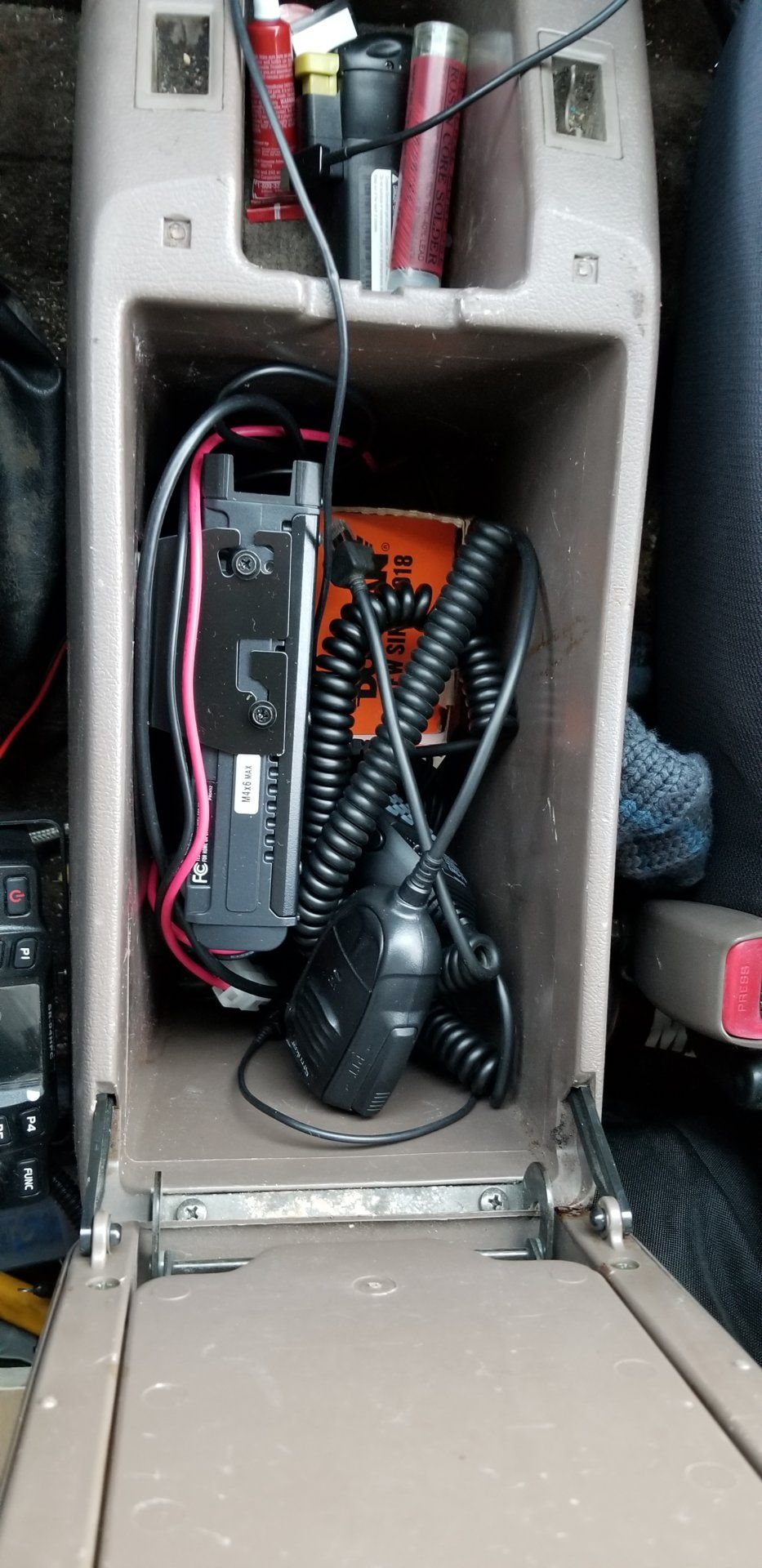

Here is a shot of the remote faceplate for the Alinco. And the body is in the console. Dont know if I will keep it permanently there. But its good for now. I keep both mics in there when not in use.

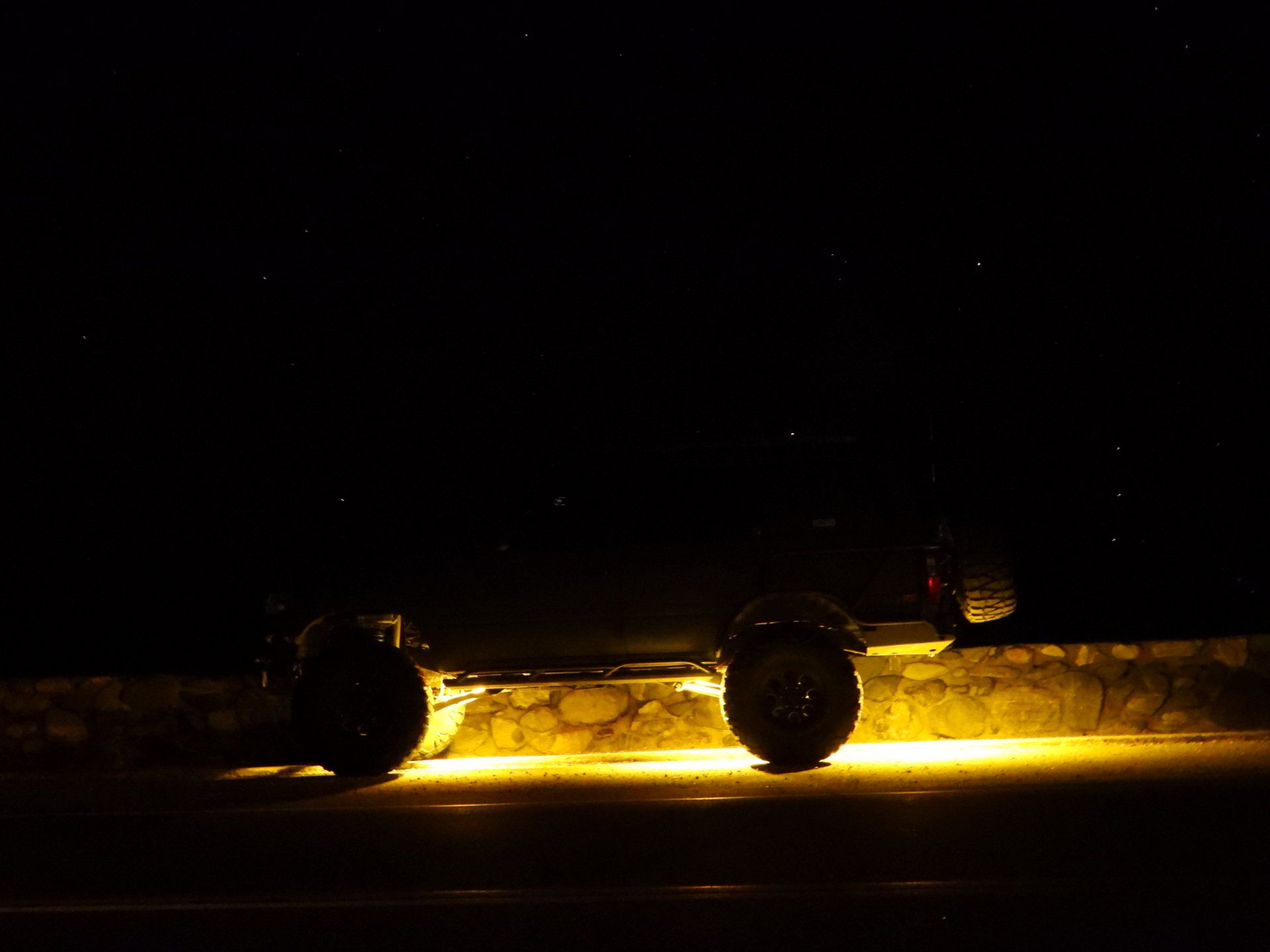

Finally got a picture that captured some stars nikon P1000 hampton beach avoiding the holiday entirely. Also notice the sway bar is razor blade close to control arm on driver

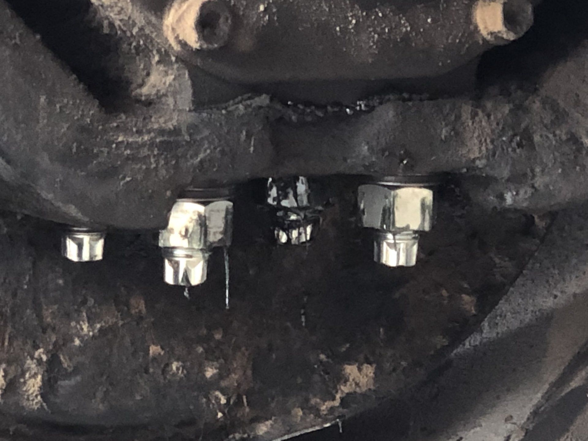

Replaced the studs on the knuckle today and tightened down belts. I did use locktite as well. Nothing crazy, just a little Blue Locktite. Nuts were torqued to 75 the studs 45 or basically snugged and 1/4 turn.

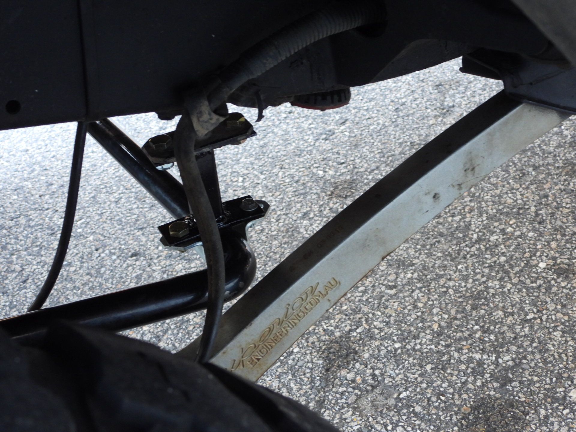

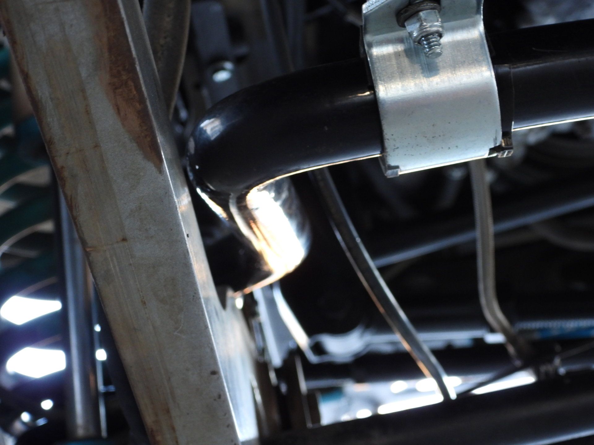

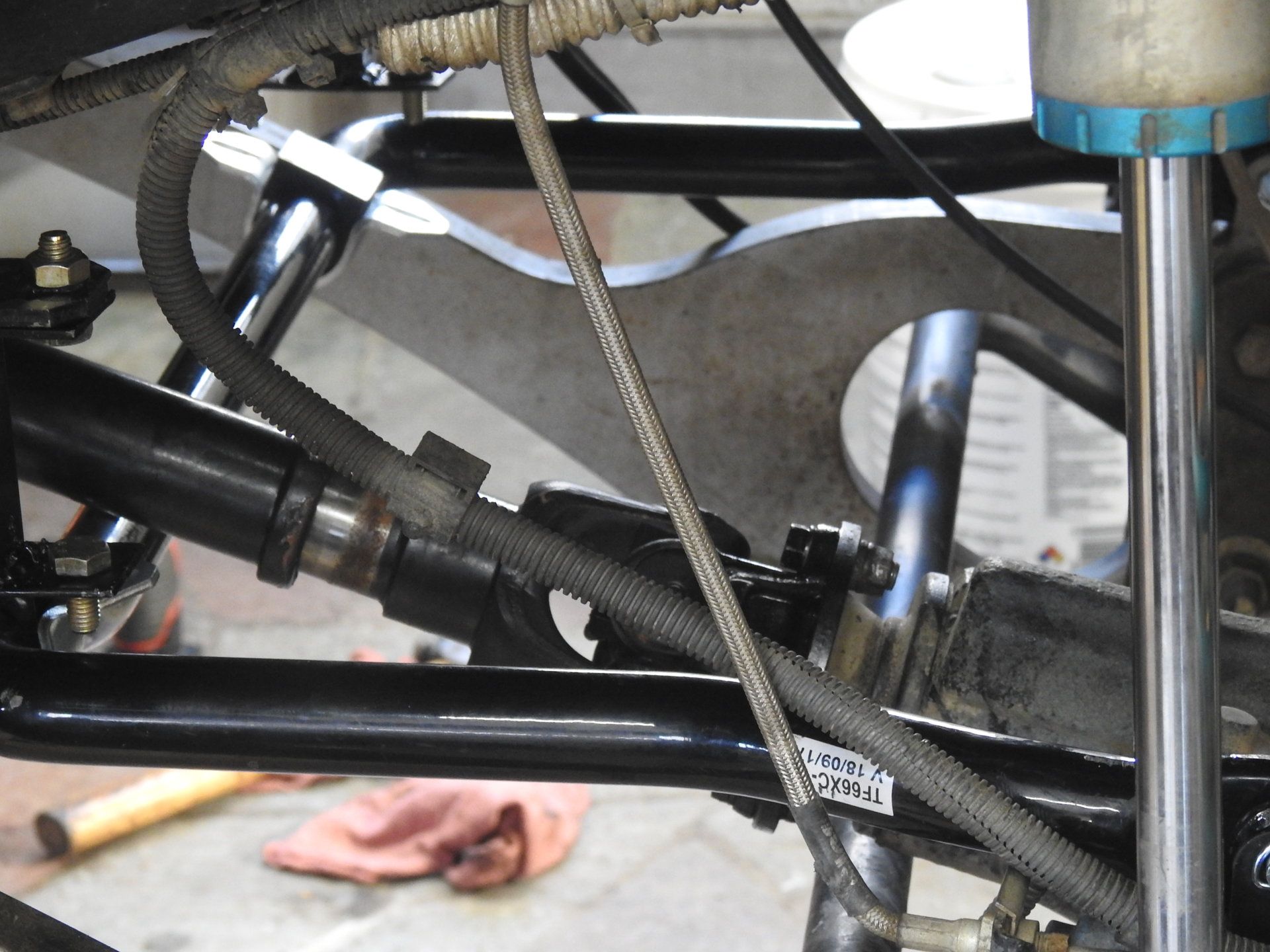

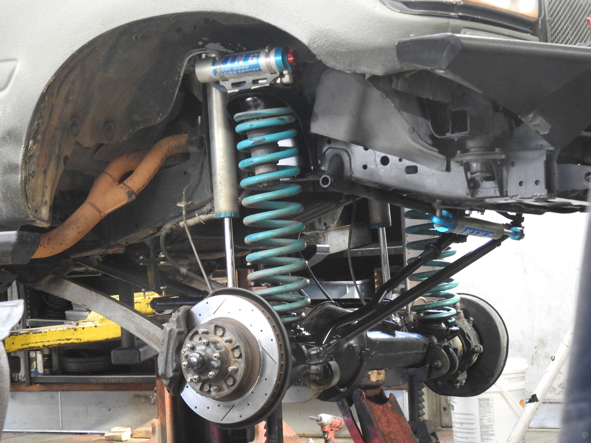

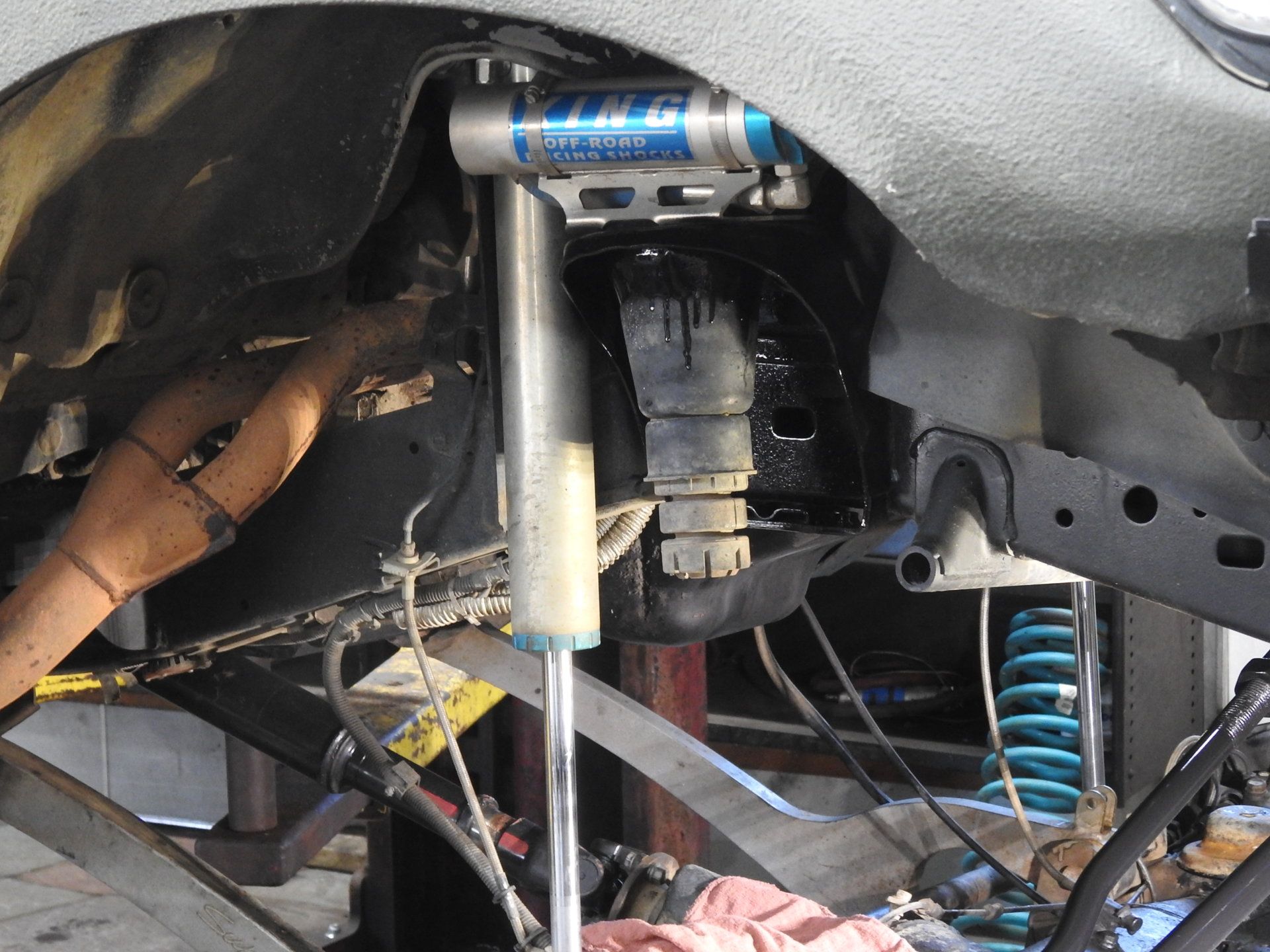

Finally got around to installing my whiteline heavy front sway bar with LCP quik disconnects and WTF have i been waiting for the truck is on rails now, granted I have fr/rear whitelines now the super heavies but damn they work broke the clips on the LCP disconnects right away but I believe he redesigned and made them mo better, BUT I do break shiite so its not on him. Also realized my slee ext SS brake lines dont quite keep up with the droop the superflex/king/dobinson combo allow. so I gotta get custom to make be longers. and yea I laid the gloss black on thick up in the spring towers but Shes still got no rust second northeast winter on deck, which is why Im outta here cali bound or death next week.. and MOABView attachment 1861441 View attachment 1861442 View attachment 1861443 View attachment 1861444 View attachment 1861445
Have you done a full droop with the sway bar in the up and stowed position? I did my own QD and with these longer Dobinson shocks and tapered coils the front DS contacts the sway bar when wheeling. I welded a silver dollar size tab to the frame so my sway bar was up high when disconnected so as to not limit up travel. Your situation may be different. So now my front sway bar spends most of the time in my garage - does drive better with it installed though.

I have a little not full blown(droop test) and the truck is perfect with both heavy sways in without front shes rolly.
