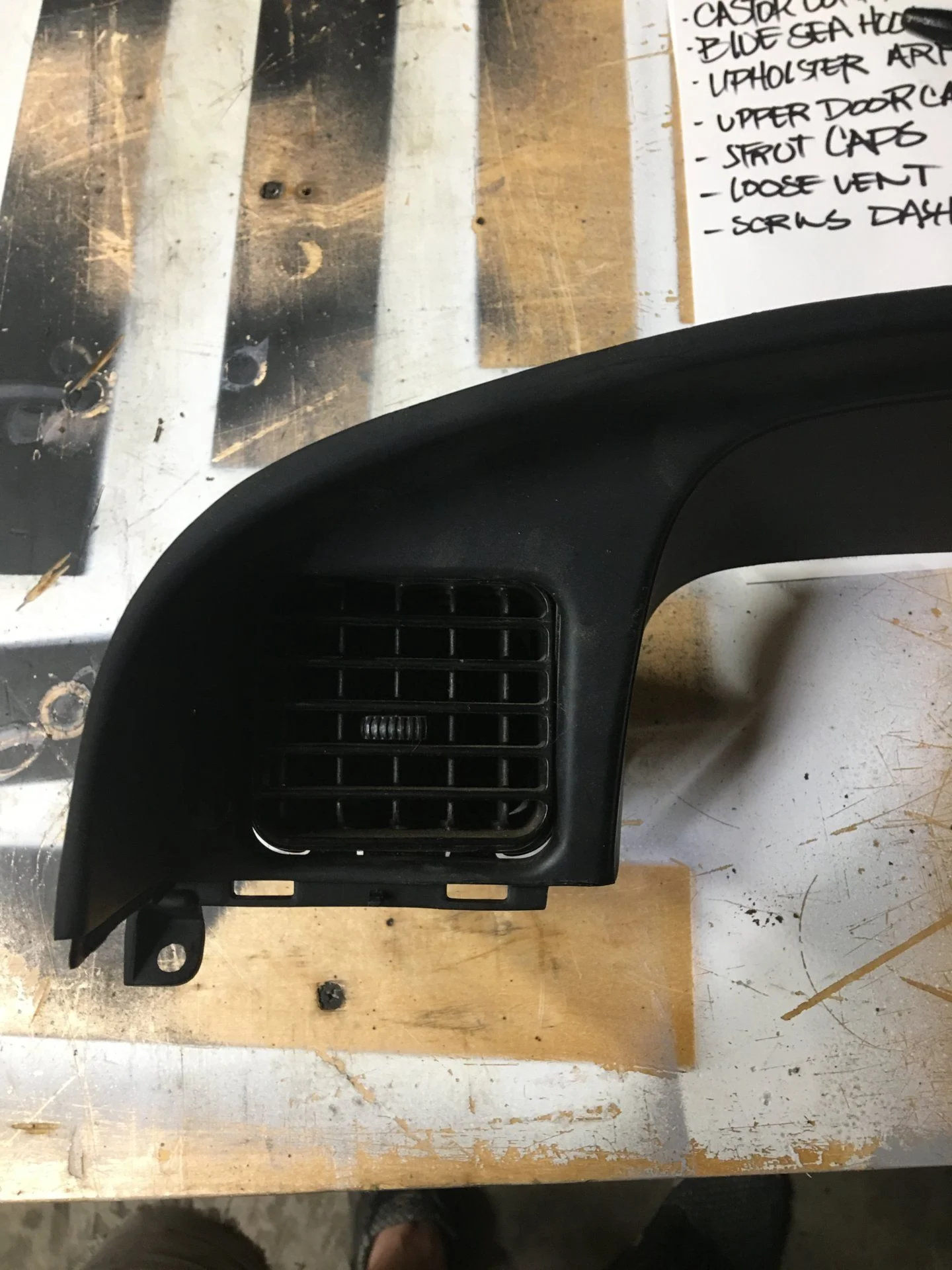

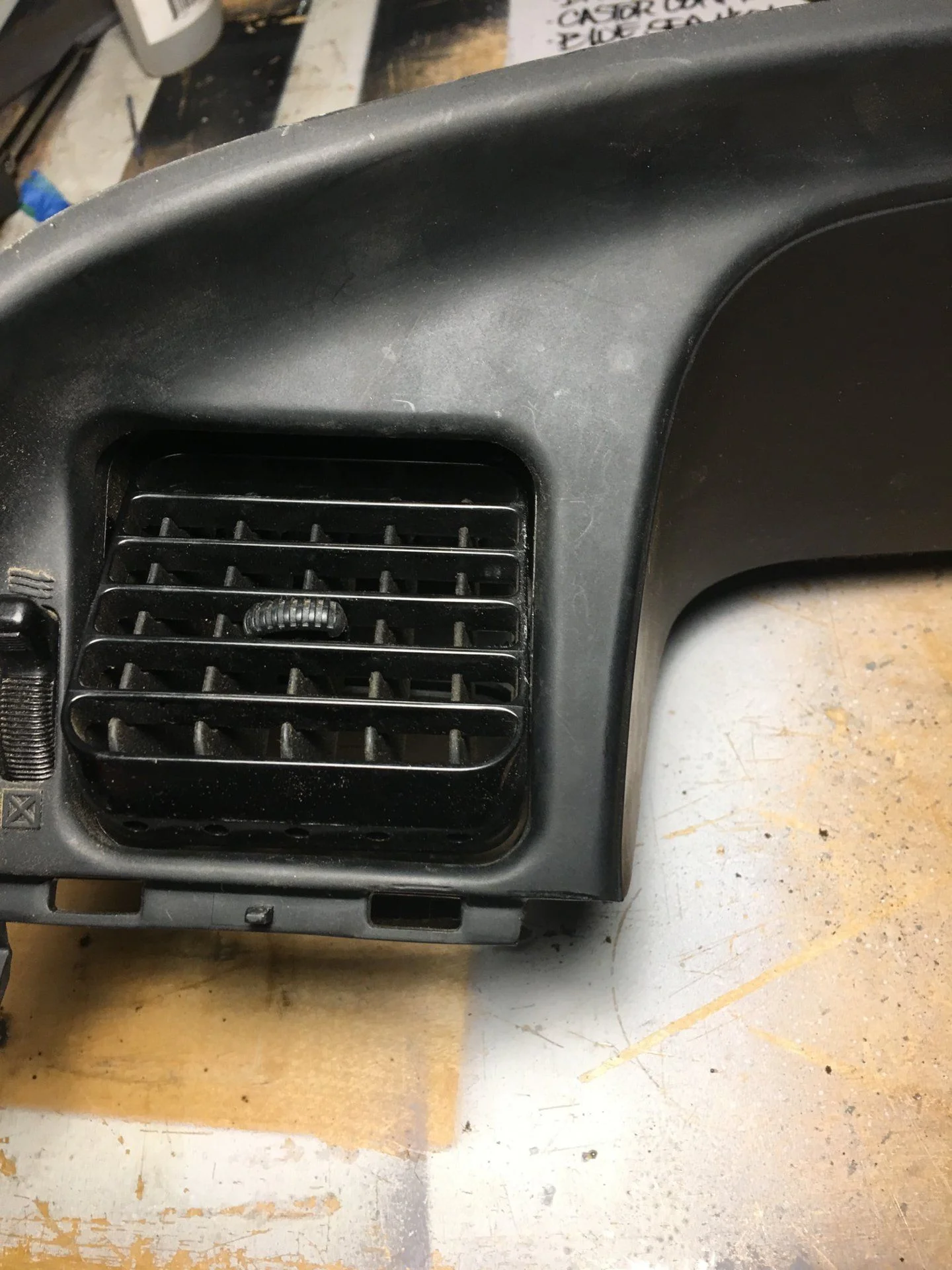

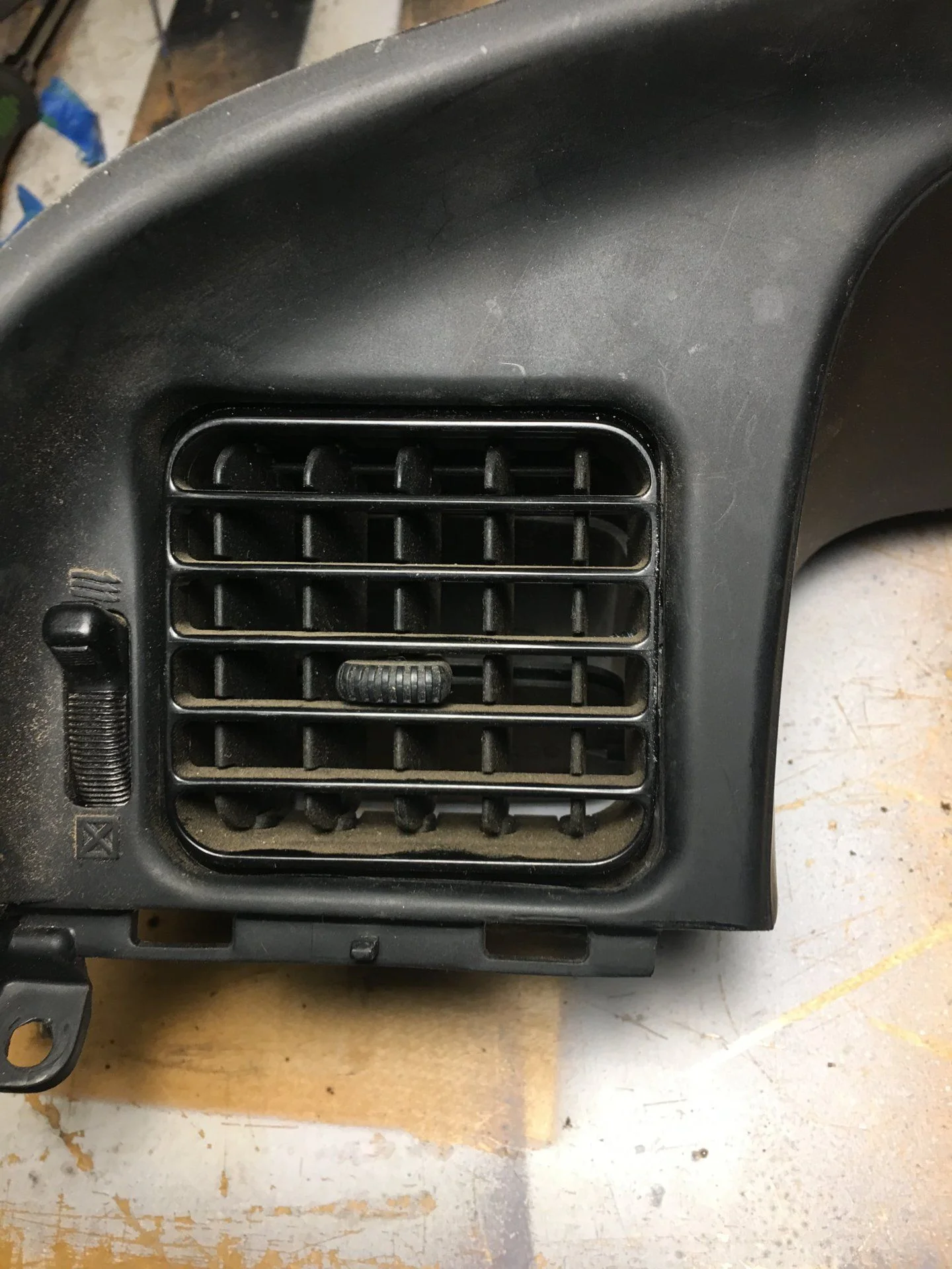

Ever so often I get floppy vents on the 80. They do not stick and stay and it can be annoying. I came up with a solution that works really well on and off road.
You can see in some of these photos that the floppy vent is caused by these posts breaking off, and the best way I've found to remedy this is to replace the posts with sheet metal screws. I'm sure other screws will work, I've just had these on hand.

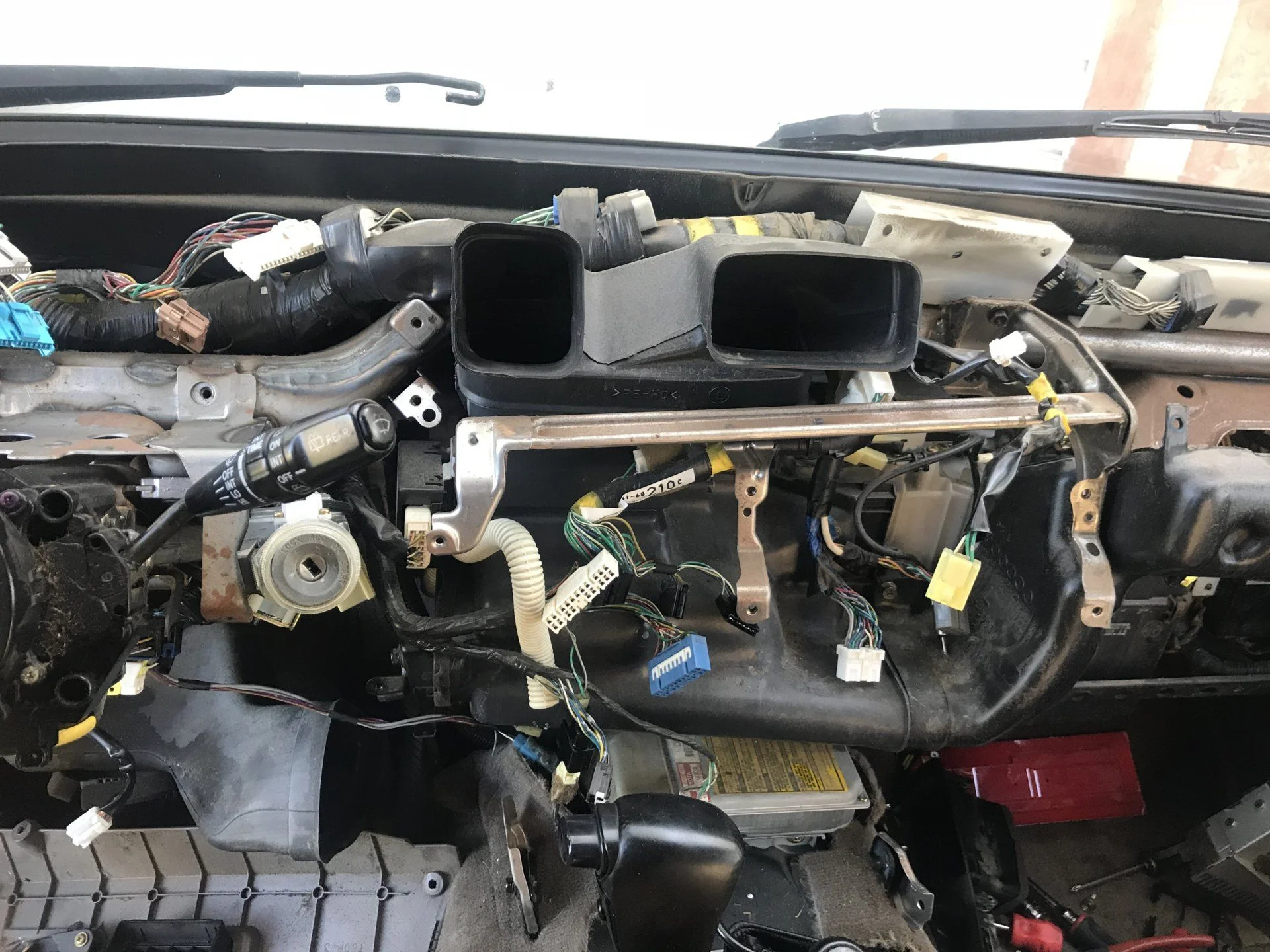

First I remove the dash pieces and get em on the workbench.

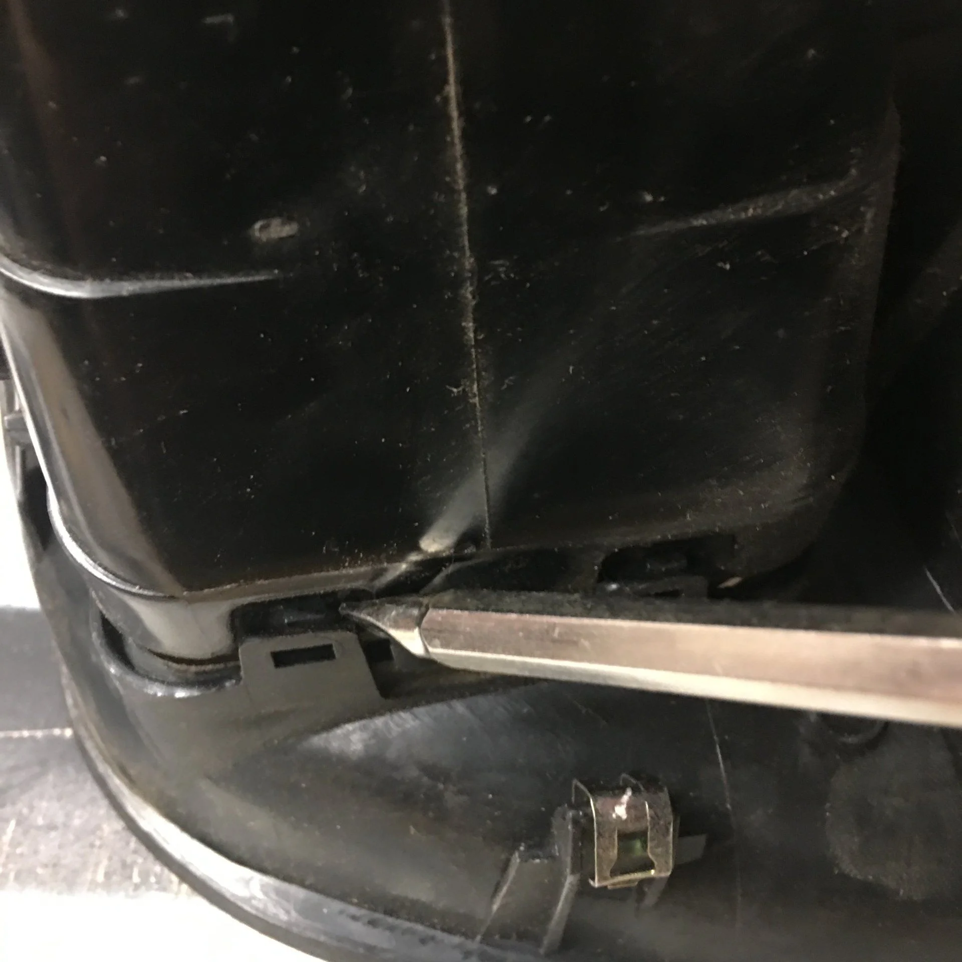

Disassembly is pretty straightforward, just a couple brittle tabs to be careful about

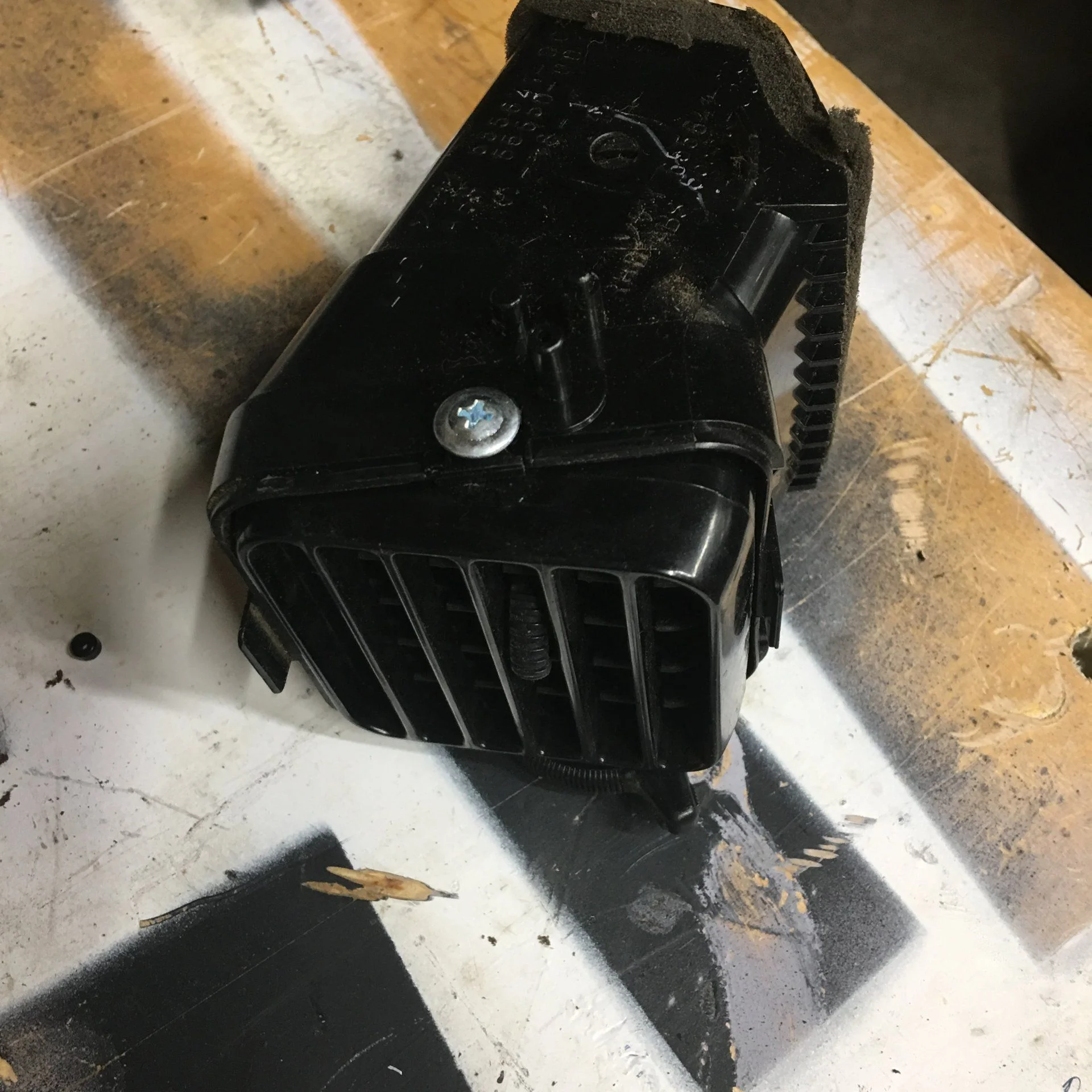

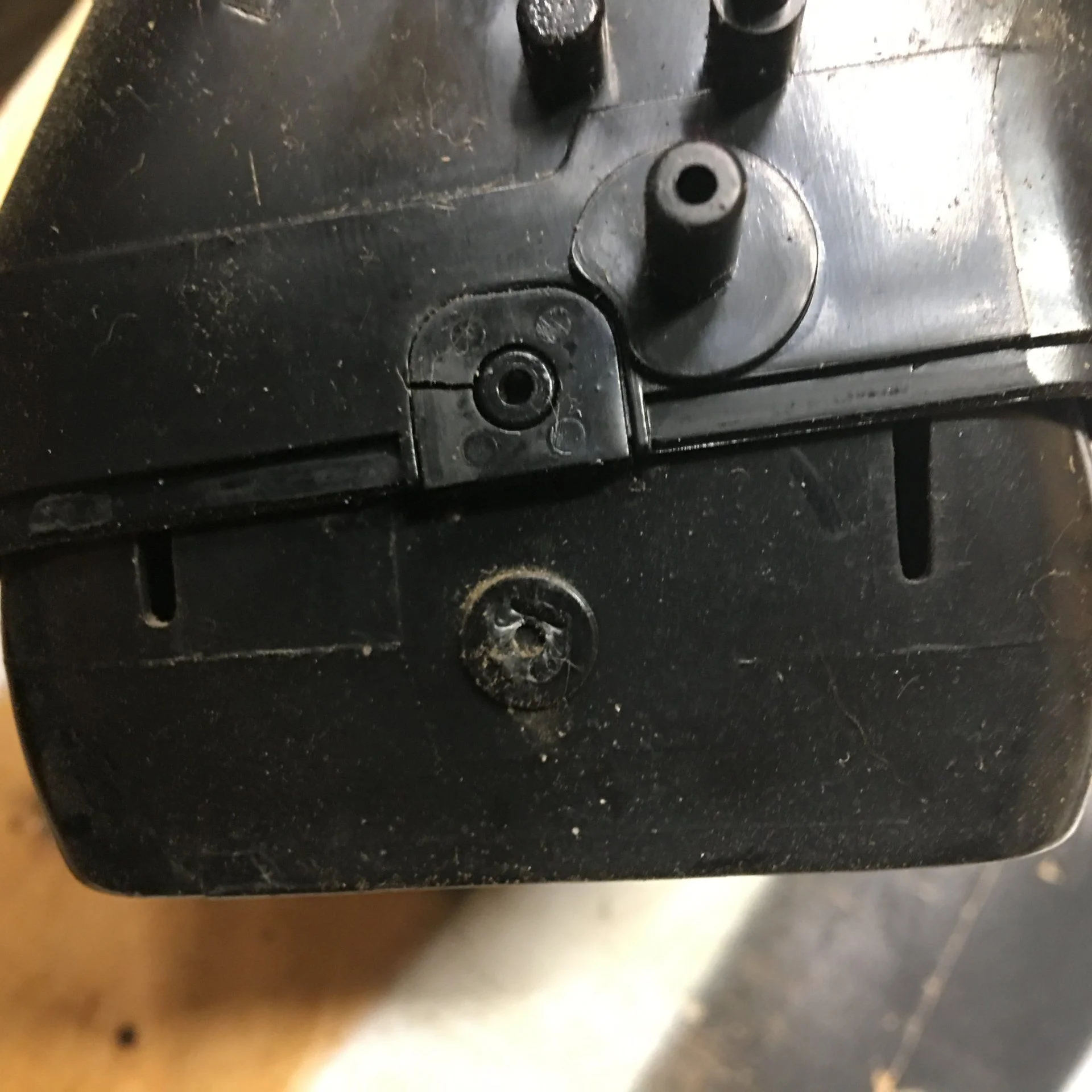

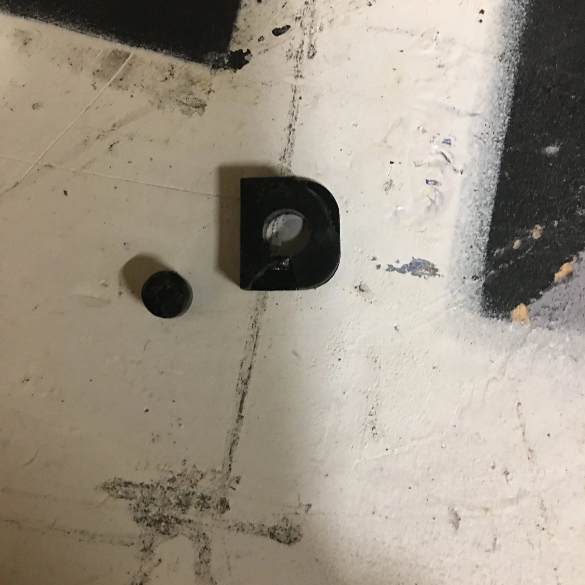

See, broken posts:

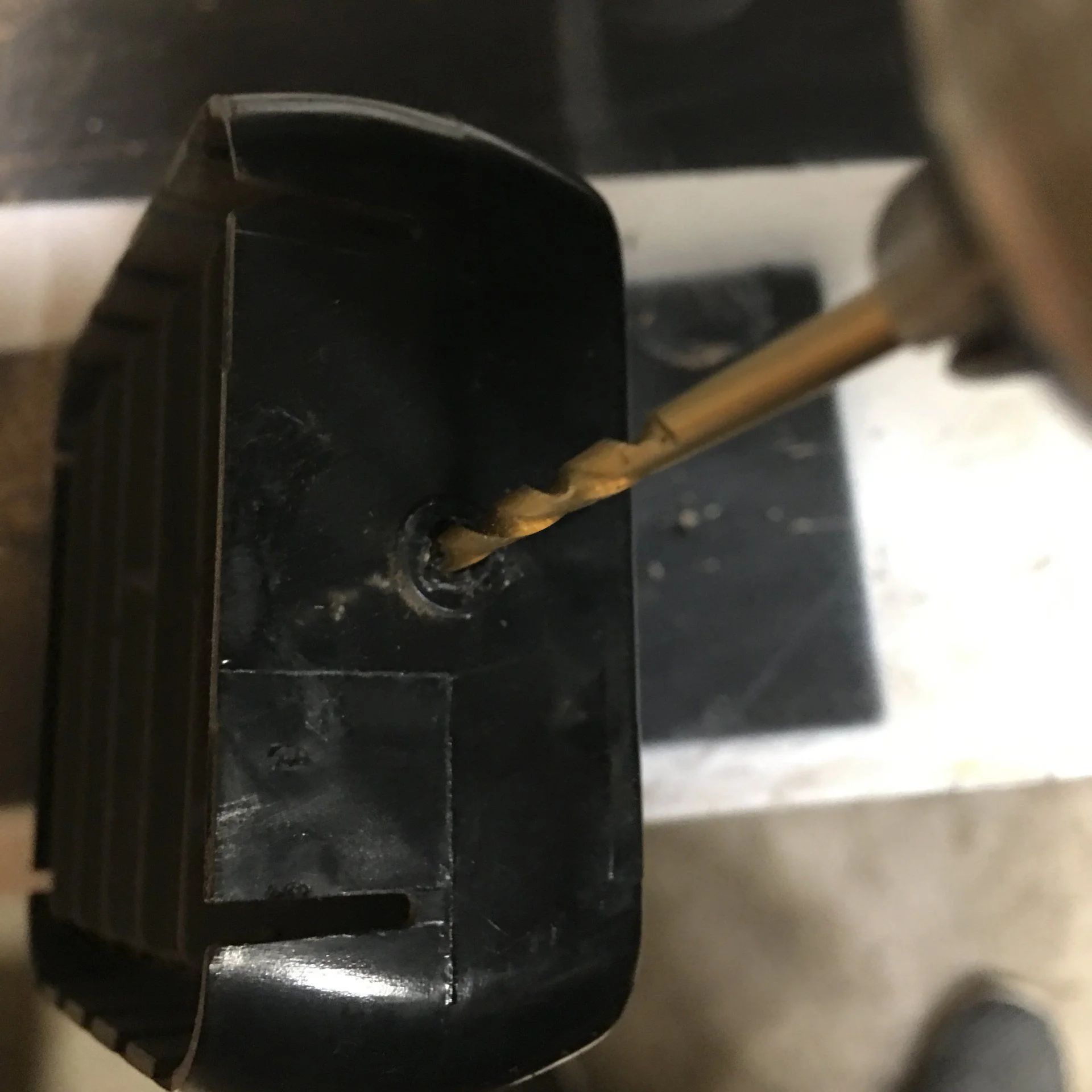

From here, drill a pilot hole in the vent grill (?) and screw in the screws for a semi-firm friction fit. The bit you use pretty much correlates directly with your screws and on this brittle plastic I hold the bit against the screw and ensure " just a little" thread shows. Scientific, I know.

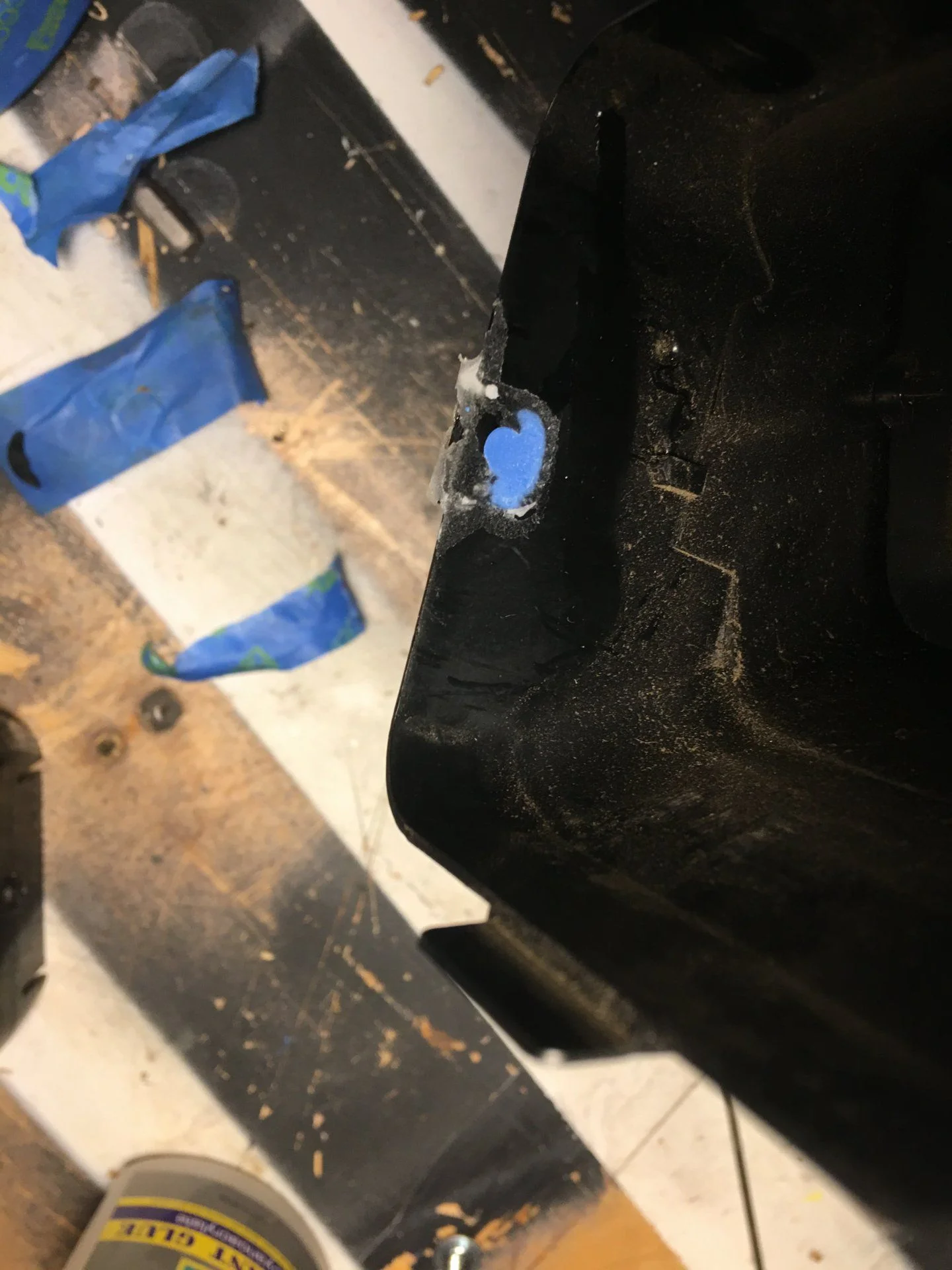

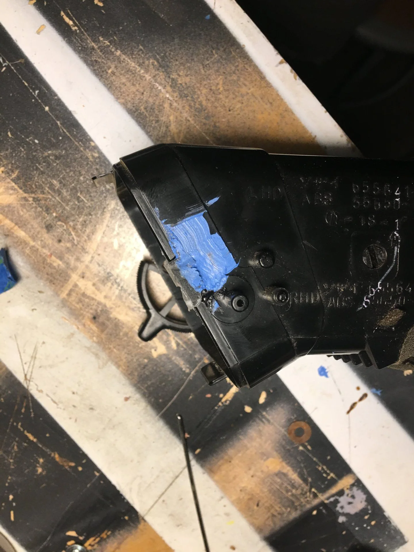

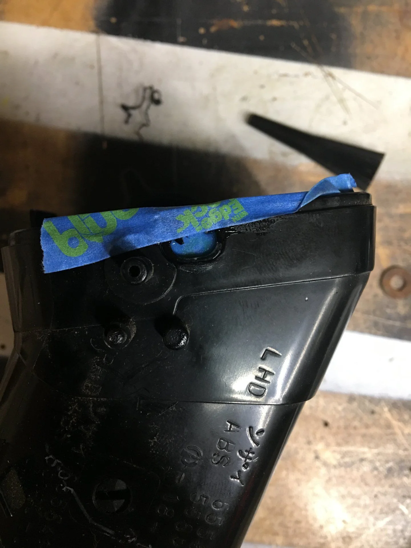

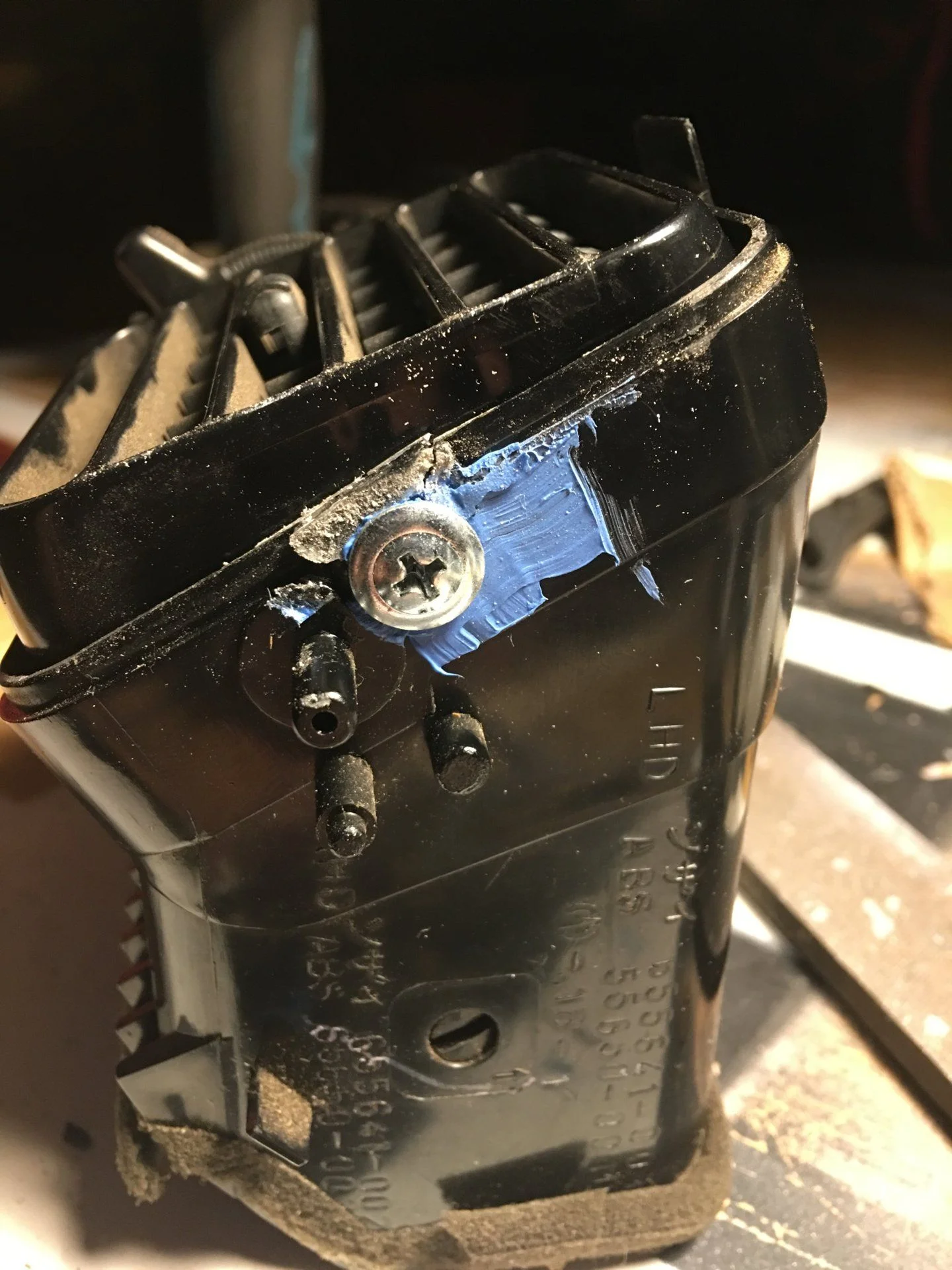

In this case, I had to rebuild the hole in the tubing as well. I tried CA glue then Bondo — both held semi-well for a few moments but cracked off after threading in the screws. I then turned to blue RTV and it held like champ. The idea here is to make a form out of the tape so that less time is spent on the
Once the RTV cures you can thread the screws right on through without a pilot hole.
Look Ma! No Floppin'!!
Though I know stills prove nothing these have held up really well. ~12k on the first batch I did, I might have done 3k on these with the RTV.

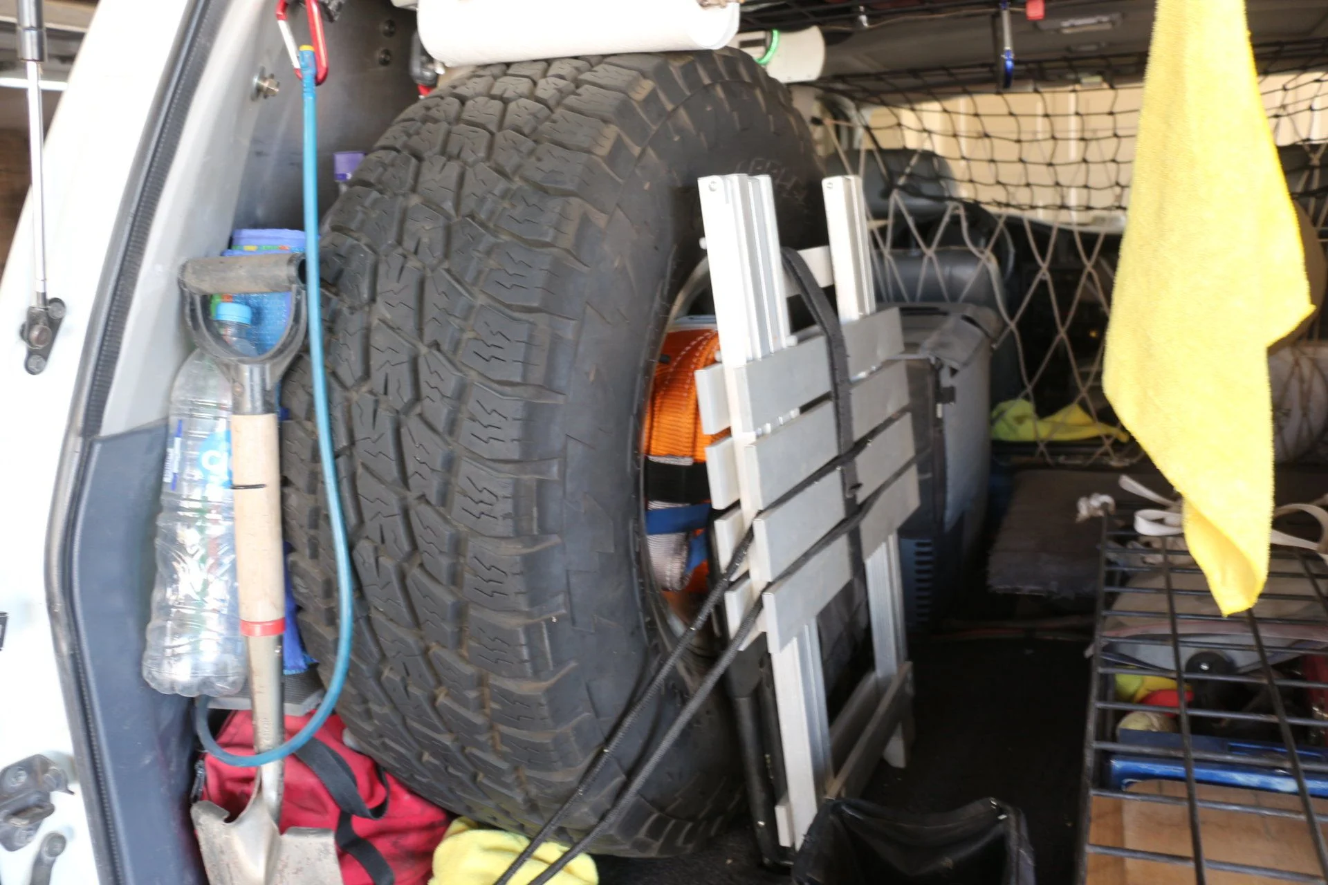

Upgraded my ARB snatch strap to 24,000lbs from 17,500. Now all my recovery gear in rated at a minimum 24,000lbs.
Stores in the same place as the 17,500 strap without taken up any more space but still easy and fast to get to if needed
Retired the ARB 17,500 to the LX470
FWIW - ARB snatch strap has some of the best test results of any snatch strap well in excess of its rated 17,500
