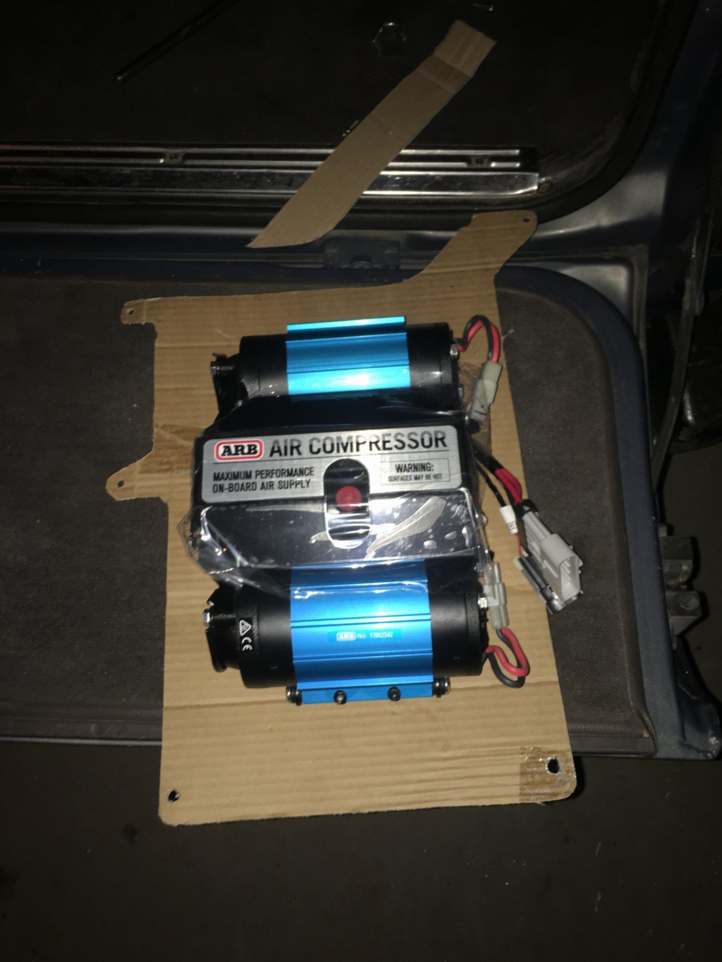

Decided to remove the stock sub(it was so cute.....) and needed a place for my air compressor. I measured and thought it would fit, and then I had an idea on a chuck location, the old jumper seatbelt beaker location. So I started making some templates.

Wits' End Accessory Mounting Quarter Panel- need input
It's not the prettiest thing, but practical. Also disappears from prying eyes. Should stay clean too. Cover needed the two keepers removed, but I could drill holes in the body if I want, put screws in new holes and put those back in. But this is zero holes or grinding or anything to the body, just one hole drilled into the plastic(including a accidental hole next to the real hole). Gotta cut a switch in somewhere, not sure if I'll do it on the dash or on the back.
When I put an air locker in, I'll run a switch on the dash.
Anyone done this? I'm sure it'll be loud, I could put poly stuffing in there, but then I'd be worried about it heating up.
Shoulda called @NLXTACY for the latest Wits End toy....... Would've saved you hours of work......
EDIT: Posted before I read everyone else telling him the same.....
Free is good!
Free is good!
Yeah I definitely don't want to push my stuff onto anyone and I also don't want to discourage others fabricating their own stuff regardless of the crap I make. Its purpose built. Rock on!
