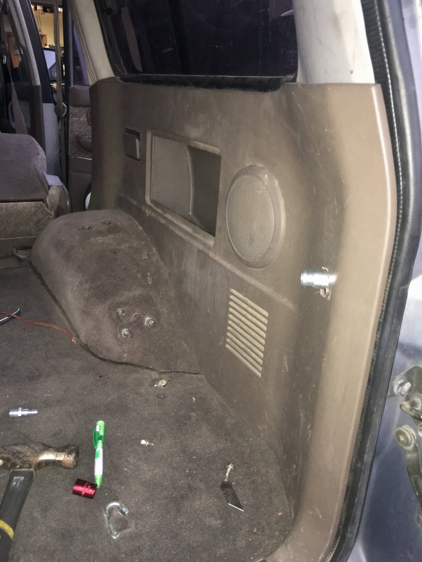

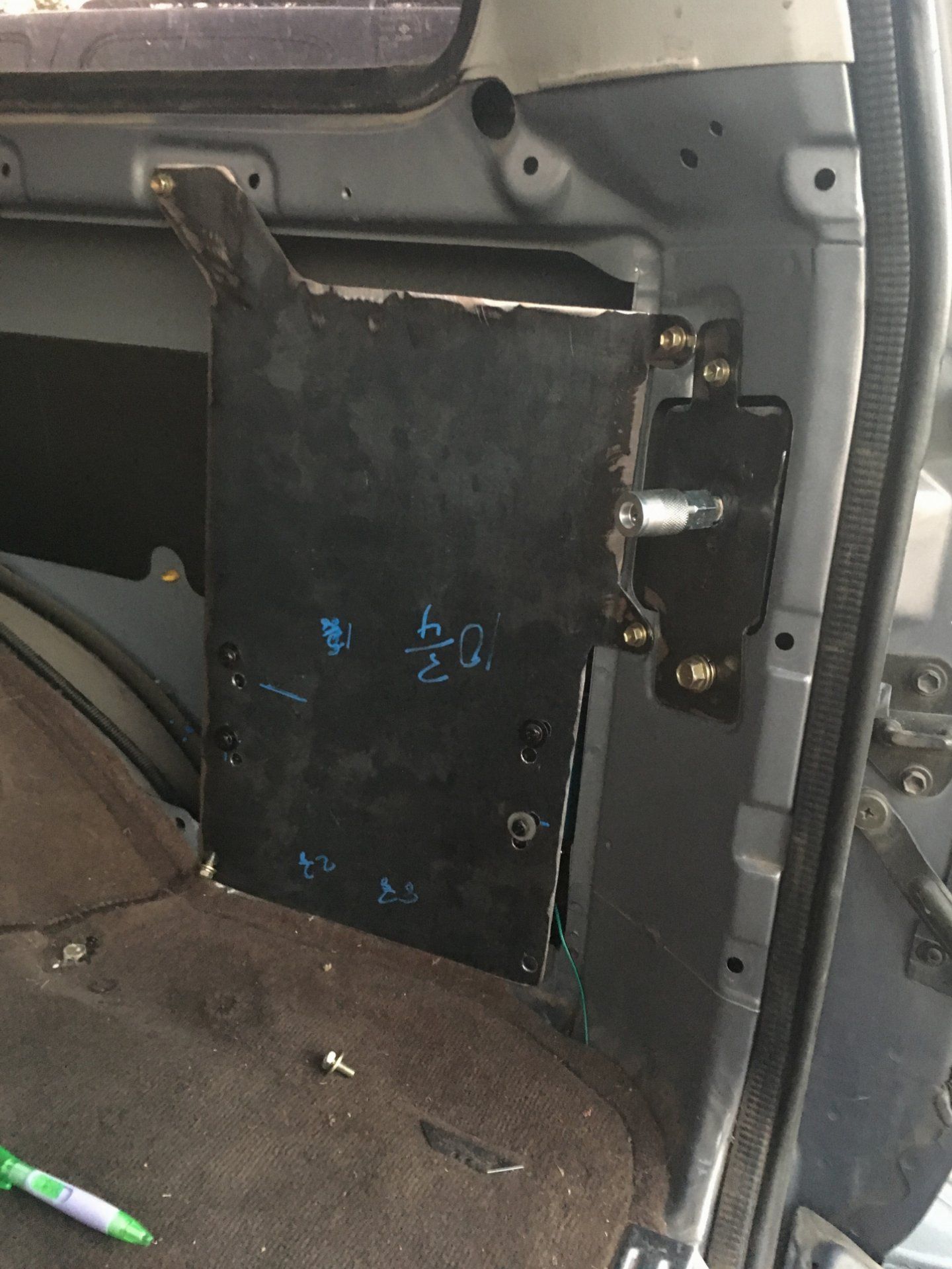

It's not the prettiest thing, but practical. Also disappears from prying eyes. Should stay clean too. Cover needed the two keepers removed, but I could drill holes in the body if I want, put screws in new holes and put those back in. But this is zero holes or grinding or anything to the body, just one hole drilled into the plastic(including a accidental hole next to the real hole). Gotta cut a switch in somewhere, not sure if I'll do it on the dash or on the back.
When I put an air locker in, I'll run a switch on the dash.

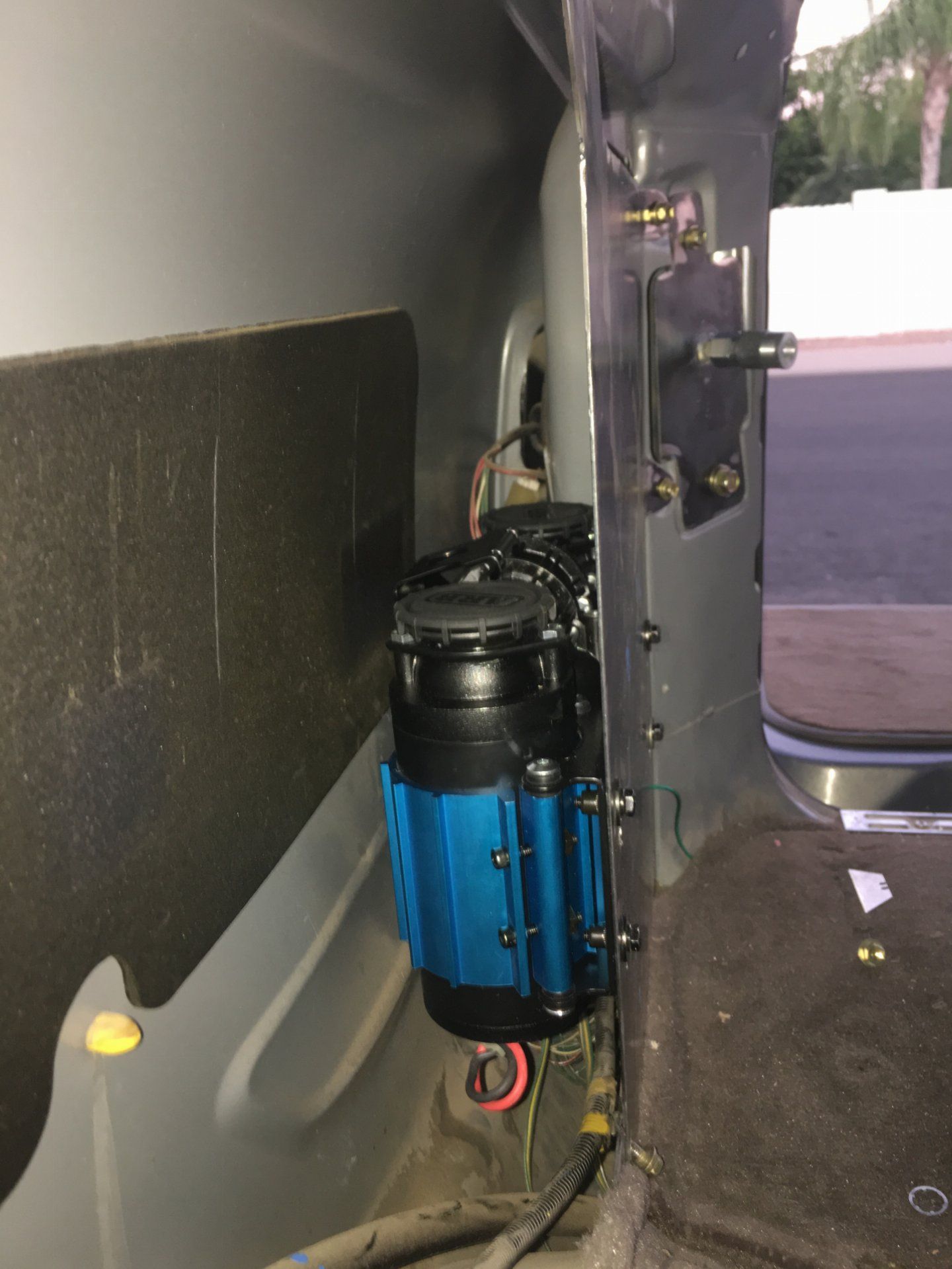

Anyone done this? I'm sure it'll be loud, I could put poly stuffing in there, but then I'd be worried about it heating up.
Whole thread on this ;)
Anyone fit a CKMTA12 ARB air compressor?
I can hear it running, but it's not overly loud. Don't put insulation around it
