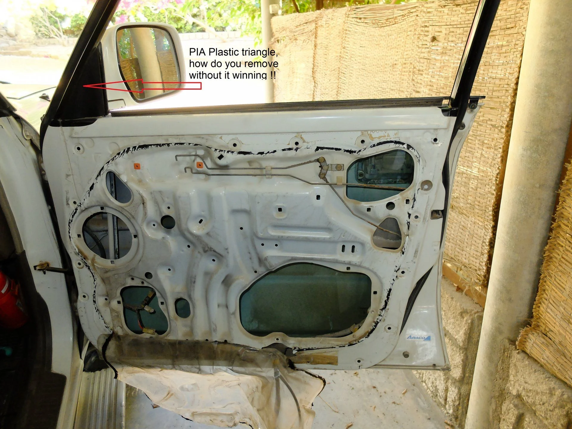

Front Passenger Window Blues :

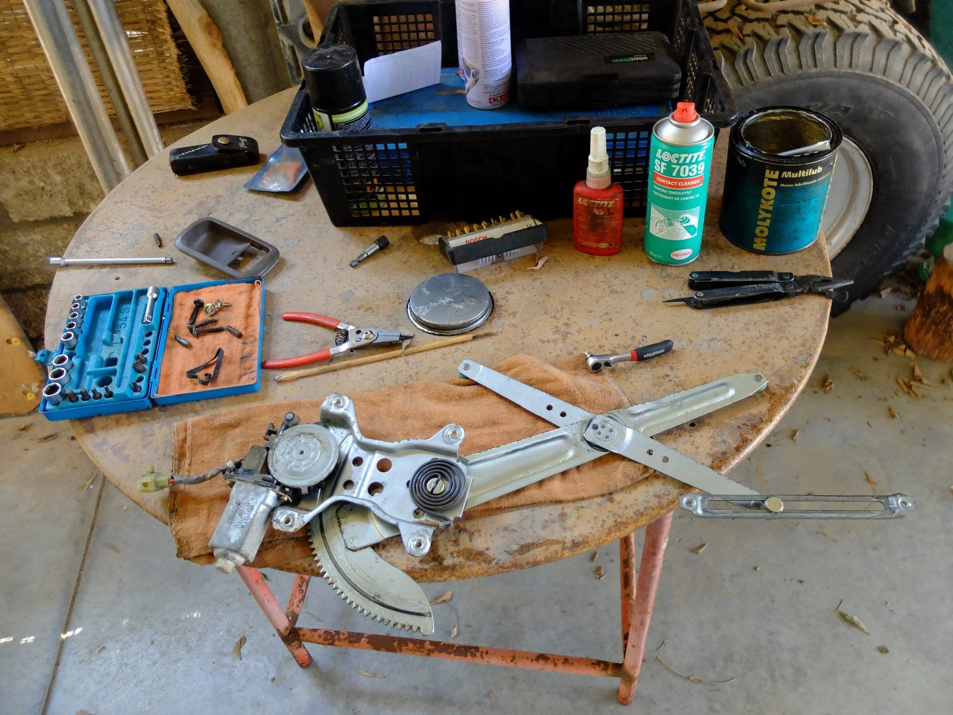

Window didn't work, dove head first into the door to investigate and clean/grease everything there is, electrical contacts of window motor switches, gears, runs of glass from 20 years of grime, clean and grease glass channels, etc., etc........then got stuck big time trying to remove the outer weatherstrip without it breaking :mad:, removed all the small fragile plastic clips in the outer weatherstrip but there seems to be one hiding under the side mirror mount.
Tried to remove that small plastic triangle so I can remove mirror so I can remove the outer weatherstrip to wash & clean but got stuck :bang:......can anyone come to the rescue ? Thanks.......
I lost :muted:, thanks for all the feedback guys.
A lesson well learnt, actually not all my fault, didn't have any patience left and couldn't get any from the store in time :wacky:
Cruiserjack's write-up came in very handy but a bit too late, thanks Reiti

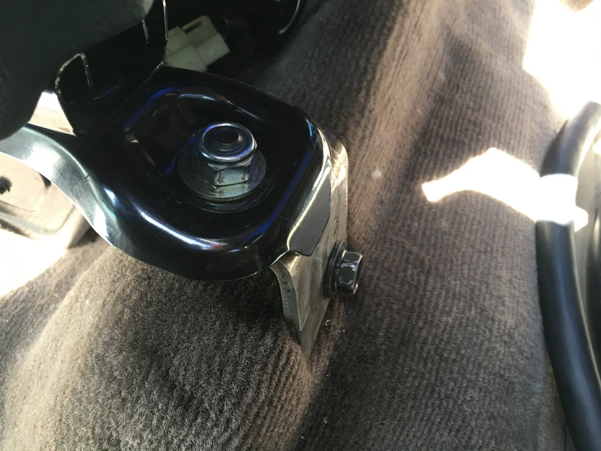

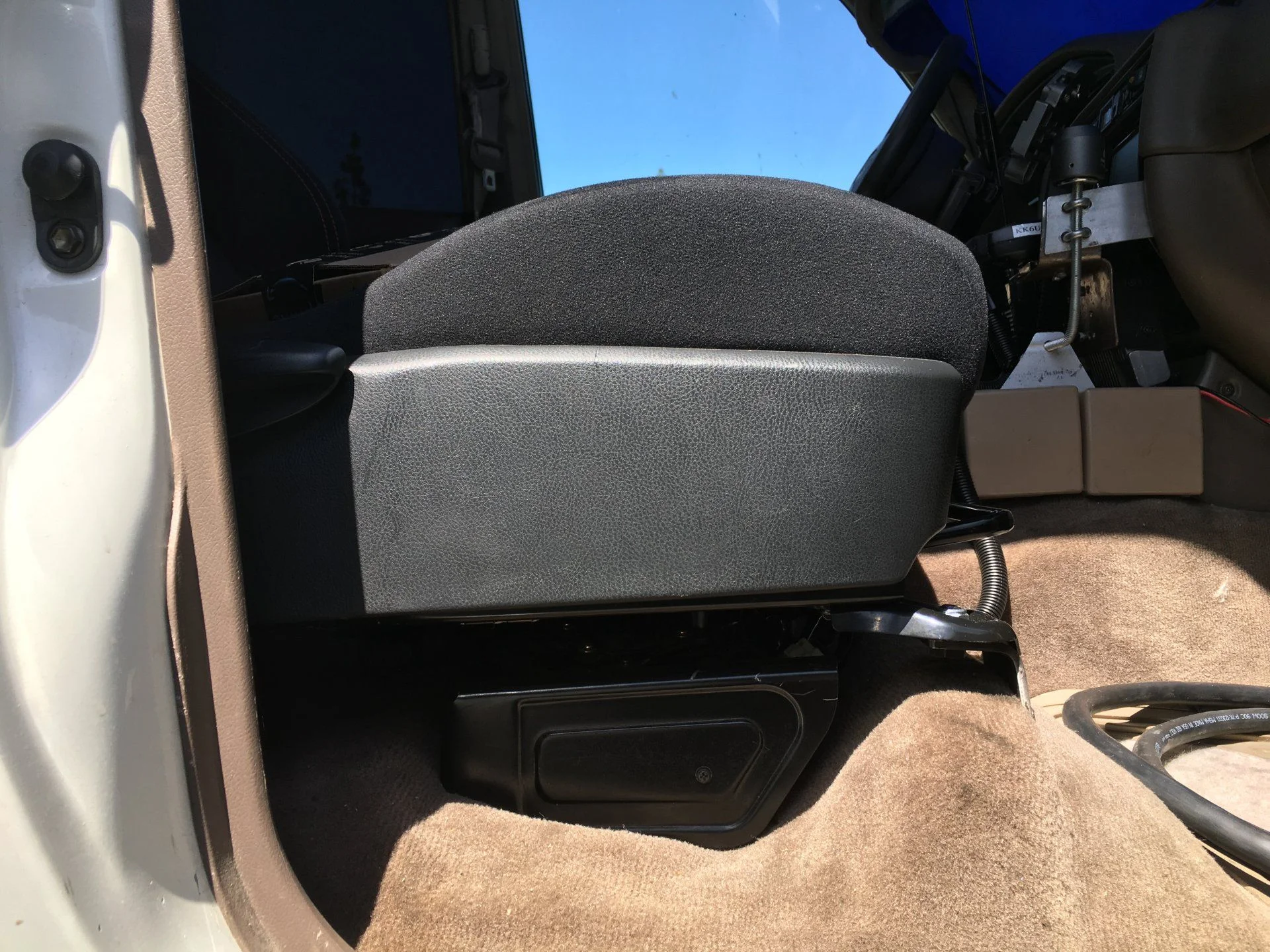

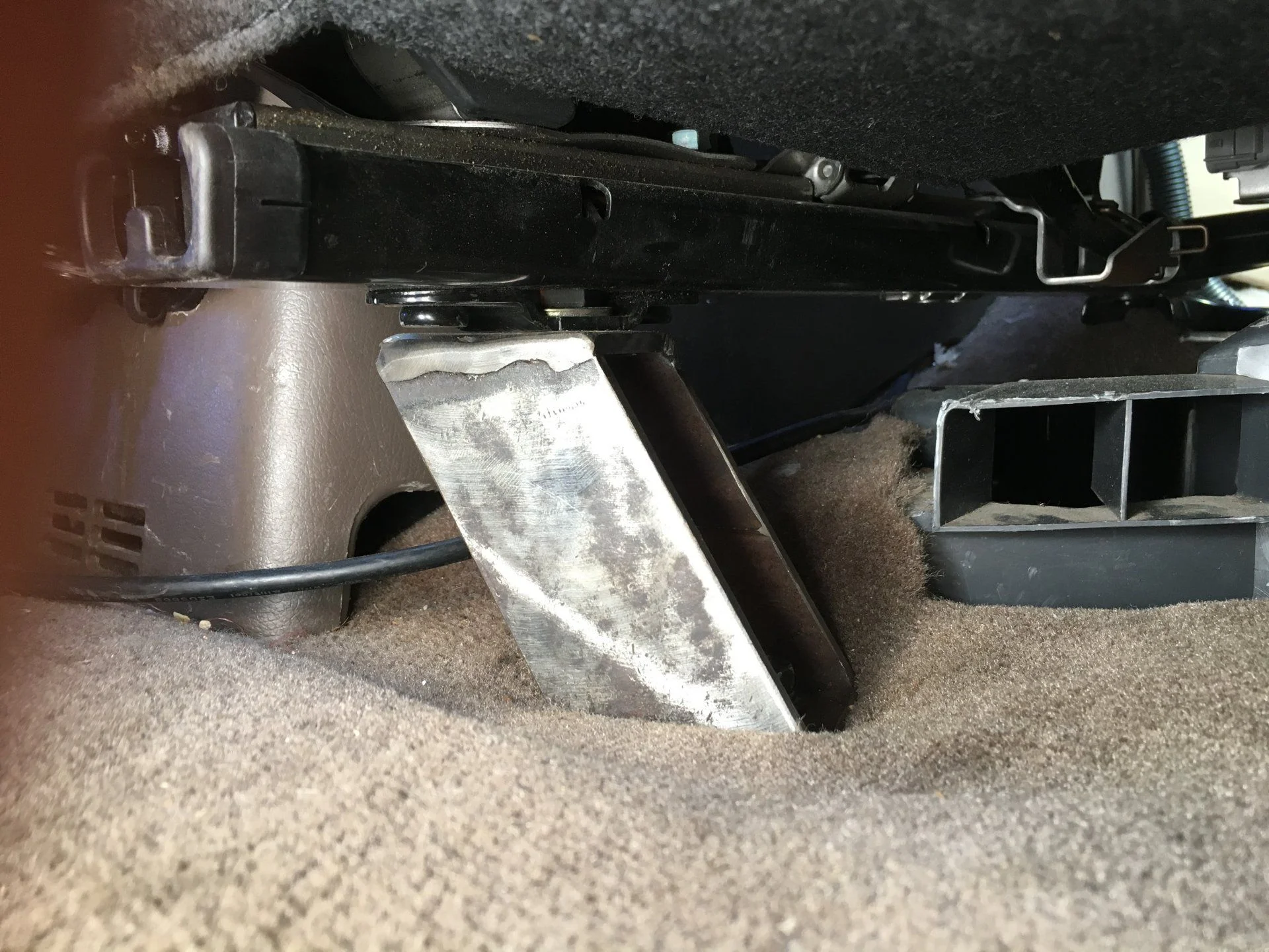

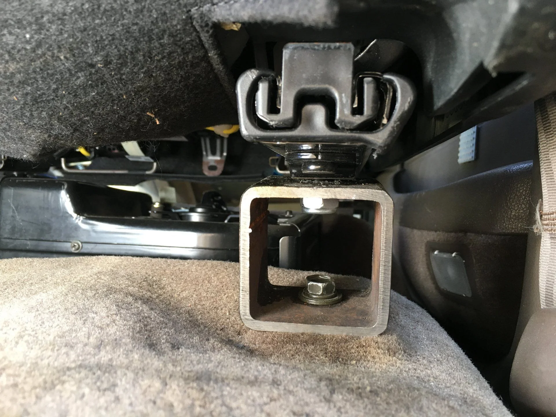

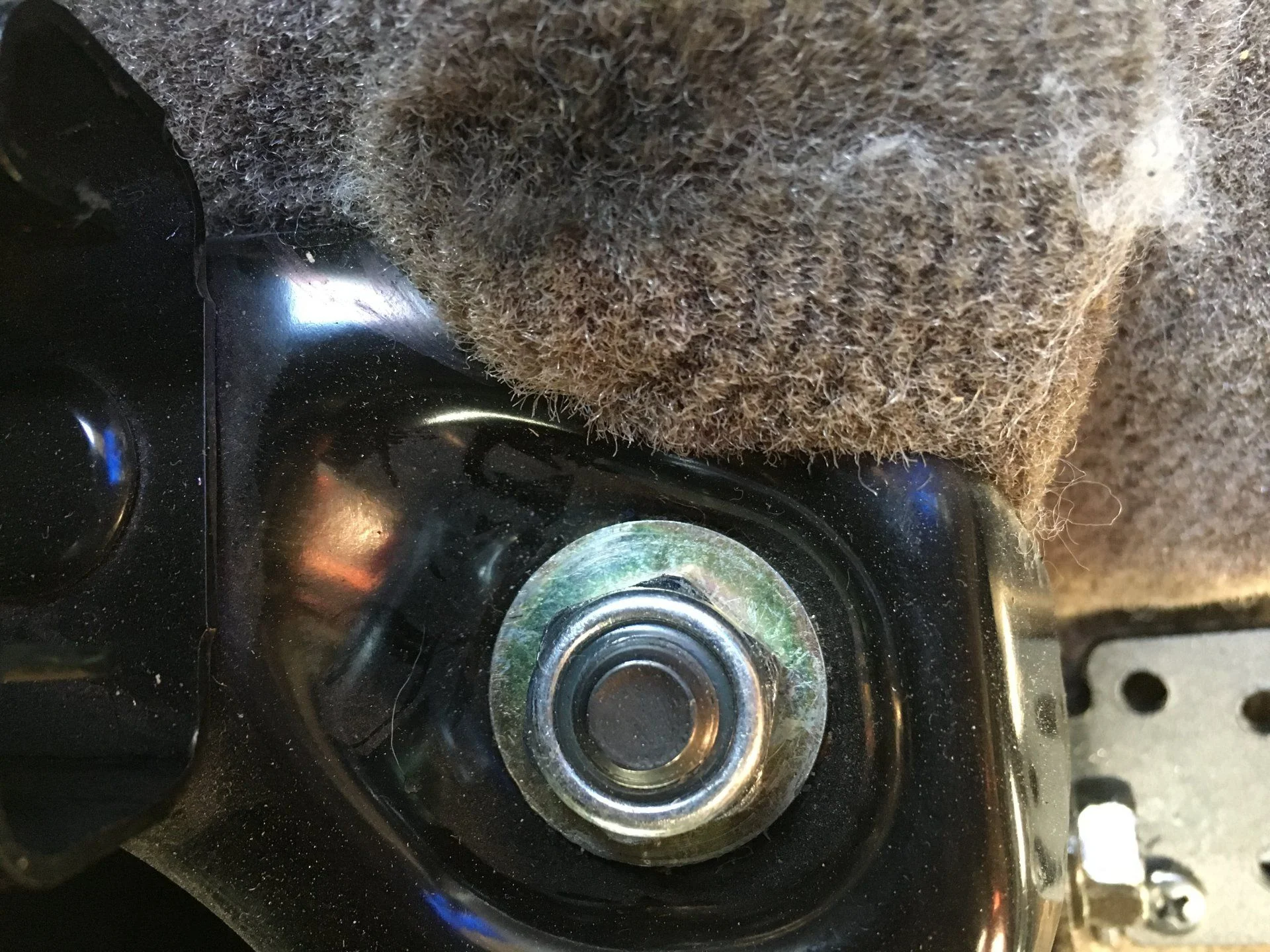

Can you provide details on what's needed for mounting? Looks like at least one front seat track bolt points upward instead of forward?
They're bucket style seat so it looks upward. Rear mounts are 2"x2" and 2"x3" (or 2"x3.5"). Front mounts are less than 90* bend cut to fit. I had to grind the front mount of the seat to center/fit it.

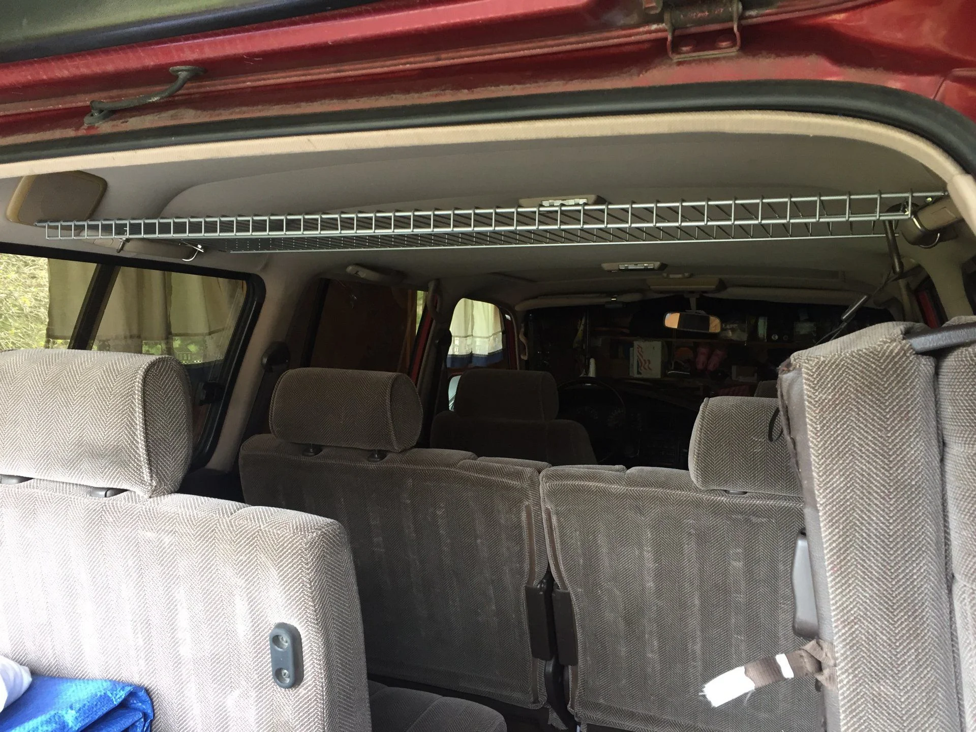

View attachment 1441635 Six hours of silky-smooth fzj80 action to the Atlantic coastline.
Happy to report that the newly-installed attic rack performed as desired.
If you flip it over the other way you have a small lip to keep things from sliding off. Might require modifying the way you have it attached though. I made metal brackets for mine.
Yeah, mine has a lip on both sides in opposite directions. So I have the front-facing edge with the lip up, preventing things from sliding forward. That just means that the rear-facing edge has a downturned lip.
@Bama4door Thanks! It's a Rubbermaid FastTrack, 4 feet x 16 inches. I got it at Lowe's for just under $10. I trimmed 2 sections from the width, which was like 2 inches. I used some u-bolts to secure it to the grab handles. I had seen a few posts on this mod here on 'Mud, though I forget who had the original idea.
