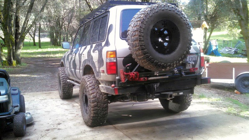

I got the bumpers powder coated, remounted and added the lights...
