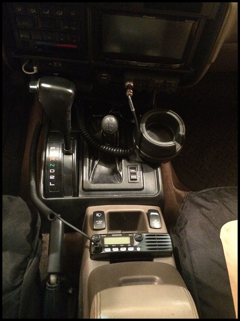

Been scratching my head about where/how to mount my new HAM radio. My radio does not have a detachable face which makes installation a bit more difficult when trying to keep it discrete and not completely exposed and in the way.
Couldn't use the stereo location since I have a double din unit. Already have a CB in the ashtray location, so.......
I decided that it was worth some minor sacrificing of the center console since I don't use the front pocket of the console that much. I still have some room in the pocket but this made for a little cleaner install than the alternatives I had come up with.

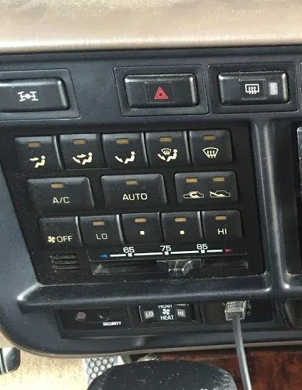

You may find it nice to replace your coiled mic cable using any internet/router patch cord.

Handy way to mount your mic out of the way and easy to reach.
full
I've seen that done before. I'll see how it I like it and maybe change it out later. Thanks
I did the same thing that @LandCruiserPhil suggested utilizing a patch cable, RJ45 female-female connector, some JB weld, and a empty dash blank.

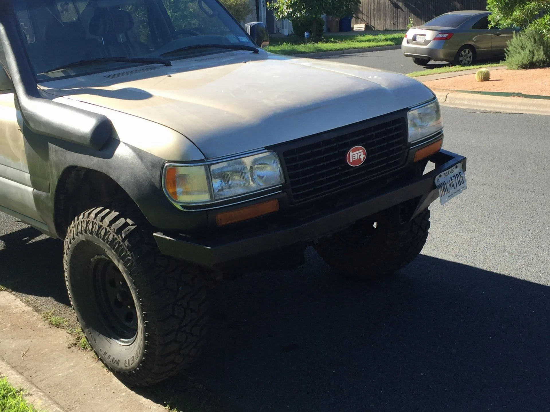

Trail-Tailor bumper?
I've got a Trail Tailor from Jason on the front. Love it! For now, funds dictate stock for the rear :frown: Here's a shot of the front TT.

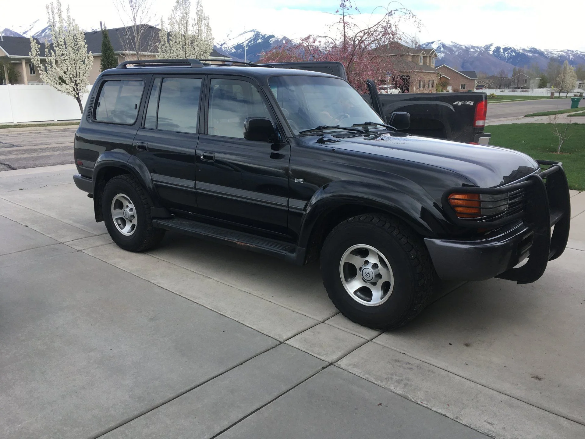

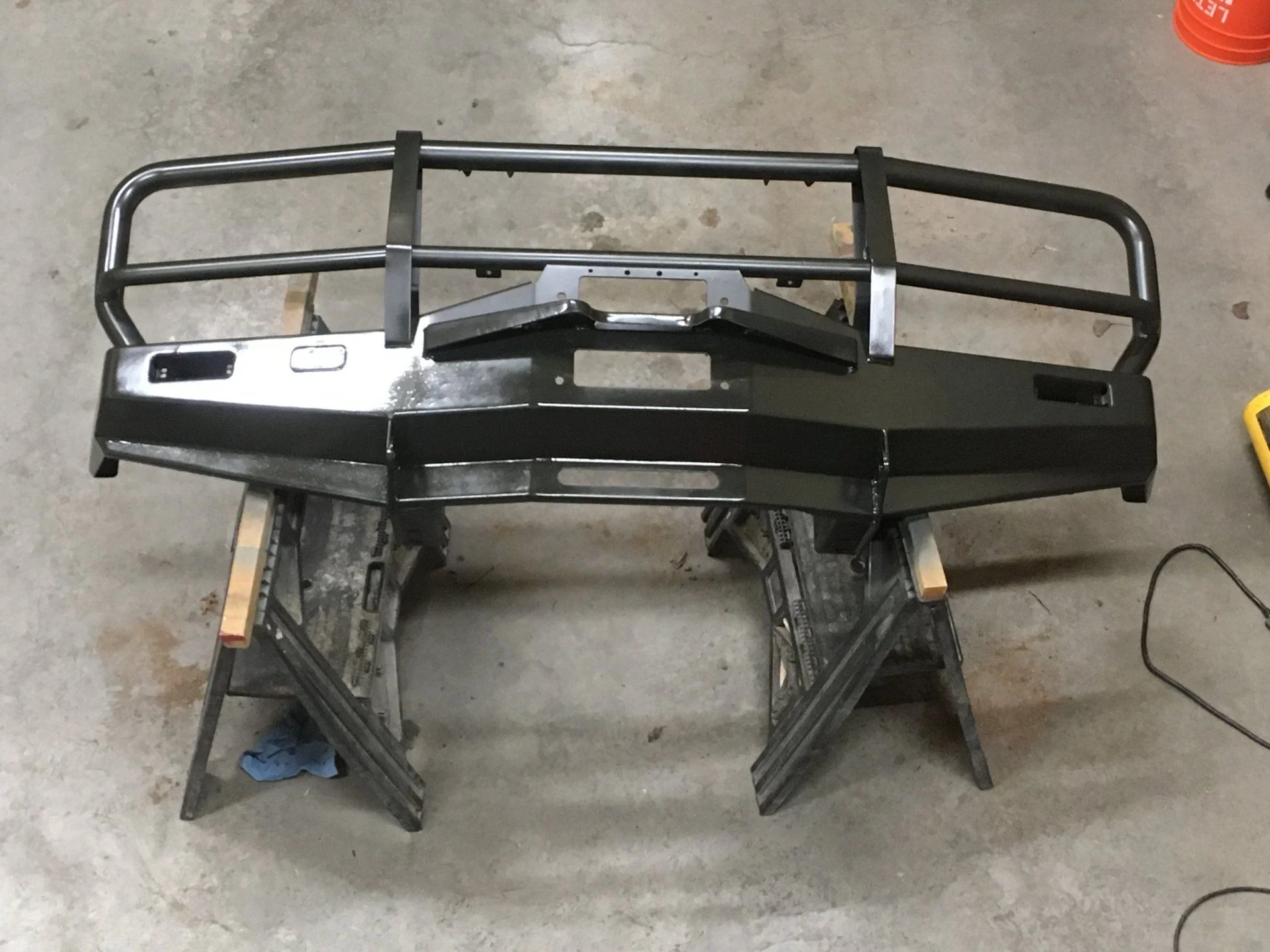

Spent last night working out if the lockers on my newly acquired '95 actually work or not. Jumped the CDL position sensor and got a light on the dash. Replaced the sensor and got three solid lights. Jacked it up and made sure they were locked! Tonight I removed the running boards, stock bumper, and waag from the '97. Pulled the ARB off the '95. Threw the stock bumper/waag on the '95. A little touch up and tomorrow the ARB goes on the '97
