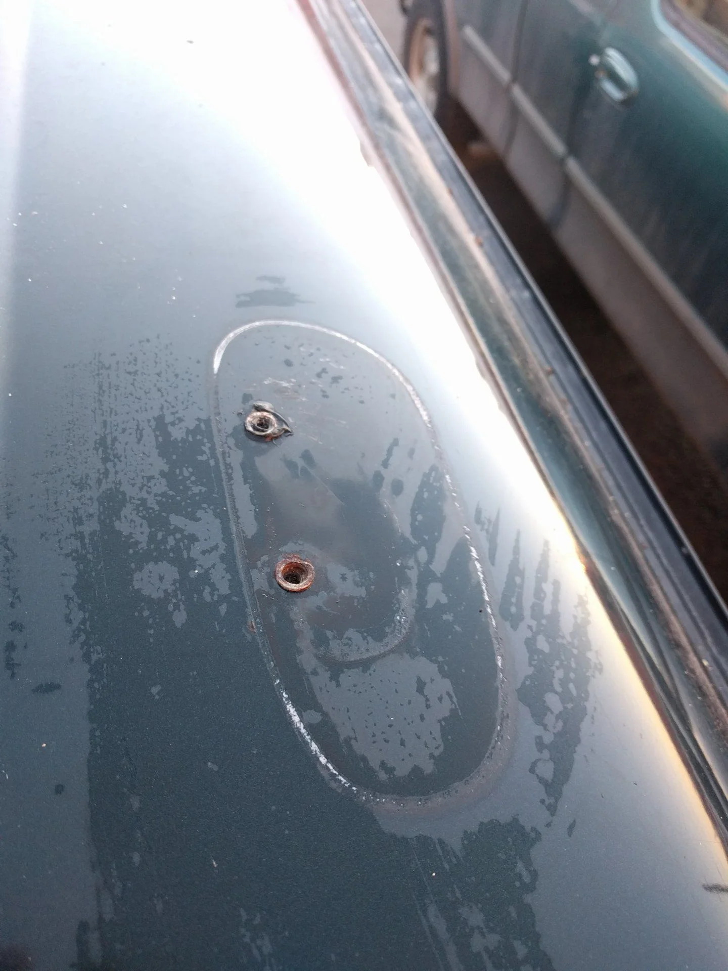

Awaiting a new roof rack to arrive, went ahead and pulled the port-installed roof rack. Spent a fair bit of time reading up on the best procedure and was prepared to need to drill out the rivnuts and so on. Sprayed a drop of penetrating oil and thought I'd check the bolts just to see how bad they were. All 8 came lose with just a touch! Unfortunately, the plastic feet rubbed quite the groove into the steel, but was relieved to see that there wasn't much rust. I mean, those are some pretty clean bolts, no?

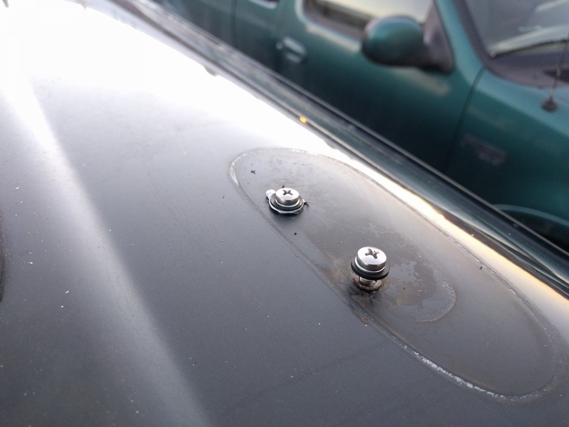

New hardware installed: M5 stainless bolts, 20mm in length, with a dab of grease to prevent further rusting of the nuts and a rubber washer. Sealed the whole assembly with some automotive silicone. Going to cover everything with some plasti-dip to prevent further rust.
