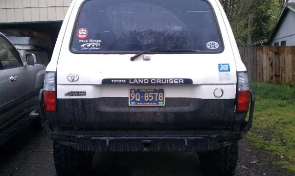

looks good.
how was the install? any modifications?

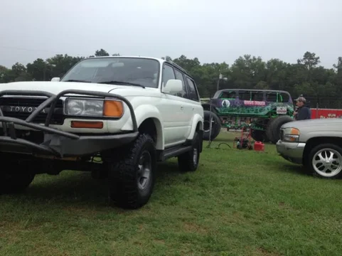

it was not really a weekend, but today we had a lot of cruisers come out of the wood work for a tampa Bay area meet and greet.
