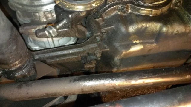

Oops forgot about what the thread was for. Put together a list of parts needed for some minor maintenance.
Went to Yota and got a 3 for $10 oil filter for my '94...
Changed the oil from regular 5w30 to M1 0w40 synthetic.
I noticed a slight rattle sound after the change out but will have to find out where it's coming from...

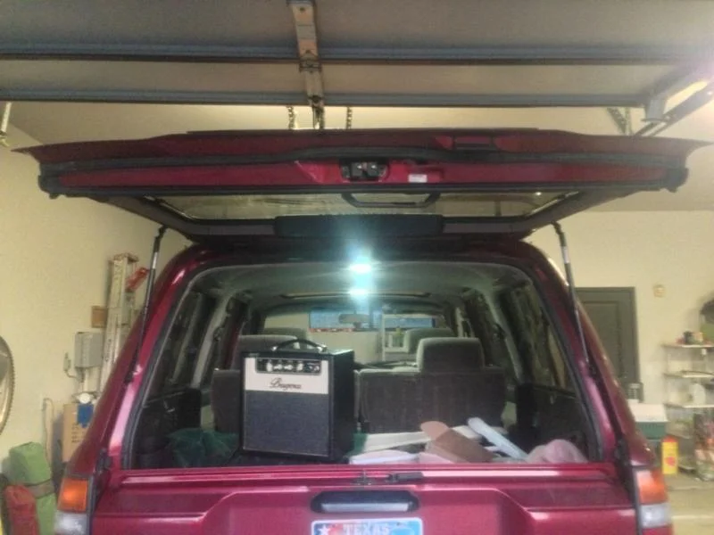

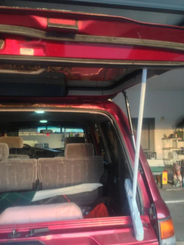

Finally replaced my broomstick rear hatch lift with working new support arms.

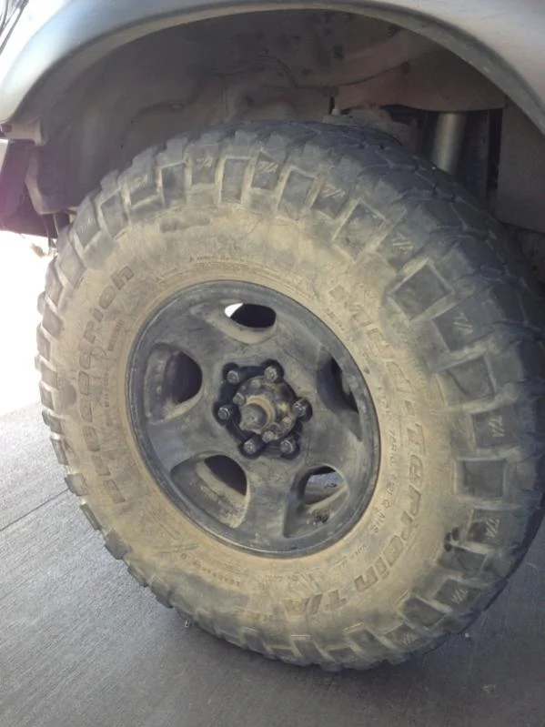

Today was a wrenching day, and my brother gave me a big hand doing some upgrades to the Cruiser. We started off with drilling and fitting a new skidplate to his Jeep Rubicon, then installed Powerstop rotors and ceramic pads at all four corners of my 80.
[URL="http://i1238.photobucket.com/albums/ff490/mikedebear/IMG_20130413_173033_zpsfd678293.jpg"][/URL]
Following the brake job, we re-clocked the control lever on my new 12K HF winch to fit it’s new home on the HF winch plate. The winch plate was then fitted to the frame rails of the Cruiser with the help of a sawzall and the trusty flap disk. We ran out of steam to finish the winch project, but will pick it up next Saturday when I need to replace the sway bar mount that let go while wheeling this weekend. I do believe some new braided stainless brake lines will find their way aboard at that time as well…

Lift supports, another of many things on my to do list. Steve Jobs soul... Lol
I got them off eBay for $40 shipped from a company called 'Lift Support Depot' out of Cali, and plug and play too. Took less than 5 minutes to install so a great experience. Now we'll see how long they last. Gonna order the hood supports from them this week as well.

3 or 4 cans of brake clean, penetrating lube on various fastners and hubs, lots of rags or paper towel, a 54mm socket ($25 bucks on Amazon) to set the bearing tension, axle grease, a little RTV because my part time hubs were allowing water in while doing deep water crossings, and one new seal on the back of the axle hub because I mangled it while removing it. You might want to just pick up two, just so you have new seals. Only cost 6 bucks at Autozone...
Other than that, just an impact gun to press the hubs back in, various sockets & extensions, duckbill snap ring pliers (makes it waaay easier than standard snap ring pliers for the axle), a rubber mallet (nice but not necessary), a 2lb hammer, flat blade screwdriver to remove and replace the locking ring as well as help compress the caliper pistons, channel locks to compress the pistons, pry bar to help unseat the hub from the rotor, jack stands, latex gloves to protect your manicure, and a willing assistant to hand you tools.
The fronts took a while (disassembly of the hub and repacking/resetting tension on the bearings), where as the rears are simply remove the calipers, whack the rotor with a sledge a few times until the rust breaks free on the hub and it falls into your hands. Clean & lube your sliders and you're done in ten minutes per side if you are taking your time.
While I was in there I noticed my brake lines were swollen and cracked all around. A call to Man-a-fre went in and I have a seven hose set of braided stainless lines on the way for $175. Not a bad deal, within a few dollars of dealership replacement lines.
You will really like these rotors and pads. BIG difference in bite. On the freeway it scrubs off speed with authority now and has much better modulation than the old ones. They only get better as they wear in I'm finding.
