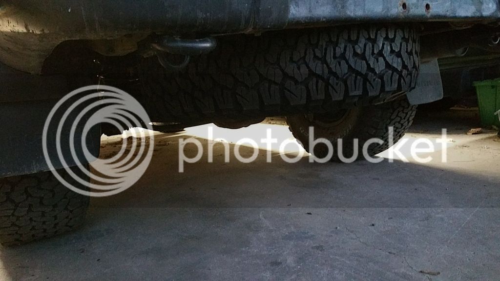

Practiced with my new bottle jack accessory, courtesy of @LandCruiserPhil
Thanks Phil,
my son also enjoyed the tootsie rolls.

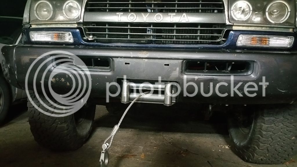

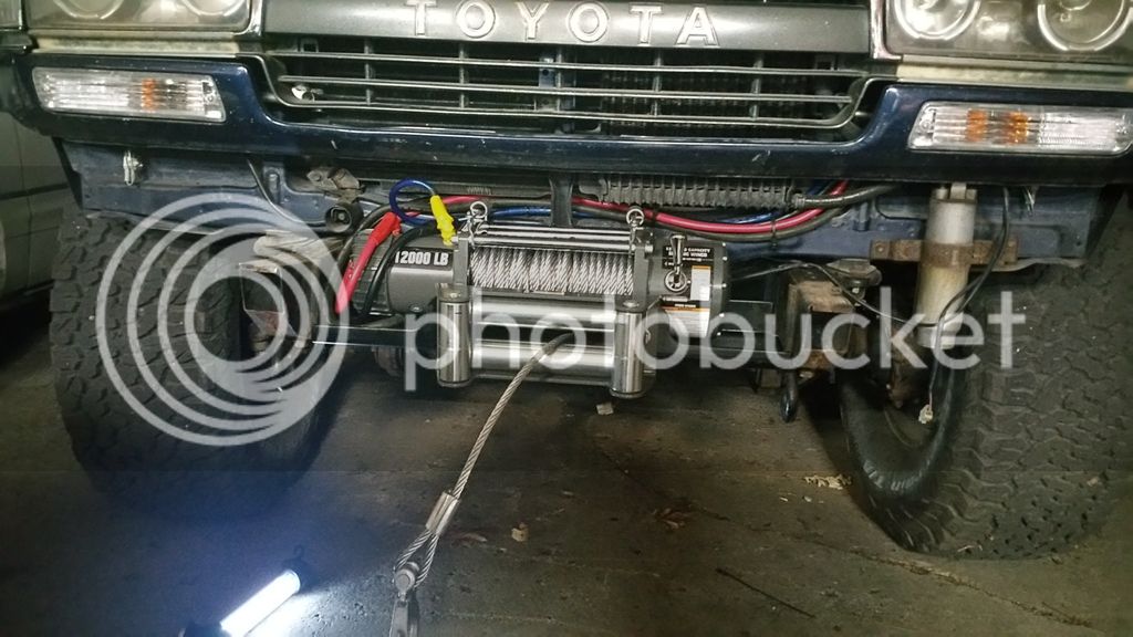

*Over the last week or so. Got my spare tire lift installed and put some Tundra tow hooks out back since I didn't have anything back there after ditching the hitch to make room for the tire. Got the winch behind the bumper and in cab switches wired up. I slotted the air intake grill on the bumper for easy removal to access the winch lever. Pretty happy with how well the winch fit and it's hidden rather well too. I need to paint the bumper and possibly trim it yet. I also put some small led strips on the underside of the hood and used the same pin switch as my alarm to turn it on when the hood opens.

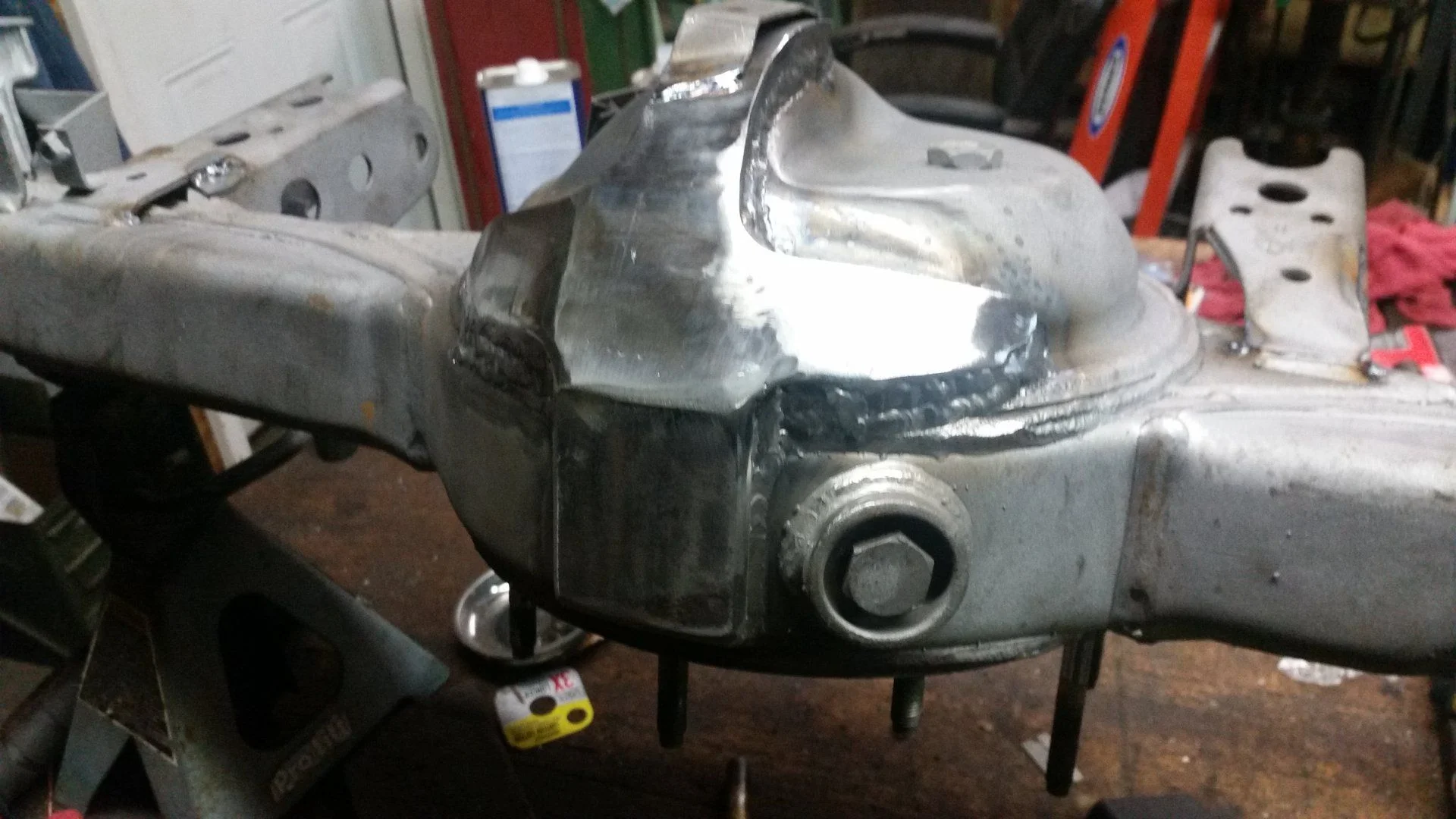

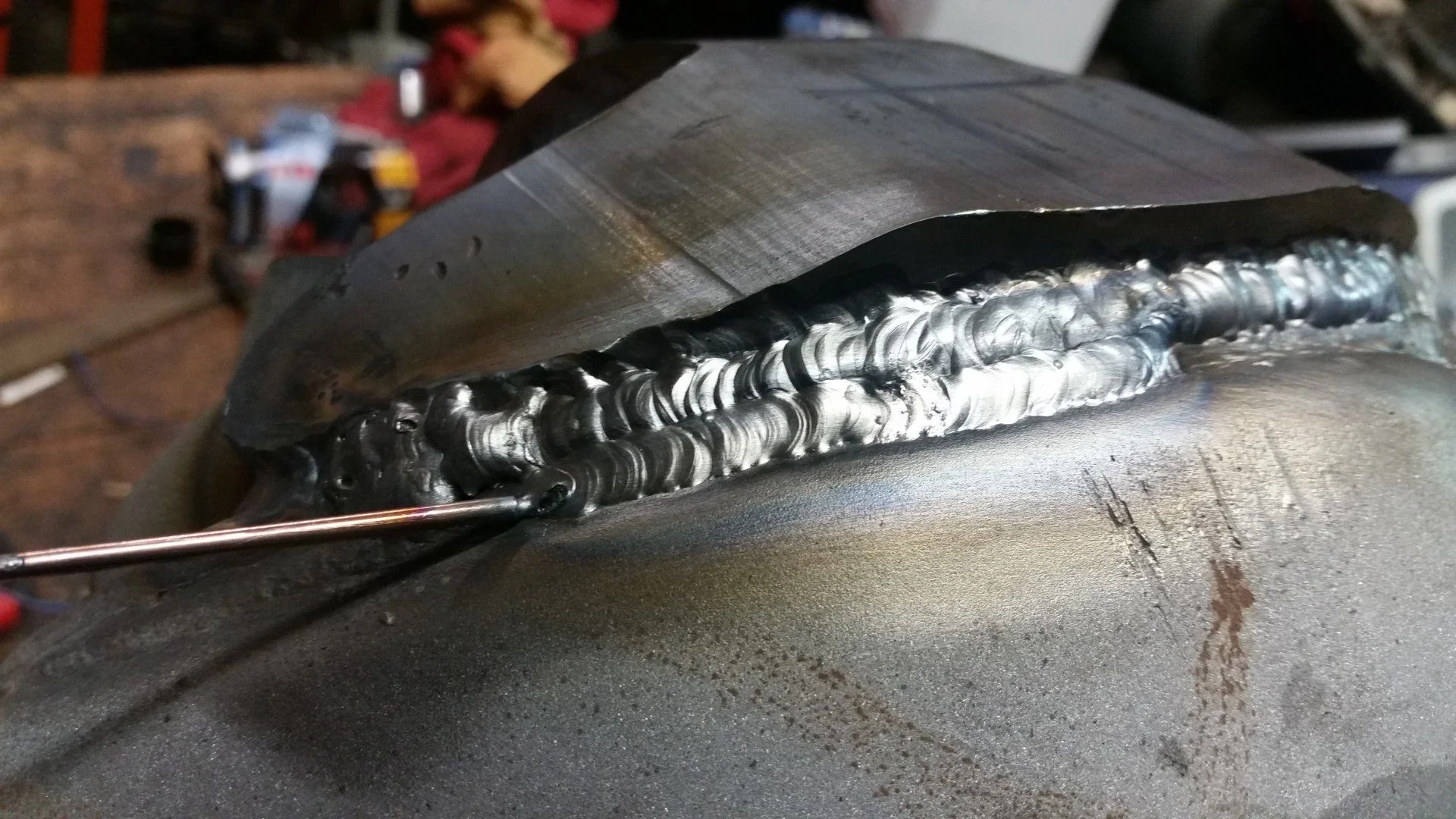

Was on call this weekend and was gone all day saturday and spent most of Sunday preparing for a hunting trip. I did however find time to tig up the diff protections and reinforce the weld on the rear axle. The cap is a Ruffstuff 8" cap bent for the 9.5. I used a CRAP load of large filler rod to fill in and then ground. I also added a plate onto the bottom center of the diff housing to act as a skid plate. I'm going to add the skid plate to the font housing as well. I've already installed the guard on it and reinforced the brackets on the front. I used my flux core though so I've got to re-blast some of the areas to clean the weld smut off. I had all of the links, brake,s hubs, arms, axles etc bead blasted to prep for
por-15. It's getting there slowly but surely.
