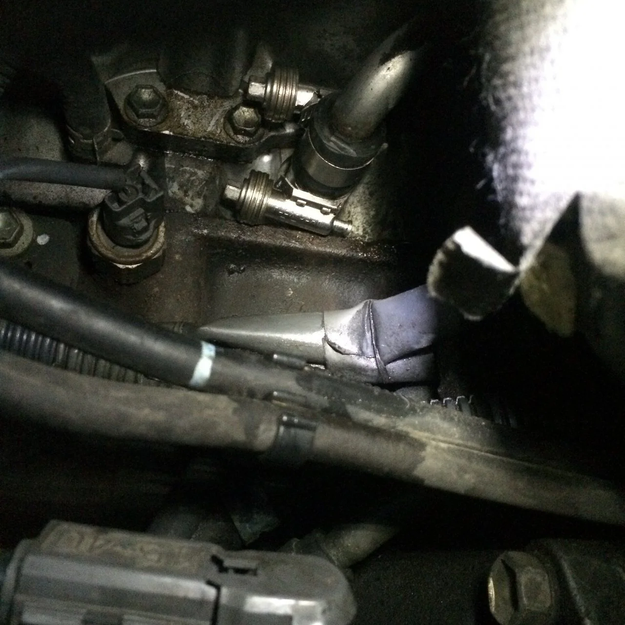

Fuel filter:

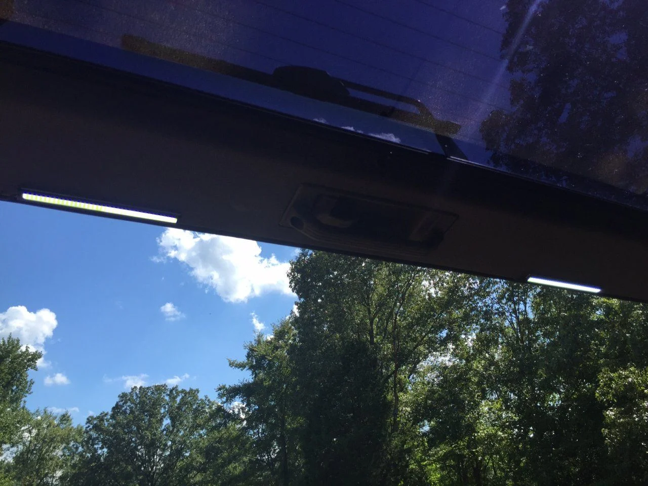

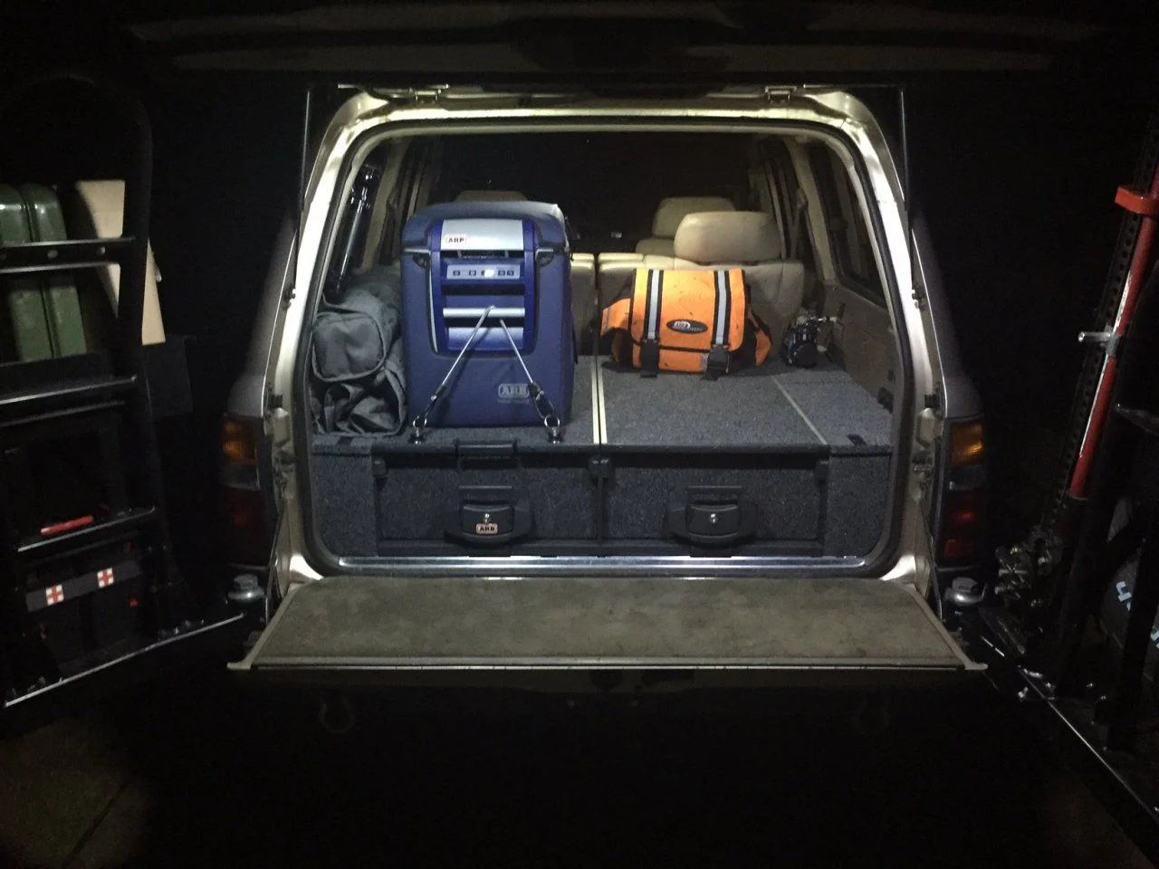

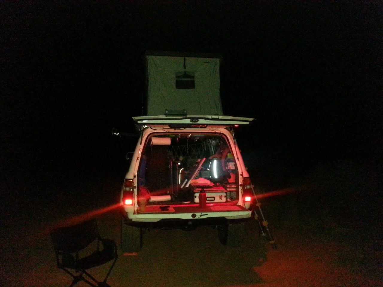

I installed the Pfran LED dome lights quite a while ago, but with the fridge and drawers there was still not enough light in the back.
I've seen some folks put generic LED strips on their upper hatch but my experience with those is that sections of them begin to fail after a short amount of time.
I had these two little mini LED aluminum light bars on my fishing boat for a couple years that have held up great with impressive output. I gave them a shot on the upper hatch of the cruiser and I am super happy with them.
Install was super simple. Just routed one lead up to the dome light so that they come on when the hatch is opened with the dome. Wire was routed under the rear glass weatherstripping, through the drain tube grommet, and then fished through the headliner for a clean install.
Lighting in the back is great now! And the best part is they cost $6.99 a pair on Amazon. Just thought I'd pass along!
https://www.amazon.com/RioRand-Waterproof-Aluminum-Daylight-Vehicles/dp/B00C1YI2XA/?tag=ihco-20
I have those lights. Used one as a backup light above my license plate and one for an under hood light. Work well. Have held up for almost two years with no issue.
