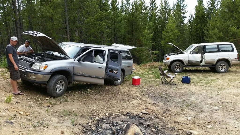

Finally got the hell outta Dodge for the first time this year :/
Two turbo yotas in their natural environment:

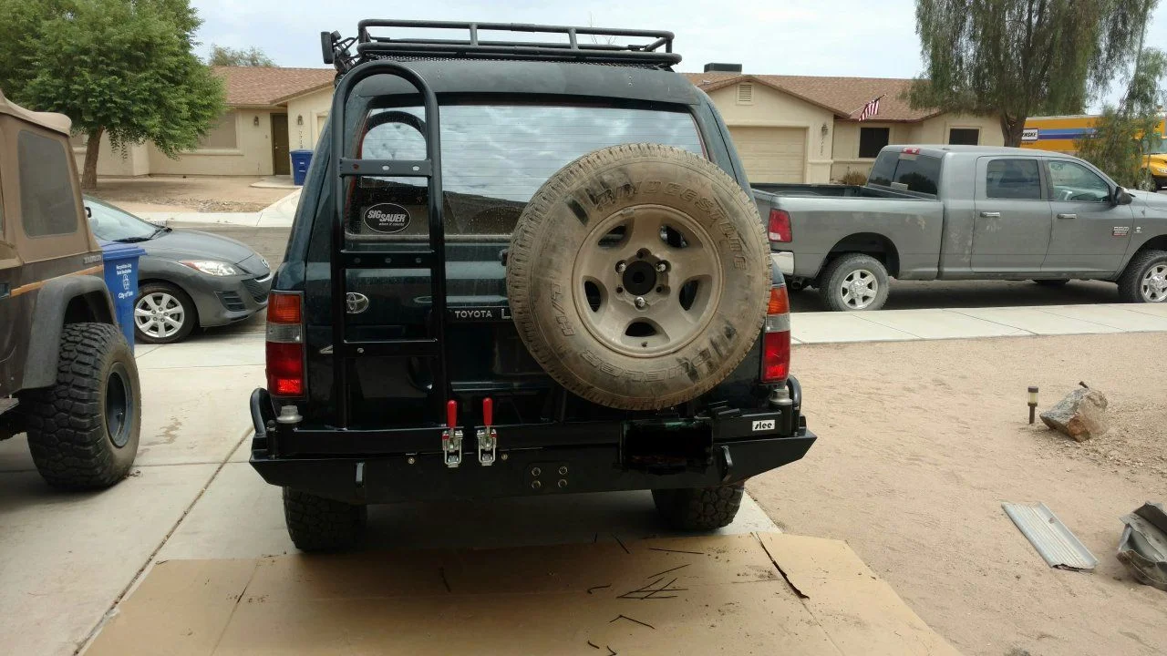

Slee rear bumper
@reevesci you may still have my contact info from the antenna mount, but please keep me in the loop on the tailgate storage. Looks great!

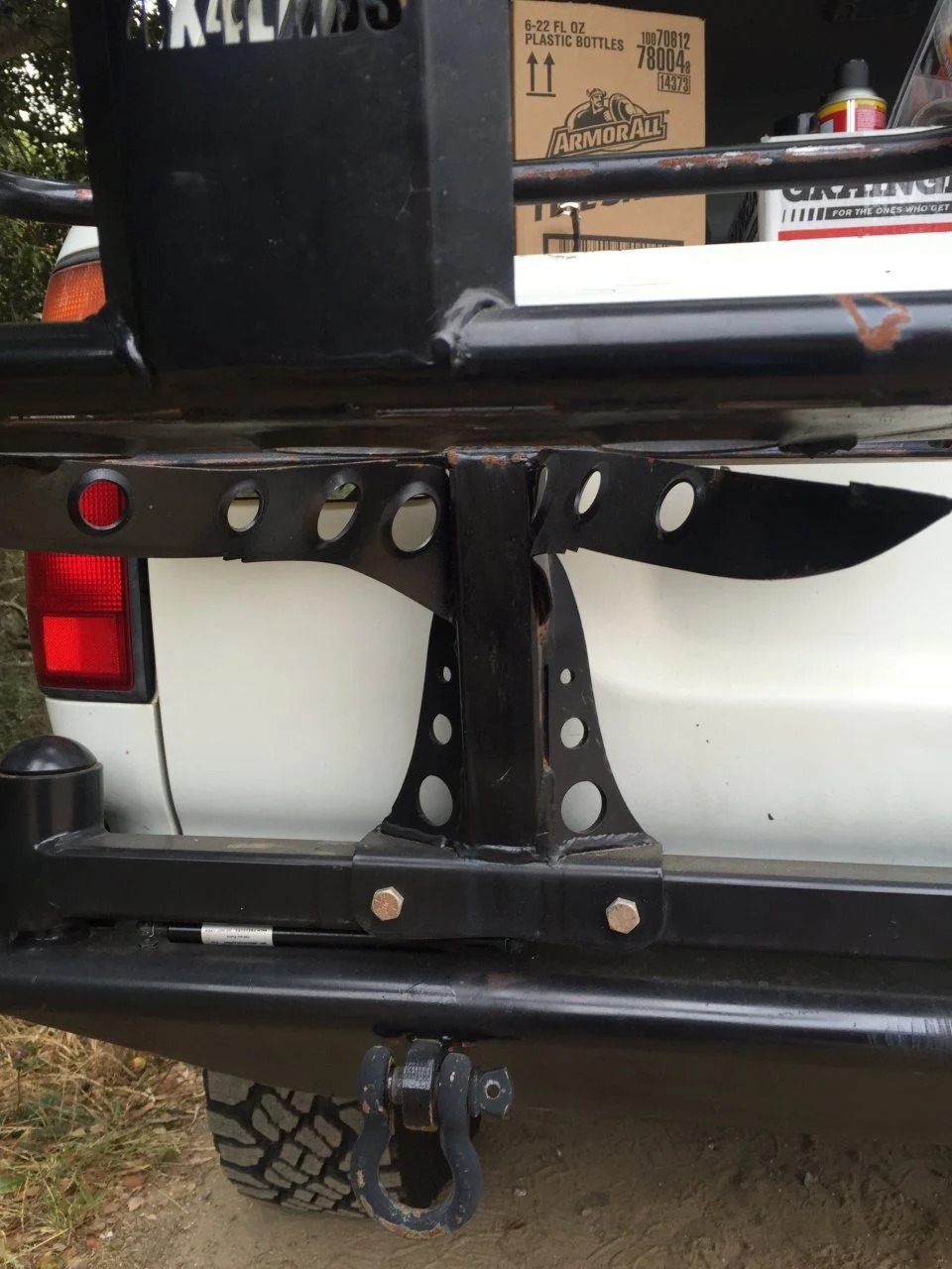

Finally got some time to fix some stuff that was broken from Rubithon...
The welds on these brackets from the carrier went caput...
Replaced them with 1/8th versus the 1/16 that was in there. And full weld this time.

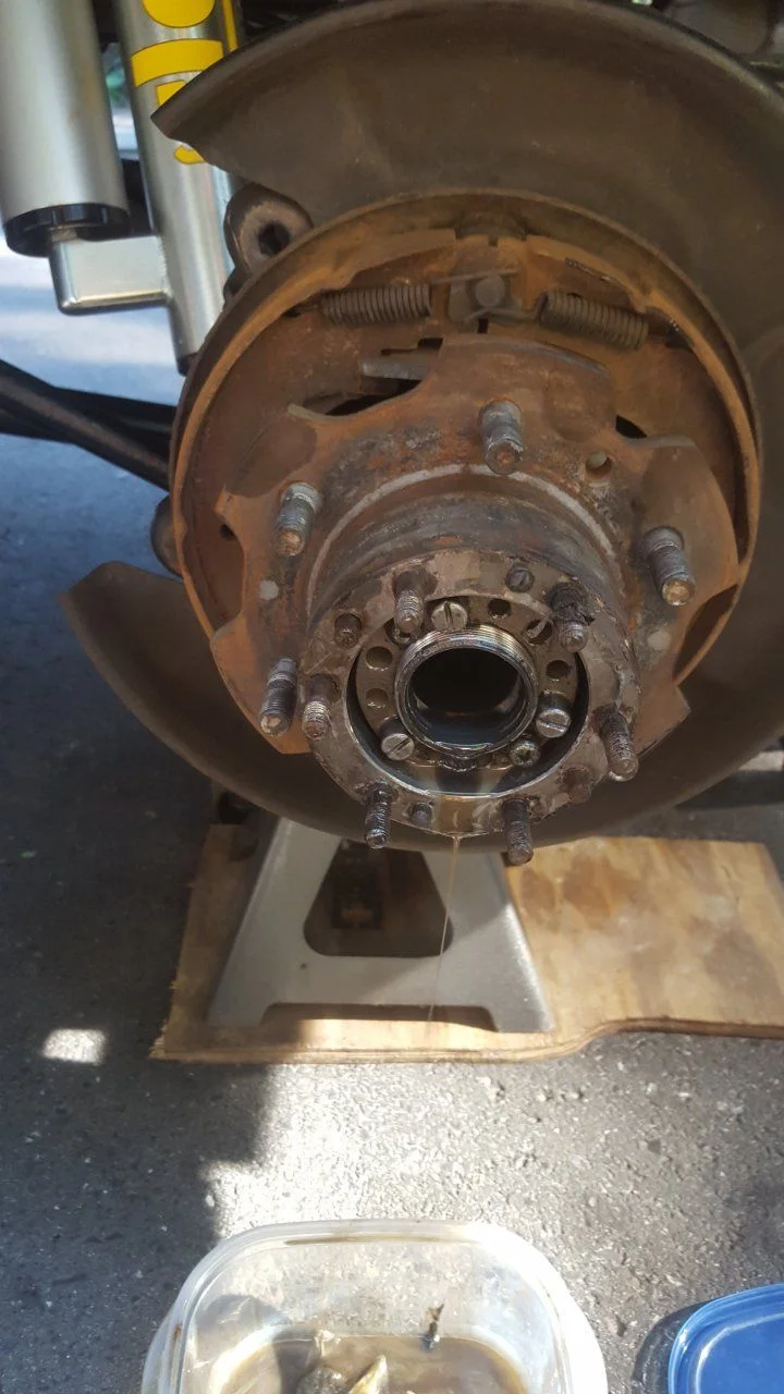

Just finished pulling the rear axles and hubs. They were very loose and had Timken bearings from the PO. They had a lot of oil in them from bad inner seals too.
Tomorrow I'm going to sandblast and powder coat the axle ends and the hubs. My new Koyo bearings should show up and I have new Toyota seals and gaskets. Also getting two new Spider Trax spacers. View attachment 1292093 View attachment 1292094
I did the same thing. If your bearings were loose make sure you check the underside of the spindle for wear. Consider retaining compound if there is enough wear to feel a lip on the spindle.

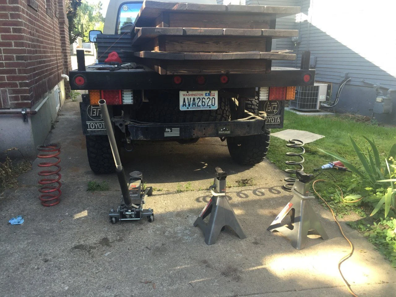

Swapped my rear coils out with longer ones for a heavier load... getting ready to haul four farm tables, benches, and who knows what else for our big day.
Love me some ute!
Mike,
Every time I see your rig I want to throw a canopy on it....
Jason
